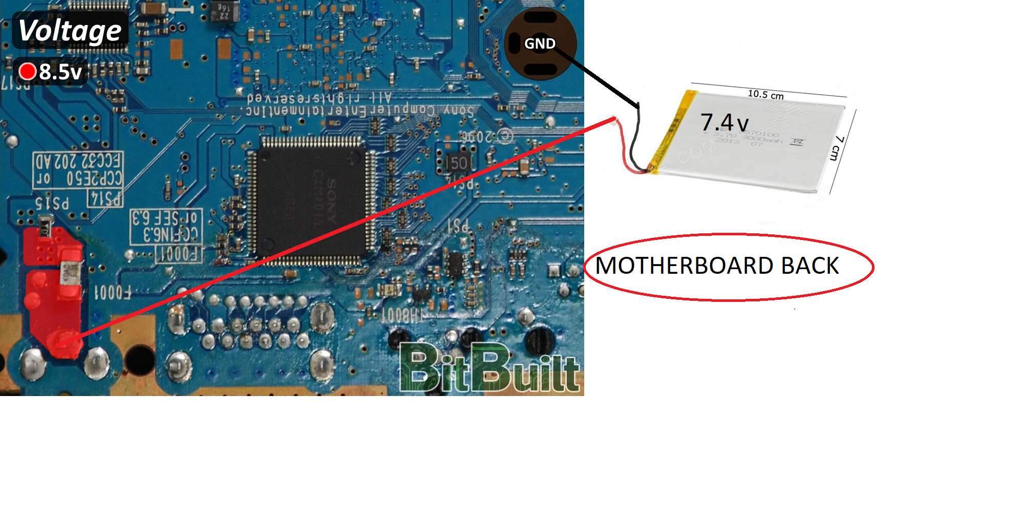

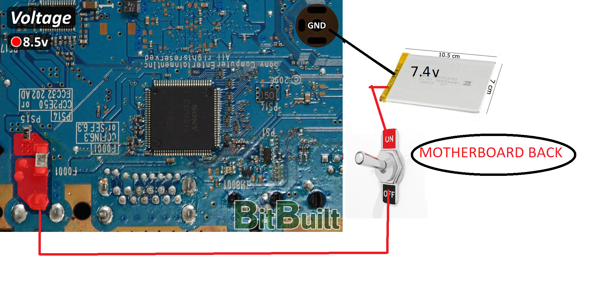

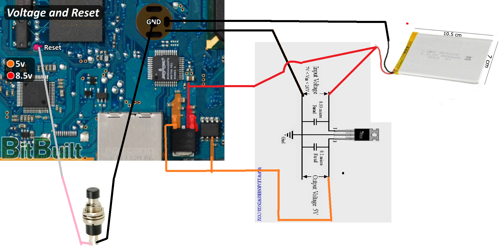

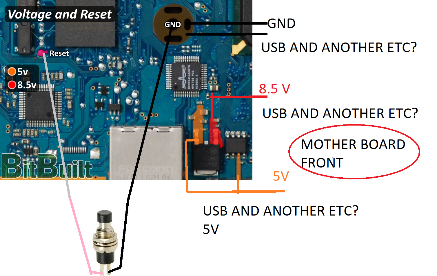

acalitos . Joined Apr 2, 2018 Messages 8 Likes 1 Apr 2, 2018 #1 i have so poor my grammer I made a drawing Should it be? what is it connection please tell me by drawing and what is this second picture connection Last edited: Apr 2, 2018

Gman RTFDS Staff member . . . . . . Joined Feb 25, 2016 Messages 1,465 Likes 3,020 Apr 2, 2018 #4 The switch wiring is correct. No need for the 7805. There is already a 5v regulator on the board, you just need to apply 7.4v.

Gman RTFDS Staff member . . . . . . Joined Feb 25, 2016 Messages 1,465 Likes 3,020 Apr 2, 2018 #6 acalitos said: okey and what is this View attachment 5631 Click to expand... You connect 7.4v there to power the console
GingerOfOz no wario Staff member . . . 2020 2nd Place Winner 2022 3rd Place Winner Joined Dec 16, 2016 Messages 1,144 Likes 2,868 Location The Oregon Wildlands Portables just so many i am so cool Apr 2, 2018 #8 ...That is a drawing though. Connect the output from your battery to the 8.5/7.4v part on the board.
Gman RTFDS Staff member . . . . . . Joined Feb 25, 2016 Messages 1,465 Likes 3,020 Apr 2, 2018 #10 I believe so. Make sure to put a power switch directly after the 7.4v from the battery
Gman RTFDS Staff member . . . . . . Joined Feb 25, 2016 Messages 1,465 Likes 3,020 Apr 3, 2018 #12 Yes
