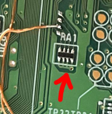

Hello everyone, my problem is that I decided to cut a Wii for the project, but when connecting the control number 1 to the Wii it is not recognized, are there alternative points for the controls of a Wii 4 layers?
I also tried a gamecube controller without success

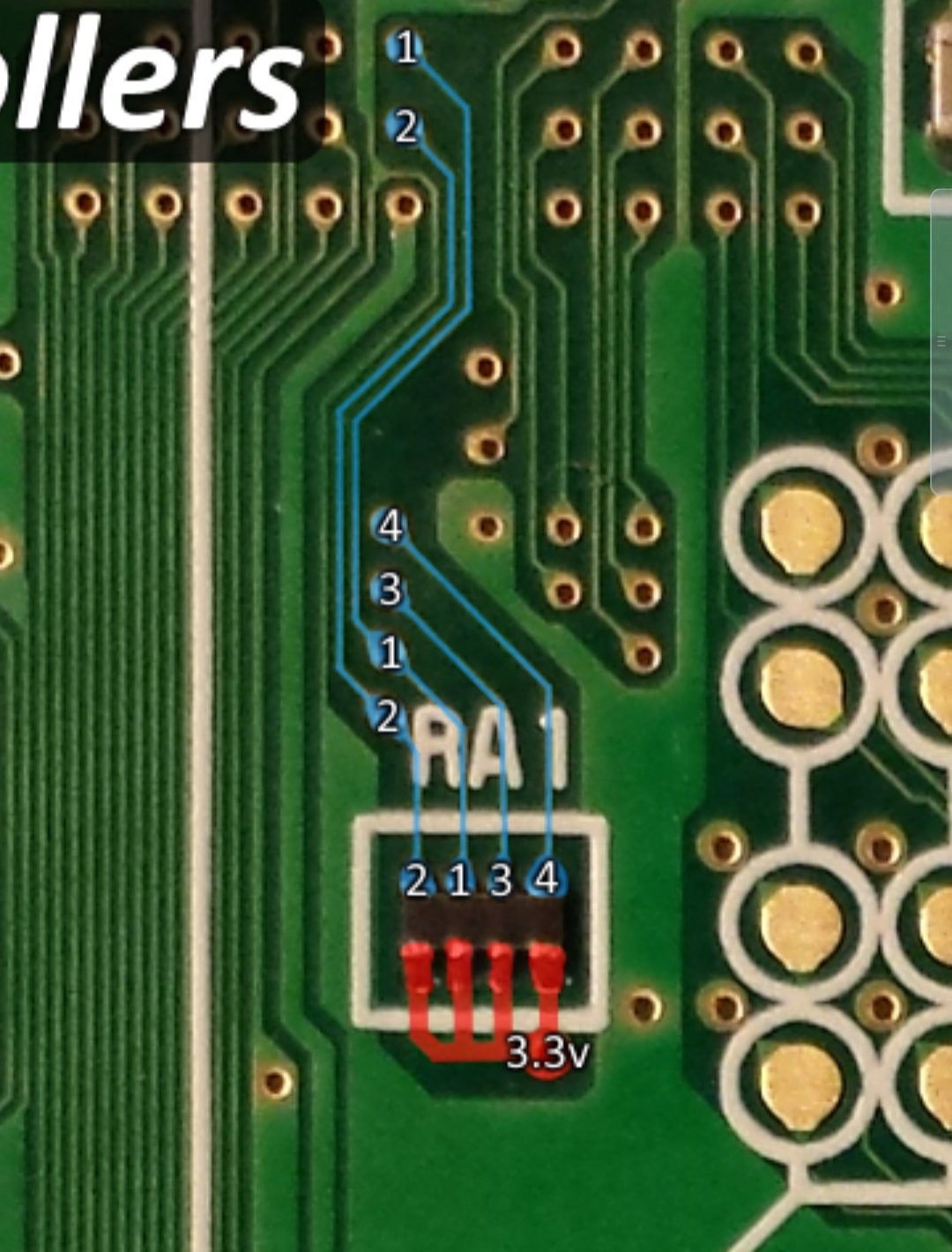

Those vias and the resistor array above them are the only spots to access the controller data lines
Sadly I have no idea. It's a direct data line, it either works or it doesn't. The only troubleshooting step I know for it is to make sure the RA1 resistor array is properly receiving 3.3v on this side
It may also be worth doing a quick continuity check from the exposed wire to the resistor array leg just to be sure that your solder joint is good
Thanks for answering, do you have any idea why the data line doesn't work? Will it be damaged in the process or by overheating when testing?
I tested that there is continuity and if there is 3.3v, that is the problem, everything seems to be fine, with bluetooth working I can move it with the Wii control but the gamecube is not capable
