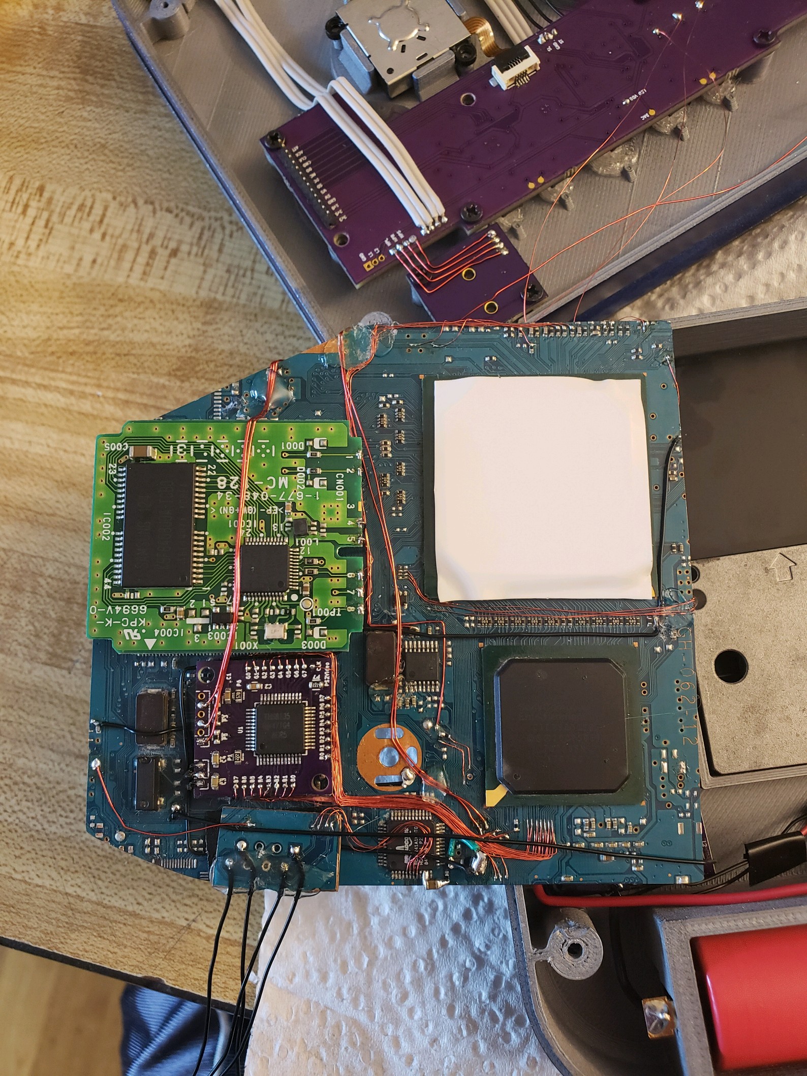

So I'm not sure how you're trying to solder the wires on as you haven't offered up a photo but having gone through this on my PS2 and Wii you're going to want to stagger the wires, this allows for one wire not interfering with the other as you try to solder. Sadly the PS2 only has those 2 pairs of traces specifically for usb data.
If Gman doesn't mind I use his PS2 razer build photo as a visual for what I'm talking about with staggering the wires, there is much more going on for his own personal add-ons but if you look at the top of the ps2 trim in the image you'll see how the data lines are staggered for soldering, this makes it much easier as you only wanna scratch a little of the mask of the trace.
