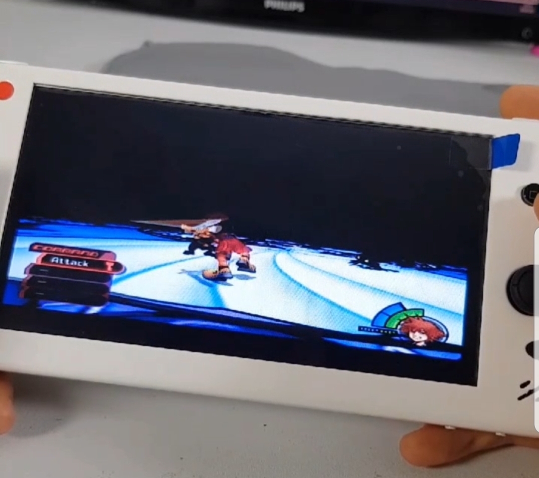

Ok, after a lot of testing ... strugle ... MAJ OPL and FMCB... install all again ... testing some diferents types of games (EU, USA, FR).
It look like it don't recognize the controller only when I put game in FR (French), If I put EUR rom in english it work !
I don't know why ?
Maybe OPL doesn't like French
After testing some other games it work only with Kingdom Hearts, Crash mind over mutant, GTA San Andreas.
I have tested God of war in fench first and in english after, but I have the same problem : the controller is not detected.
And when I test the controller with the Controller tester (in freemcboot) It doesn't recognize the Stick, so when It is on the PS2 menu it is on digit mode.
I think the PS2 think it is a Digital Controller, and with some game it push it to Analog mode automatically ?
I don't fully understand the code of the Ps2 Plus, so I don't know how the controller change of digital to analog ?
