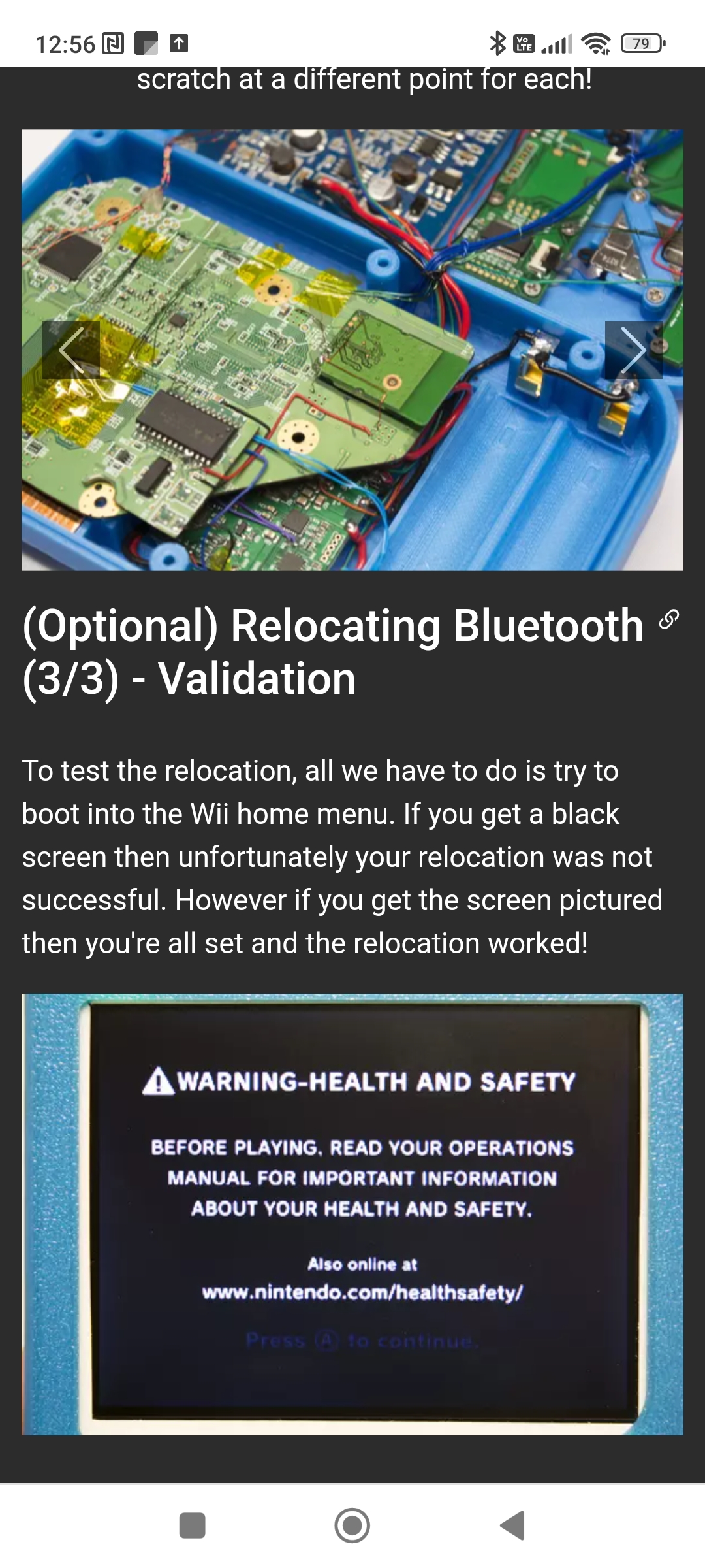

Actually, every Wii portable can do this.When you install rvloader, you can boot in the Wii menu if you want.You just need to relocate the bluetooth module for have the warning message.For exemple, take a look at the end of the g-boy's manual.Hope it's help!

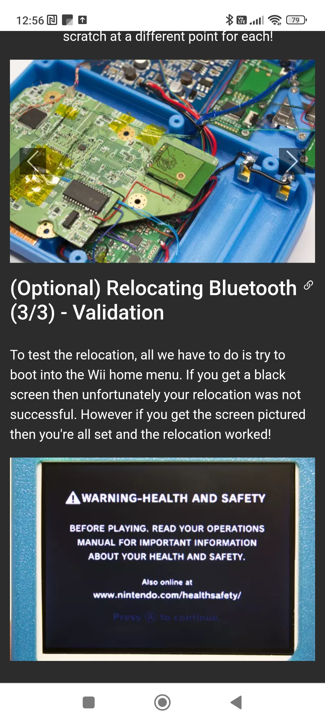

Actually, every Wii portable can do this.When you install rvloader, you can boot in the Wii menu if you want.You just need to relocate the bluetooth module for have the warning message.For exemple, take a look at the end of the g-boy's manual.Hope it's help!View attachment 37942
Oh, I dont need to relocate WiFi to get the wii menu? That would be great, bluetooth relocation Isn't too bad but wifi looks like huge pain.

Watch this thread, it will help you much.
(And Yes you dont need to relocate the wifi module),

To clarify: You don't need to relocate the wifi module if you install the nowifi patch during RVLoader installation. Without the nowifi patch, the Wii will not boot if the wifi module is missing.
After installing RVLoader, you can boot into Priiloader and change the power on behaviour from running RVLoader to booting the System menu. Unfortunately RVLoader does not have a forwarder WAD, so you can only run it from the Homebrew Channel at this time.

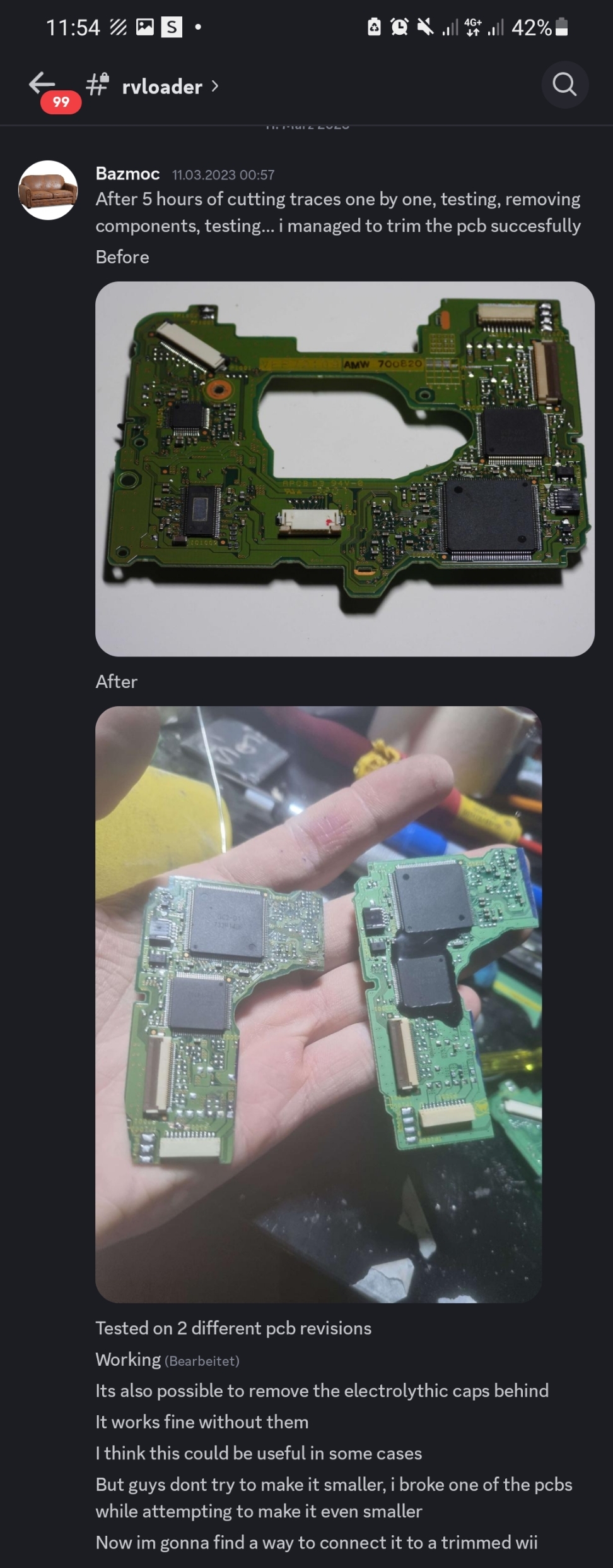

I considered trying to figure out a trim for the disc drive board and somehow connect it to the trimmed wii so I could use USB Loader but... there is a limit to my stubbornness
Depending on how you want to build this thing, you may not need to trim the disc drive PCB. It's already pretty small once you remove the housing and desolder the motors

Someone did trim the disc drive actually
Think he used a version that could communicate with the wii with just the data line, without the power cable

Oh wow, I could sworn someone out there had to have tried it before and I guess I was right! There should be a bitbuilt post about it :)
I wonder if that trim works with the smaller disc drive board revision? I have a rev 40 (I think) black Wii and it's drive board is smaller (as @Stitches mentioned).
All that's left is how to connect it to a trimmed Wii :)
I'm not aware of anyone having done this before or any diagrams related to it, so you may have to trace your own pinout using the Wii compendium and a multimeter.
Aurelio already had a working method to patch out the disc drive calls before I joined up, and before that trims were kinda Wild Westy and kept the disc drive FFC traces intact.
