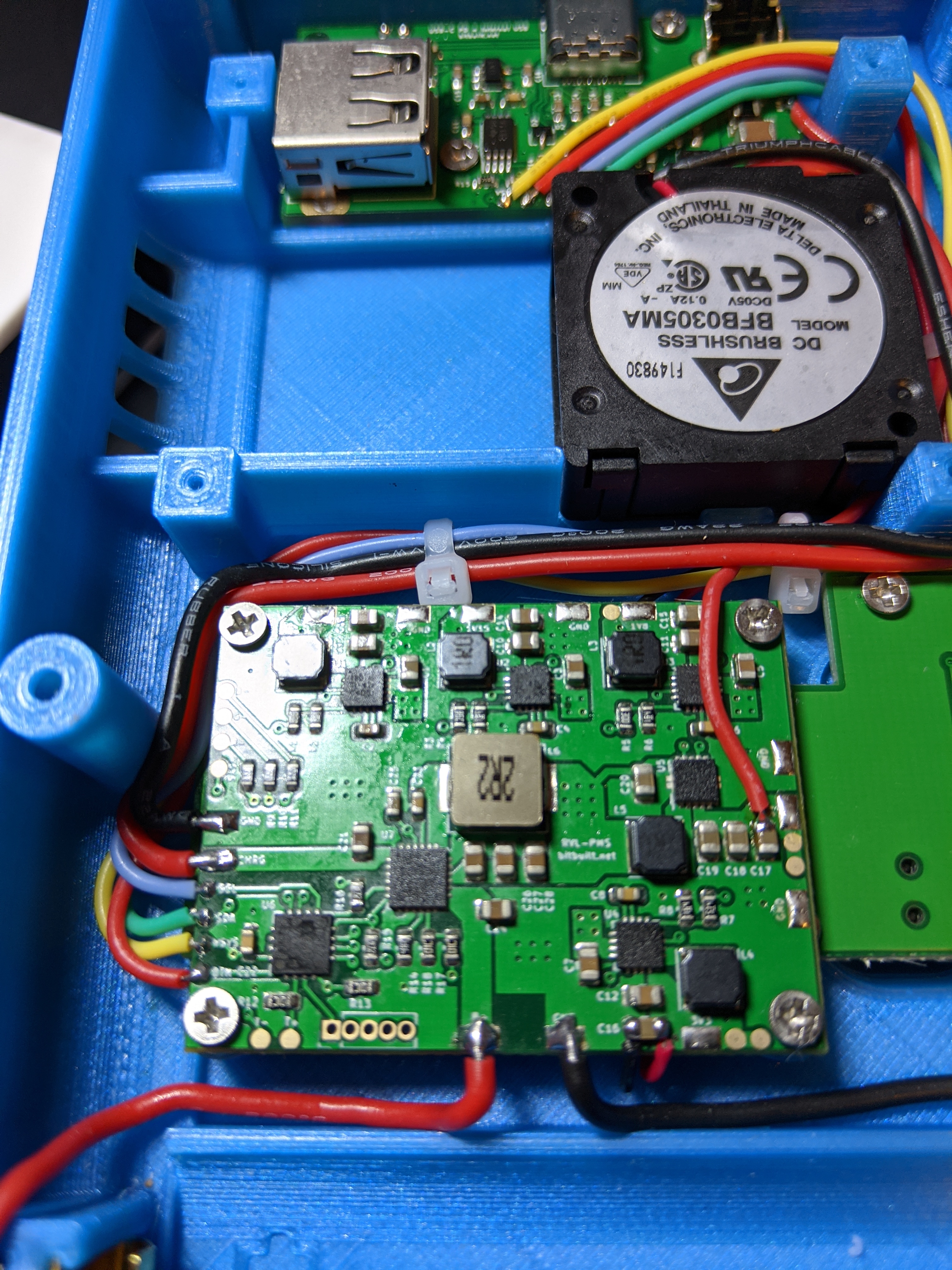

On Step 7 of the G-Boy guide I noticed SDA, SDL, and VSys appear to have been moved to the left side of the PMS board revision I received. I don't want to apply any power to the system until I can get verification though.
In the photo, my SCL, SDA, and VSys are the blue, green, and yellow wires, respectively. Also, the red wire is pulling 5V from C17, which I believe is C3 in the guide.
Does this look correct?
Yeah looks great! The new board has additional voltage pads so you dont need to solder to the capacitors. The new guide update will have new pictures of the board. You can do it either way it is fine.
