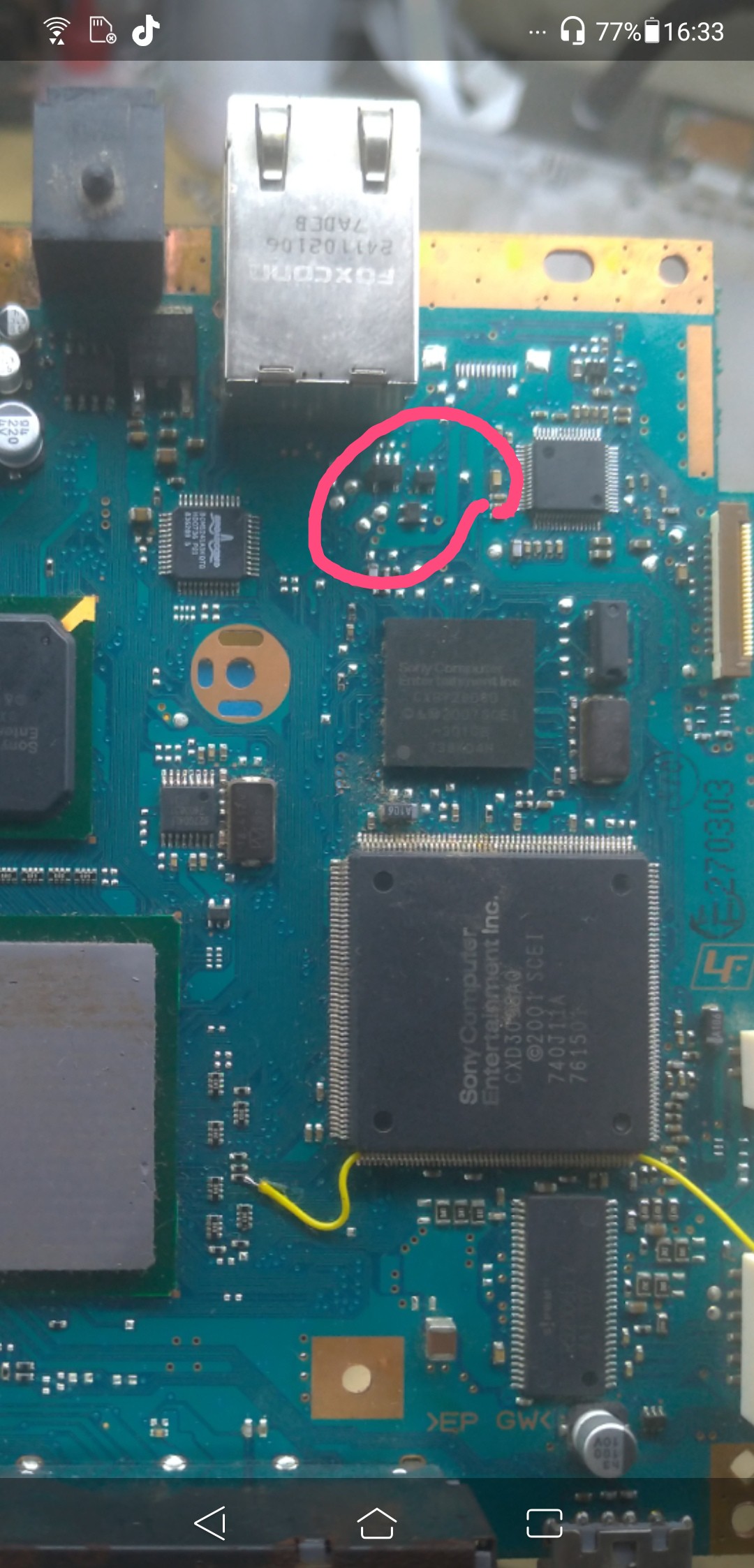

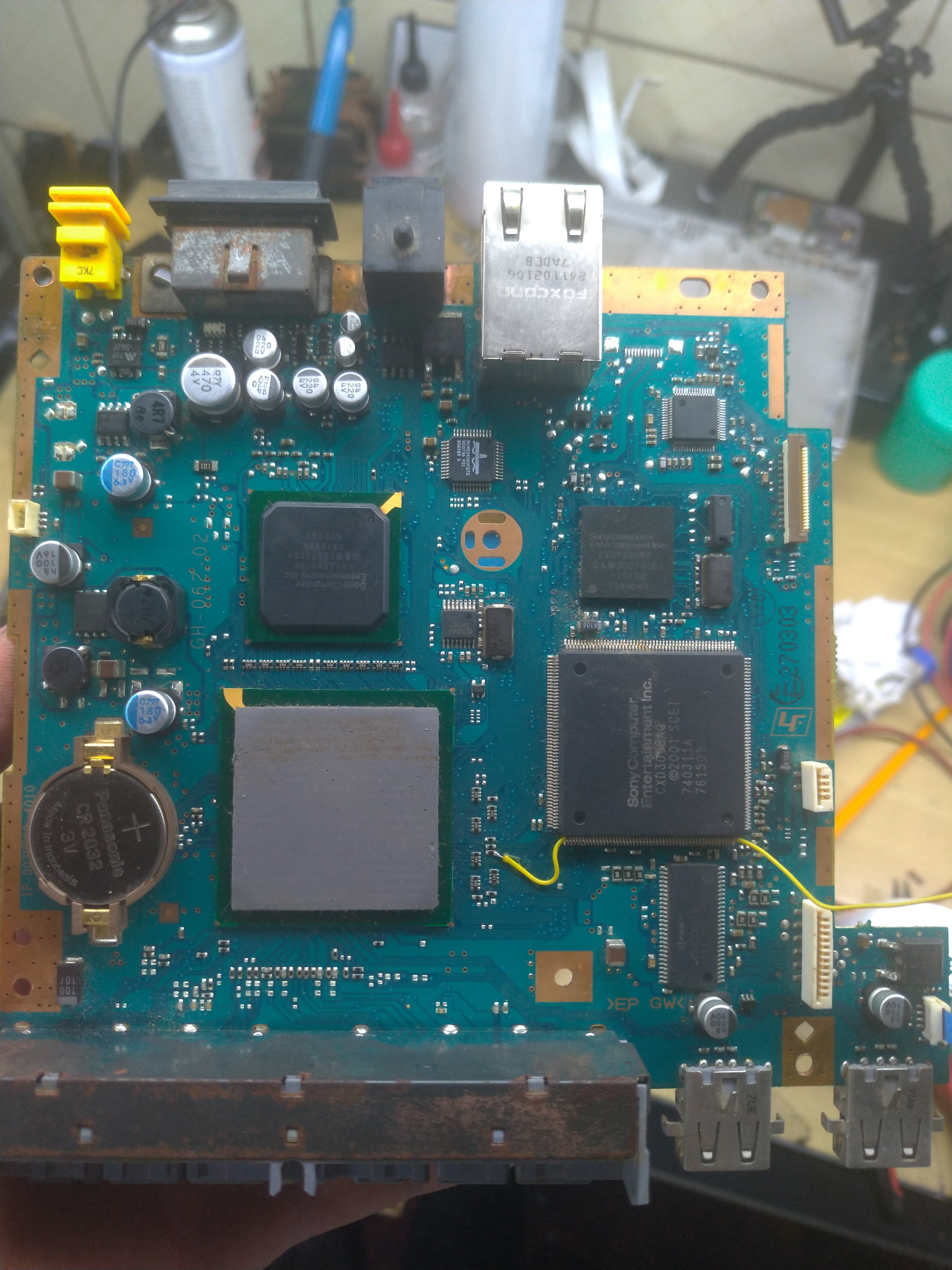

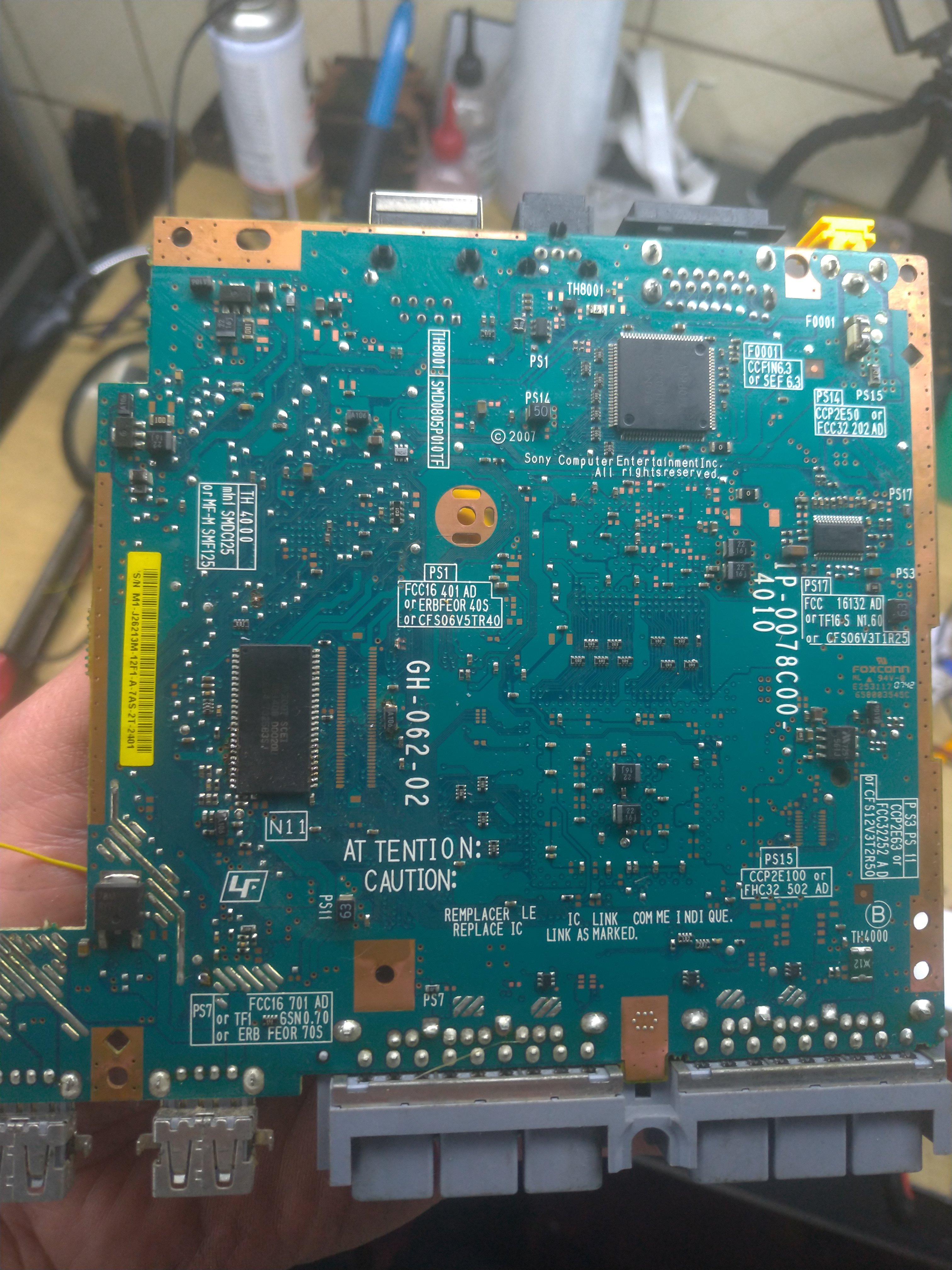

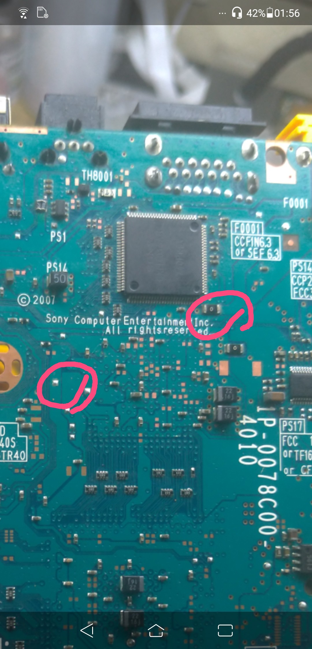

friends I have this motherboard as I show in the image, it was working, when I went to turn it on, there was no image and the power button is stuck in green light
I wanted someone to tell me where her voltage regulators are by editing the images shown, I notice that the positions of the components are different

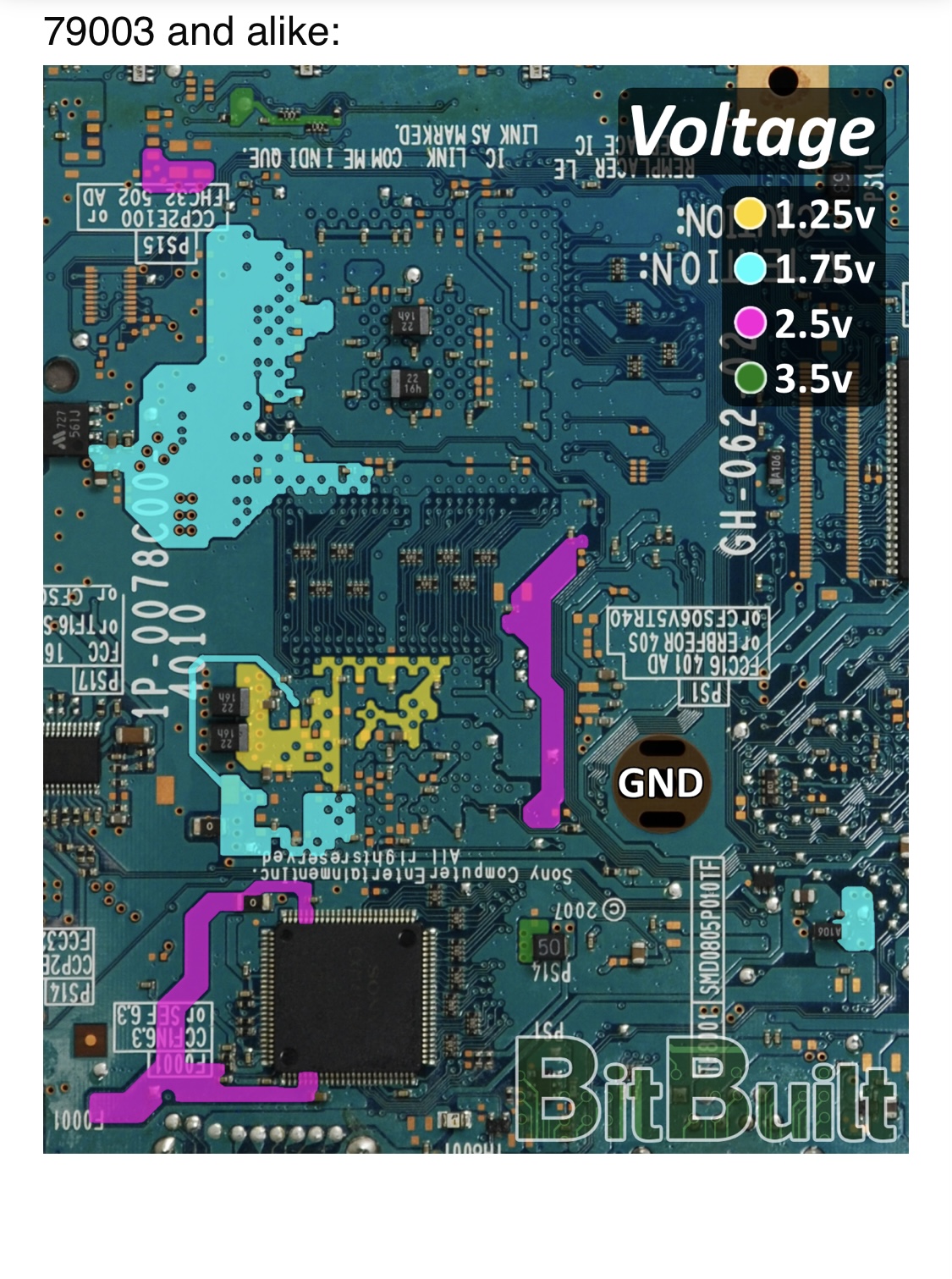

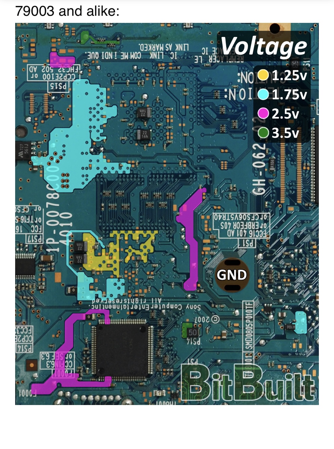

friend seeing the image here, the model 79003 does not need to remove any regulator to make the advanced cut? the Model 79001 is marked in red, but the 79003 is not
On the bottom no but you still have to remove the ones in the top side, when you make your cut you will pretty much get rid of them.
I understand, so I should remove the regulators and put the custom regulators, are these the regulators I should remove?

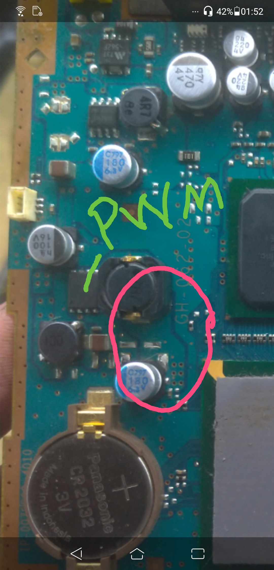

I'll explain what happened, I was planning to use the Nintendo Wii adapter, on my 5 inch screen so instead of turning on 5v I turned on 8v, I don't know if that's what killed my motherboard, I didn't test my motherboard, before doing it this hdmi converter installation
Today I tried to bring it back to life, without success, but I discovered that I don't have tension in the pwm
