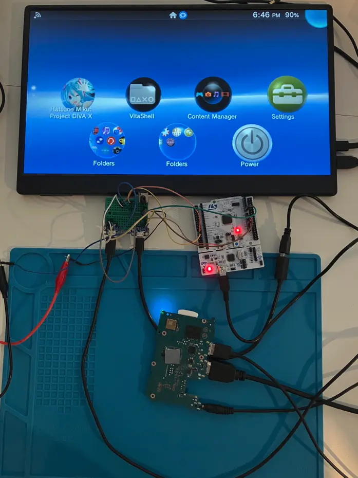

Well, I posted this last year, immediately got filtered by the USB implementation and gave up...
I got a cheap logic analyzer recently, so I hooked up a real ps3 controller to the PSTV, recorded each usb transaction, fed that into an AI, then copy pasted the output into my microcontroller code and now it works :)
Here's a picture of my simple setup. When I click the blue button on the microcontroller it virtually presses the PS button via the usb pins

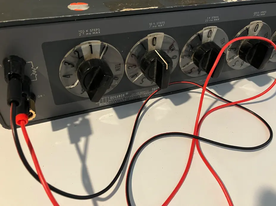

I also have the microcontroller's ADC attached to a resistor divider and this variable resistor box to make the left analog stick move up and down. Since that and the PS button works everything else should too!
