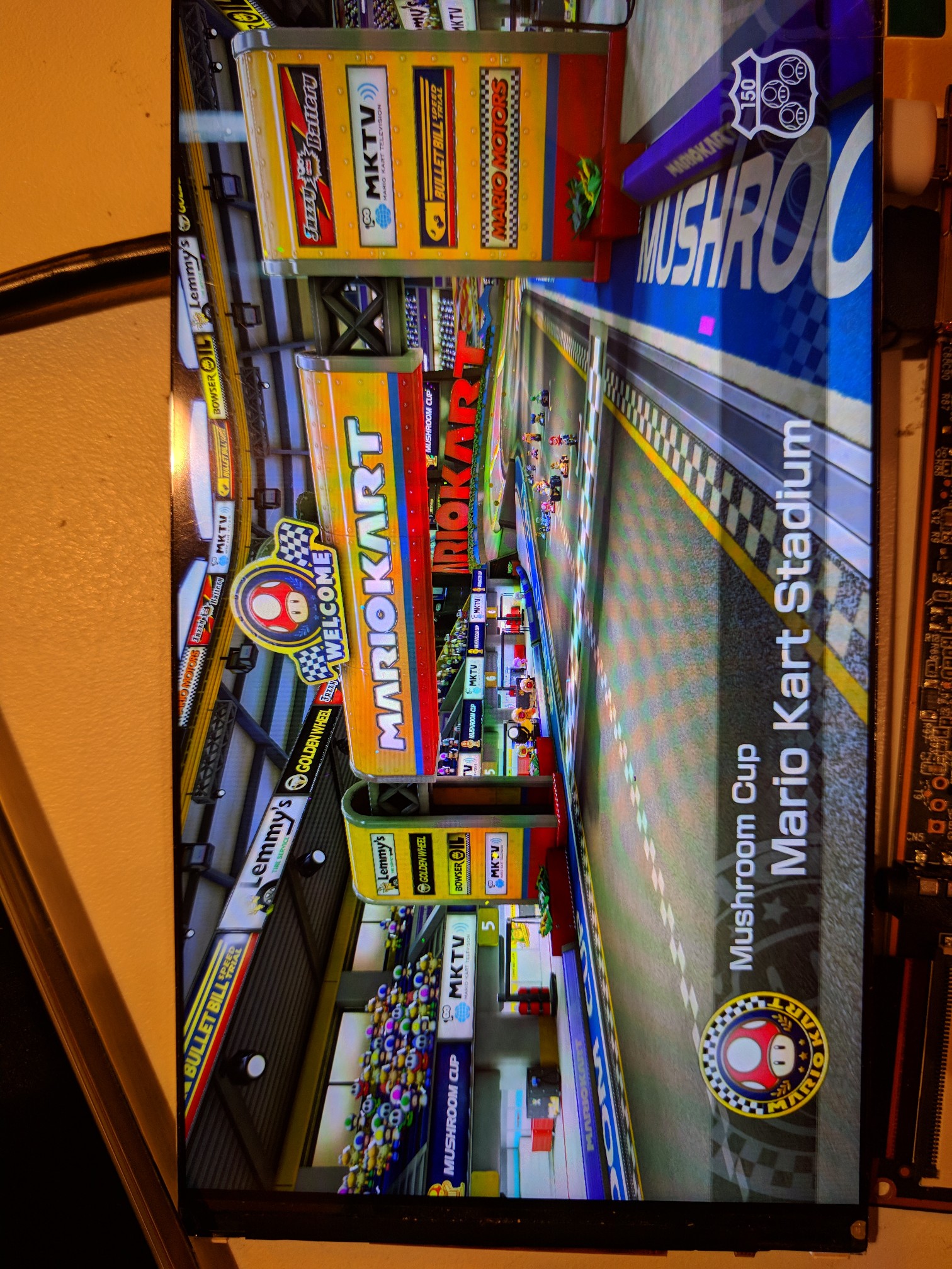

I always wanted to pair it with a nice 6" 1080p TopFoison panel for those sexy IPS colors and viewing angles:
As you can tell, I've been wanting to mess around with this myself, but Shields are expensive, and I'm lazy :P
That is excellent!
The IPS photos look so good. How is that connected to the motherboard? Directly to the motherboard or a quick demo via HDMI?
That's just my PC hooked up via HDMI, running Dolphin and CEMU. TopFoison's screens are pretty gorgeous.
The MIPI driver board doesn't have a scaler built in, so the device you hook up must output 1080p at all times.
