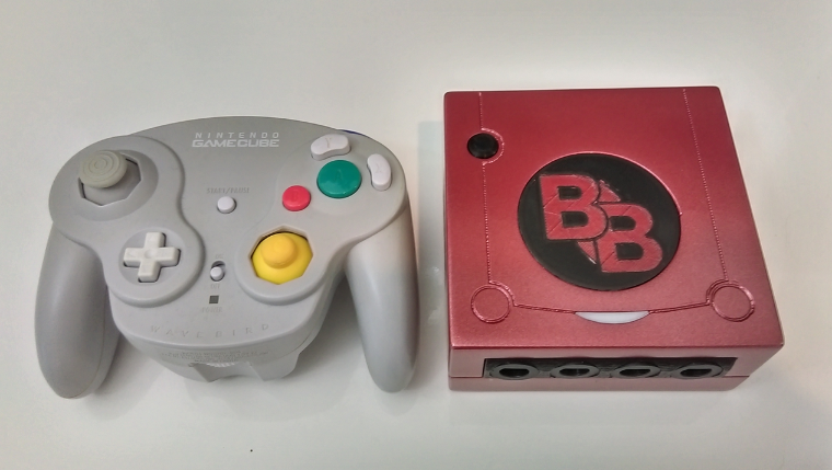

So this is my first Wii trim and case design. I figured i'd start out with a rather simple mod before moving on to a portable.
THE GOAL:
  • To create a case that is simple to print and assemble.
  • To reuse a decent amount of Wii components and screws.
  • Small enough to be cute but retain decent thermals.

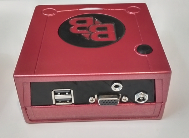

  • Easy to modify backplate (using tinkercad) to accommodate other AV and power methods.

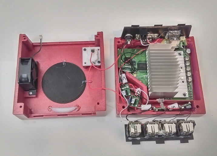

The power button height and switch mount may need to be modified to accommodate whichever switch you decide to use. Easy to find low profile switches can found in cheap pocket LED flashlights.
Cut the USB to this shape and power the fan header from the USB's 5v and GND.

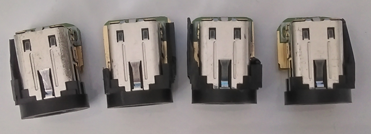

Trim the Controller ports as short as possible, otherwise they'll hit against the heatsink.

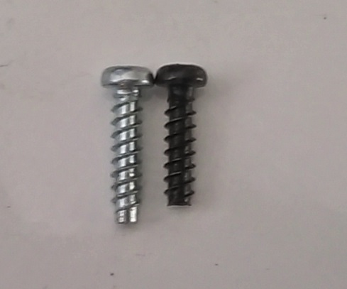

The Wii's fan, heatsink and the switch bracket are mounted using screws from a disassembled Wii. The original heatsink screws are slighty too long and can press on the bottom of the case, use a shorter screw from a disassembled Wii.
