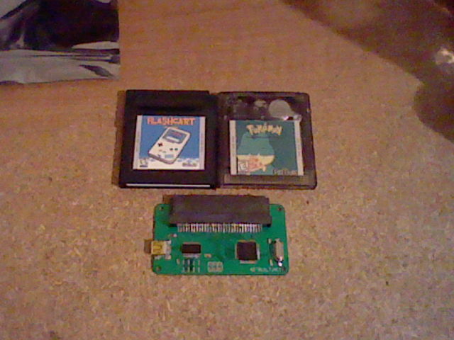

So the new one will support both GB(C) games as GBA games?Flasher will be available again shortly, waiting on parts for a new batch.
I've never tested this flasher with the Chinese bootlegs. If it can't flash them it's a software limitation rather than a hardware one. I'm currently writing new software that will allow those to be flashed and allow for slightly faster flashing times (I've also got a new flasher in the works that supports GBA so this one will be discontinued soon but still receive software support.)

I don't know what you mean with the arduino statement
But I meant that I want to wait for the newer revision because that one can flash bootleg GBA games and I already have a bootleg GBA game. And also, because I don't have to buy two flashers, but only one, which costs me less money
But if the old revision could be updated somehow to support GBA, I would buy it immidiately :p
@pikpol The one of BeenVenn isn't made with arduino, it's a proper cpu and noah's programmer can't program gba bootlegs but for gb bootlegs i don't know.

You can easily program a microcontroller to do both.
