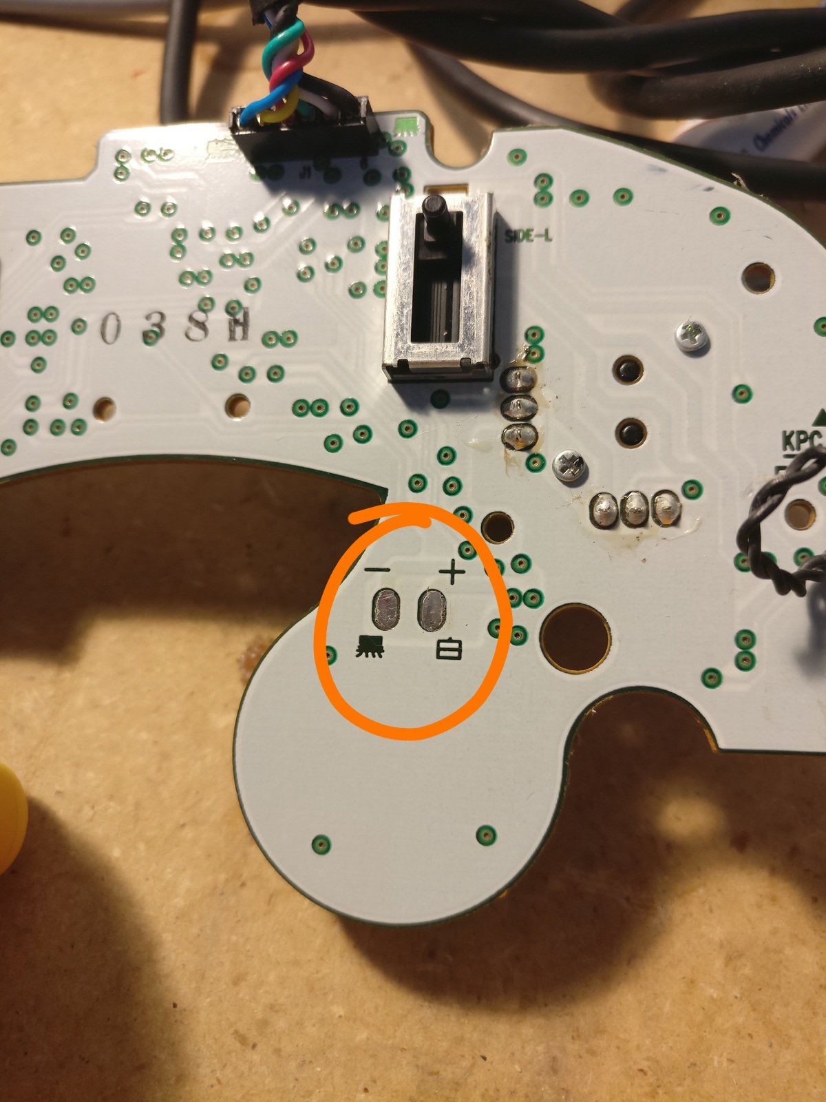

Should've posted a picture earlier, my bad. I'm talking about these pads. Also, they're both giving out 5 volts.
The negative pad only provides ground when the rumble is active. That's how it turns rumble on or off. So it sounds like your 5V supply is fine.
Okay, I had a feeling that was the case but I figured it'd be better to make sure. I tested multiple controllers as well and none of them are working so I assume it's not their fault.
