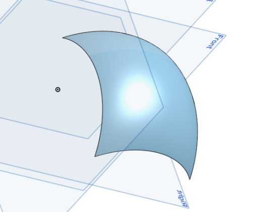

After that I loaded it up into onshape quickly to confirm my therory, and indeed, they all lined up with the center point being around my palm.
I did a similar thing with my pinky finger and did a loft feature to combine the two and we end up with this:

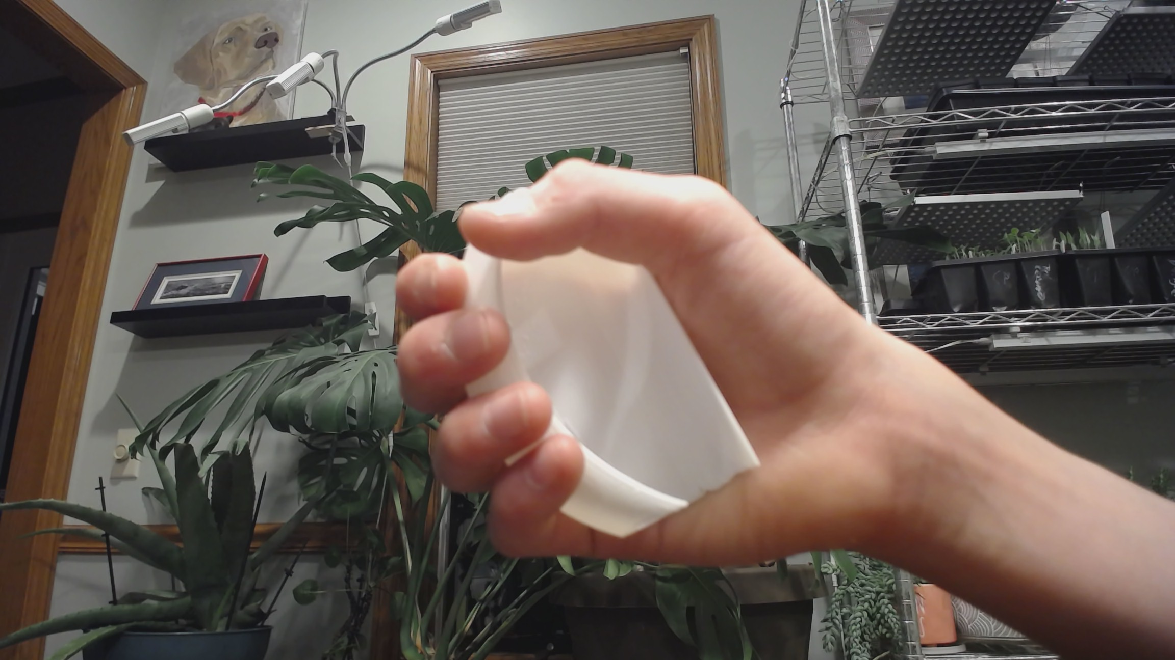

after a couple iterations, I ended up with this:
...and It's quite comfortable! I think with a bit of fine tuning, this could be a very easy way to make comfortable portables!
