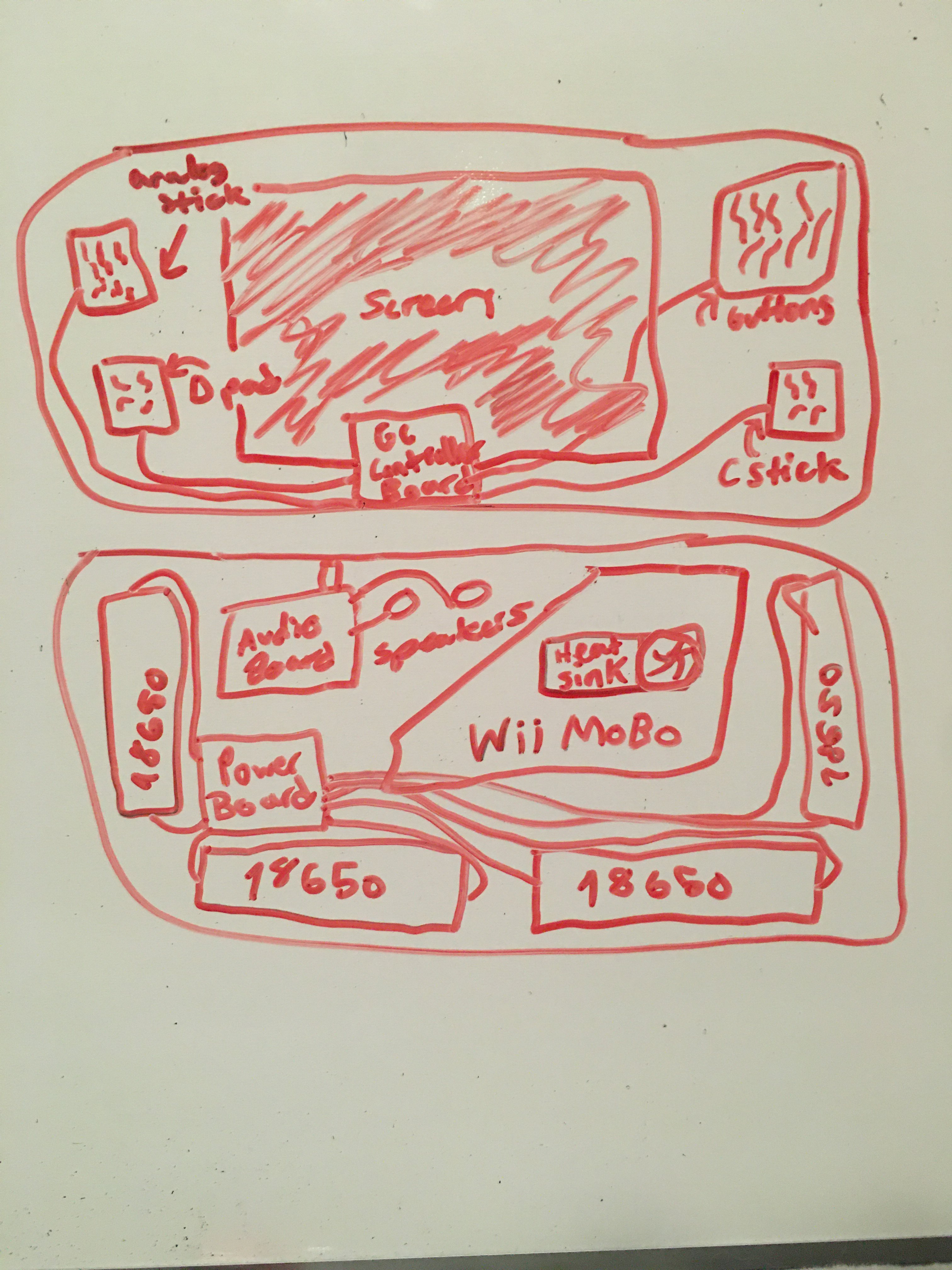

I know this is VERY rough but I drew this out and was wondering what the experienced builders would think. Is there anything I’m missing? So far I got the Wii Mobo, a 5 inch screen someone in the forums recommended me, Gamecube buttons and joysticks, U-Amp 2, PMS-PD 2, GC+ 2, RVL-NTC, RVL-PMS 2, 4x 18650 Samsung Batteries, an on/off switch that Gman used in the G-Wii and 34 AWG and 22 AWG wire. If theres anything I have wrong here or things that I’m missing (which I’m sure there are), please let me know. Thanks!
No need the on off switch the PD board includes a power button.
maybe you want an aux jack?
this design looks to be very similar to gwii, maybe look into it?
Yeah, I’ve been pretty inspired by the G-Wii but I really want to design and 3D print my own case design so I can put screw posts anywhere for anything. It happens that I’m learning Autodesk Inventor at my school which will teach me how to design and print anything.
