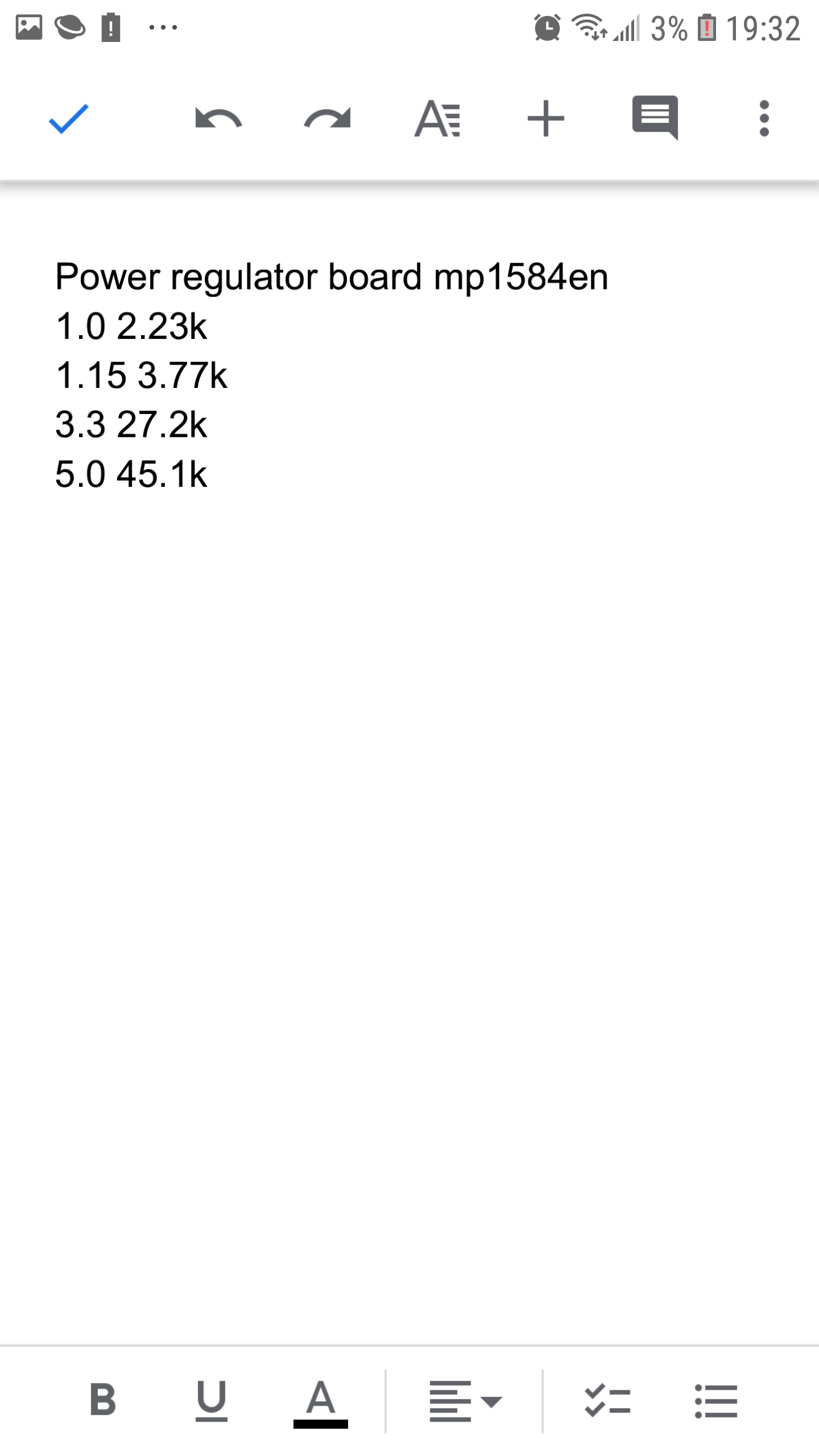

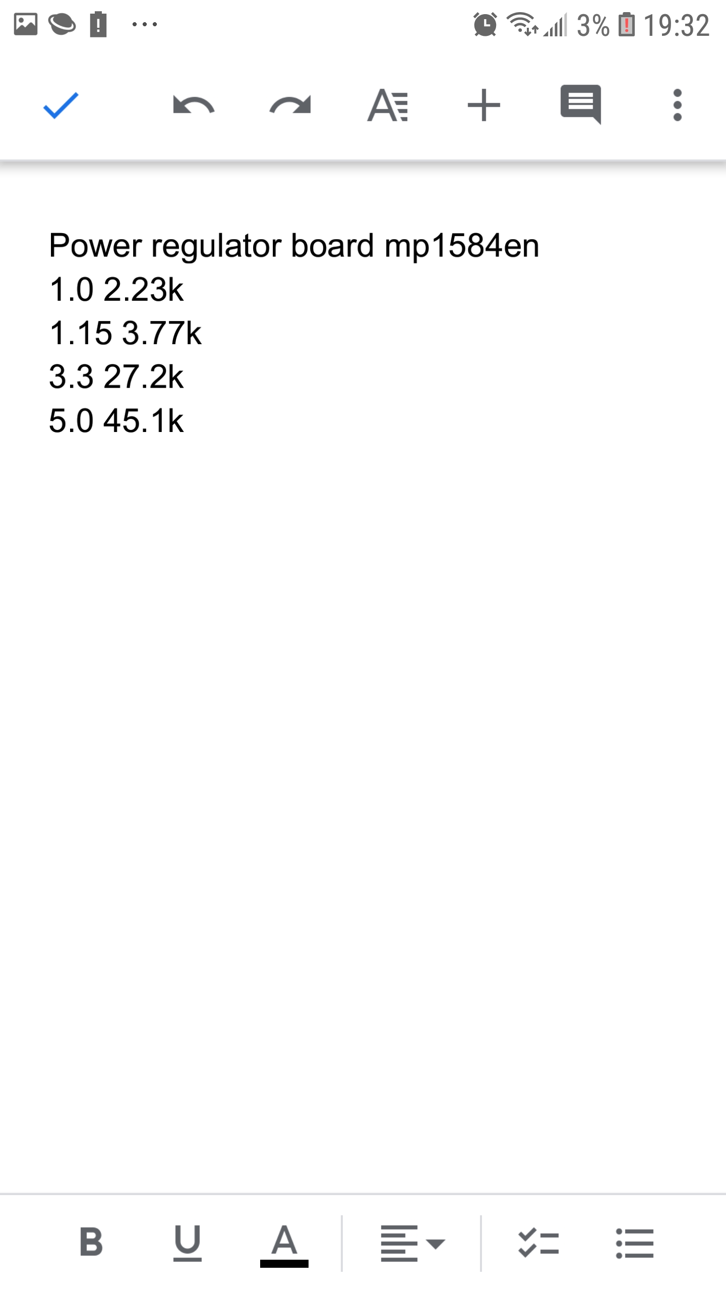

So I think I figured it out. Removed the shitty little pot, soldered in a better 50k pot, bridging the wiper and one of the end pins. Soldered the lone pin to the lone point on the board, and a wire to the two joined pins on both the pot and board. Set the right voltage, removed power, desoldered the wire from the pot, measured it, then resoldered the wire, rinse and repeat. These numbers look right? Thanks in advance.
So I calculated 2.05k for the 1v line and 3.5875K for the 1.15v line (I didn't use these particular regulators for the 3.3v and 5v line on my portable. Your values look good to me, because I think they can be a little over, to compensate for wire length and voltage sag.
