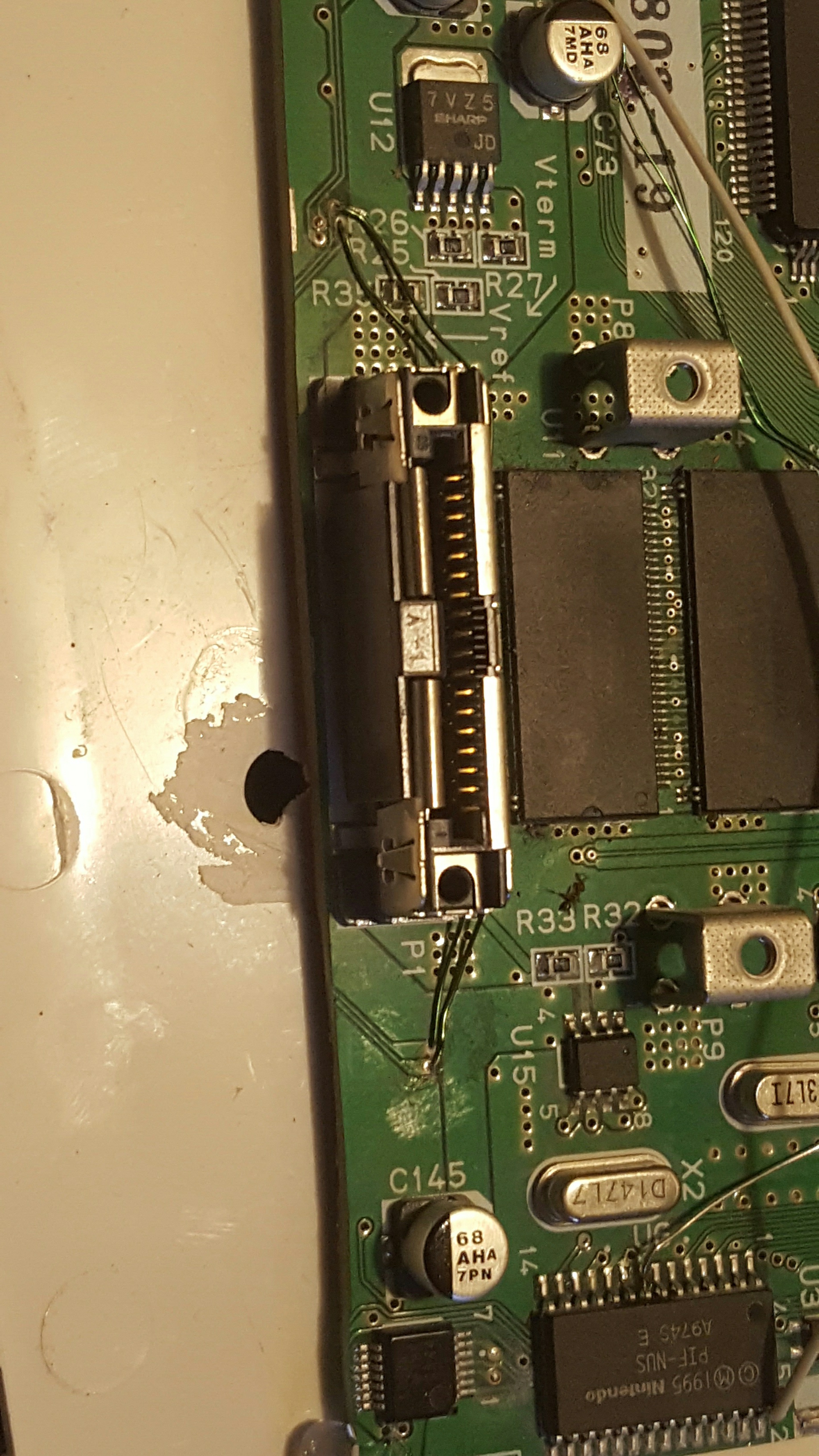

Evening folks,
I've been trimming the board. Started with the left, top and right. Tested each time.
Today I've trimmed the bottom and now it's dead :(
Any ideas on what I could have knackered? I've trimmed some of the surface mount components which originally led to the controller ports. Would removing any of these have killed it? All cut tracks have been re-routed I'm at a bit of a loss.
Any thoughts, ideas or crack pot theories welcomed! :D
Yep, sanded all edges. Found I broke one of the tracks which went along the back of the board but I fixed that. Still nothing though.
The only thing I can think is the surface mount components which went to the controller ports; I shouldn't have cut through them?
I was checking an untouched board with a multimeter and it looks like one of the components was a 1K2 resistor between 3.3v and ground? Would reconnecting a resistor fix this at all? :/

Yeah some of those are important, it's worth a try at least.

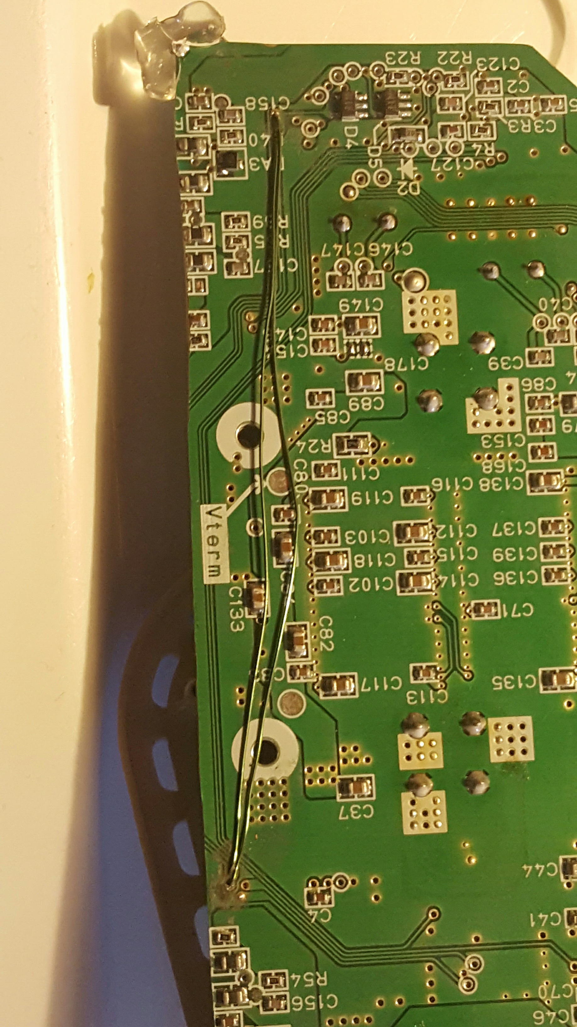

Did you rewire the 2 line on the front and back that's at the bottom?
Yep, rewired all of them using the via's. Double checked with a meter to ensure no dry joints.
It's seems to be ever since I sliced through some of the surface mount resistors/ capacitors on the bottom of the board :(
I'm fearing I may have killed the board unless someone knows of a fix?

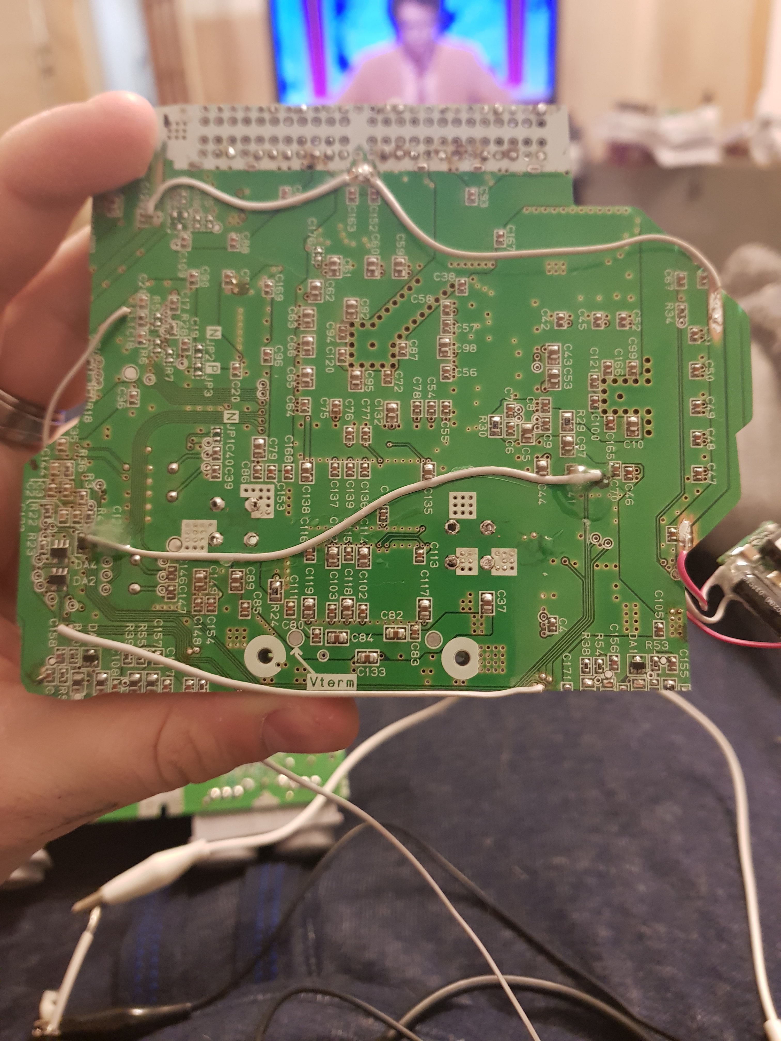

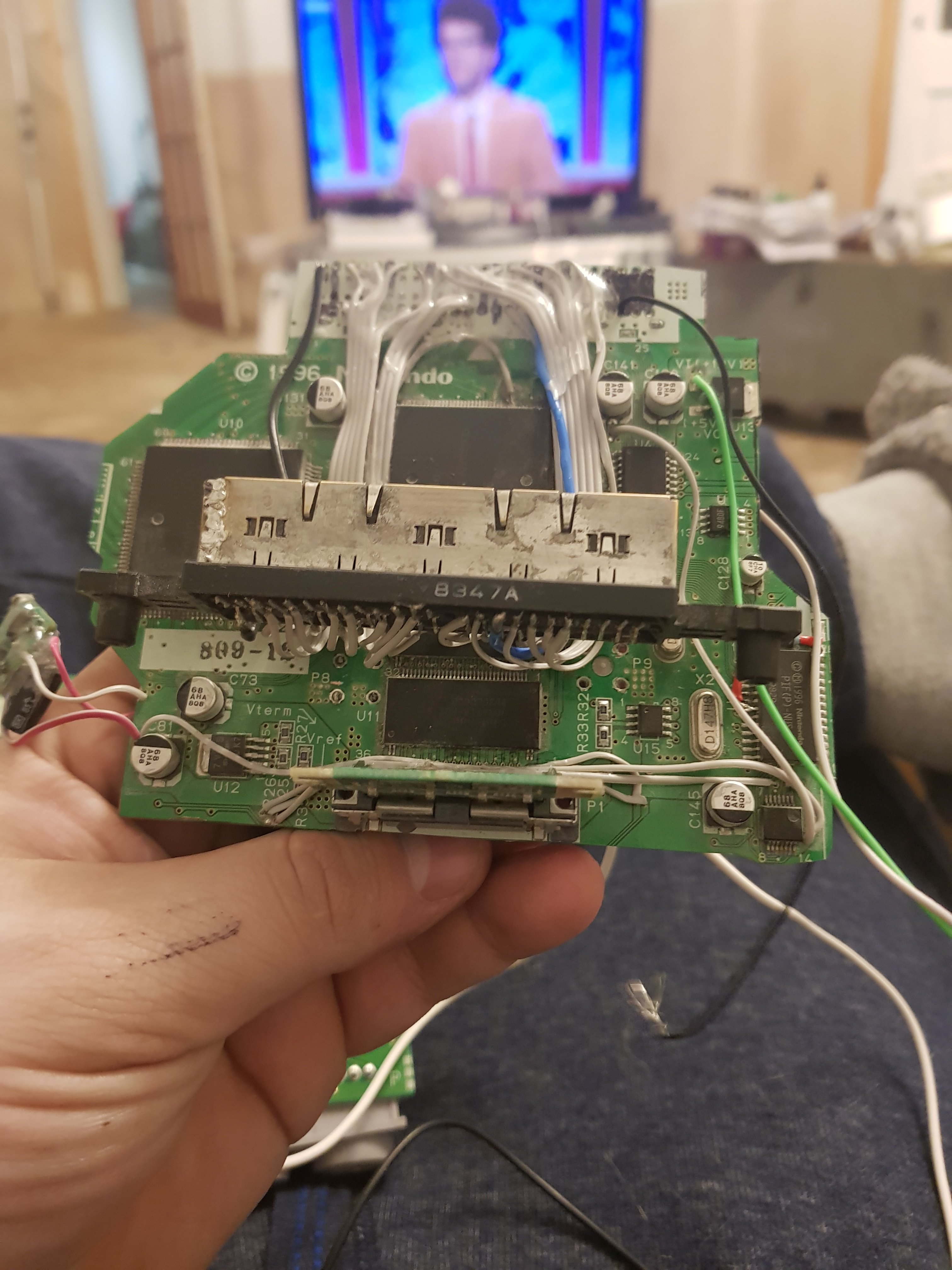

Can you post a front pic of the board
On the back i only see 1 wire that's rewired at the bottom
The wire you used for the main voltage line looks a little thin?
It's a 28awg magnet wire:D
Not from your picture, I meant that towards elektrix
His wire looked thin for the main power line?
But I guess that wouldn't be the issue
His board just flipped the life switch. I had a board I took a chunk off around the bottom right, took off all the surface mount components around p3 and p4 and I haven't been able to get it to work since but I know I was gonna try the resistor fix?
