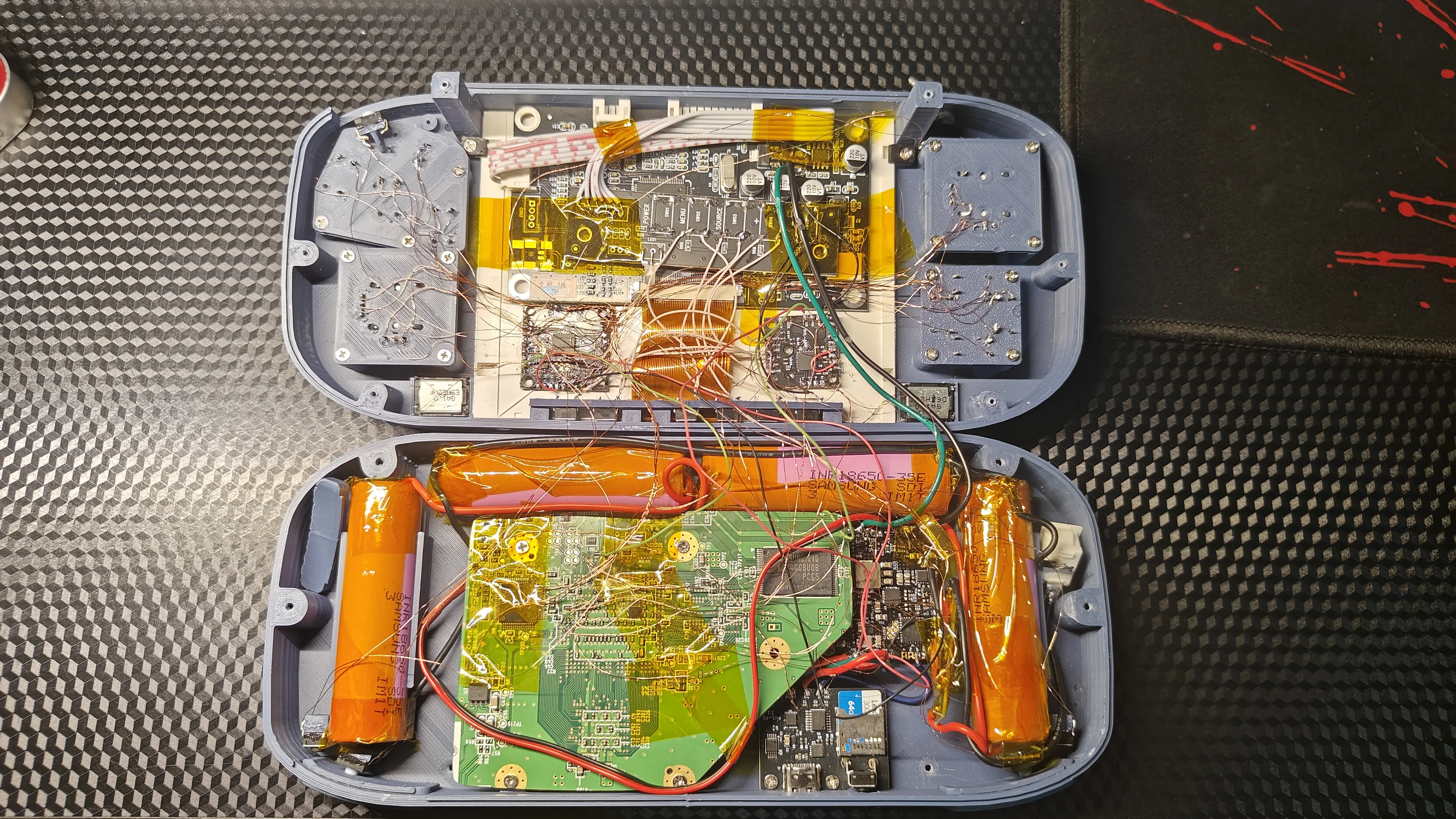

About a year ago now, I built my first wii portable. Despite people in the community saying that the ashida was the easiest portable to build in the community, I decided that I didn't like how bulky the ashida was and settled on a g-wii.
I did this all for my highschool “capstone” project. A self guided project where you could do whatever you wanted, as long as you could make a presentation showing your skills and growth by the end of it. (I got 100% on the project btw)
That portable has some of the most atrocious wiring in the world (see picture) but it still works to this day, and I would never change a thing about it.

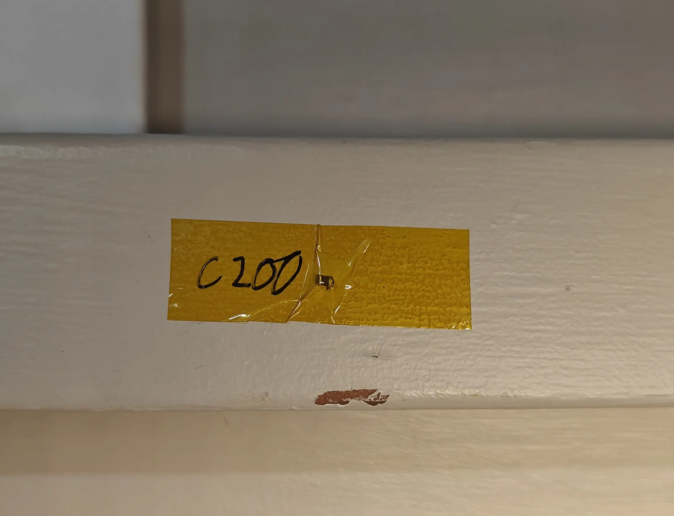

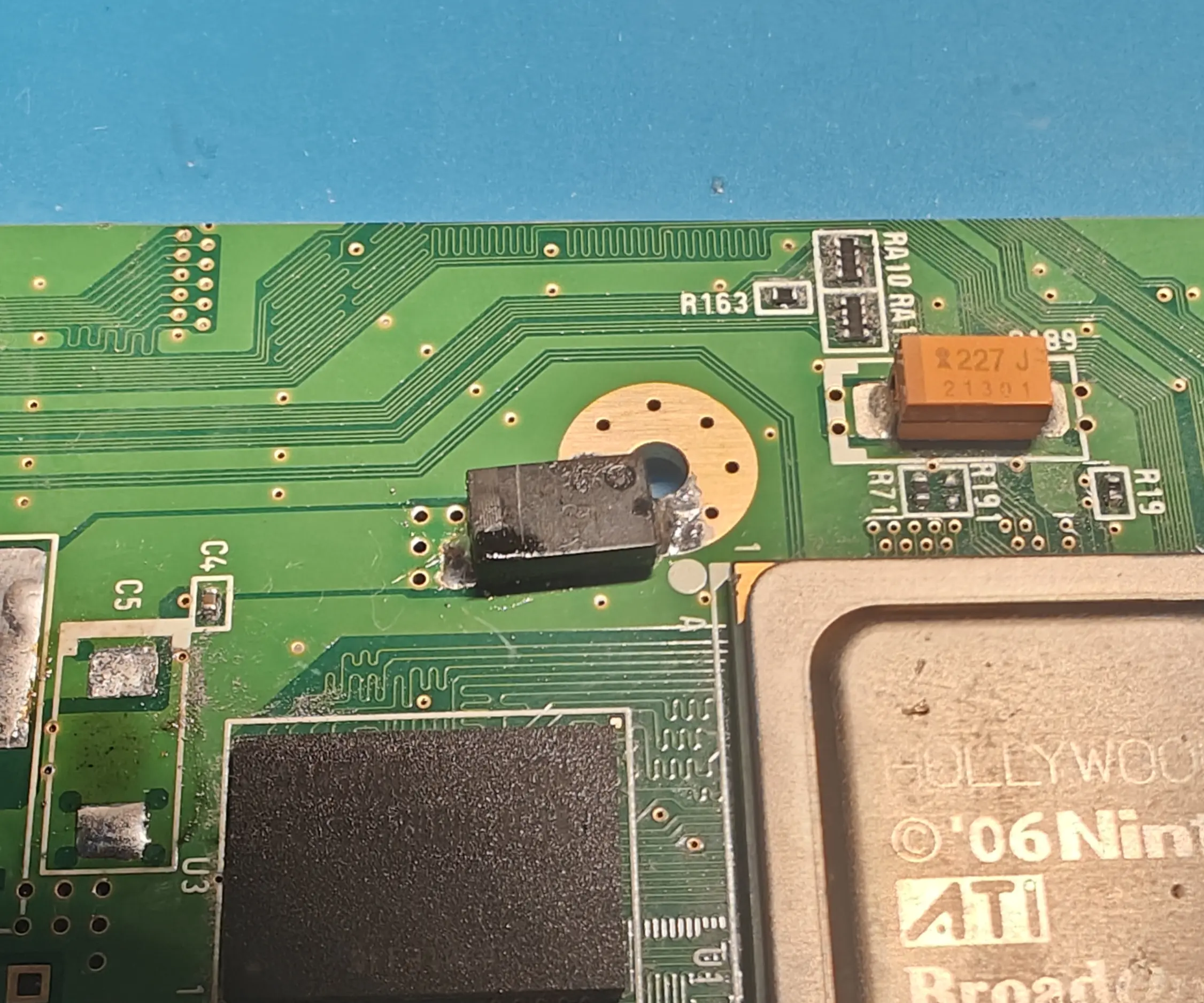

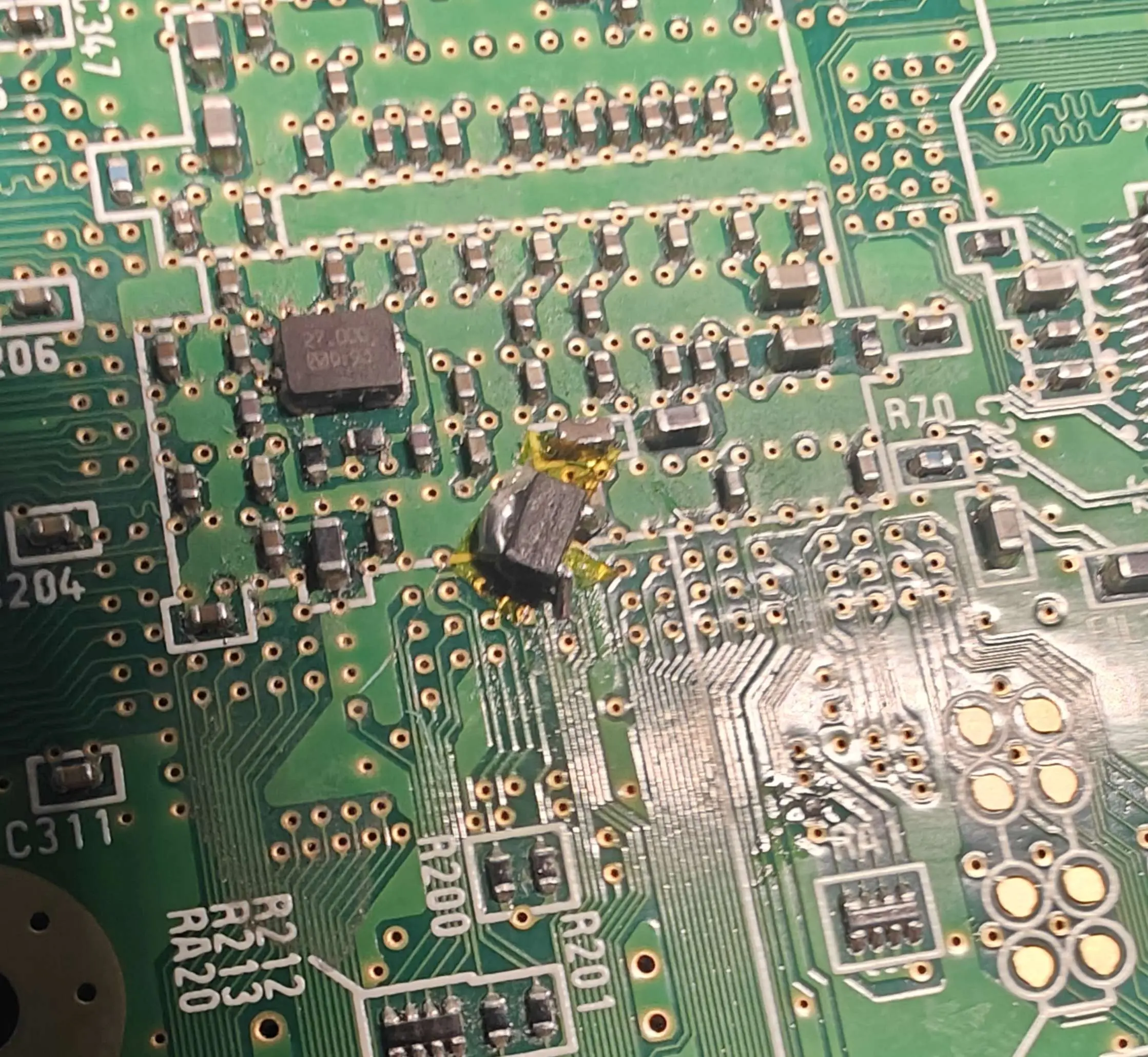

Right now I have step one complete. I have a working OMGWTF running off a pms 2. The only steps I've done towards a further trim is relocating the u10 to the back of the board based on a picture I found. I checked continuity and stuff and everything seemed like it would work and sure enough, it still booted.
The other thing i’ve done is move C5 to the right.
I’ve seen this in many omega photos, so i was pretty sure this was the right thing, until i saw this thread https://bitbuilt.net/forums/threads/life-goal-trim-an-omega.4533/
Where sparklebear relocated c200 from the back of the board to the same spot that I put c5 on the front of the board???????? It seemed to work for him, and c200 seems to do the same thing as c5 with one end connected to 1.8v, and the other to ground. But shank’s wii super thread says that they have wildly different capacitance values. Other trims seemed to have removed c200 entirely, so i tried removing it and keeping c5 intact, and it still boots. So is c200 needed at all? Or will this cause problems later on? This is still a mystery to me. For now, c200 lives on my wall where it cannot be lost.

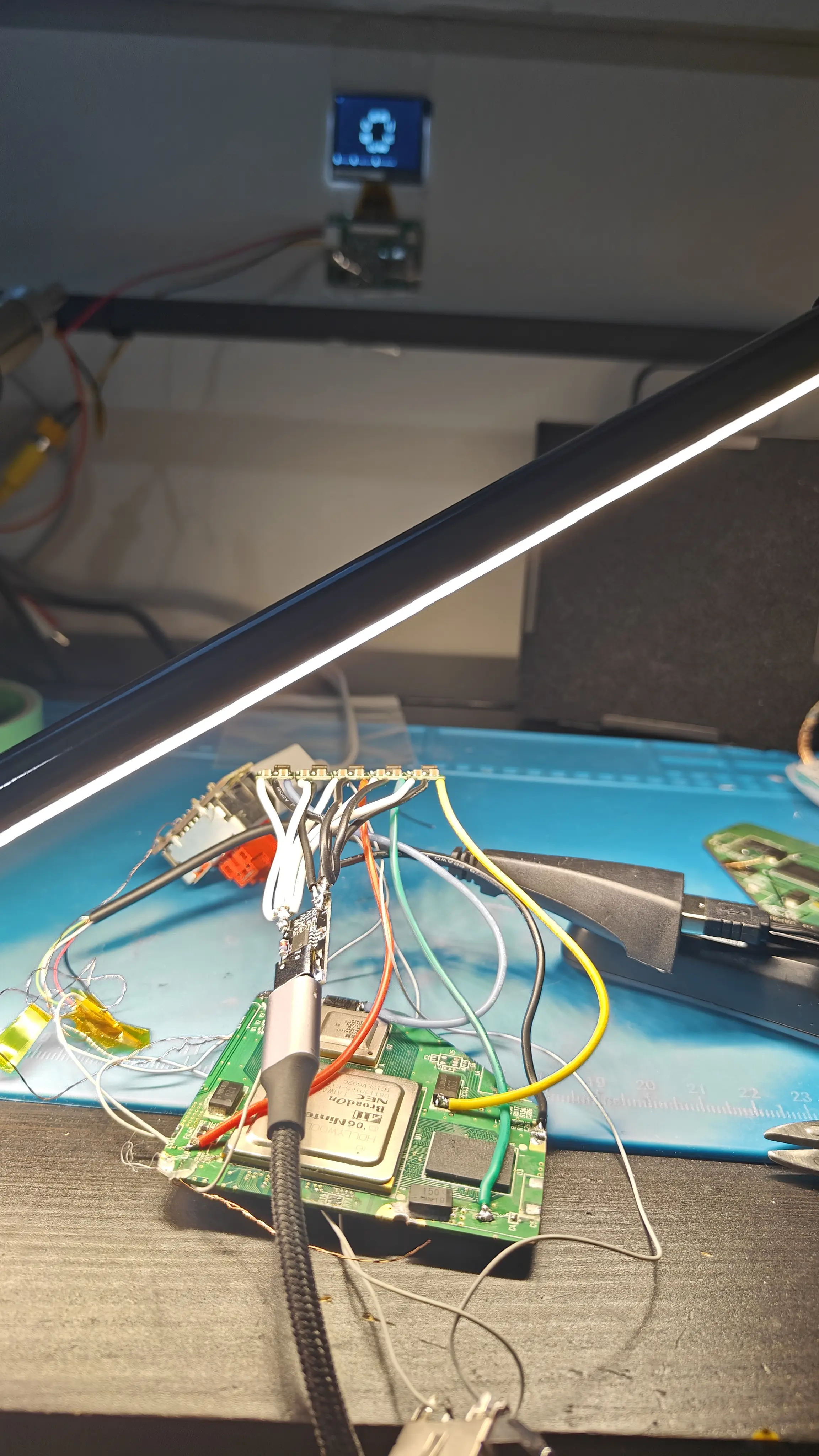

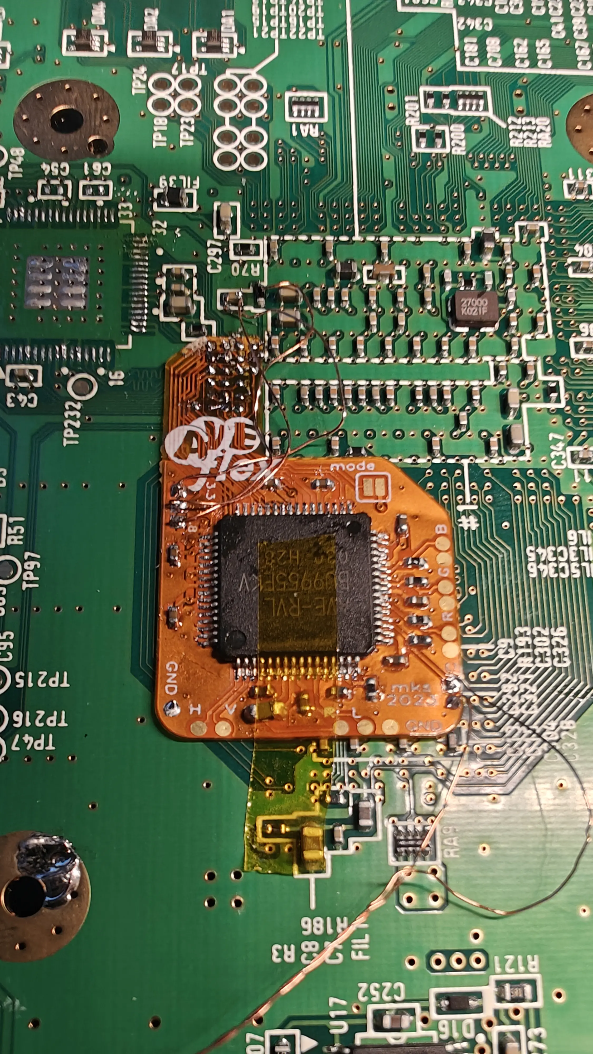

About 3 or 4 days ago I got my order from flashfi.re with my av flexs and reggies. I pretty quickly started work on removing the AV chip from my omgwtf trim. It was really difficult to get the av chip off. For my first 2 attempts, I preheated the board for 3 minutes, then hit the chip for 2 minutes, and it didn't work. Finally, on my third attempt, I spent a lot longer preheating and I did it with no nozzle on my hot air gun, I even hit it from the back, and that worked. Im still worried this killed the av chip though because after 2 days of meticulously soldering little resistors and capacitors (i had alot of stuff going on so i could only work for like an hour each day) i finally got the av flex assembled, and wouldn't you know, it didn't work.
What eats me up at night though is that when I did my first test, my av capture wasn't plugged in properly. So for all I know, it might have actually worked the first time, but I'll never know because I pulled a real bone head move and I think I killed the wii for good after my first test.
I was messing around a bit and found that the 1.15v rail was reading at 1.3v. So I desoldered all the voltage wired from the trim to test the voltages on my pms. But my dumbass forgot to turn off the pms when i was resoldering to the wii. So I soldered all the voltage lines to the wii while they were live.
Part of me doesn't even want to share that part because it makes me look like a real dumbass, but I figured I should share the whole process, no matter how inexperienced and stupid it makes me look.
After that, I wired up the wii with reggies powered by my benchtop psu and the voltage rails were fine. For all I know, the Wii is alive and well, but I think I'll try to figure out if it's truly dead later and move on to a new Wii for now.
Today I am going to software mod another wii I have. After that, I'm going to desolder the av chip from the board and solder my av flex onto it. I’m going to do this all without trimming the board so there is NO chance of my f%$*ing up the voltage wiring.

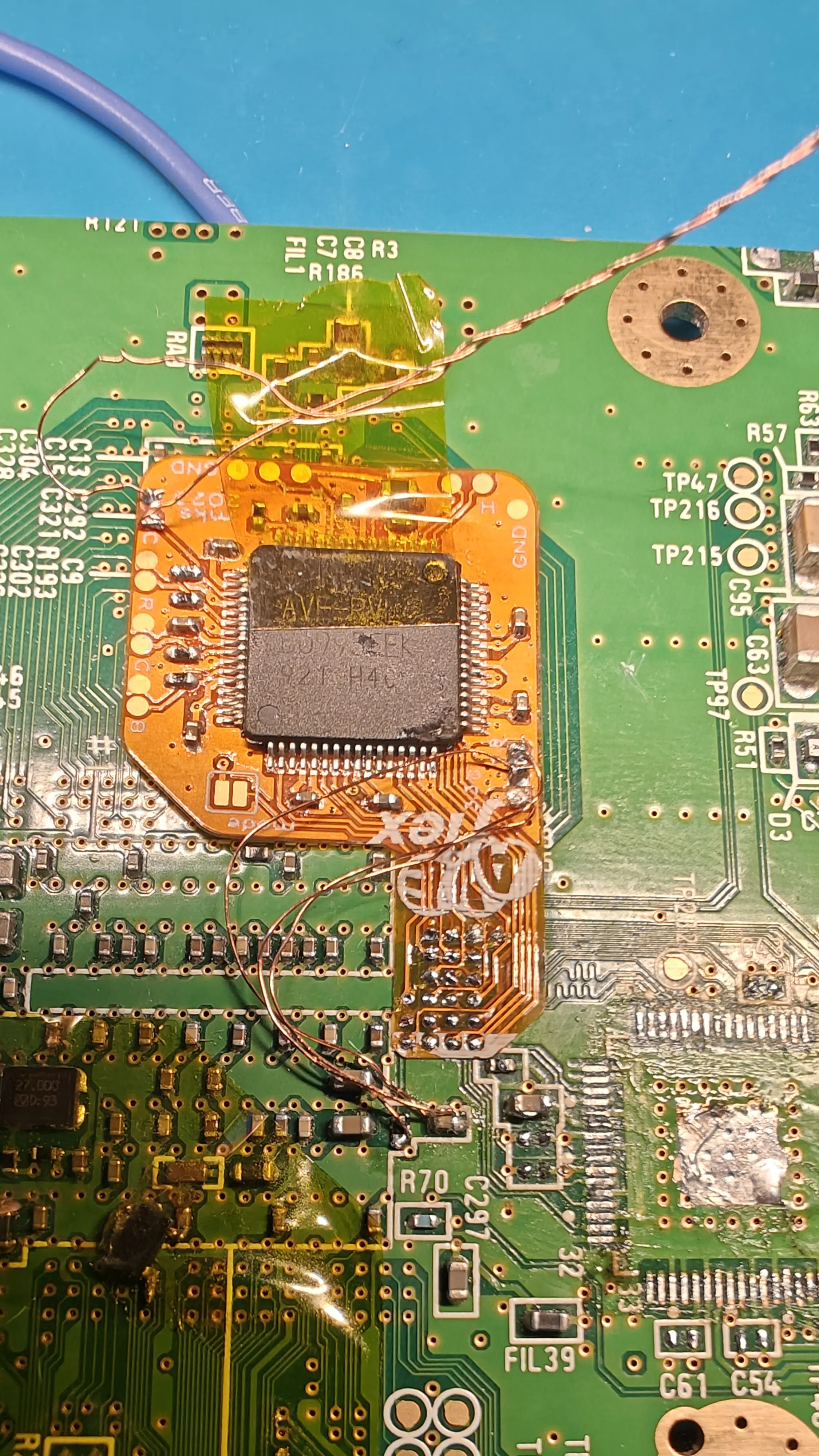

After my last update, I did some more fiddling around. I desoldered the av chip from the av flex and resoldered it onto the trim, and somehow it worked. The trim was back to being functional. My screw up with wiring the voltages did not kill it! However, after i desoldered the av chip from the board and put it back onto the av flex, it still didn't work. Lost on what to do and knowing that I'd probably have to start on a new wii, I soldered the ac chip back onto the main board once more, and it was completely dead.
I didn't work on the project for another 2 days just from lack of motivation. But after work yesterday i finished softmodding another wii, took it apart, grabbed my second av flex, assembled it, and relocated the av chip without ever trimming the wii motherboard. At first, the video feed was green (see image) but I didn't care, at least I had a video feed this time. And this morning I managed to fix the green tint by changing where I connected ground to the flex.

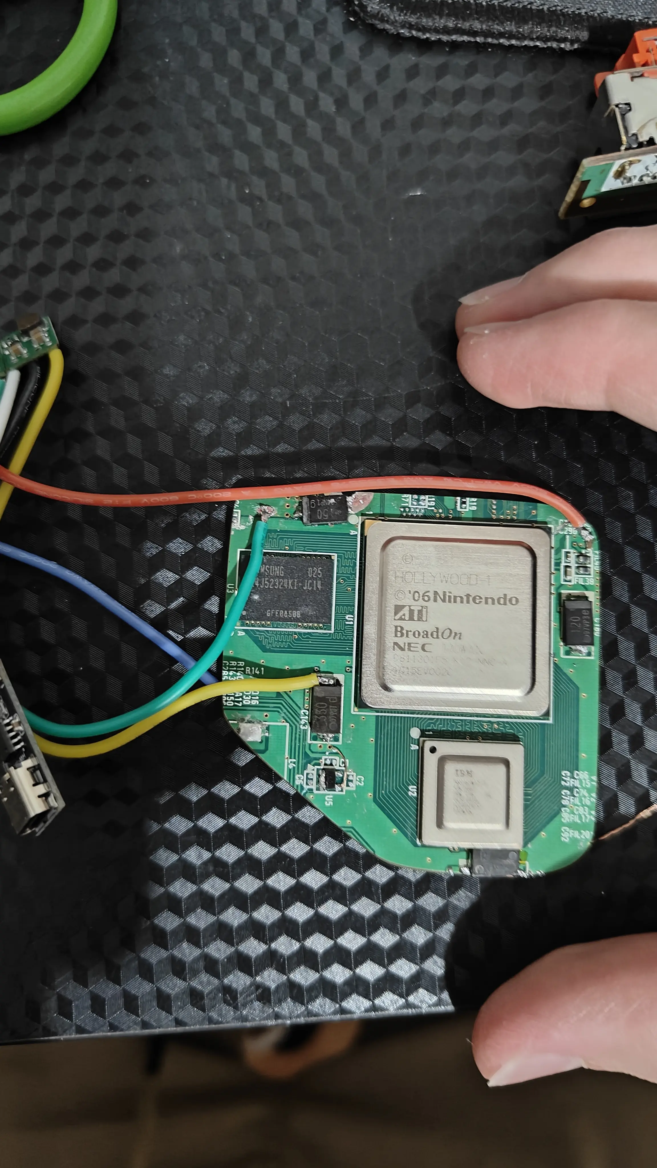

Yesterday marks the day that I successfully fully omega trimmed a wii. Before I get into my process (without giving away too many details) I want to give some thanks.

Next was the scary part, trimming. I first trimmed it to OMGWTF, and it booted. So then I trimmed it to a very conservative omega. Most of the av region was trimmed off, and all of the nand pins were trimmed off, so I’m still calling it an omega.
After one unsuccessful boot, I added more solder to the 1.15v connection on the tantalum cap, and it booted!

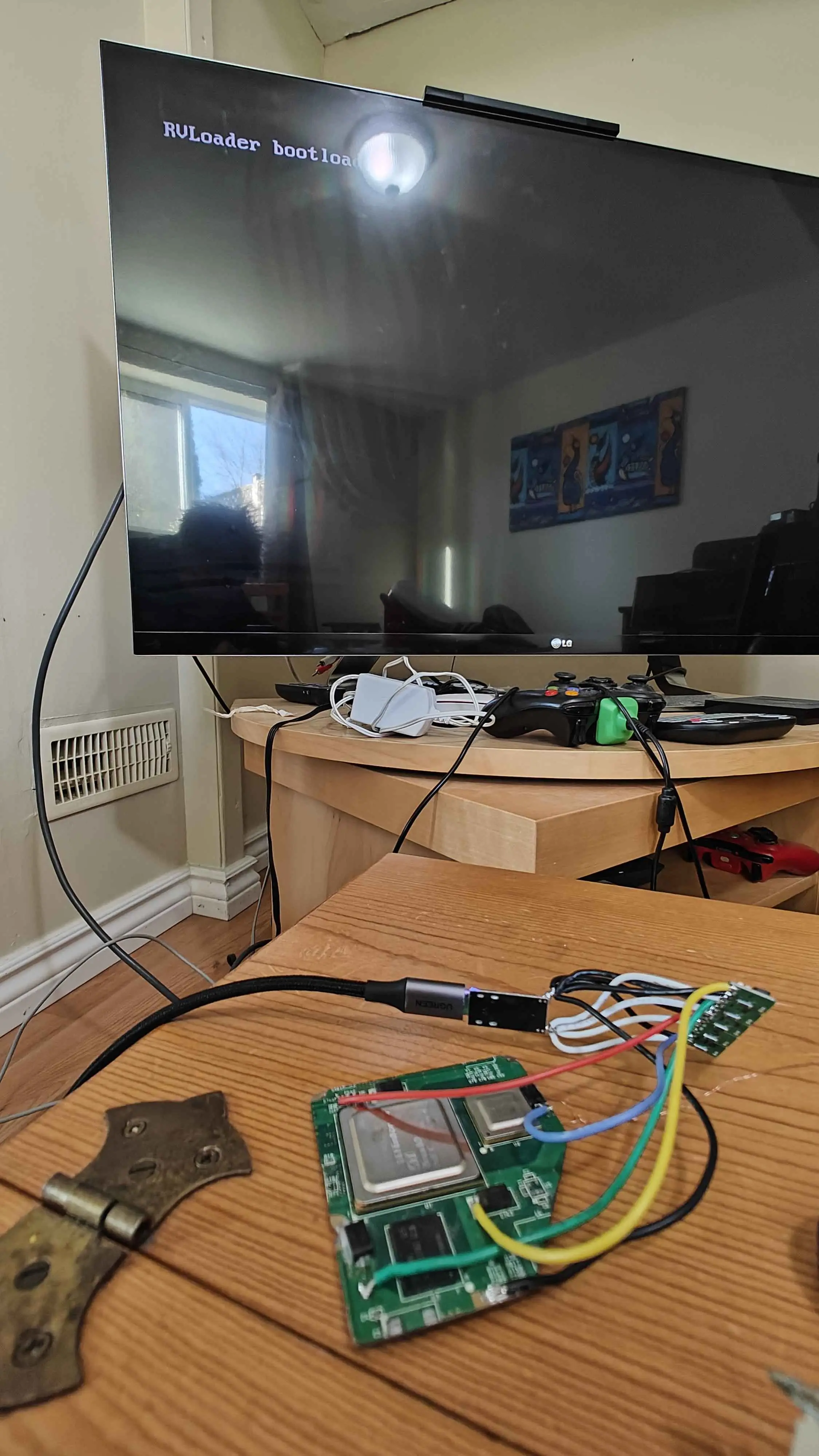

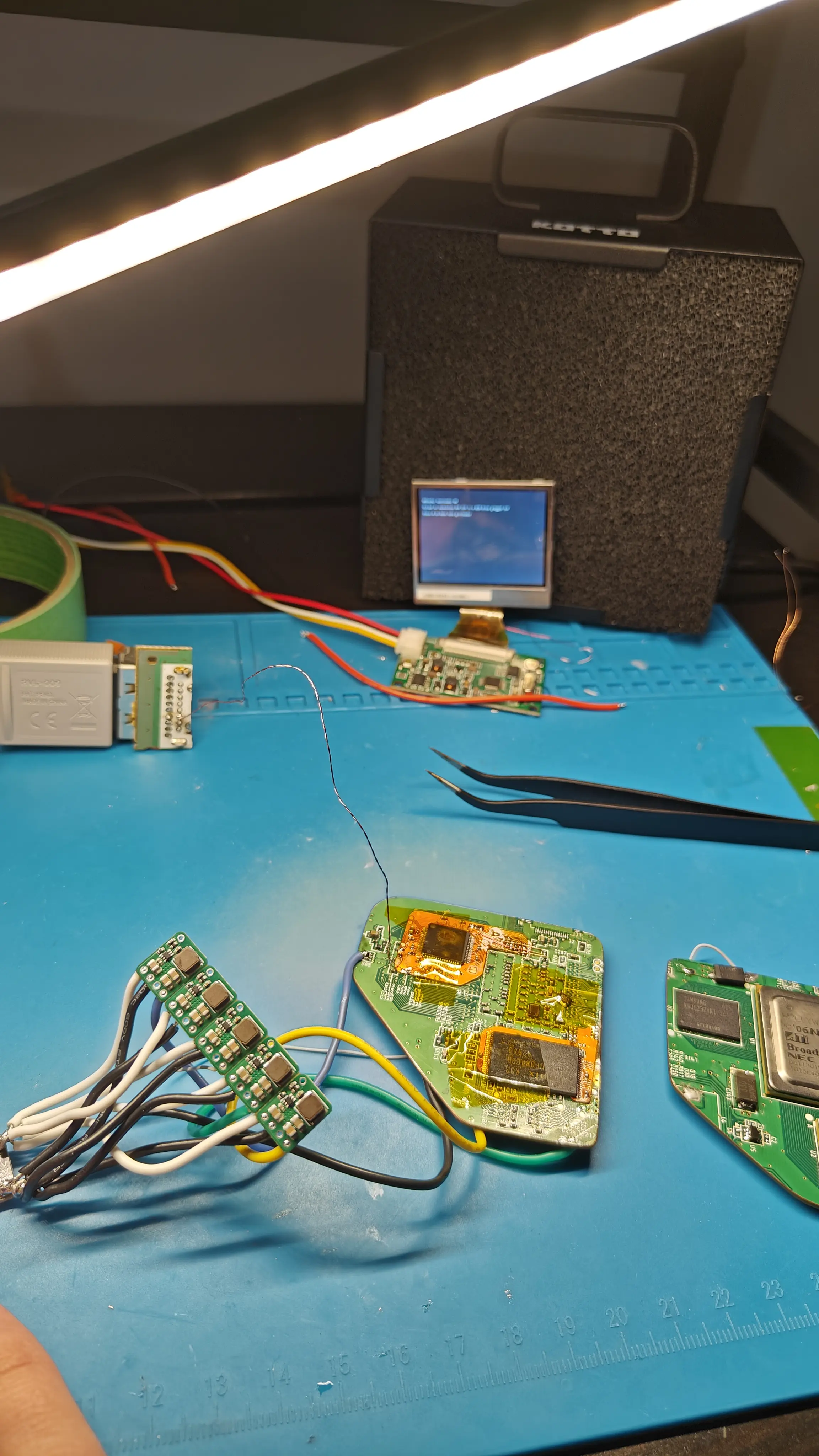

(the only composite screen i had lying around was a 2 inch one that i was going to use for a raspberry pi portable, but you can still see in the image that it has booted into rvloader, and the c stick radial menu has popped up, showing that usb and controller are both working)

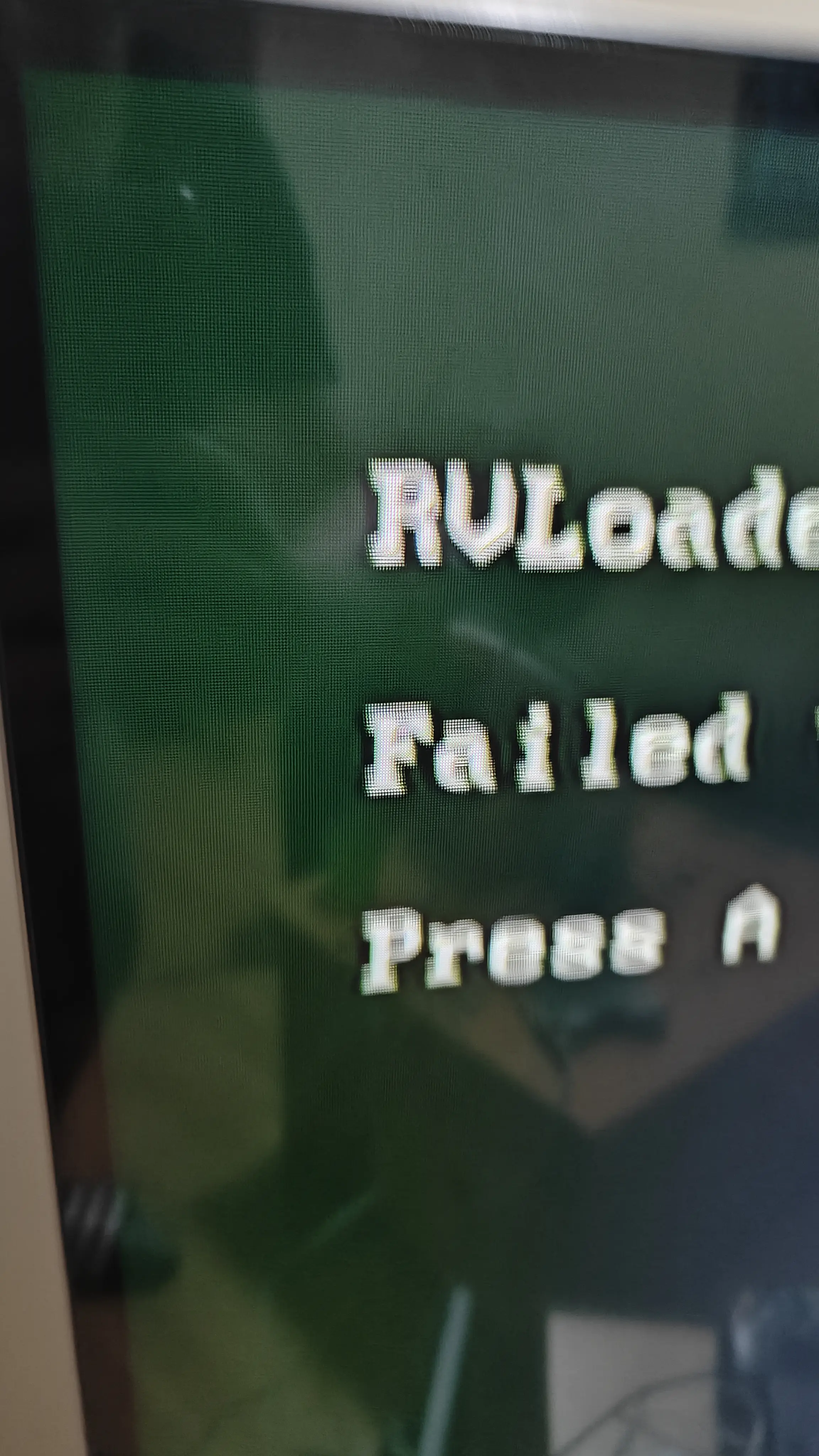

It is probably not dead, the trim still looks fine. When you sand or trim further, any cold joints are likely to pop off. The power and grounds on your AVEflex look suspect I would reflow those. Also check closely around the edge for areas you need to resend. Also check if all the vias on your nandflex are still making clean connections. You got this.
Before I sanded it further, the trim was already feeling pretty sketchy. It would only boot 3 out of 4 times. Sometimes I would apply power and id get nothing at all on screen. I'm worried that I bent the board a bit by accident while I was holding it to sand it. But I will go and check all the power wires for the ave flex (although I did already check voltage to it, and it was getting voltage when I applied power to the trim) I sanded it like 3 weeks ago, so I've already come to terms with it being dead. So if I can't fix it I won't be mad. But you have given me hope.

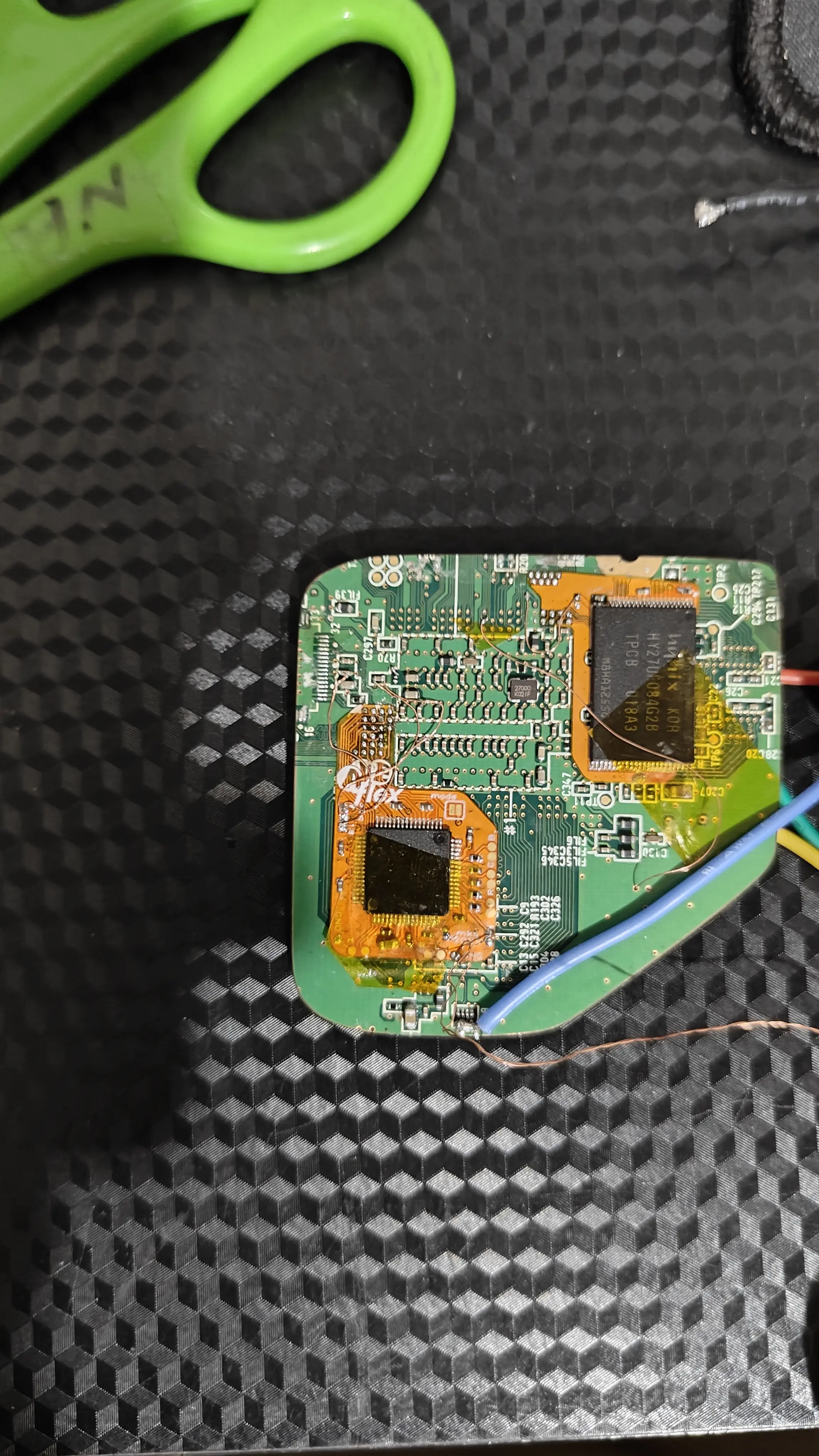

Literally nothing went wrong with this trim. It felt like a miracle.
I built a whole new av flex from a confirmed working av chip, soldered it on to my broken omega, and still nothing. So I transplanted the av flex onto an omgwtf, and it worked first try. Then I moved the nand to a flex and it worked first try! Then I cut and sanded it to the size I wanted, tested voltage resistances a bunch, and it worked first try!!!!!!
I feel like my soldering has improved so much from assembling all these flexes, and my knowledge of the Wii motherboard has also improved a bunch. So, I think I'm going to call this thread done. I achieved my goal of making an incredibly small omega trim to fit in a project I'm working on. It took a lot of time, and a couple month-long spells of low motivation, but it's done. I officially have a working omega trim that can fit inside an...
