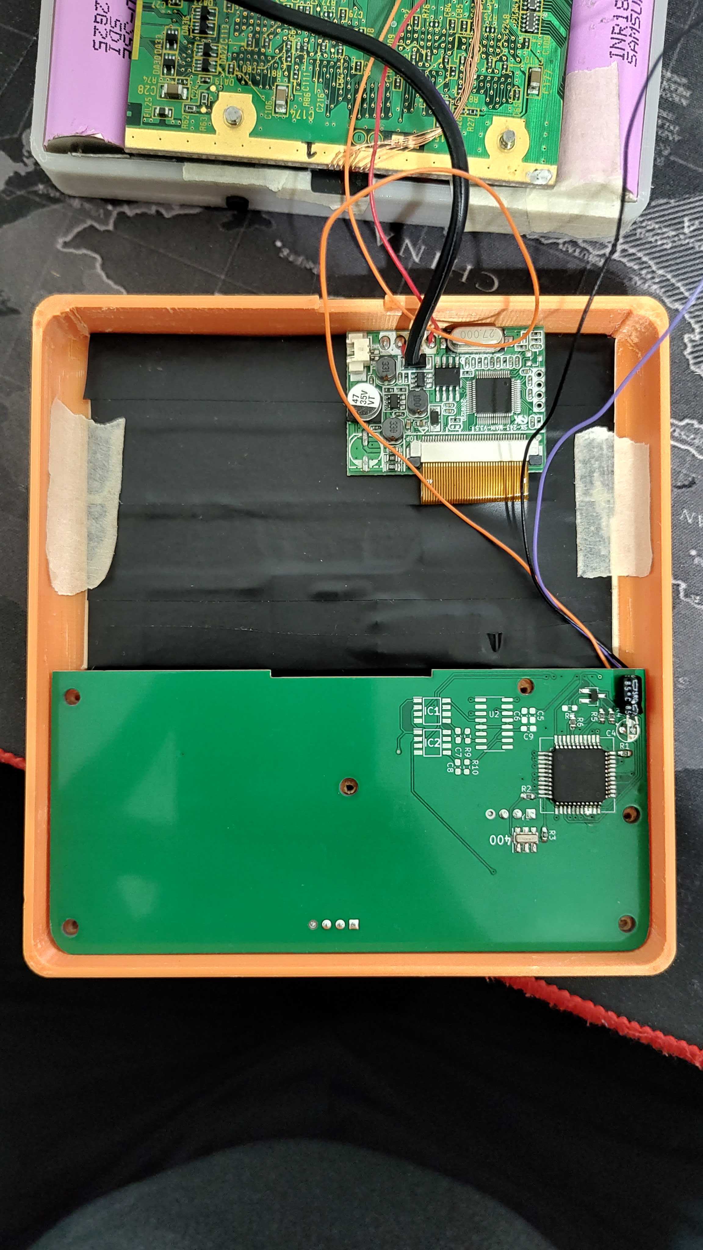

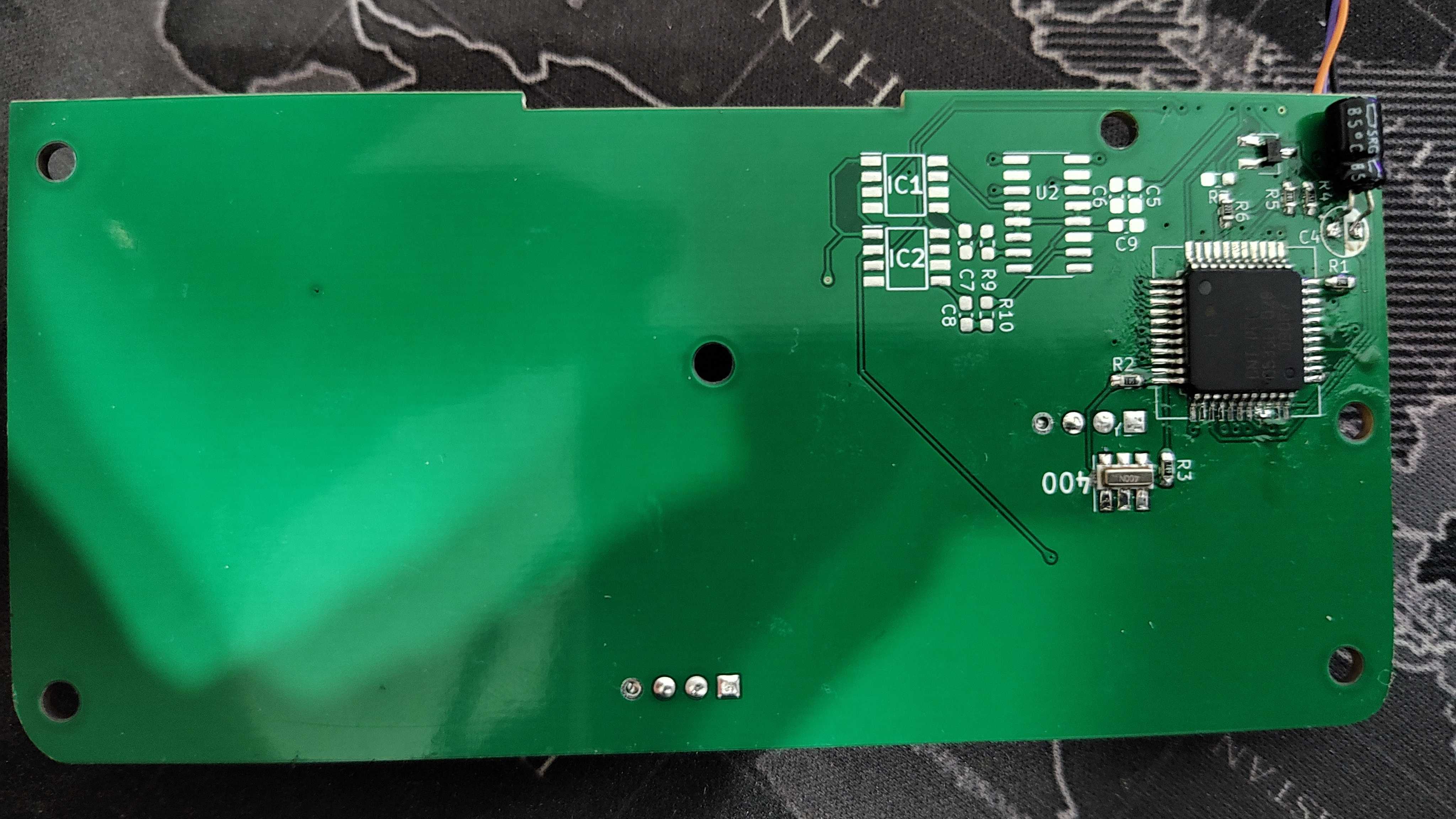

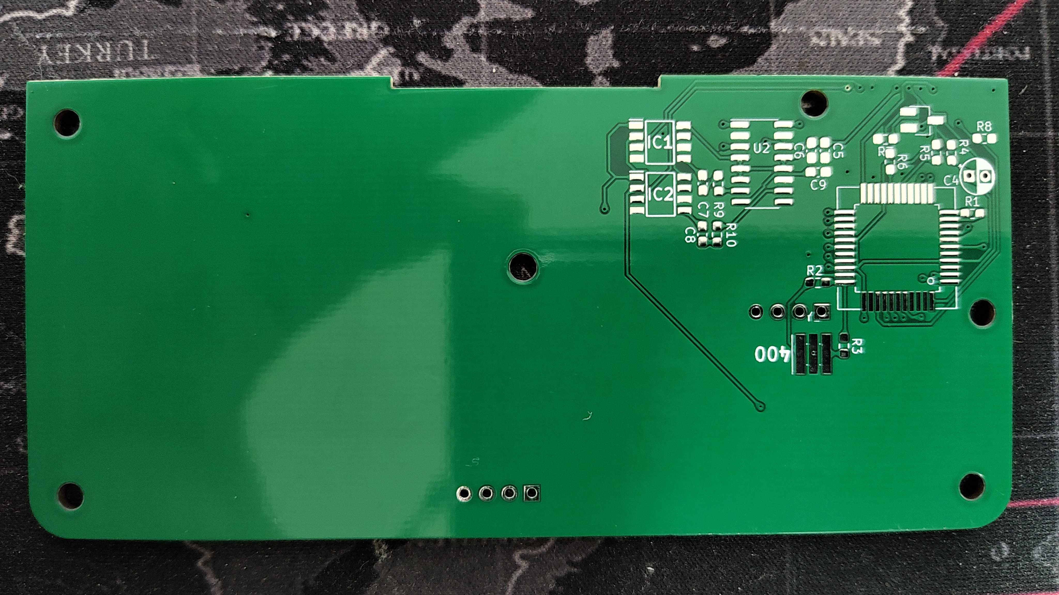

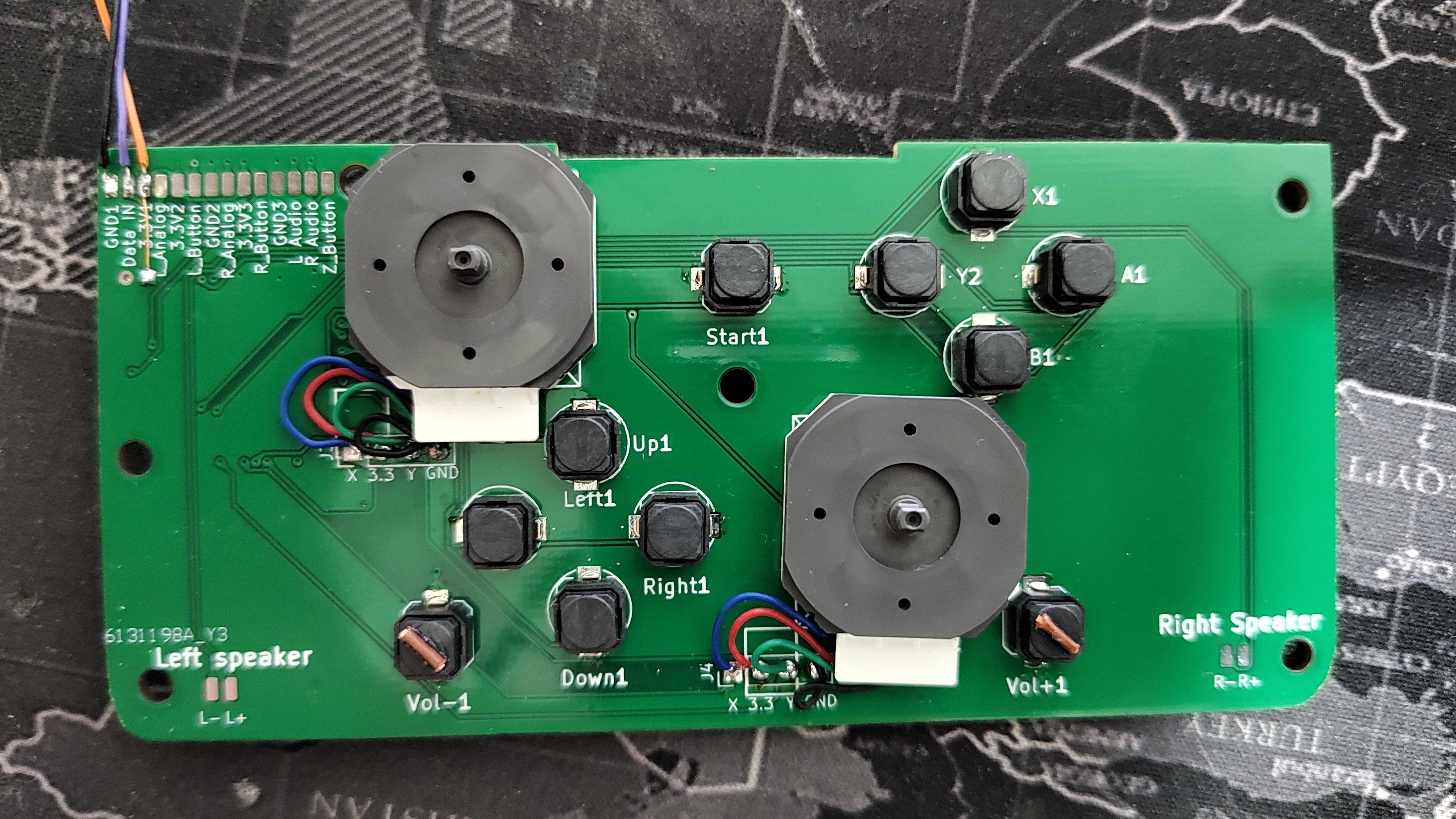

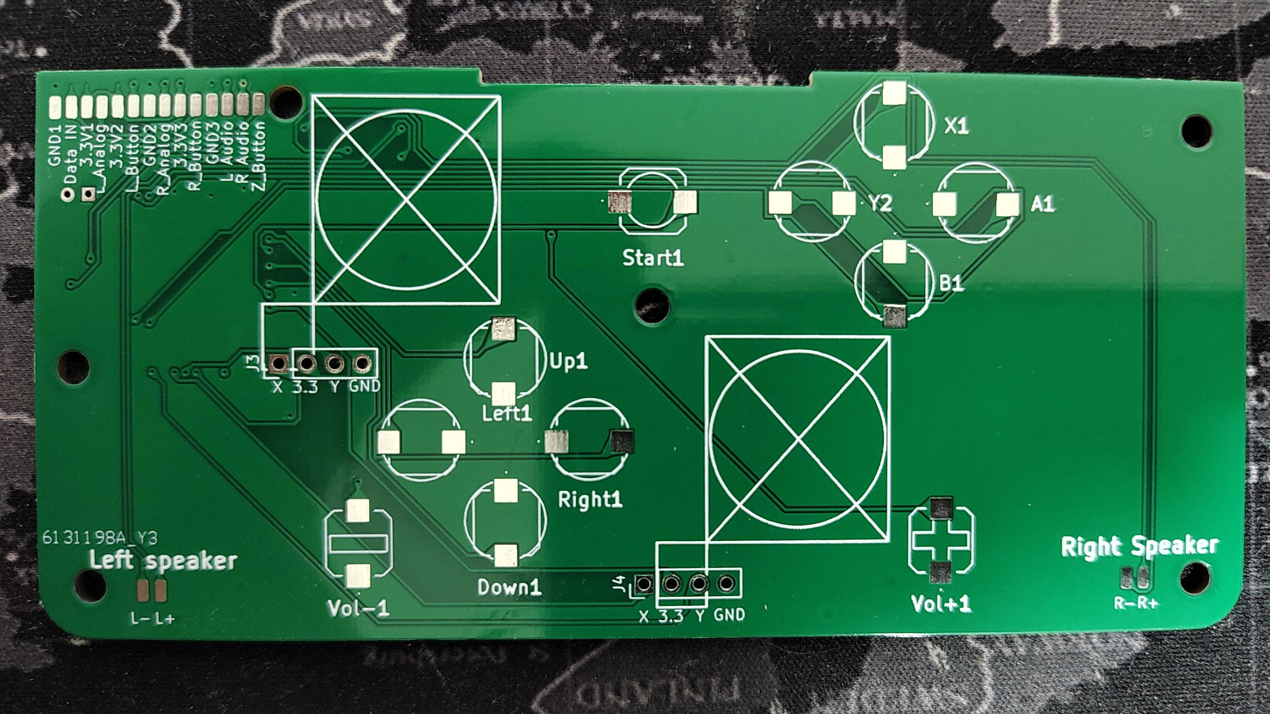

Hello everyone. I have a big update :awesome:
I've received my boards for the controller and audio on saturday. To be honest, i didn't had much hope as this is my first custom pcb ever and I felt it was pretty big of a project. But to my surprise, the controllers worked perfect first try, I can't tell you how excited I am.
It's amazing how little stuff you need to make the stock controller IC to work
All the mounting holes are aligned and the recess I made for the 3ds sliders worked awesome. I'm very impressed of myself lol
I'll solder and wire up the audio part between today and tomorrow. I hope I have the same luck as the controller part haha

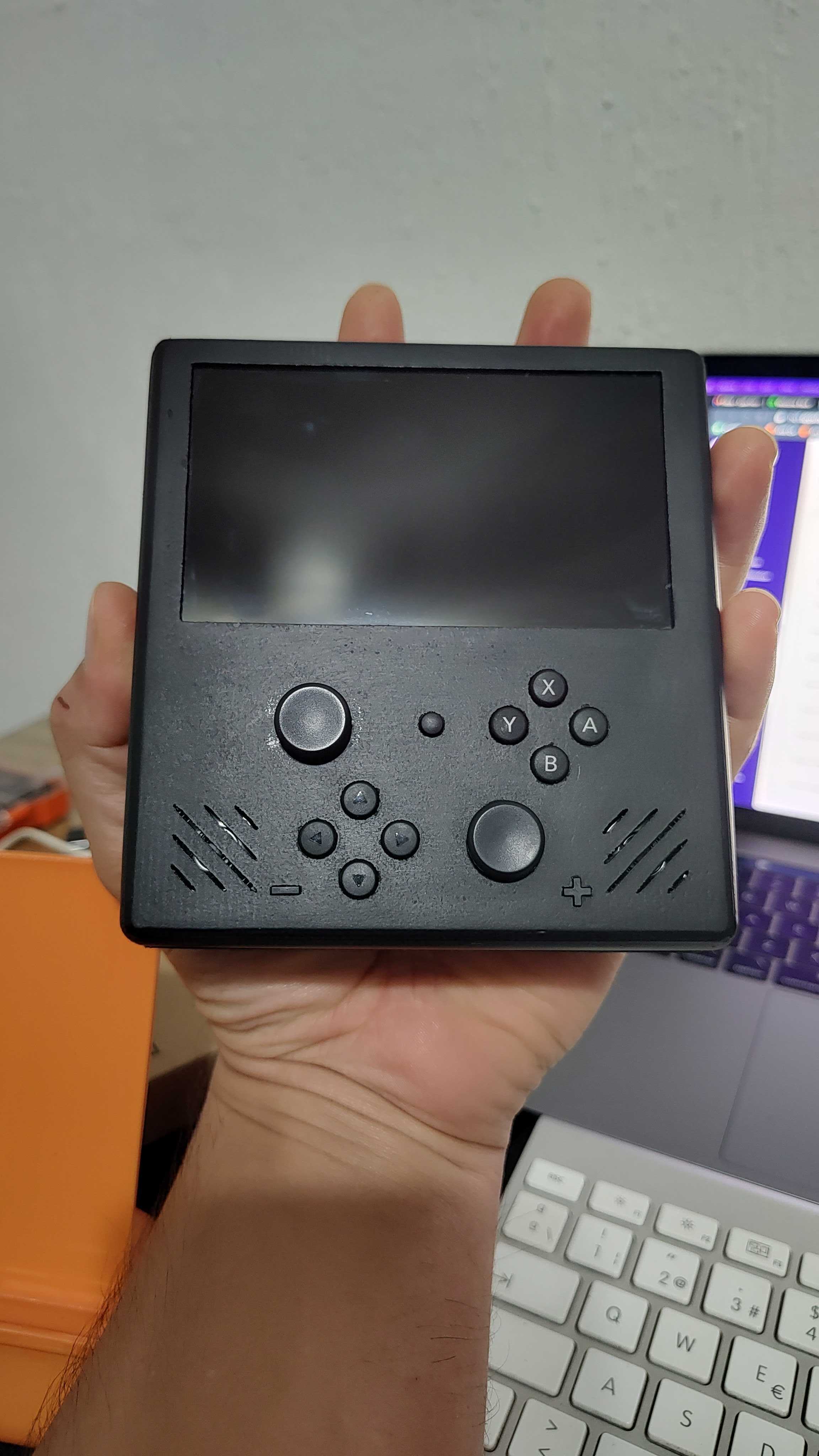

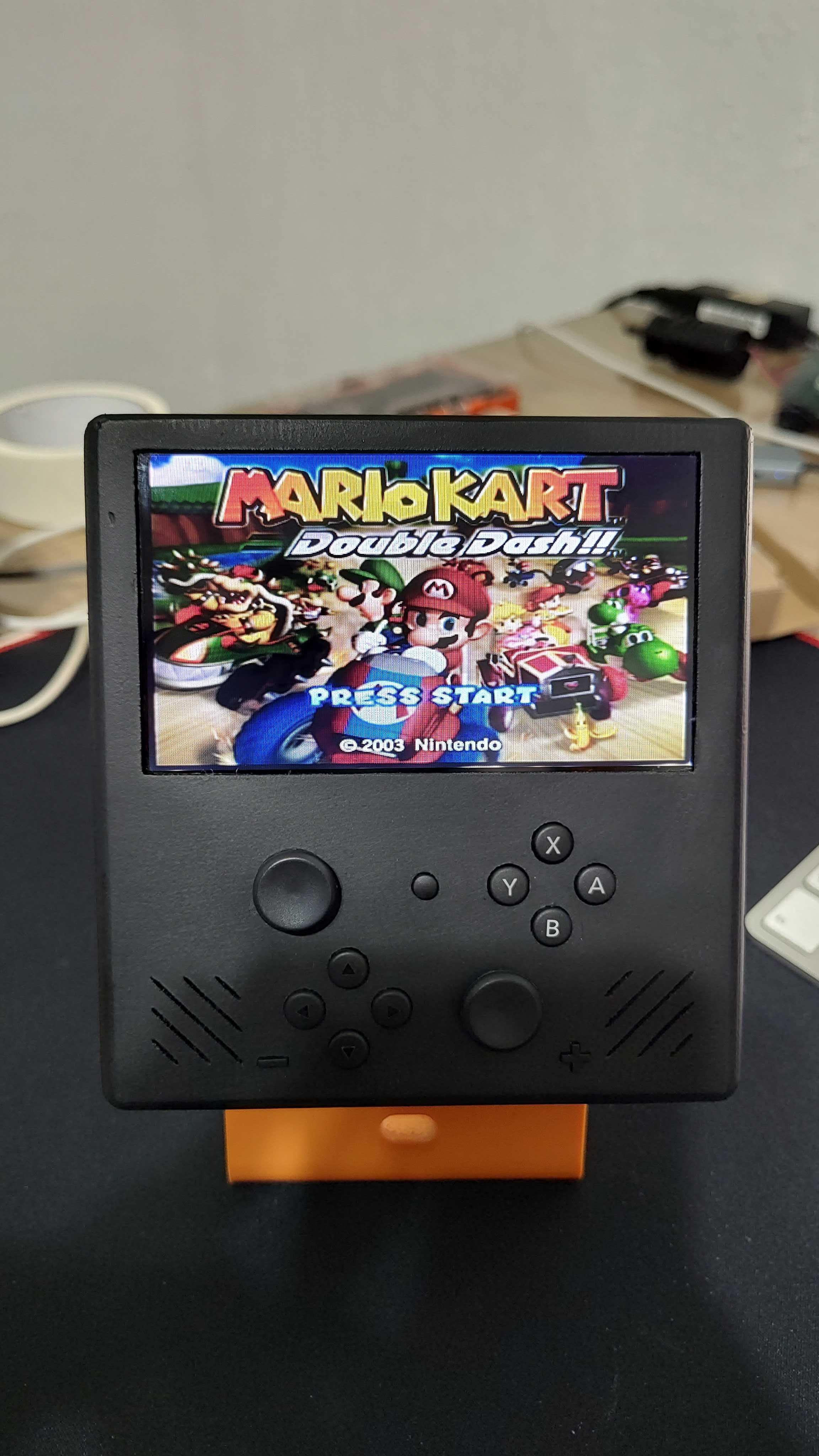

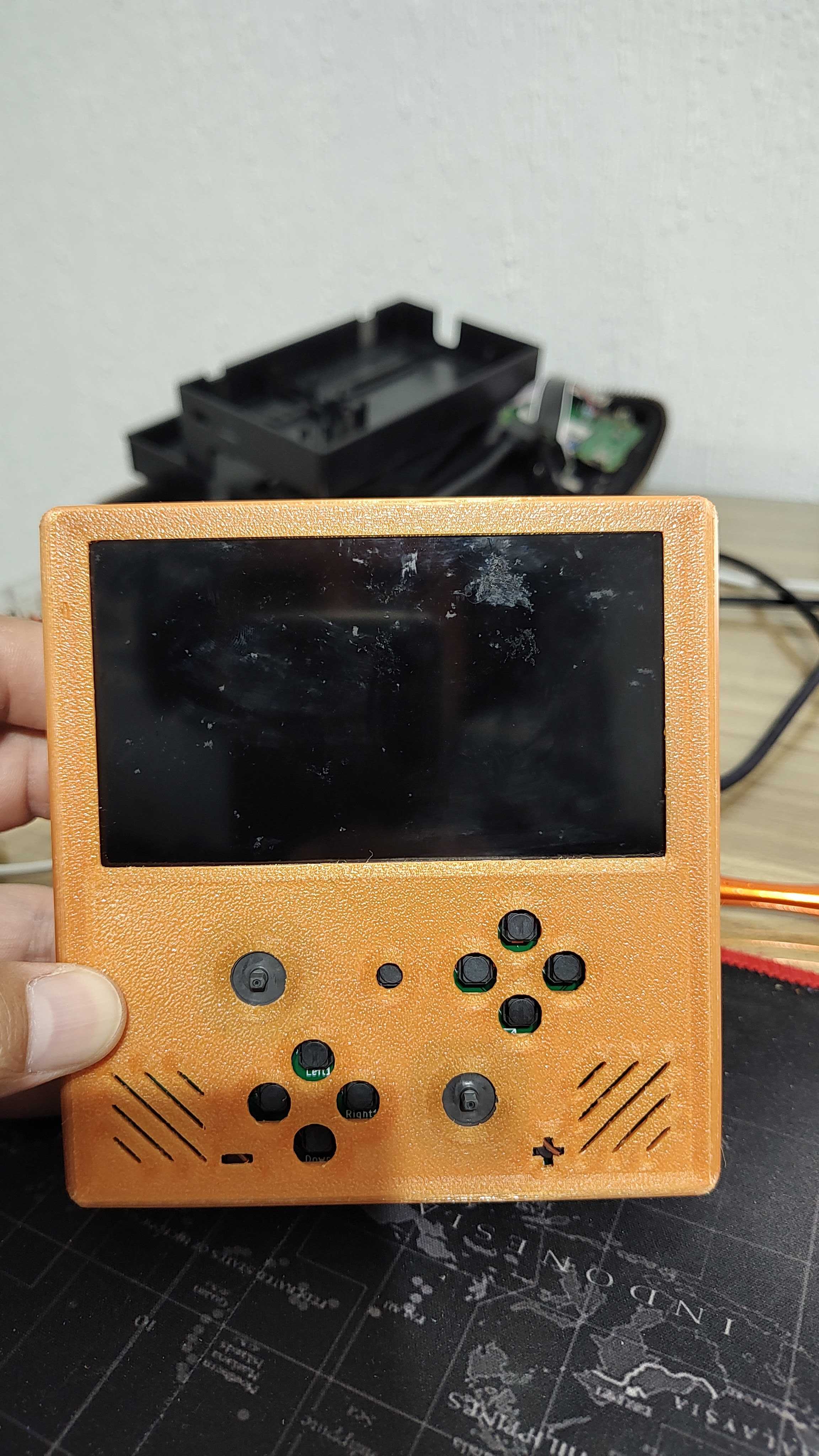

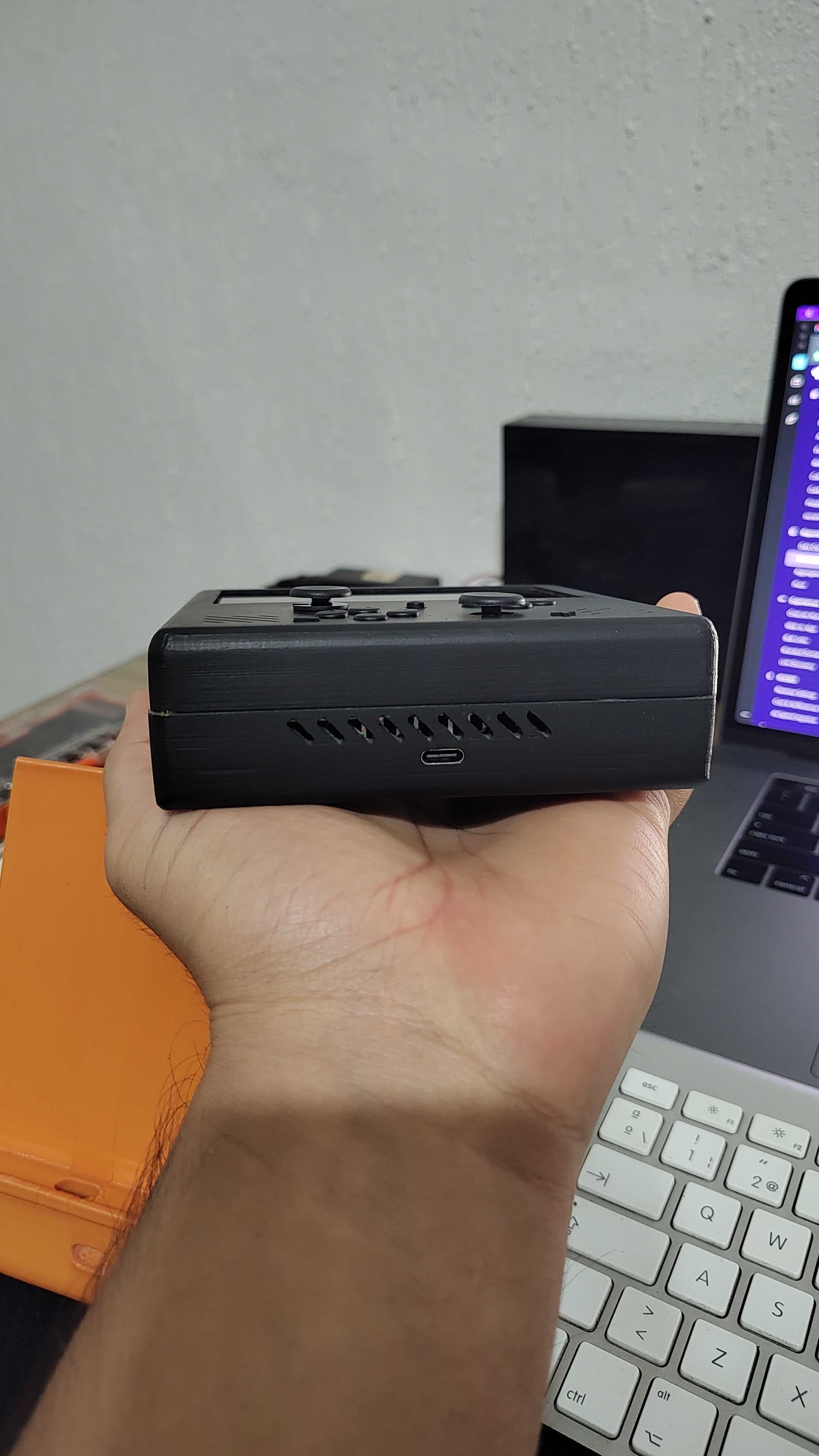

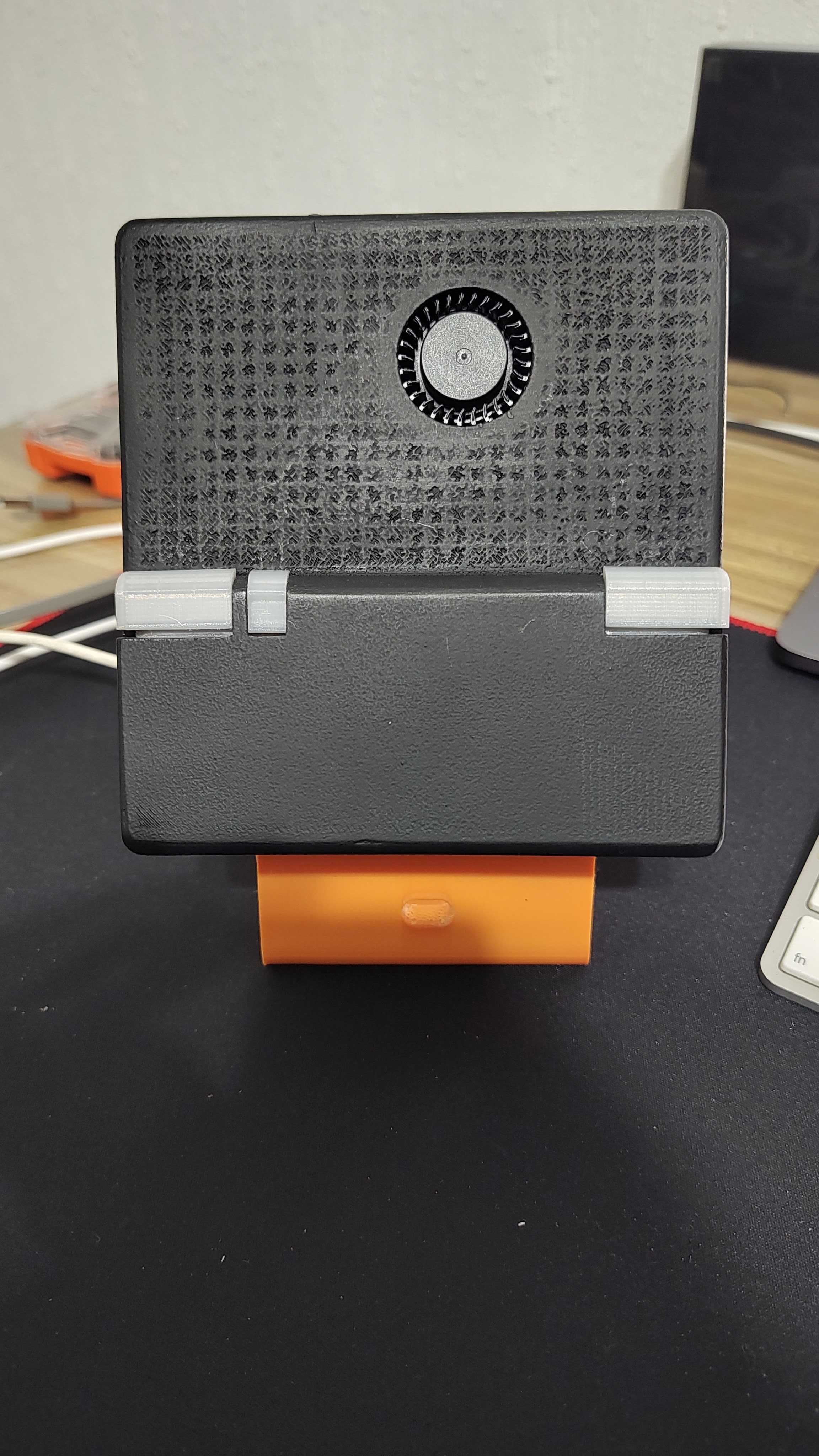

Hello everyone. I'm very happy to announce that i've finally finished this project.
My battery chargers finally arrived and was able to solder and test them, here's the final product:
In my hand for size reference:
Here's a quick video:
Edit:
Although I really loved the finished product, here's a few things I'd do different...
  1. Place the regulators in the fan path so they can cool down
  2. Redesign the L,R and Z triggers, they were very hard to make them work
  3. Add a bluetooth audio transmitter
  4. Use li-po pouch batteries, they are much easier to work with.
  5. Place the pads for the controllers and audio on the bottom of the pcb for easier assembly
