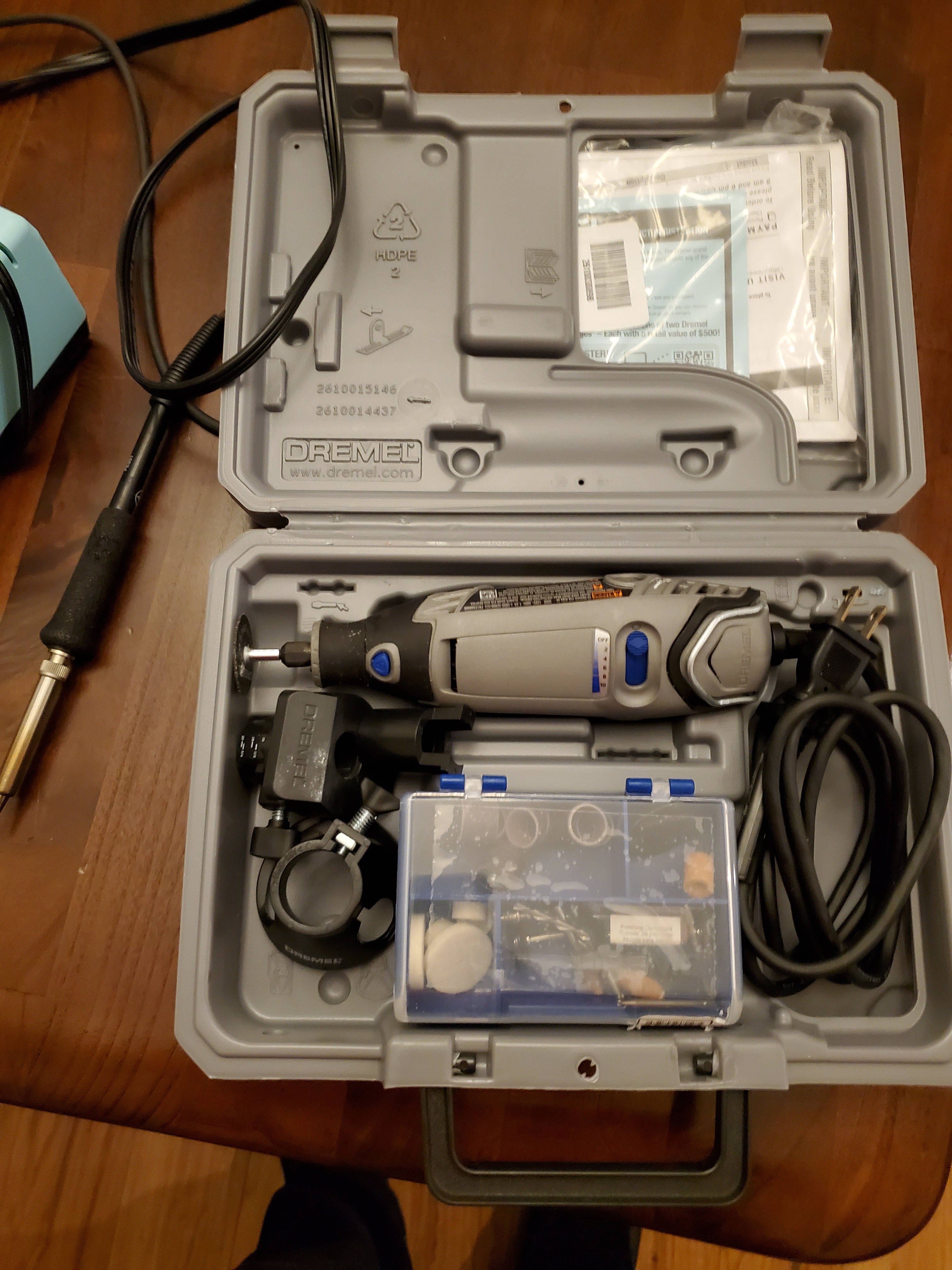

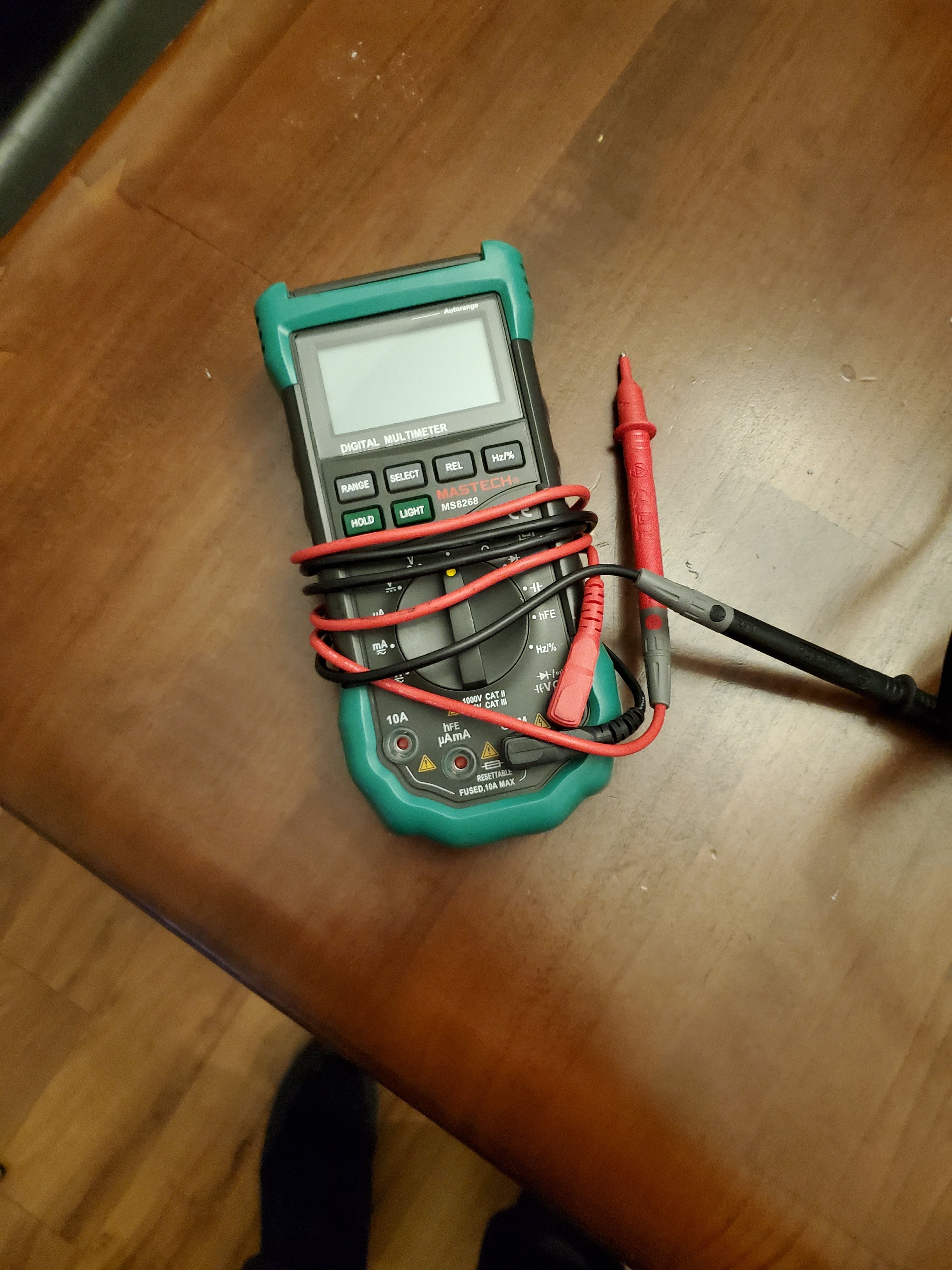

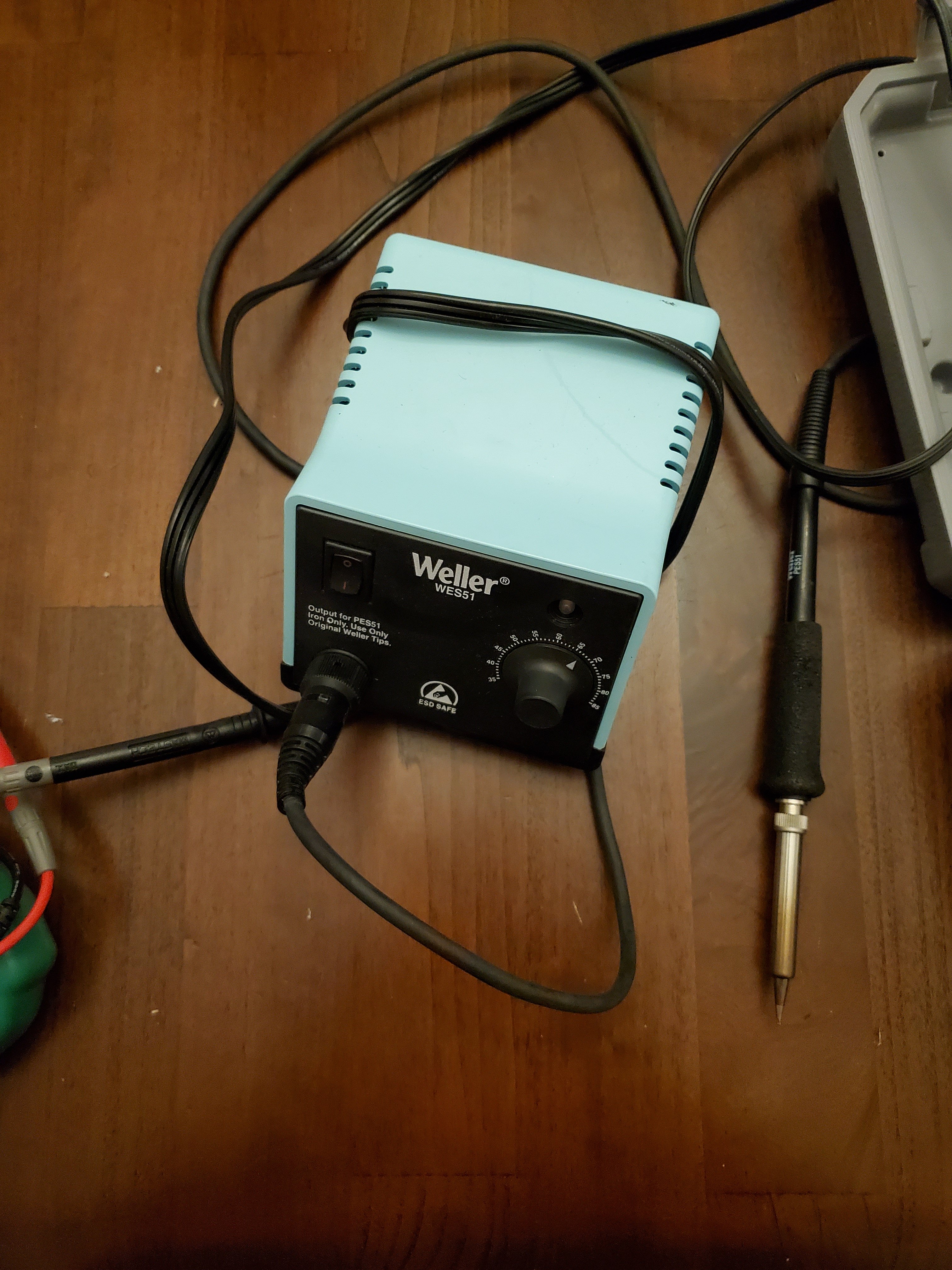

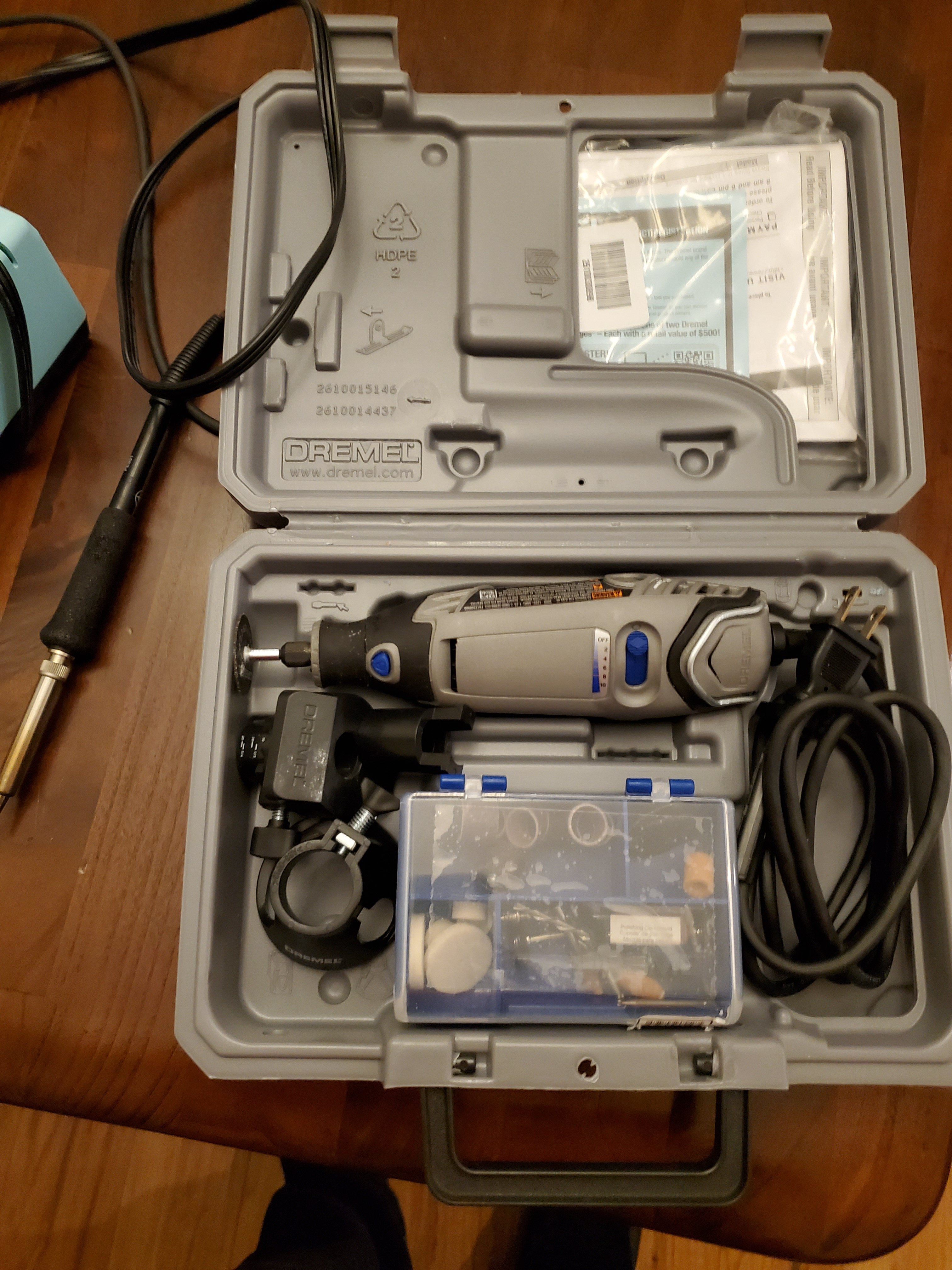

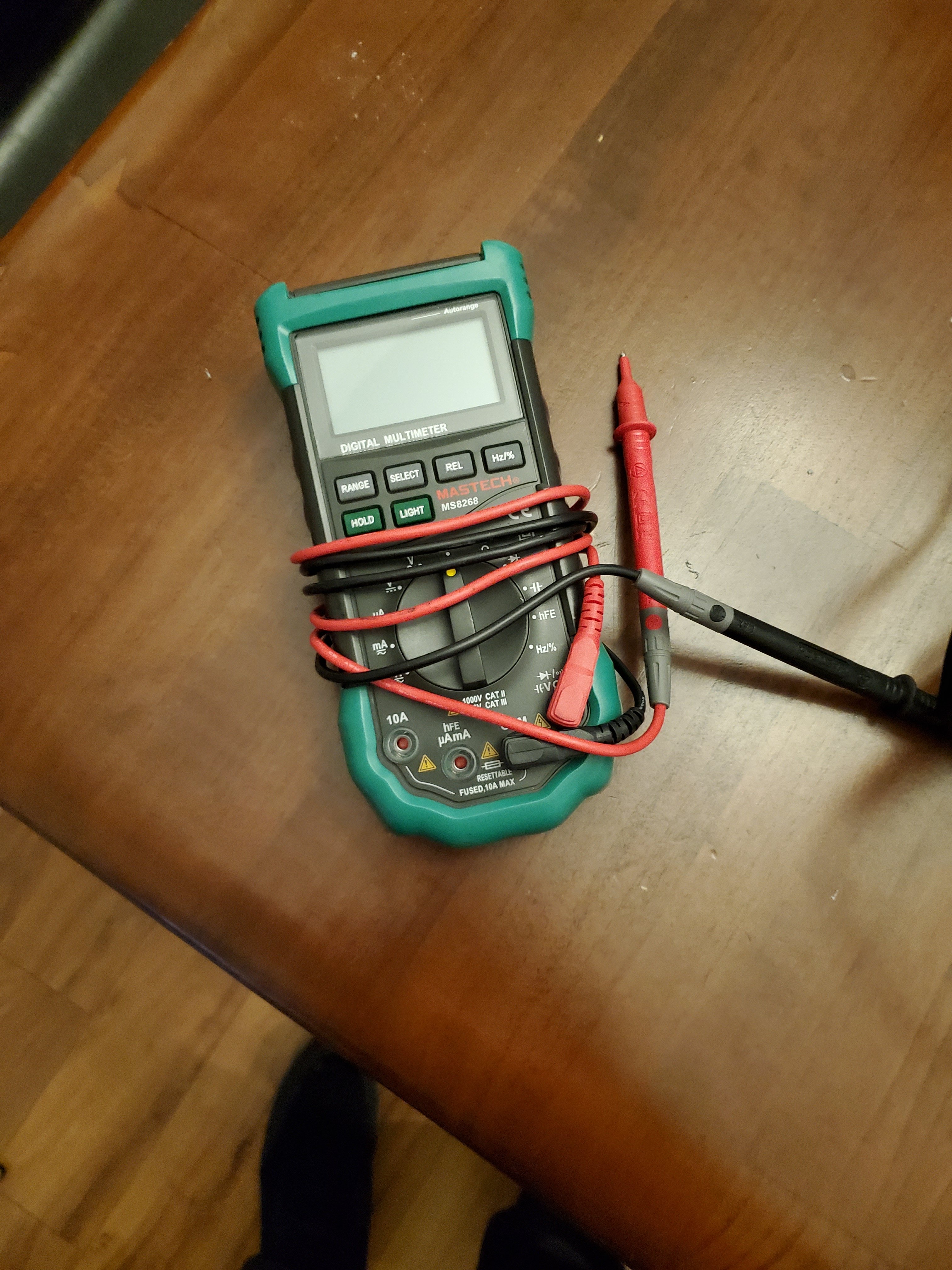

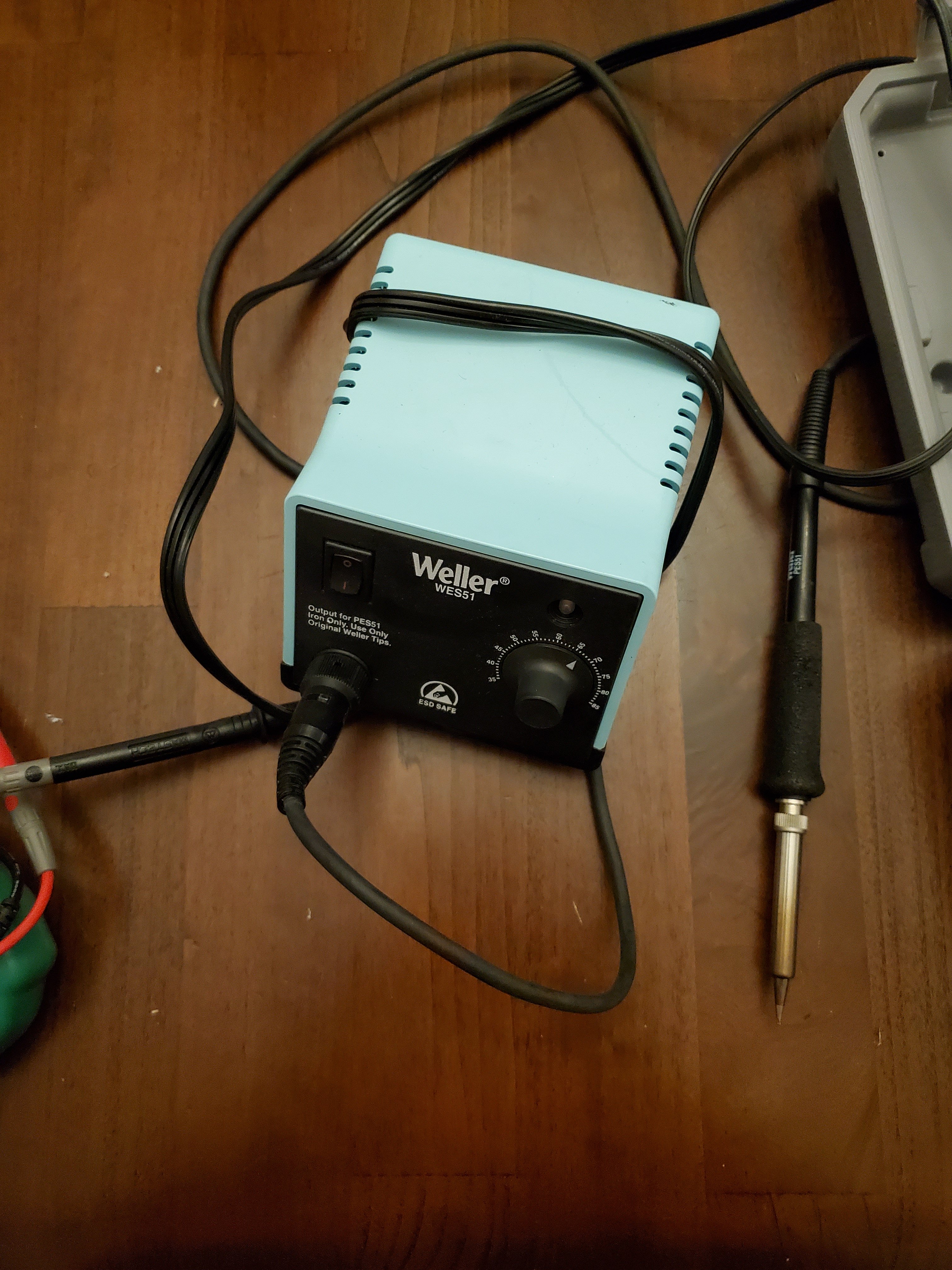

Which soldering iron and multimeter do you have? If they aren't great we can suggest better ones, since those can easily ruin boards if they aren't good enough
heres my soldering iron and multimeter and apperantly Dremel I forgot about not sure if they're good or not but hopefully they are.
Also after next I'm going to get myself a 4 layer Wii and install portablize Mii. Probably after this I'll begin trimming getting parts etc.
View attachment 10190 View attachment 10189 View attachment 10191
Hally-fukken-looyah some good tools for once, those will do you just fine. I recommend using the thin cut EZ-Lock Dremel wheels when trimming the Wii, I find they jump about less.
