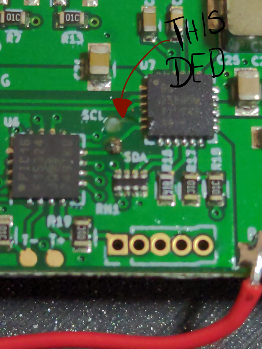

No worries, at least you asked before doing what I did in the picture lol
