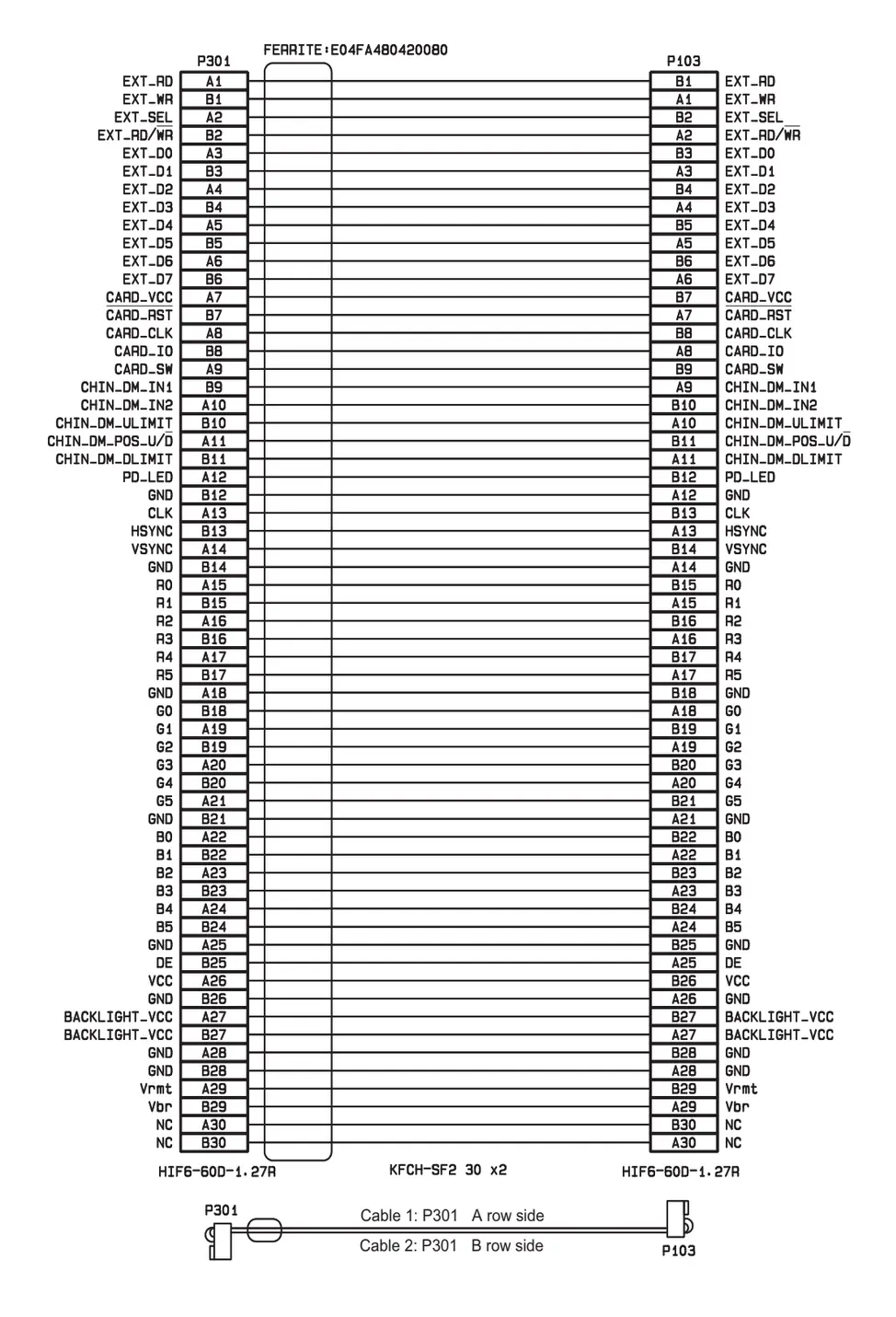

There's a few things he wants me to help with, one of which is getting the data that appears on the built-in display piped in to a separate computer. After looking through the technician docs, there's a pinout that pretty clearly shows some points I can get the 6-bit parallel RGB data from.
Now my task is to figure out a way to adapt that into a video signal we can capture. Right now, I'm thinking the ADV7125 will work well for converting the 6-bit RGB into a VGA signal, that I can then adapt into something capturable fairly easily.

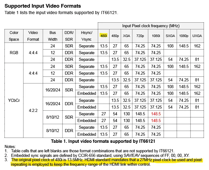

  • Pipe the RGB666 into an off-the-shelf HDMI transmitter IC, such as ADV7513, Sil9022a, or IT66121, and configure the transmitter over I2C to enable pixel repetition. This doubles the horizontal resolution, getting the pixel clock high enough for normal HDMI sinks to accept it. But there's no guarantee a cheap USB HDMI capture dongle would play nice with a pixel-doubled signal.

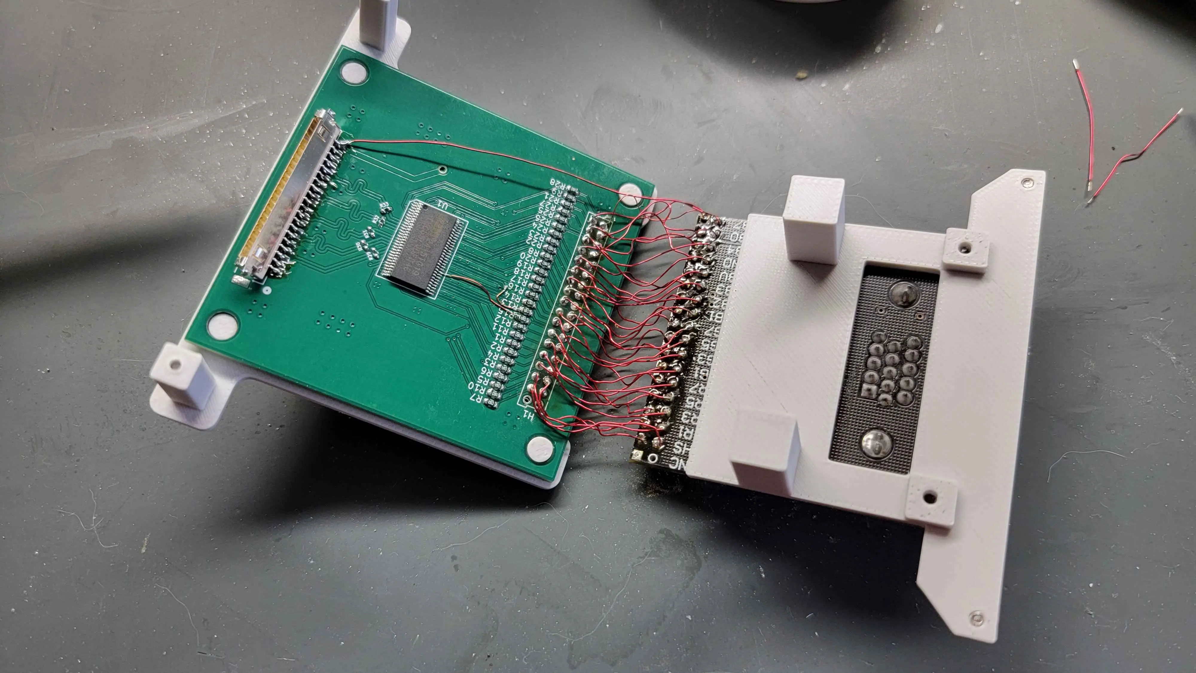

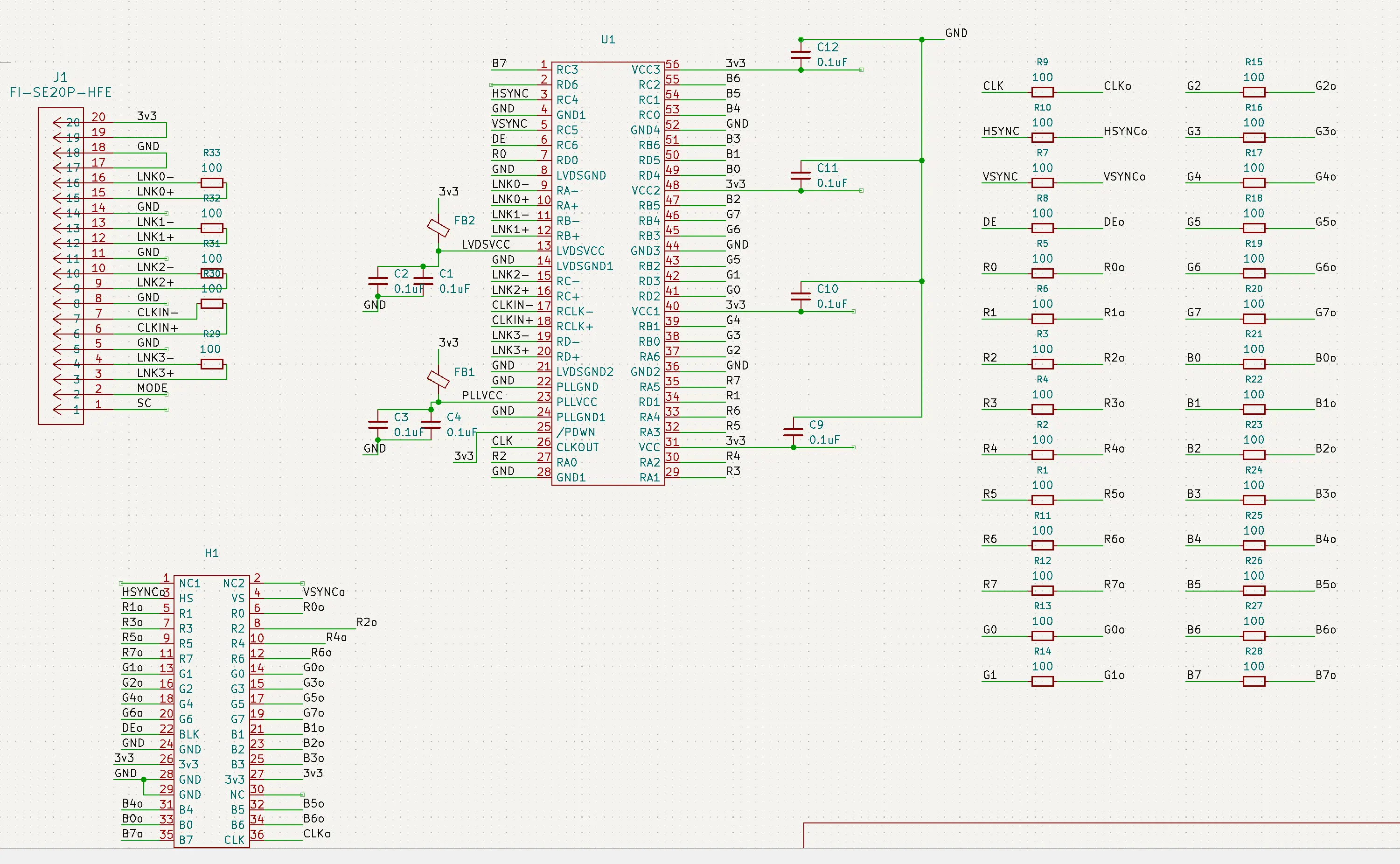

After taking the machine apart and looking at the screen, we realized that the screen was actually using a serializer on the RGB lines and sending 5 LVDS data streams to the screen. It was pretty easy to source an appropriate receiver, we're using the THC63LVD84C. We also found that the screen on the machine is actually 640x480, so setting up a capture setup will be a lot easier than we'd expected.
The current setup sends the serial lines into the THC63LVD84C, and those signals then get sent to a GM7123 module off of Aliexpress to get VGA output. The issue is that this setup isn't working at all, and I'm worried I made a dumb mistake somewhere.
There are a lot of bodges on this board. A couple of the vias weren't aligned properly since I forgot to reexport the drill files after a couple of adjustments, the input port has been jankily mounted to get the appropriate orientation, and I guessed wrong on the pitch of the pins of the GM7123, so everything has been hand wired. i painstakingly checked everything with the multimeter and couldn't find any shorts or shoddy connections, so I'm back to the drawing board a bit.
Currently, my plan is to borrow an oscilloscope and make sure that everything on my green PCB is actually spitting out the proper signals. Hopefully that will reveal something, as I feel like I'm running out of things to check.
