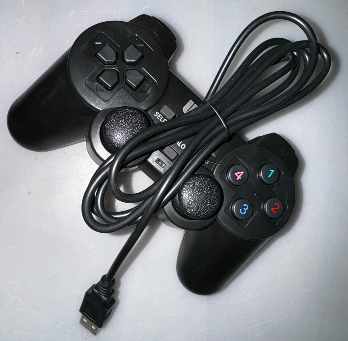

I'm very curious to know how you adapted the joycon joystick. Does the direct connection work or was something else necessary?
Yes, it can be used directly, but there is a problem, please see the picture
The polarity of one of their axes is opposite. In the MISTER system, the menu system and the control system can be set separately, so the impact is not significant.
Nice, i'll try with some newer models i saw on aliexpress. I hope it's not specific to that version you used. Thanks for the answer!
