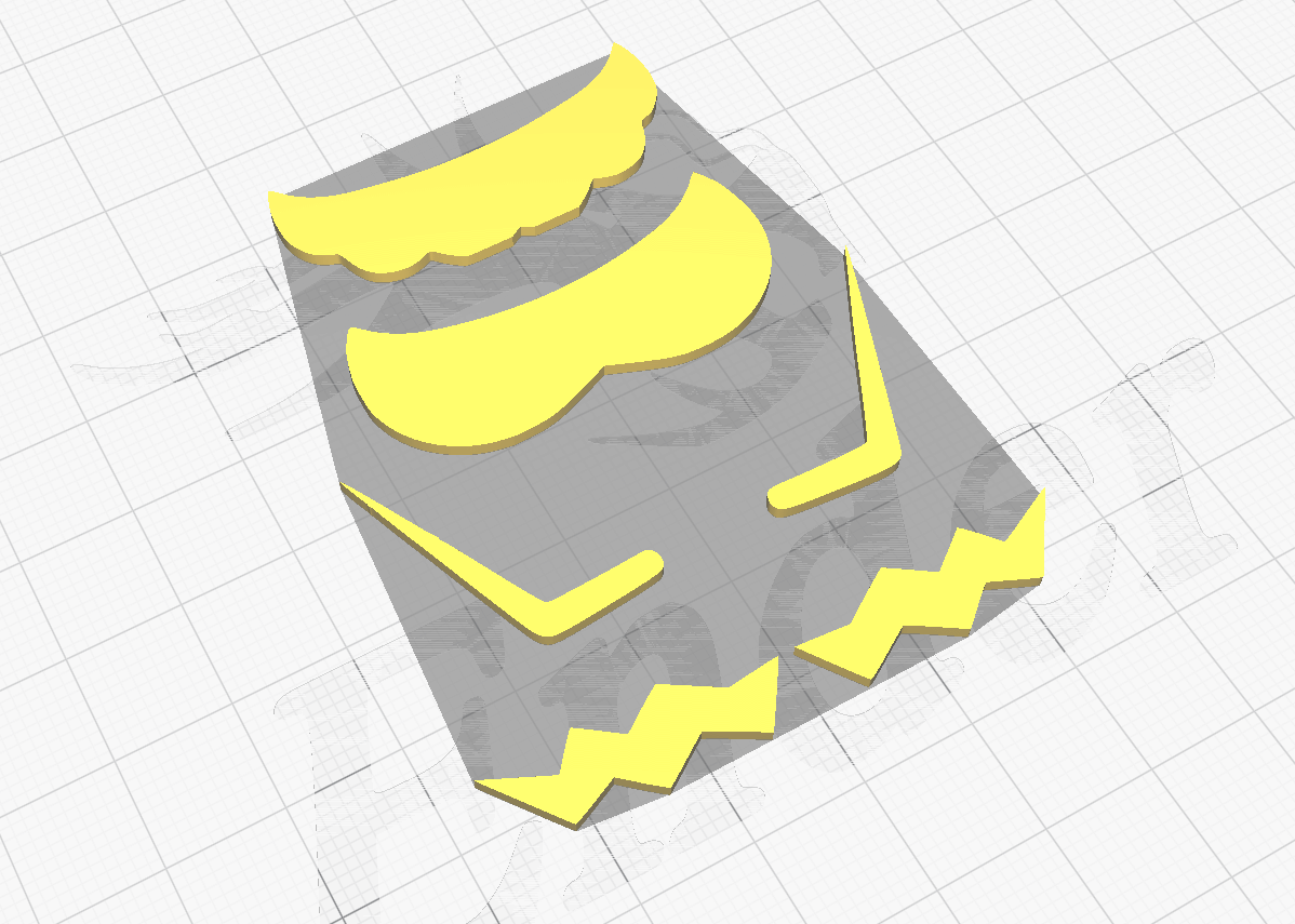

I learned a lot of different tricks to change the surface layers of prints, so I tried out a few different ways to print the case and 3d logo to make the details show more clearly. The final logo really pops, I ended up using lines for the surface layers instead of a concentric pattern.

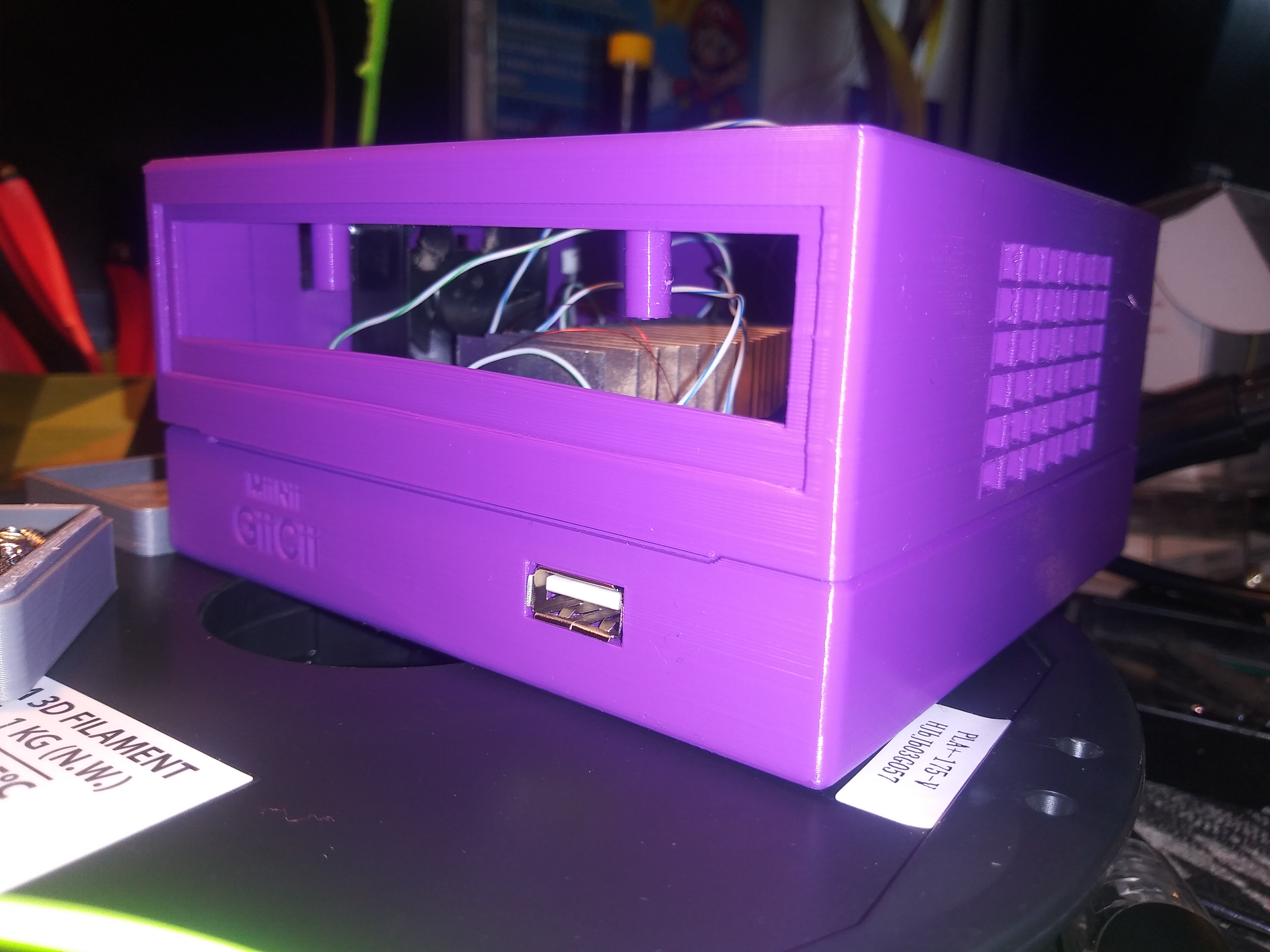

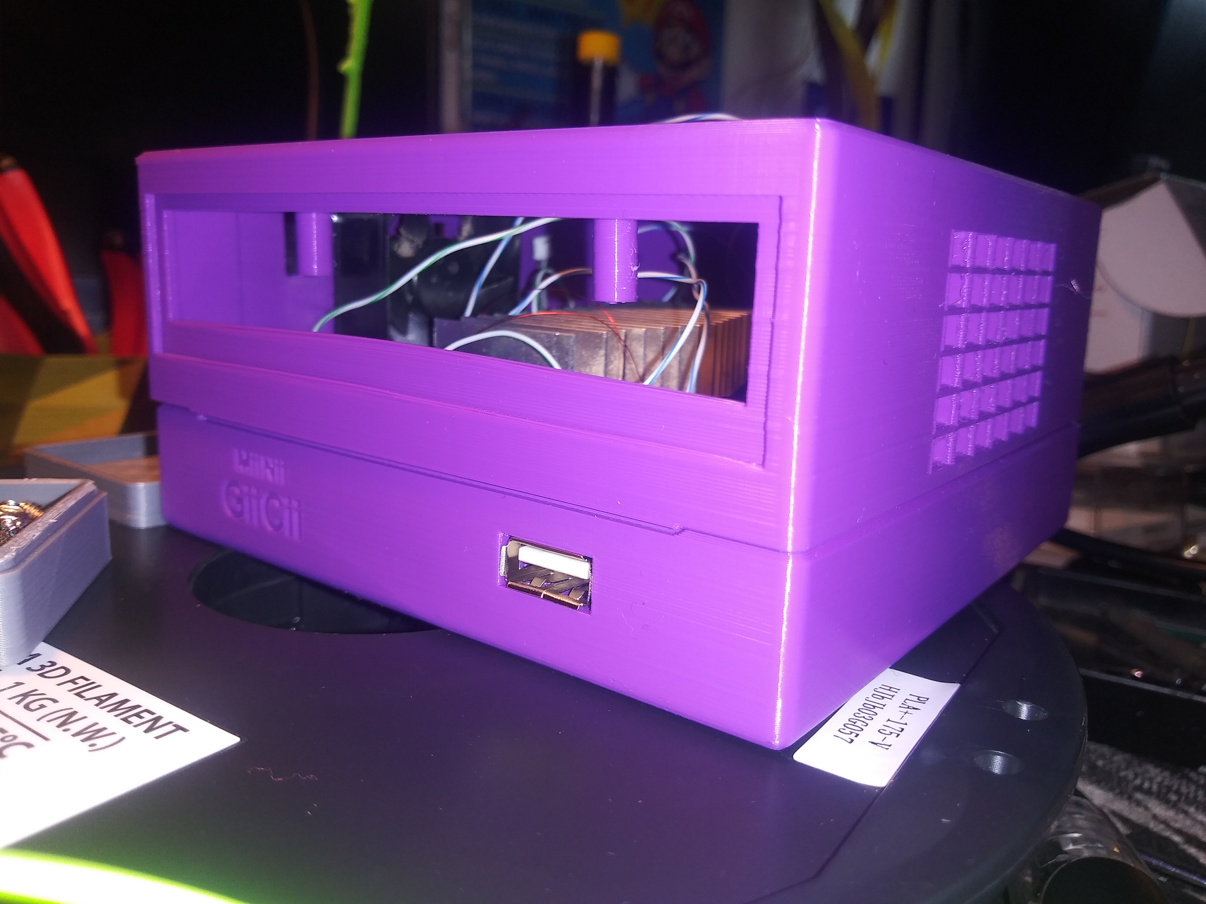

Here's a nice shot of the front of the newest case. Seems like everything should work. I may reprint the top a bit more slowly for nicer walls. It was done in 7.5hrs, so maybe I pushed it. The fan is screwed into the top, I'll show internals before closing everything up. We still need to figure out why the rewired BT isn't working on the OM6 cut. Postman is puzzled as well. Once that's all good to go, it should be ready for final assembly.

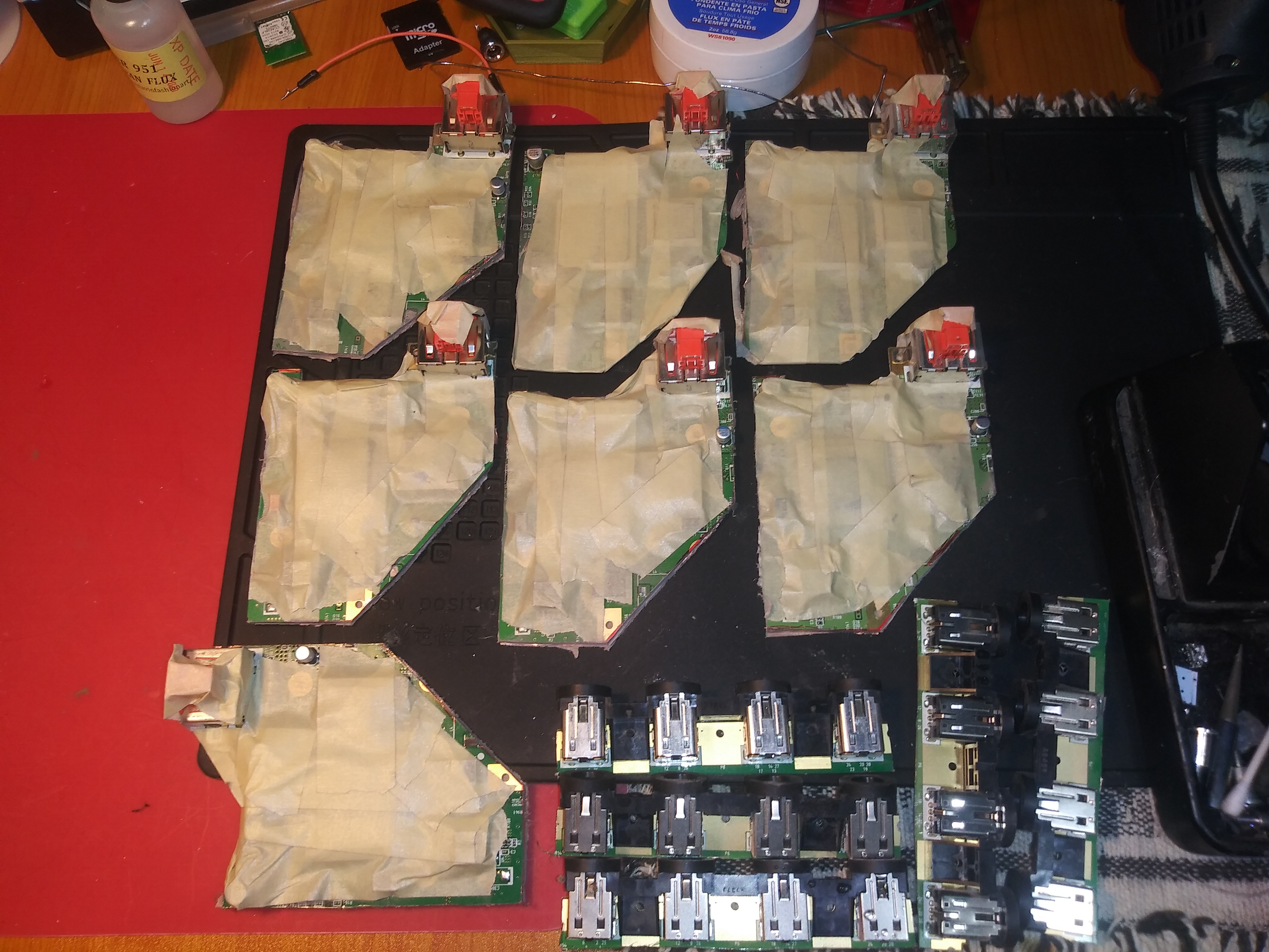

So I had some time to trim a few 6-layer boards today.
They still need sanding and testing, but I got 7 cut in about an hour and a half.

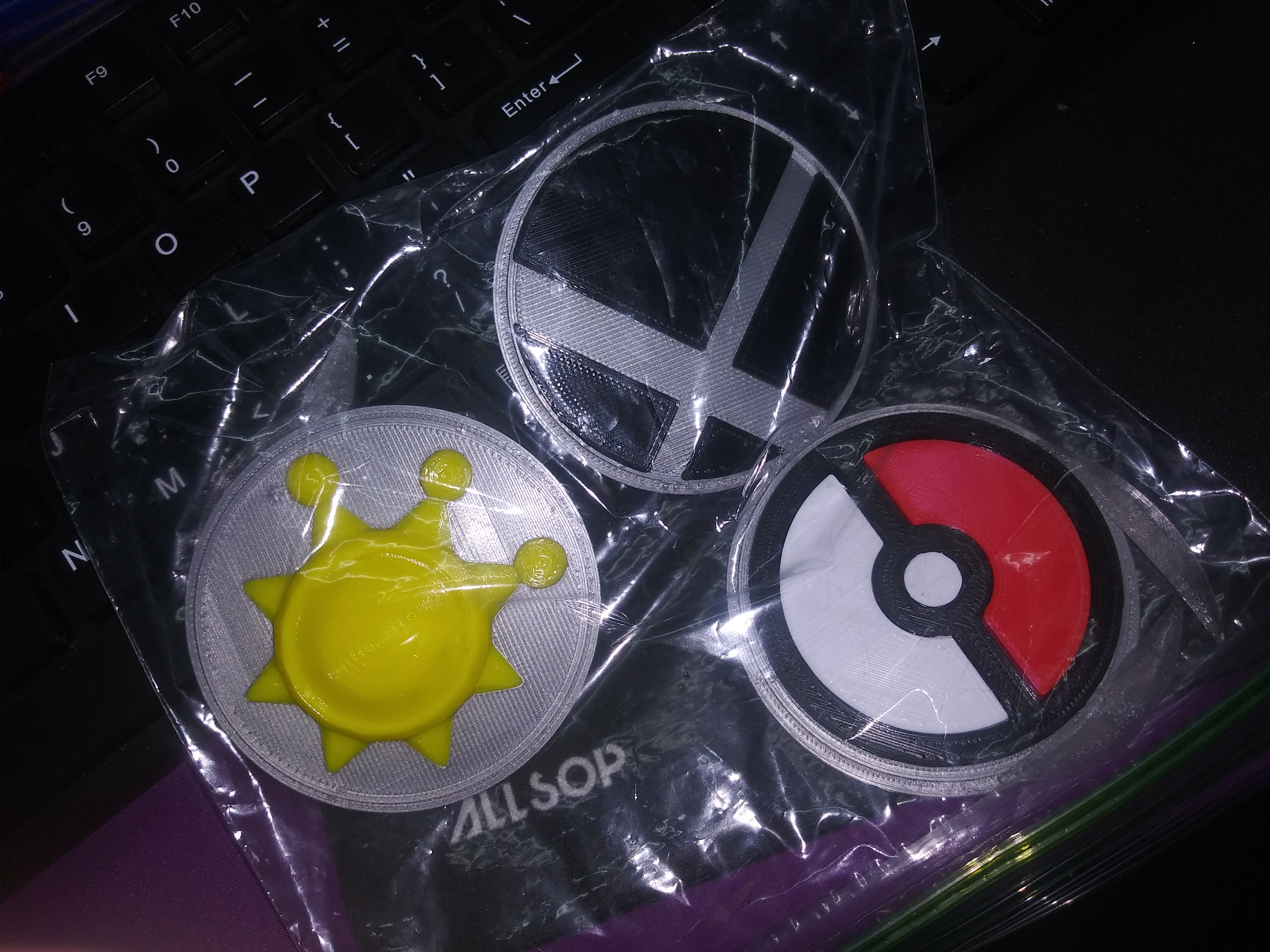

The themes are going well, had a chance to work on that a bit.

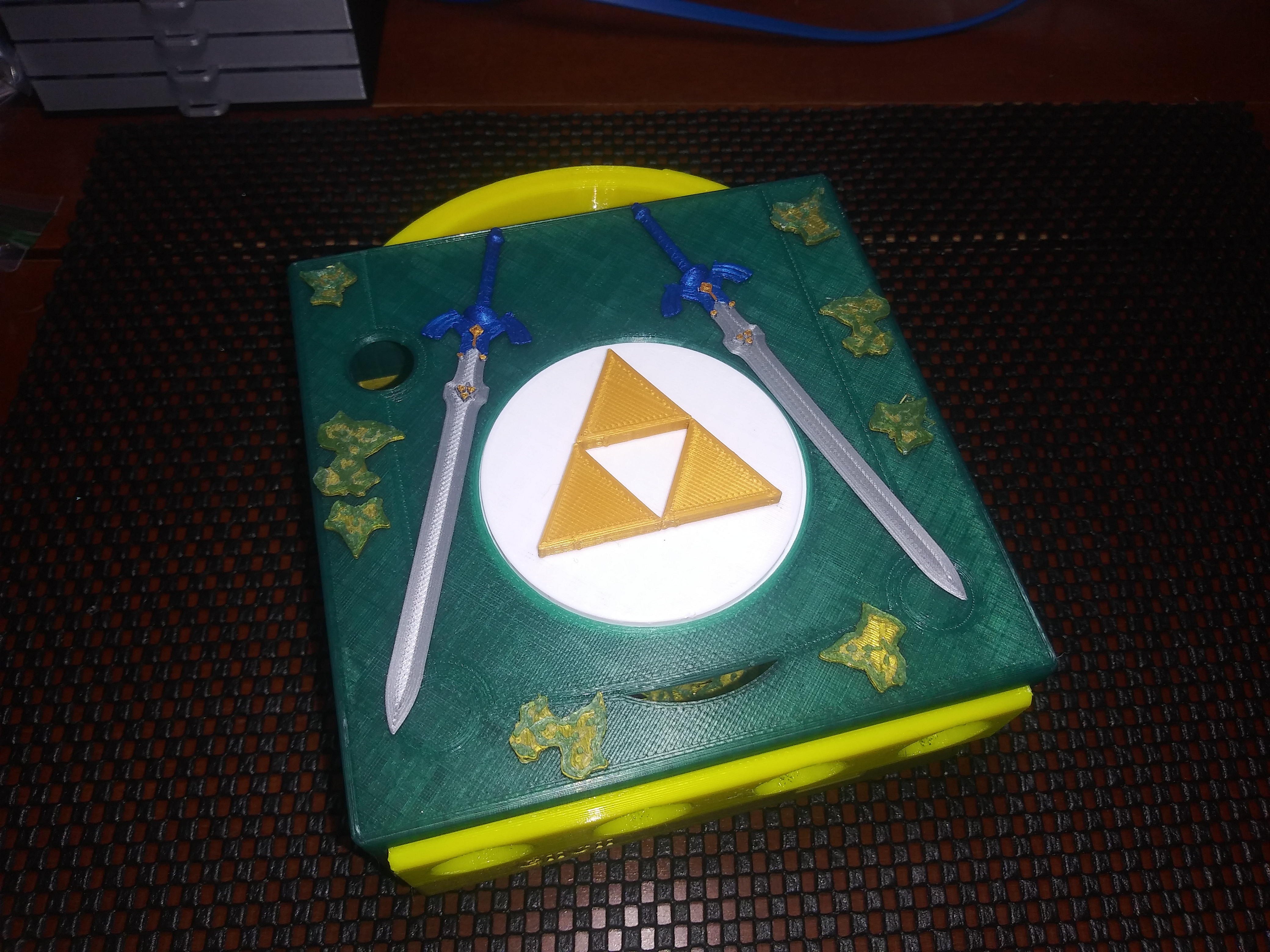

I already have a Zelda themed case printed, just needs assembly.
Working on the Bros themes and a few more GC titles to add to this custom collection.

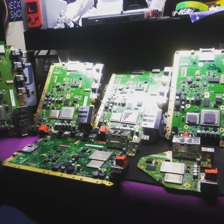

So far 4 boards have been sanded and tested working! I think I've got this type of trim down pretty good now.

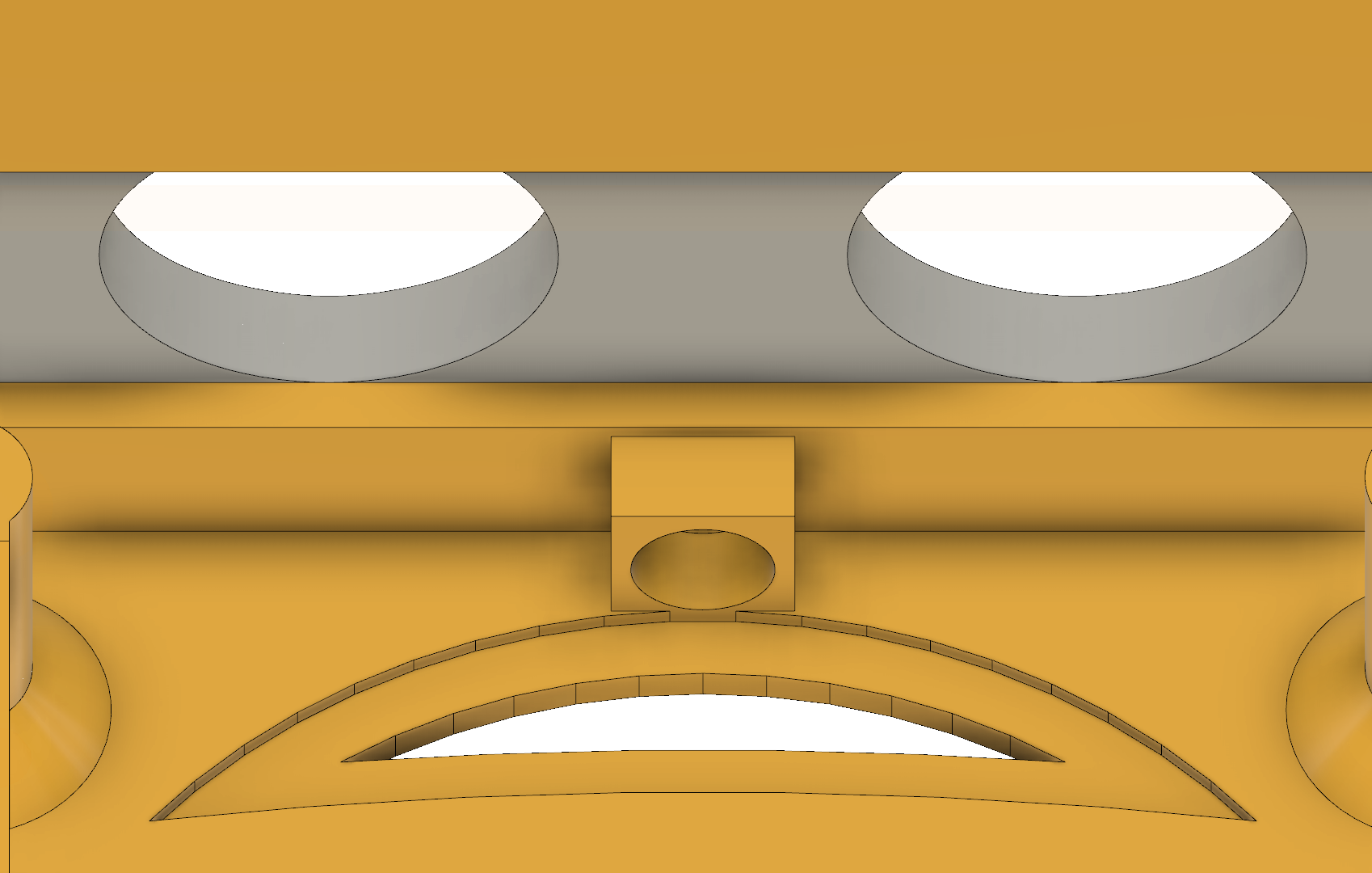

Had a couple failed prints with a new filament, gotta tune my settings a bit again. I have half of a smash case finished, and then this unholy offspring of Pikachu/SpongeBob/NoFace that makes me warm inside!
The ears screw in where the handle usually goes.
