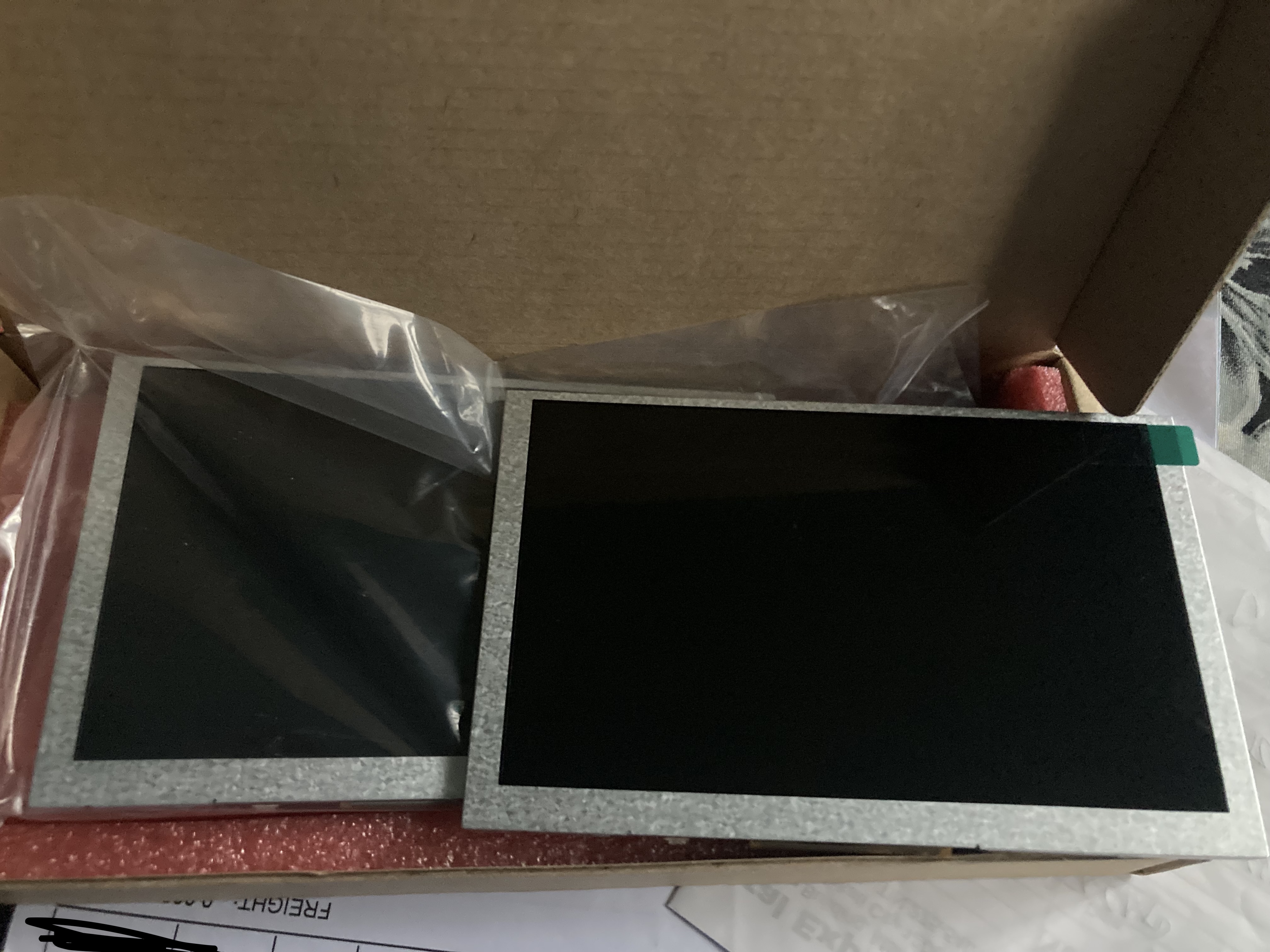

  • 5 inch LCD from BuyDisplay. I like their panels for the quality and price.

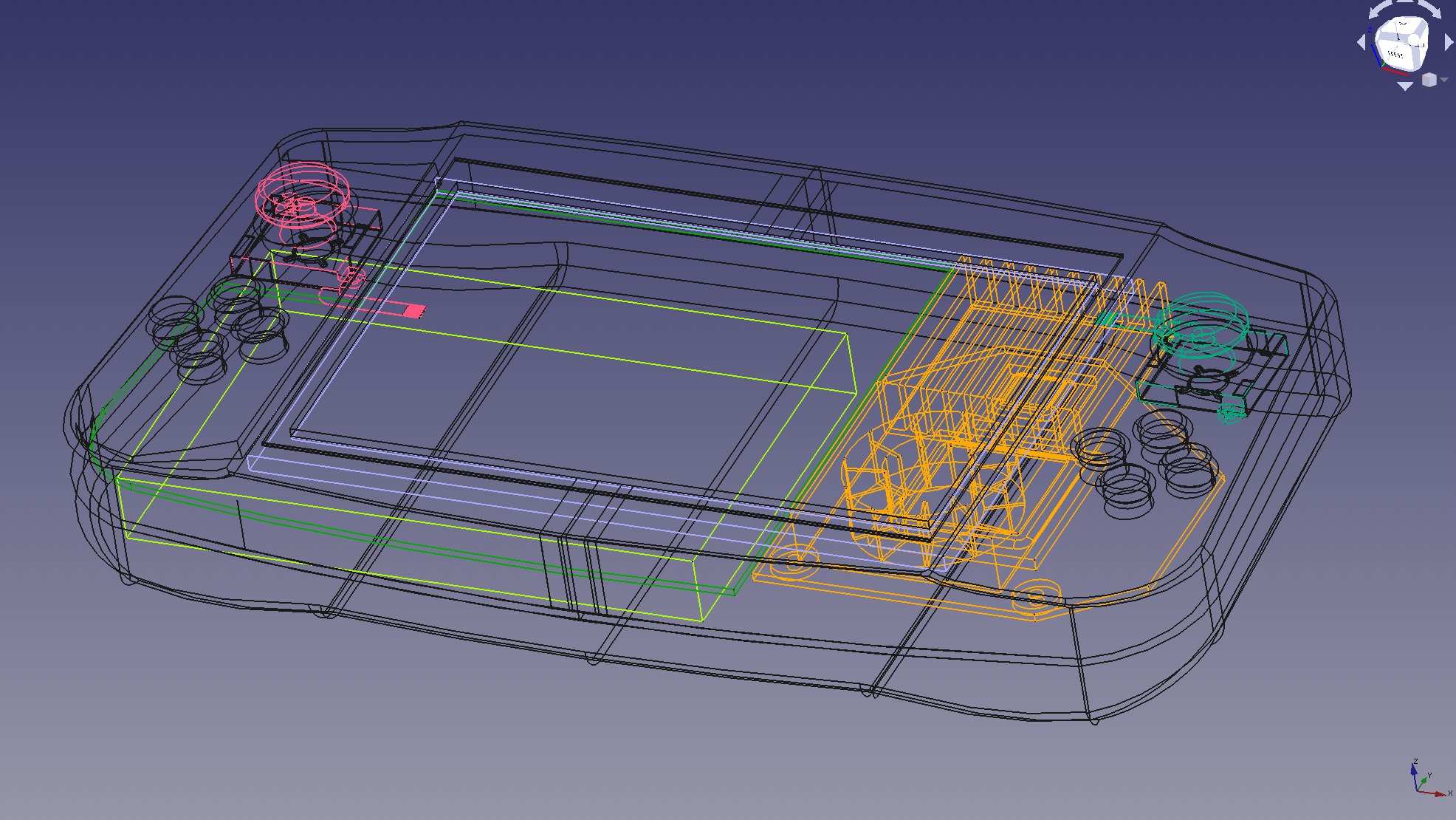

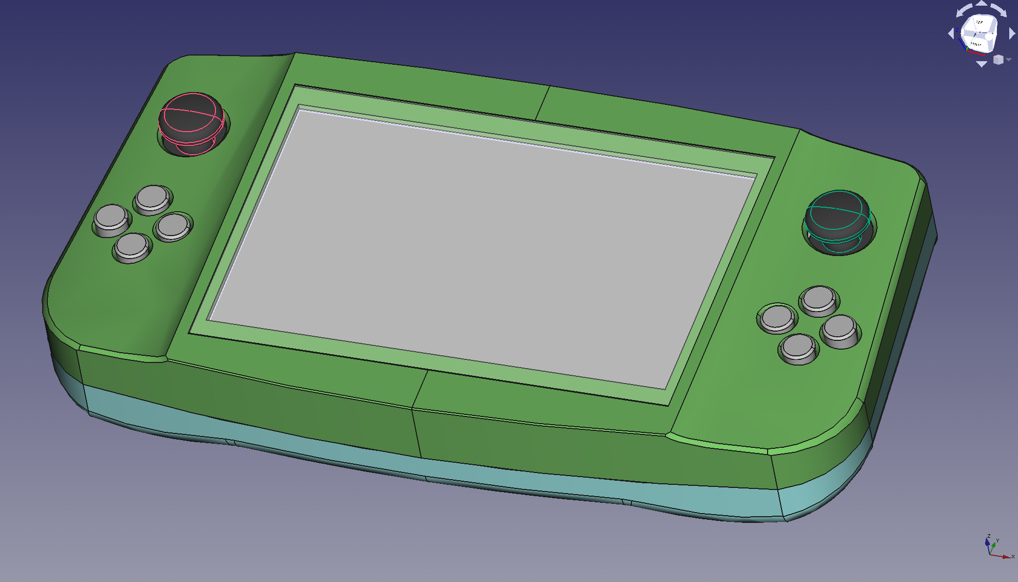

Here's the tentative CAD Model built on FreeCAD:

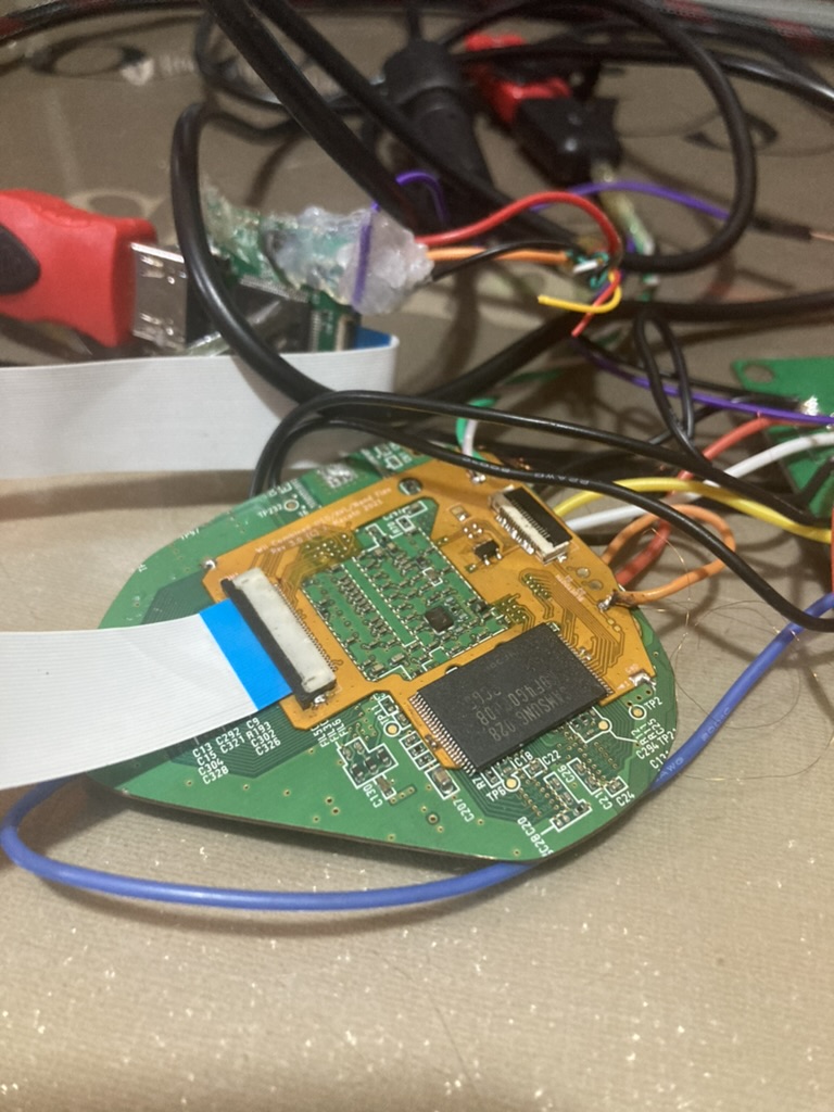

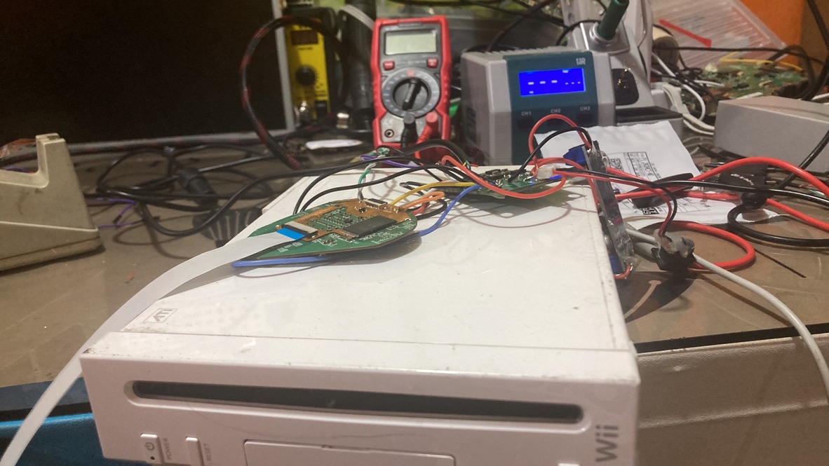

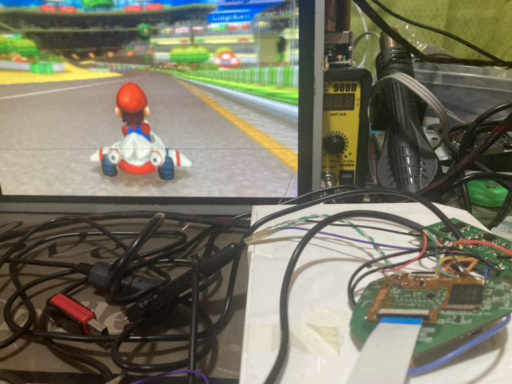

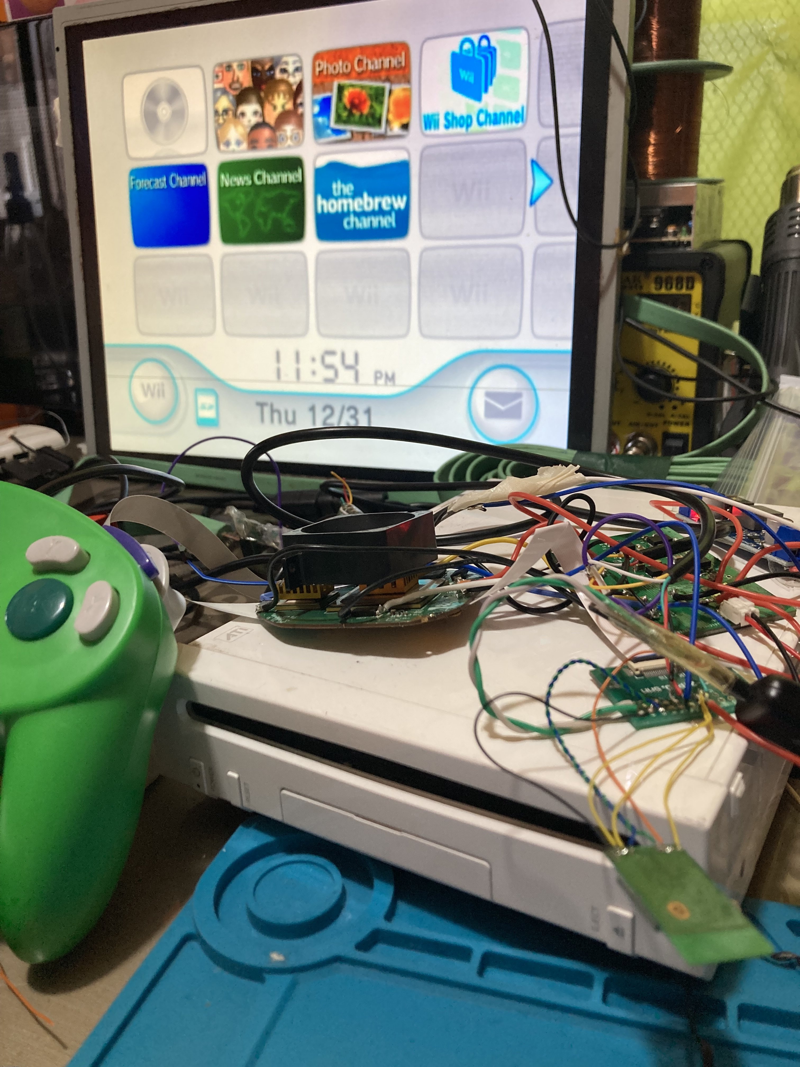

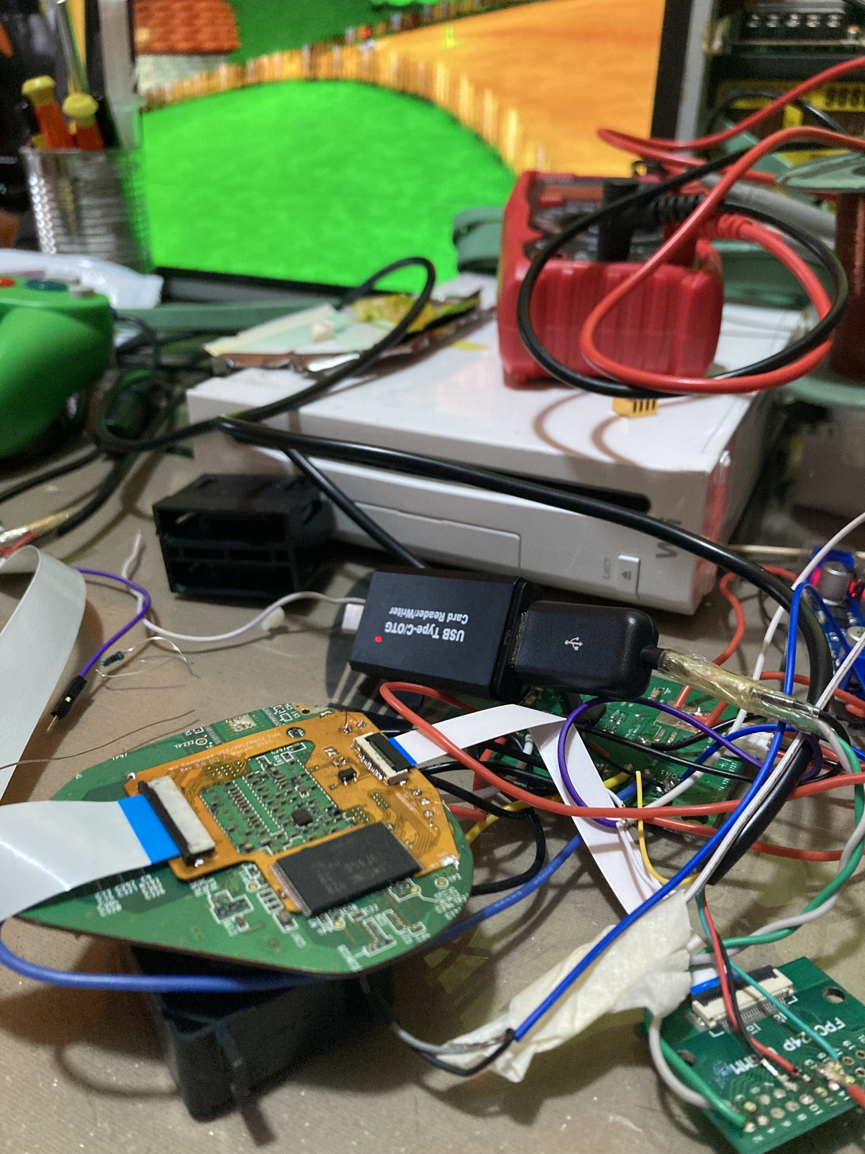

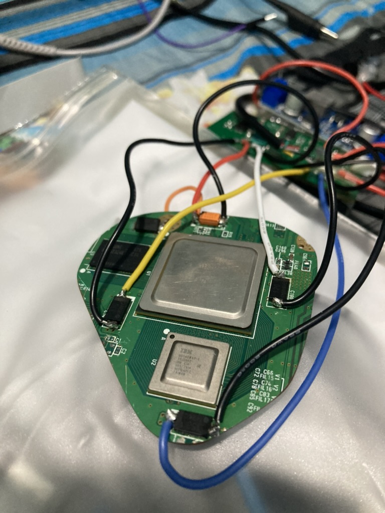

Right now, the trimmed Wii board is in an ugly state visually but it works great!
Also surprised that those Wii GPU signals can travel so far as well. Ground interleaving between the signal pins seems to have helped alot:

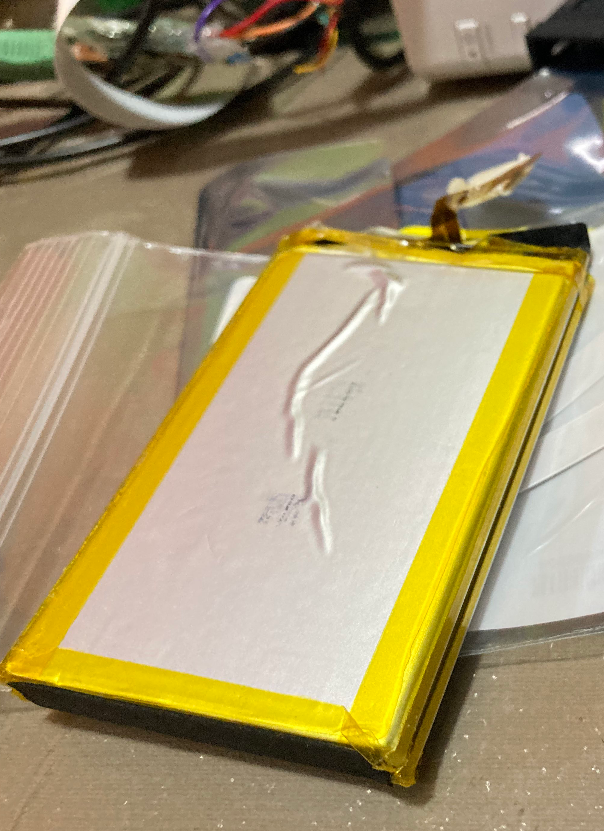

And the battery is here as well:
It was for a Blackview BV9100, was rated at 13000mah but me and @YveltalGriffin isn't so sure about that after we double-checked the dimensions.

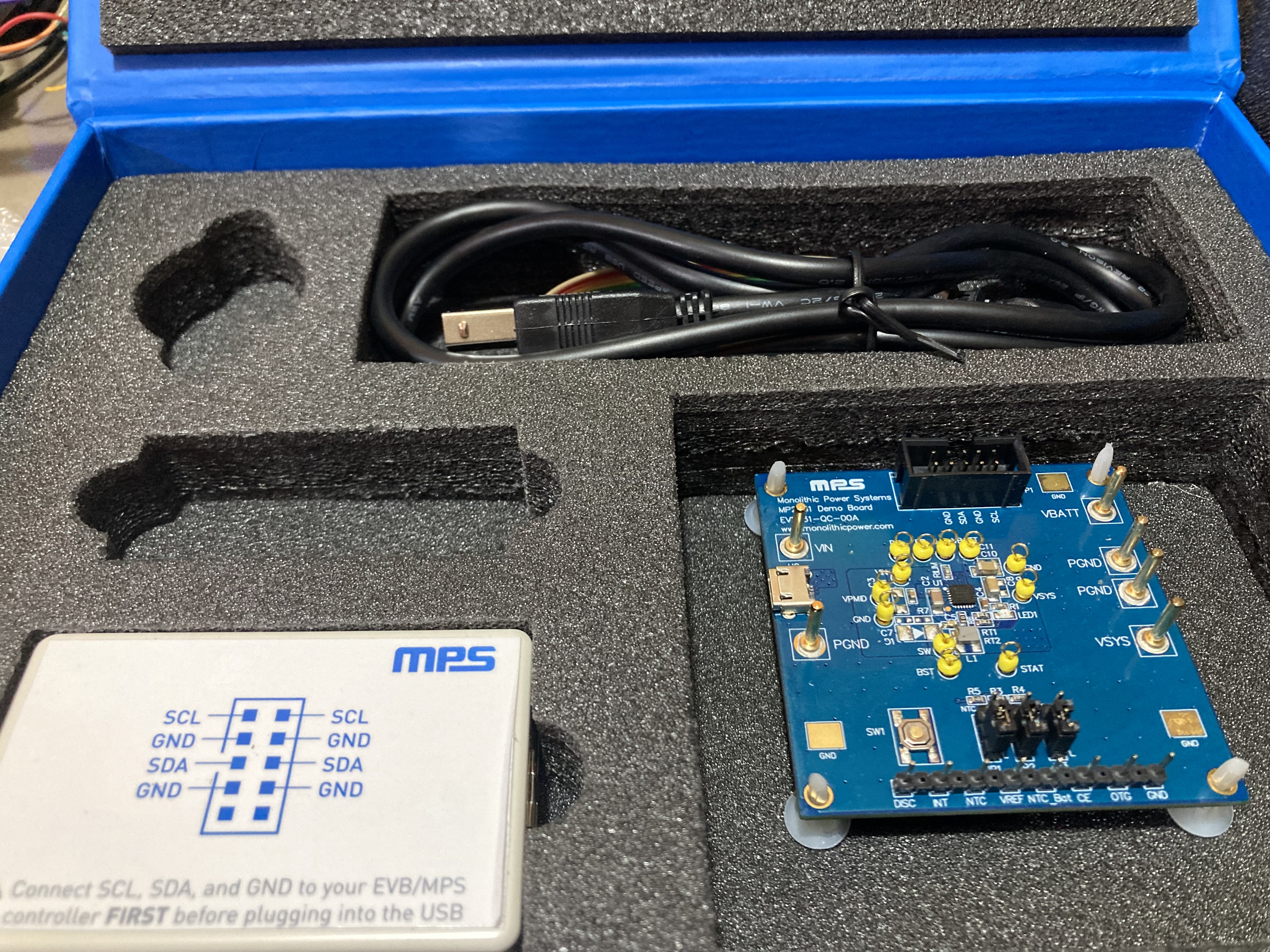

And also i get to play with a MPS evaluation kit for my charging chip so thats fun :D

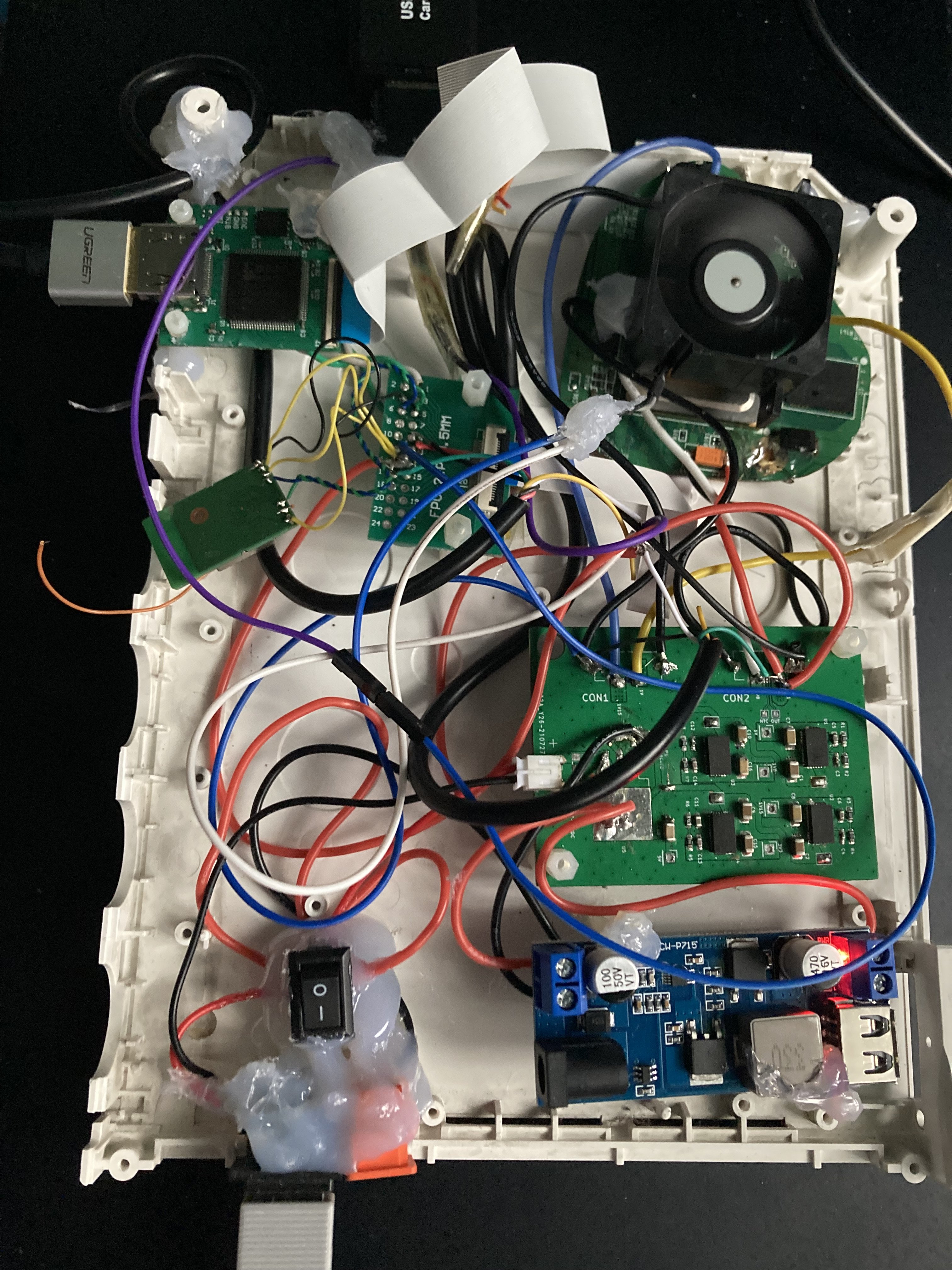

I tidied up my ratsnest for a little bit. I really need to make a development board for now while waiting for the 3d prints

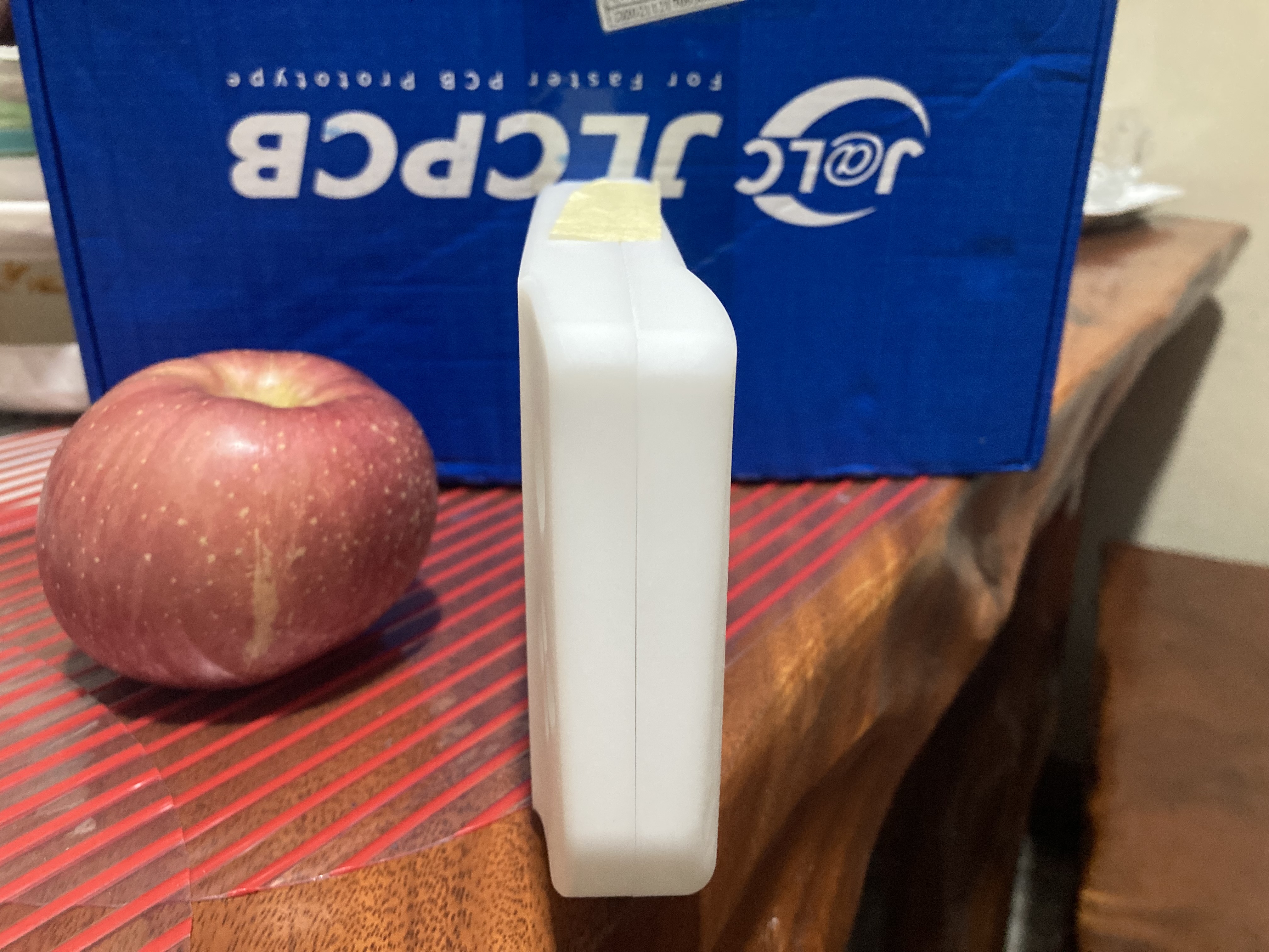

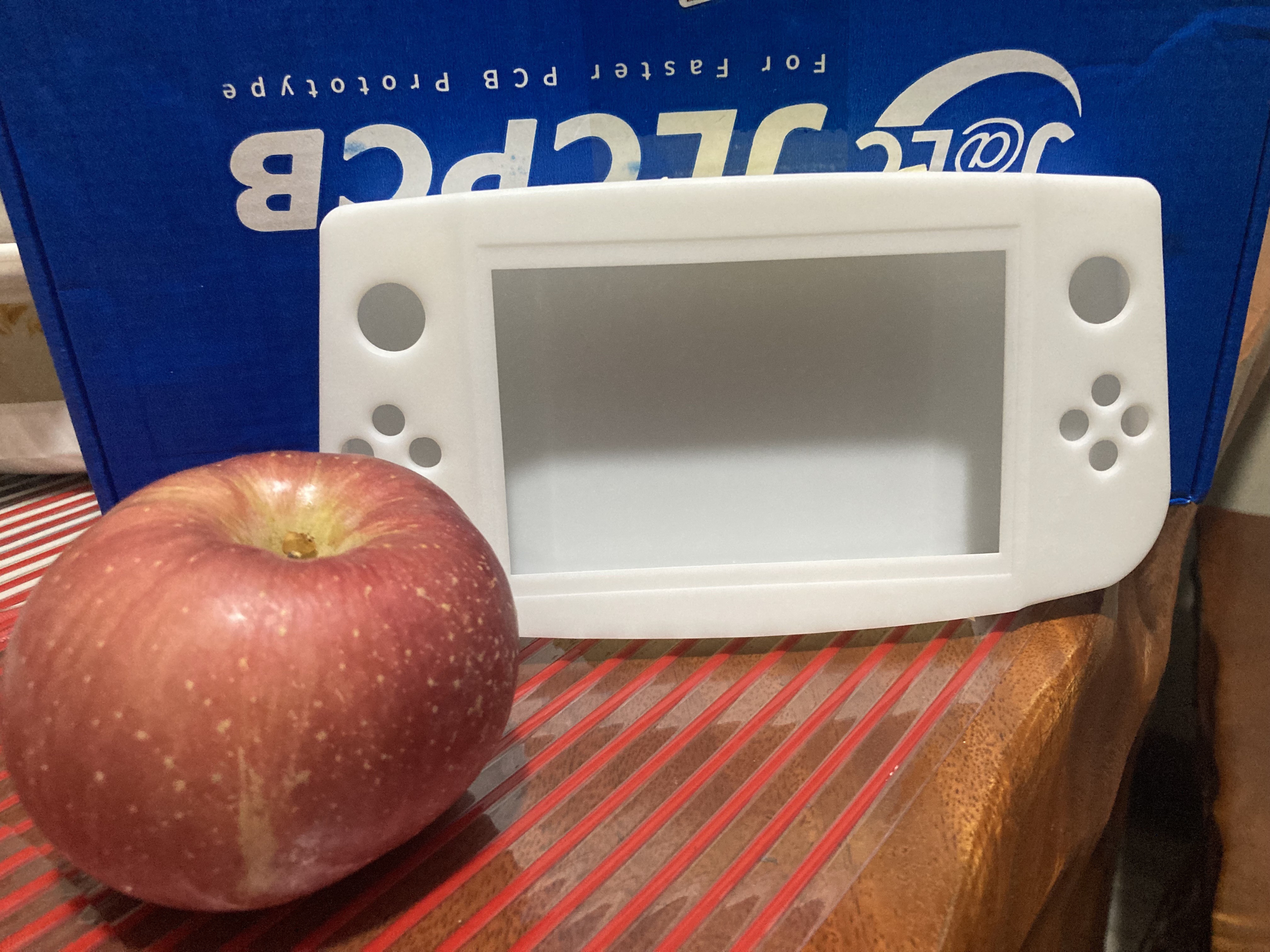

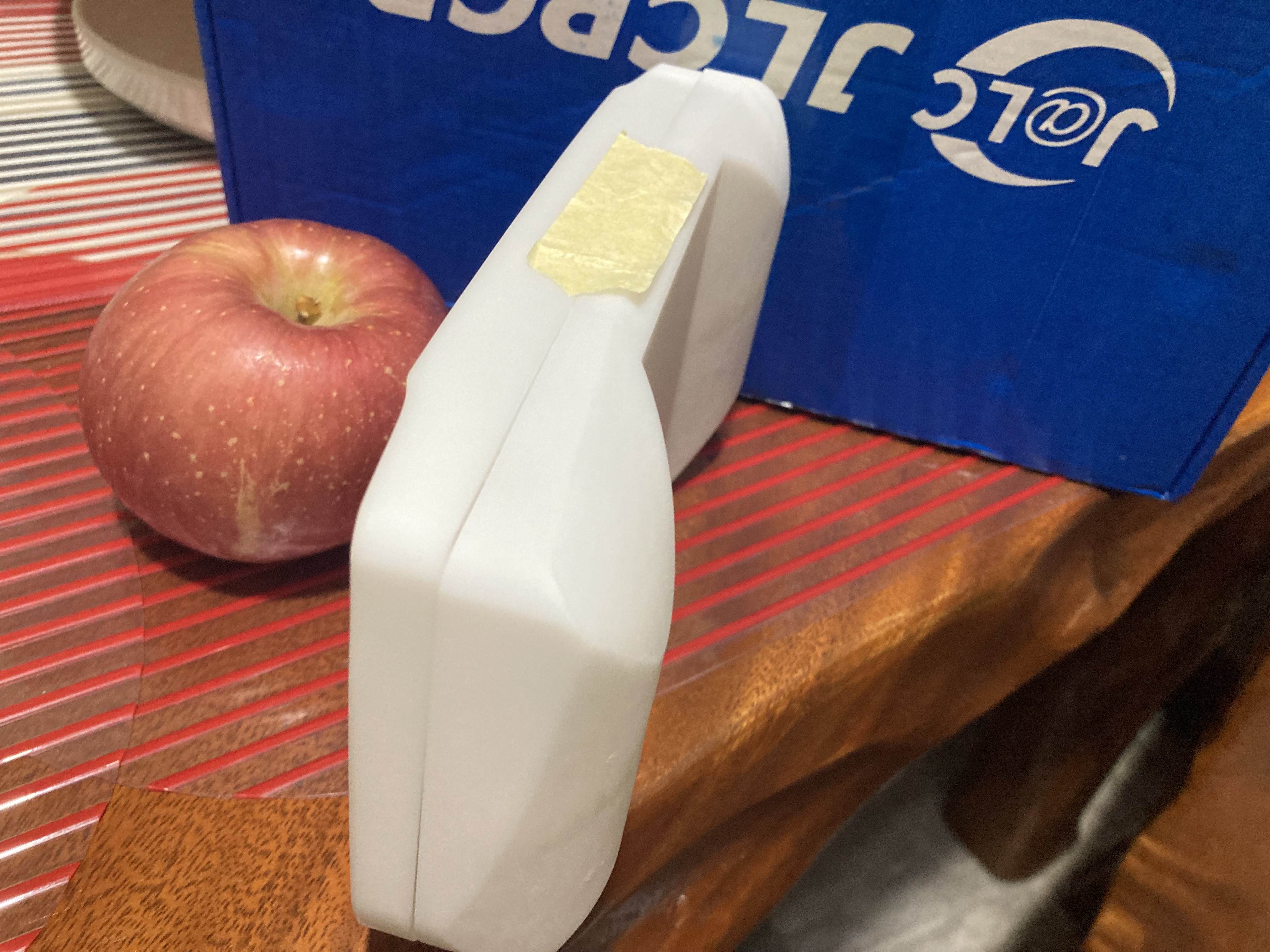

The 3d prototypes arrived :D
This is the thin version:
and this is the thicc version:
the thick backplate version will contain 4 21700's but im kinda worried that it might get too uncomfortable to handle for long periods. the thin version though will only contain a battery pack that is probably just in the 6000-7000 mAh range. Tis kinda hard to decide which way to go
