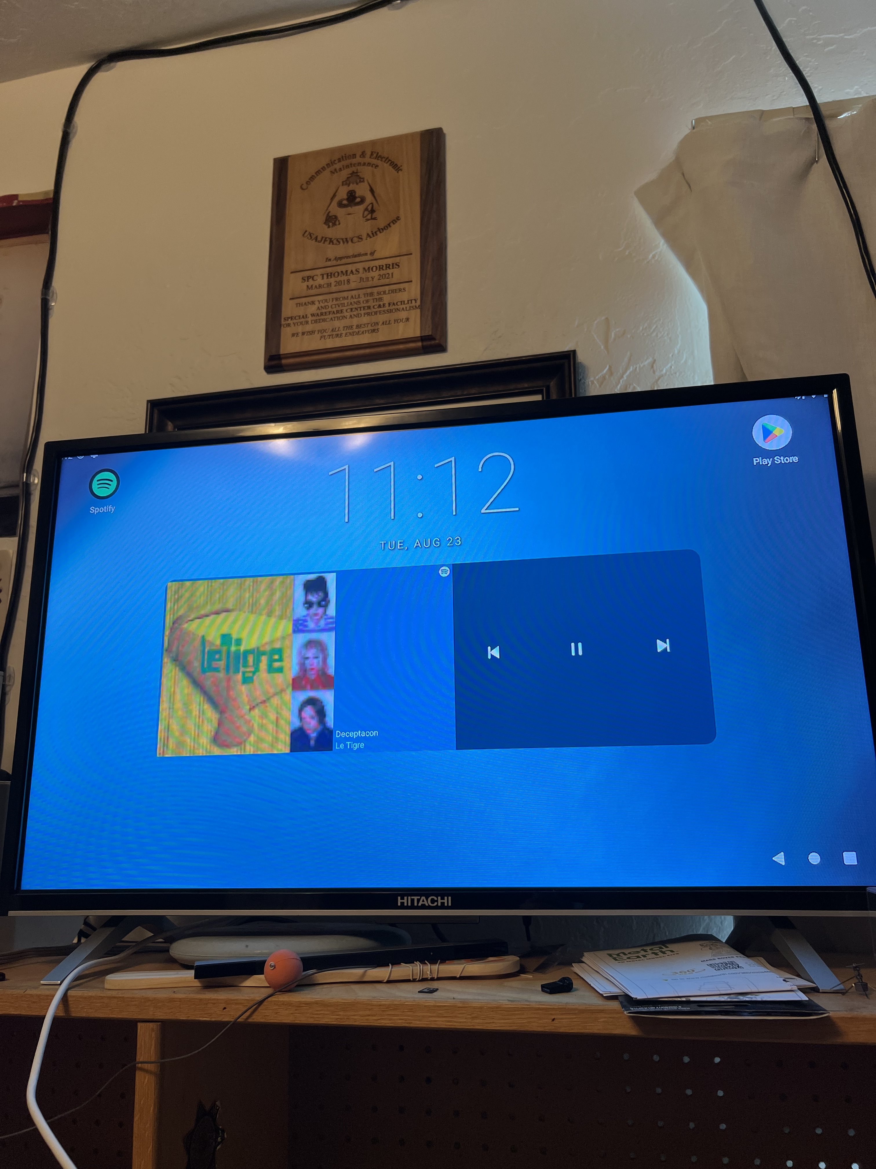

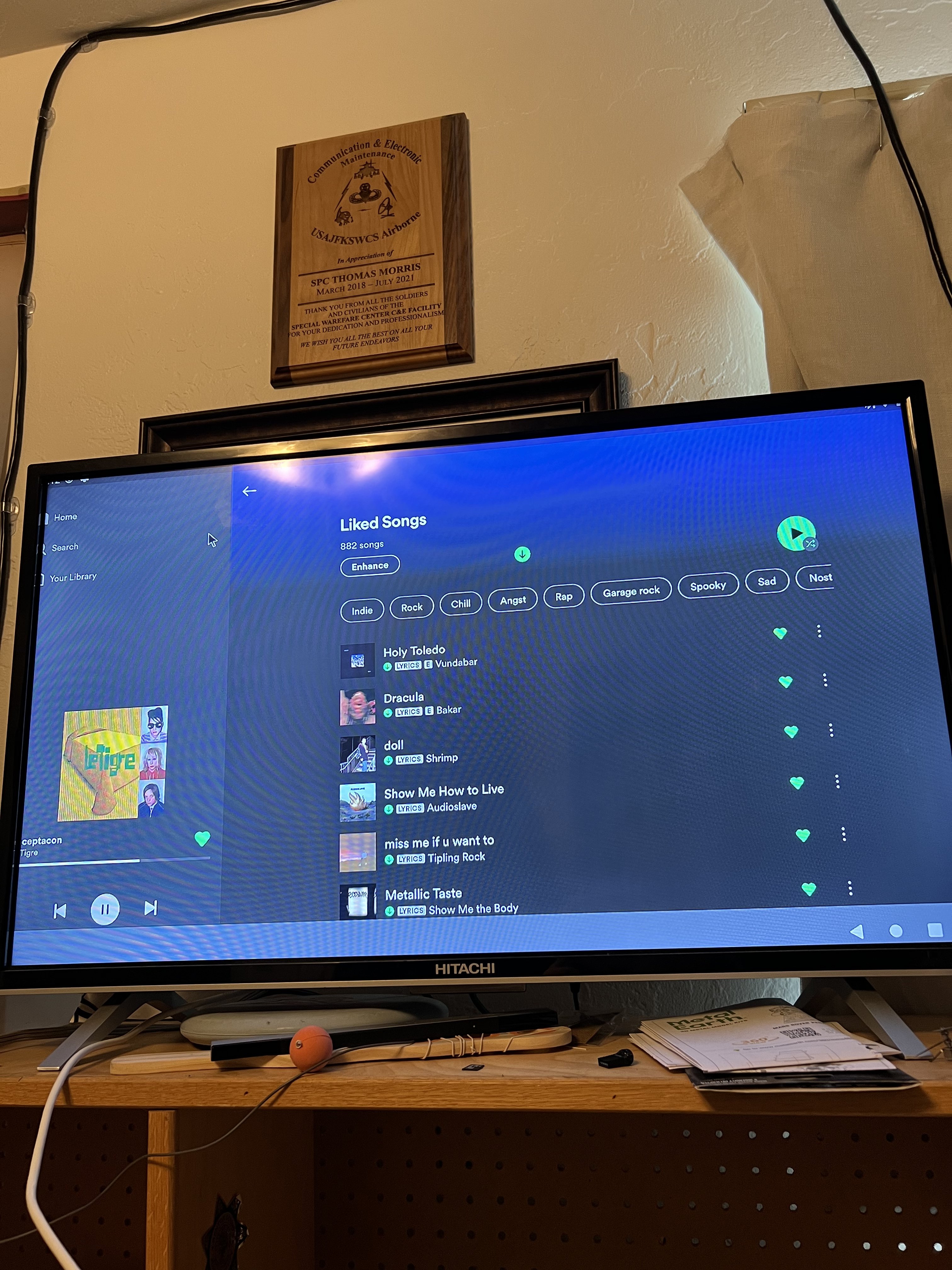

AHA! I have an update with a little bit of finagling I was able to get the newest pi port of lineage and gapps onto my 400 to download Spotify (see attached photos). So the concept is possible. I also found a CM4008000 that I have bought and I have a carrier board that has a 5 inch touchscreen. All I’m really lacking is audio out and battery power but I was going to peruse adafruit for power. Any suggestions?

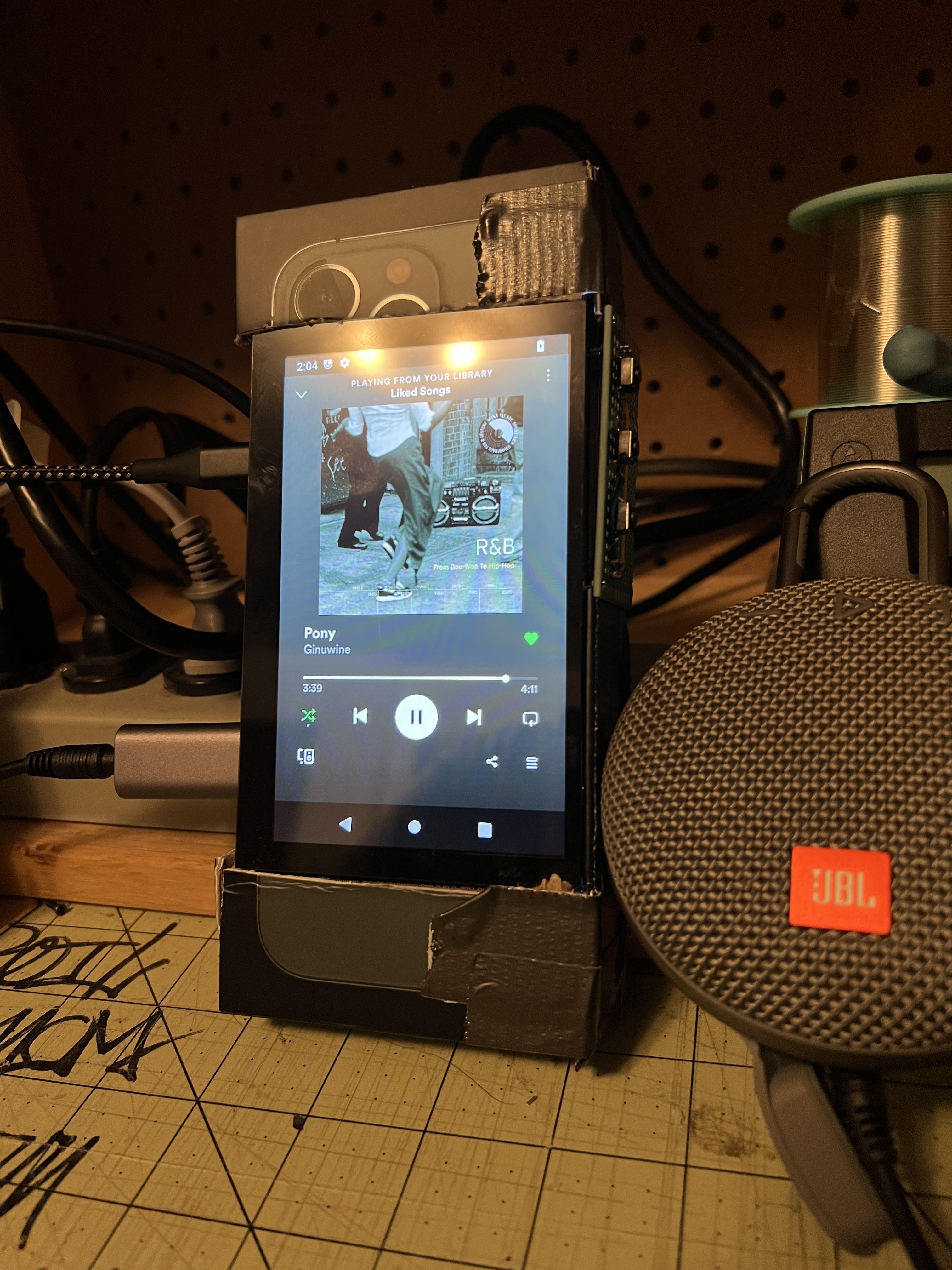

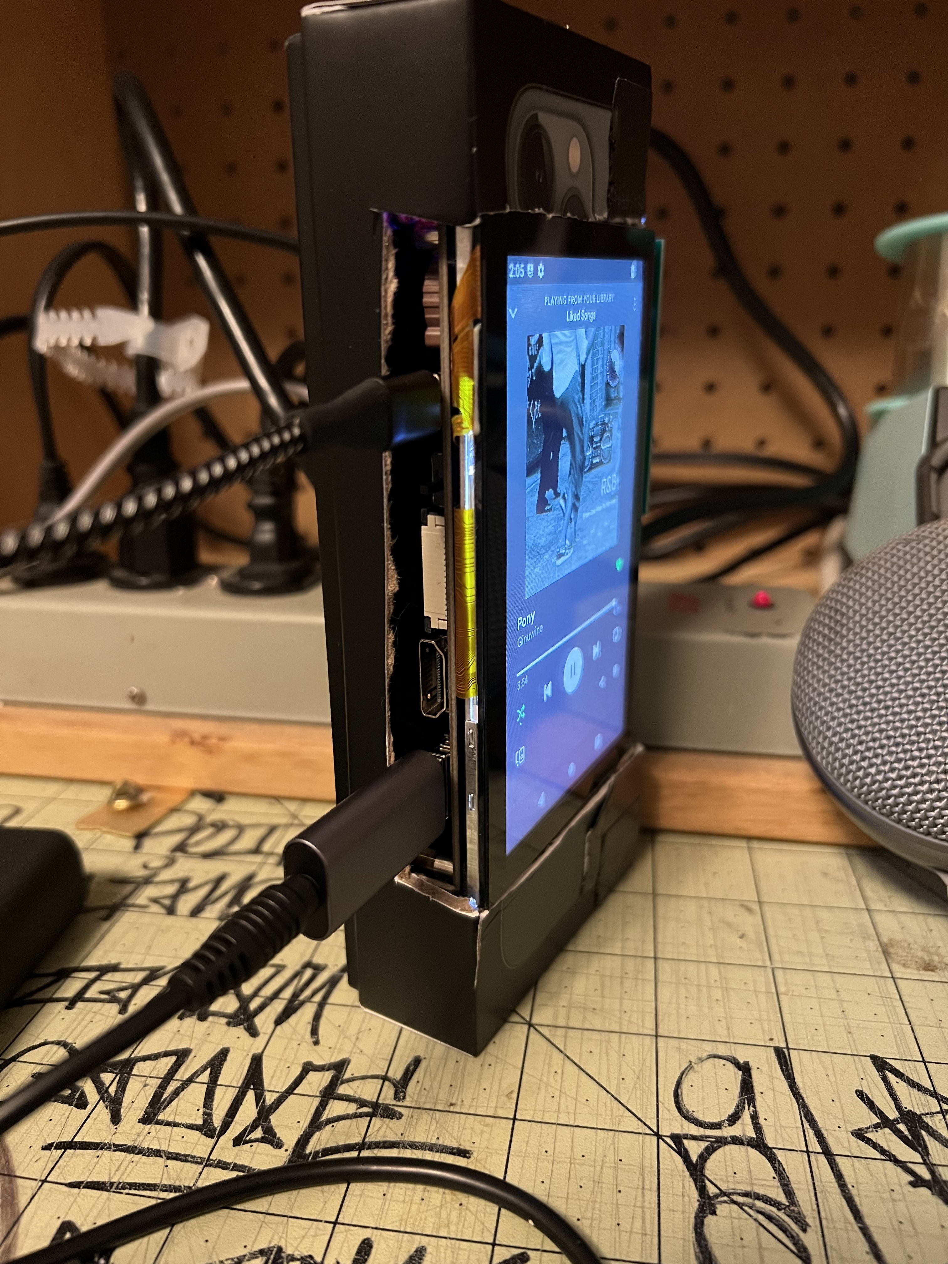

Another update I finally got the touch screen carrier board in and I strapped together a rough case (still need to get one 3D printed). But I have found a couple things that can be worked on
Ongoing Issues:
- there’s a noticeable break in the songs every so often.
- CM4 heats up a considerable amount and I have no heat dissipation.
- when I hit the power button to sleep the module the screen will turn off but the backlight will stay lit.
- currently using external power and audio out need to modify case to hold both.

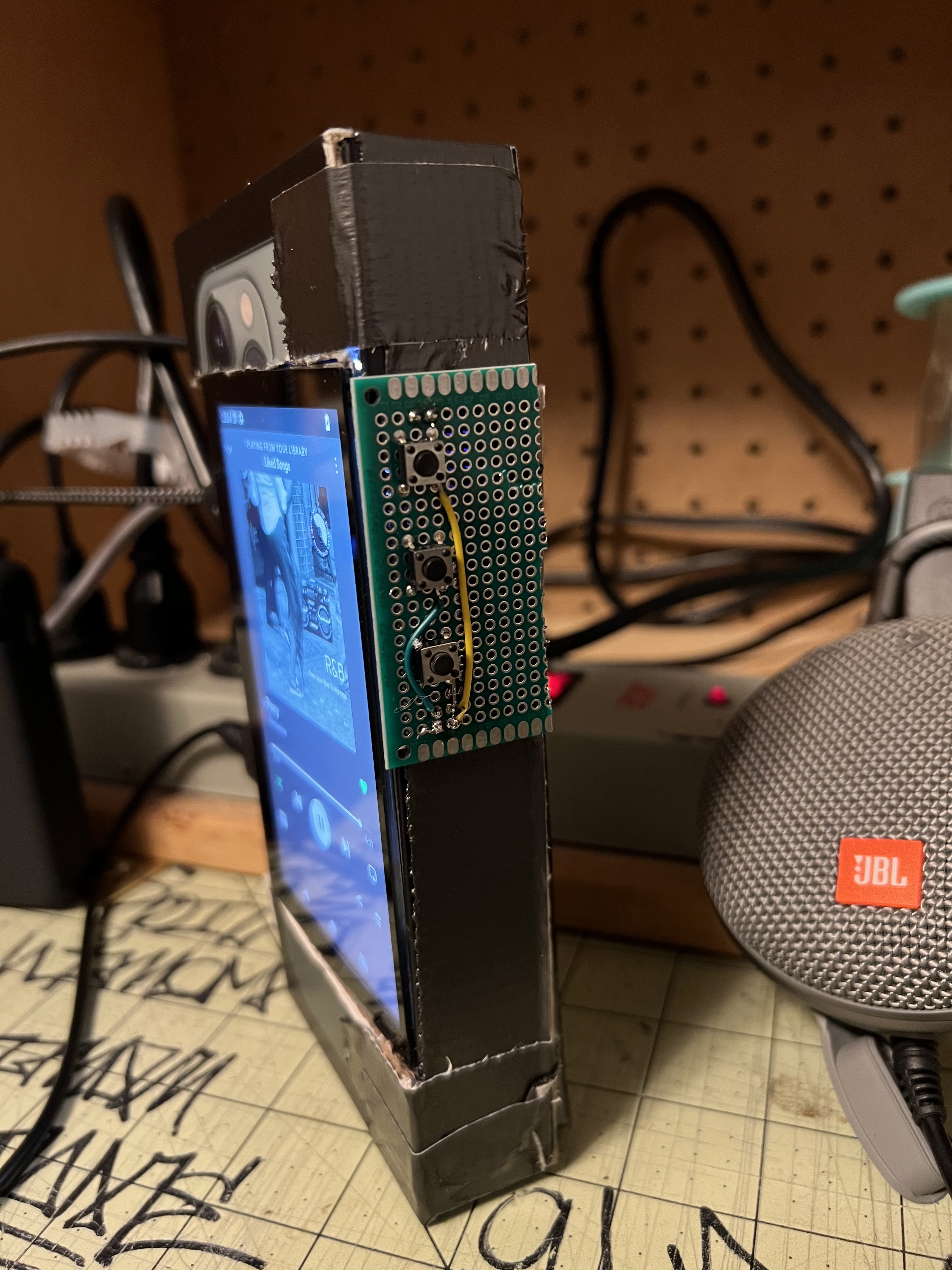

- need to make A better hat for the power and volume buttons.
