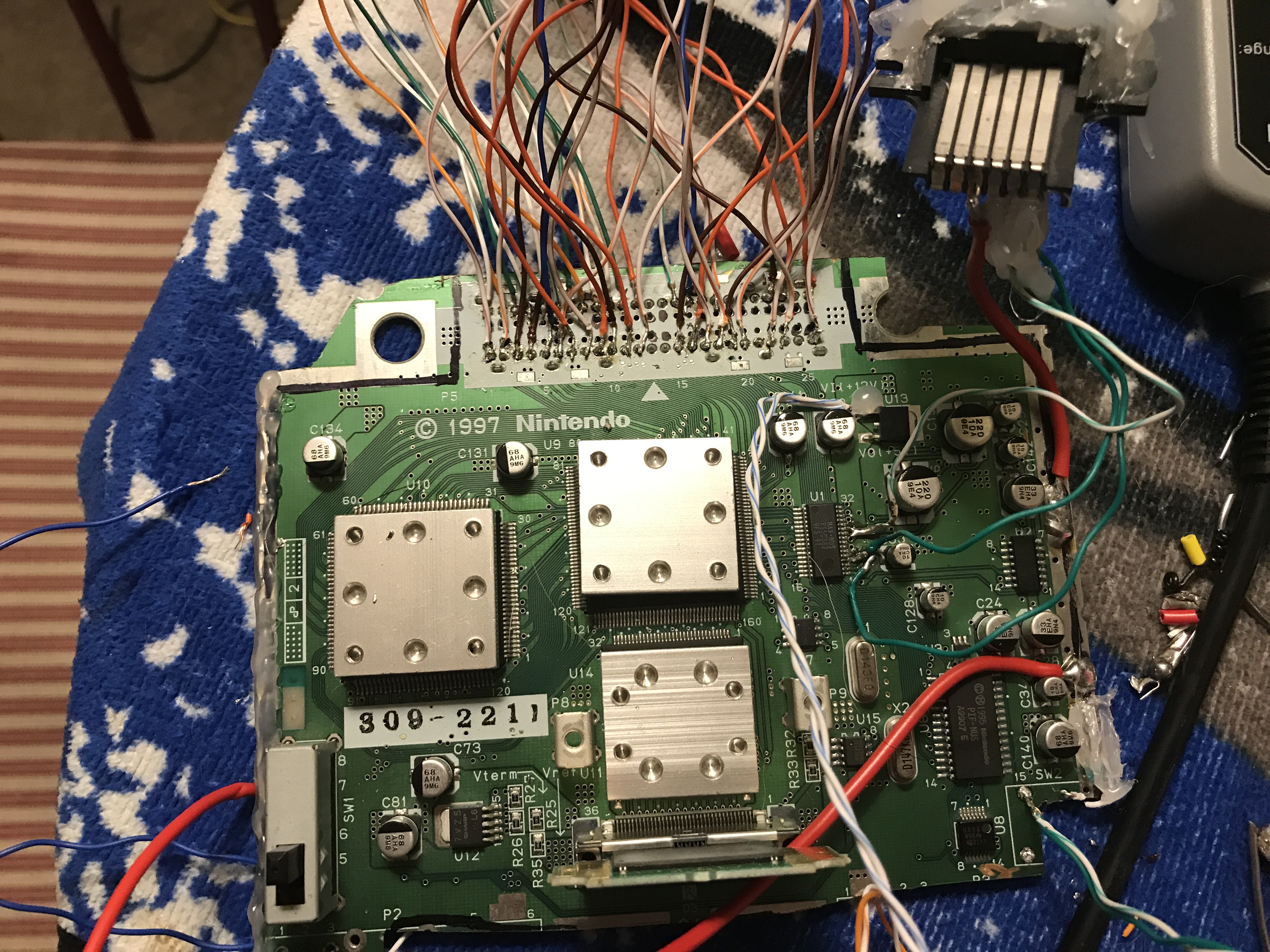

Taking a picture of your board as it is hooked up in the video would be the fastest way, since we can look for many common mistakes
Sure. It’s all kind of a mess right now, but here it is. If you need a clearer picture of anything let me know. The only things on the back are the red wire going to the 3.3v trace and 3 small wires for controller connectivity, disconnected at the moment

How many amps is your power supply giving it/ how many does it need? I found that if my gcp wasn't getting enough current it would do something similar to popping.
Edit: also, did you sand the edges of your board really well after trimming? If you didn't, the edges could be shorting something.
The power supply is from an Asus laptop, rated at 19VDC/3A, and I step it down to 12V before sending half to the console and half to another converter to go down to 3.3V.
No, I honestly didn’t sand anything. I didn’t really think it would be an issue with how conservative a trim it is, but I can definitely give it a go if you think it would help
Sanding is one of the main problems when trimming a board. Sanding is necessary, not optional, when trimming a board.

Okay, thanks guys! I’ll give it a go, what grits are best when sanding? I know I have some 80 grit laying around, not sure what I have in the finer grits, I’m not home atm
You want to start with low grit and work your way to higher grit. Work your way up to 500-600 grit in about 20-30 grit increments. After you hit 500-600, you should be all set.
Also, is it necessary to sand down the grounding strips as well? There’s kind of a lot of hot glue on the left hand side from where I might have adhered it to the new case before properly testing anything

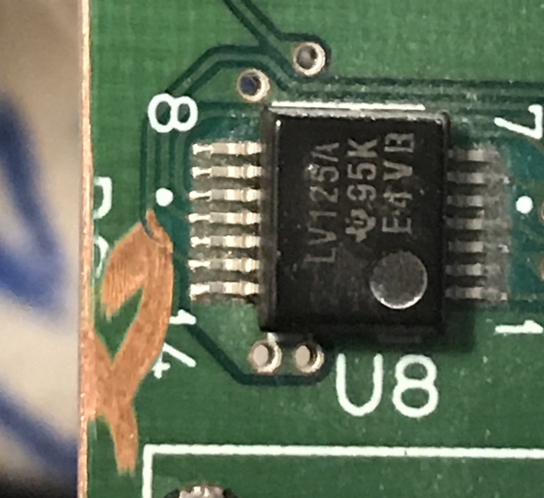

Well. I found it. I don’t know how I managed to miss this the entire time. So should I just cut off the U8, or what? Pretty sure I’ve read somewhere that that’s possible if you just bridge certain pins on the PIF. What do?
I don’t remember what rev this is exactly, it’s been a while since I’ve cut the top of the board. It’s definitely a later rev though. Not sure if that changes anything with the U8/PIF
You could use some 30-38 gauge magnet wire, scratch the mask off the trace a bit further up from the swoosh, and solder a small wire from the U8 leg to the scratched trace. That'd restore functionality, assuming it's the only problem. You'll just have to cut the trace just above the swoosh, it looks like it's bridged to the ground plane.
