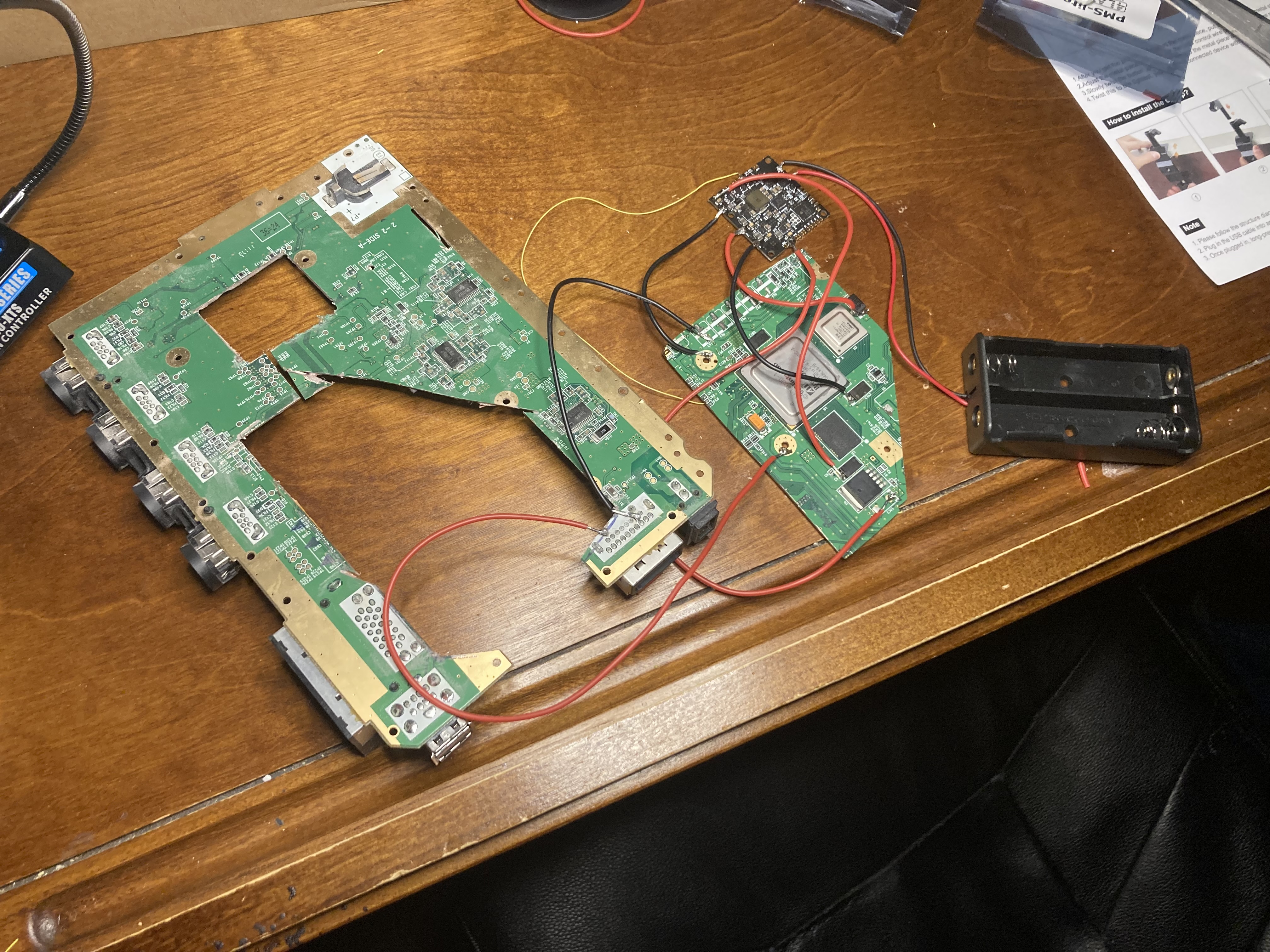

Heres the first actually worklog of the hard modding:
First thing done is the trim, it seems good, as I cut as little as I could to ensure not accidentally cutting anything important. I then sanded the MX chip and main trim with up to 800 grit. I then had enough time to wire all the voltages and u10. After realizing that I didn't have any good way of video out besides the screen for testing, and have no hot air station to remove the Wii audio and video out slot, I wired the trim directly back onto the rest of the board left over, for video out when ready to test. All I have to do before testing is wire the PMS PD to the Lite and hook it up to a screen. So far, nothing(hopefully) not working or going wrong.
Here is the final result as of now, apologies for any bad wire management, today was trying to get done as much as possible.
That looks like a series battery holder, it'll output 7.4v. If you connect that to the PMS battery pads it could kill it
Good catch! But wouldn’t it be fine anyway if I only put in a single battery while testing? Wouldn’t that keep the output around the 3.7v of the battery with the output only being 7.4v if I did both? I could be wrong, I’m a bit tired atm, I just wanna make sure I don’t make any major mistakes
With only one cell, yes, but you'd need to solder a wire to the rear contact of the holder. As it is now, putting one cell in will do nothing
Pretty much. If you parallel the cells you can solder the two existing wires to B+, and solder a new wire to the rear terminal for B-
