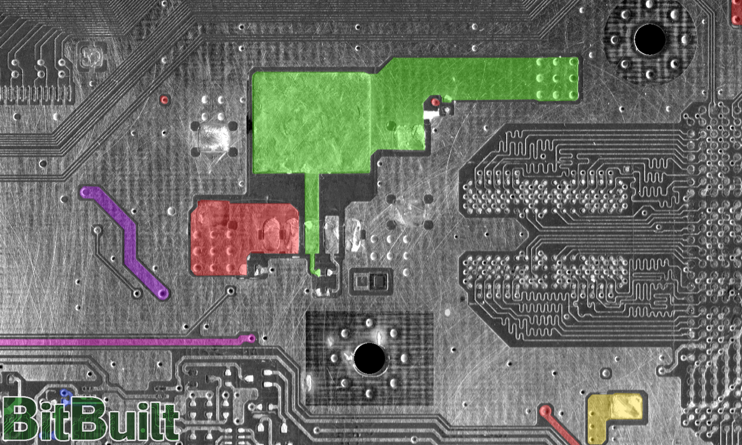

This is a scan of the top layer of the Wii near the LDO, you supply 1.8v to the green bit.
Thank you for this detailed help, so i see that only cutting the legs of the LDO is enough i can just cut the legs off and desolder them and connect the 1.8v to any where in the green are , am i right ? aesthetically its more pleasing to remove the whole thing but since its stubborn and heating that part of the board isn't smart action since beneath it there is bios chip and SMT elements on the boards are very fragile , i think if you guys say thats ok i might just do that, since GND is one of the legs and by disconnecting it we open circuit and practically we remove the LDO from our circuit only 1.8 v could travel back into the LDO and thus by disconnecting it from GND i think that wont happen , am i right?
For safety and good practice, you want to remove the whole LDO
