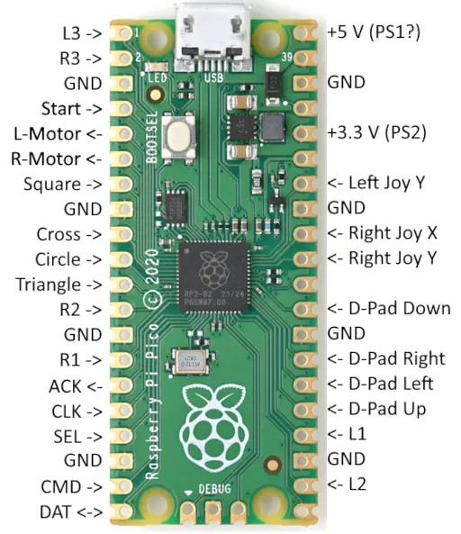

As of this posting, the v0.1 firmware is mostly functional on a stock Raspberry Pi Pico connected as follows:
Only the left analog stick and select button are unconnected without modifying the Pico and/or firmware config. A FET is required to drive each of the vibration motors also.

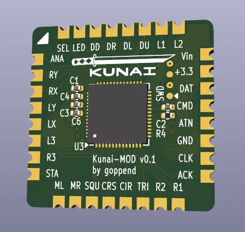

The Kunai firmware is better experienced on the reference hardware implementation, though the version currently on the repo has some hardware bugs, this will be remedied soon.

Looks like a fantastic alternative, and it's great to both have a drop-in custom board as well as an alternative firmware for the standard board.
In my personal opinion, I would find it more useful to have Left analog and Select over the two motor pins, as I have yet to want to integrate any rumble feature into my portables.
Additionally, having the analog button would be potentially useful (for PS1 games), though that's another GPIO pin that would be needed.
Same issue with a lack of GPIO, but it would be very cool if someone also integrated button combos for various things, such as console reset or analog toggle.

Thank you for the feedback! Those are fair points, what I showed above just happens to be the pinout on an unmodified Pico. The analog and select buttons and the left analog stick are all supported, just not on a stock Pico without modification. The module PCB I developed supports the full button set and rumble motors without too much hassle.
Button combinations are a cool idea. I'll certainly add it to the wishlist.

Here's a small update since I had some time over the last week to work on my v0 prototype.
I've managed to program the prototype, though I haven't had any luck getting it to do anything. All signs point to the RP2040 being completely dead or inactive at best. Maybe someone out there could point me in a direction that could help me diagnose the issue? I followed a guide to program the flash chip via SWD with another Pico, and it seems to program and verify OK. I'm holding on to my belief that this shows that the micro isn't dead, but I'm starting to doubt this.
That being said, I've found a few bugs in the hardware that could be preventing the RP2040 from showing life:
First I found out the LDO regulator I have in the design currently has too high a drop to run off of a console. To temporarily remedy this, I bypassed it with a small bit of wire. This is a bit risky since providing anything higher than the max of 3.6 V could damage the RP2040 and I've heard that some consoles may provide 5 V, though I haven't personally seen this on any of my North American consoles (SCPH-7501, SCPH-75001, and SCPH-7900X) or my Japanese PSX (DESR-7100). This uncertainty is why I added the regulator in the first place, so before connecting it I'm making sure the input voltage is safe. For the future, I replaced the old regulator with one that has a lower dropout voltage (a NCP115AMX330TCG has 215-260 mV and it's replacement is a STLQ020C33R that has 15-160 mV), and added a 3.3V input to the previously NC pin 23. A better approach could be to use the exact same regulator as on the Pico, but I'm concerned that adding more components to the bottom of the board would make assembly unnecessarily more complex.
Next, I found a more serious error I made in the design, the ADC_AVDD pin was pulled to VSYS rather than 3.3 V. I fear this may have killed the RP2040, but I'm not really sure how to confirm this further than building another without this connection.
I've updated the design files to remedy the above issues and I'm calling it v0.1. I haven't pushed these to the repo yet, and I wouldn't recommend ordering PCBs until I get the prototype working. I'm hoping that I can do this soon and move forward with application testing, building a controller and playing some games with it.
Thanks for reading!
