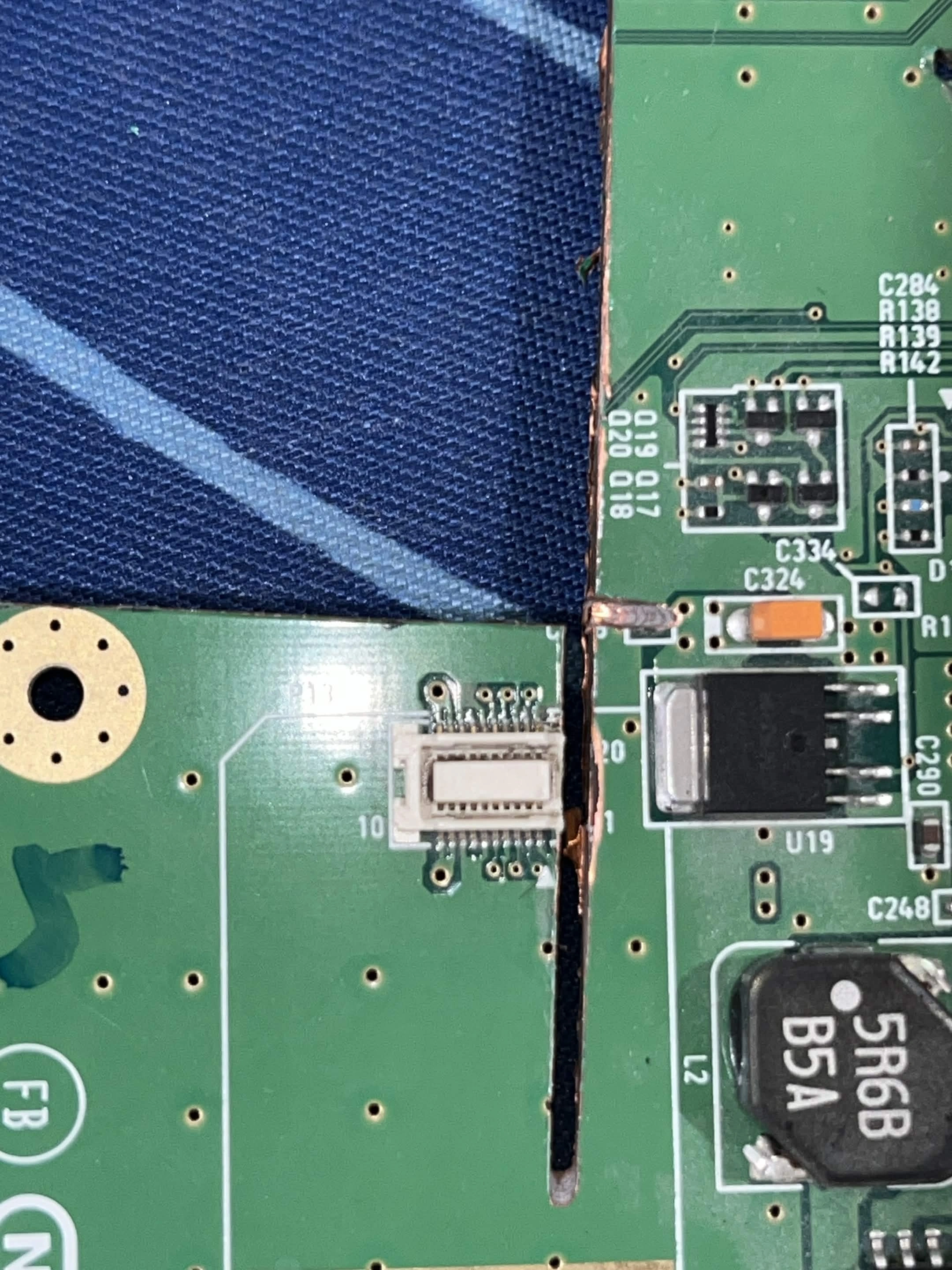

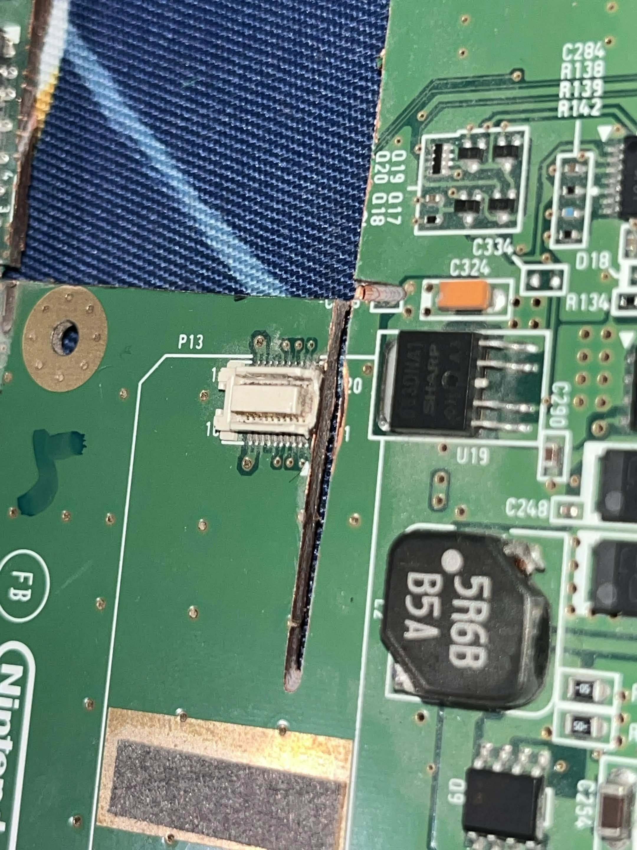

From the looks of it i only got the plastic housing, if this connector isn't worth my time, is it possible for me to just get another by itself somewhere else? I kinda wanted to keep it in case I decide to reconnect wifi to the portable. I apologize for blurry pics I can take more if needed

If you want to relocate the Wi-Fi module back into your portable you don't need this connector anyway. You just handwire it or use the Wi-Fi flex Cable to install it again :)
  • Like
Reactions: Nex
Like Samlam said, you don't need that connector and it won't fit properly. I do recommend to already remove the connector on the module itself since removing it makes it easier to solder to the module.
I wouldn't really recommend adding the module if you aren't planning to use it since it can cause a lot of frustration. (Wires breaking causing the wii to not boot, also bit hard to place it correctly so it doesn't add pressure to the screen)
