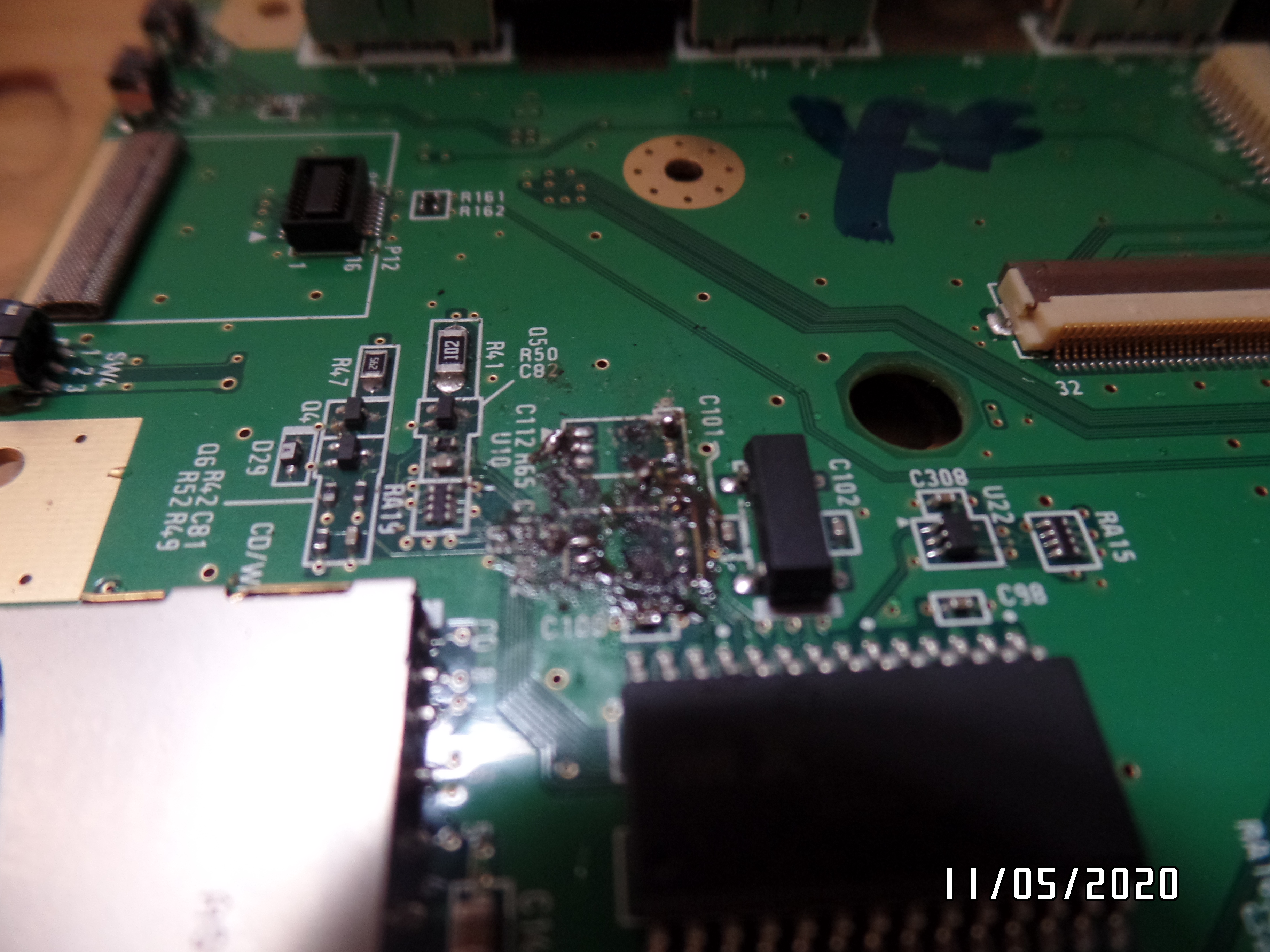

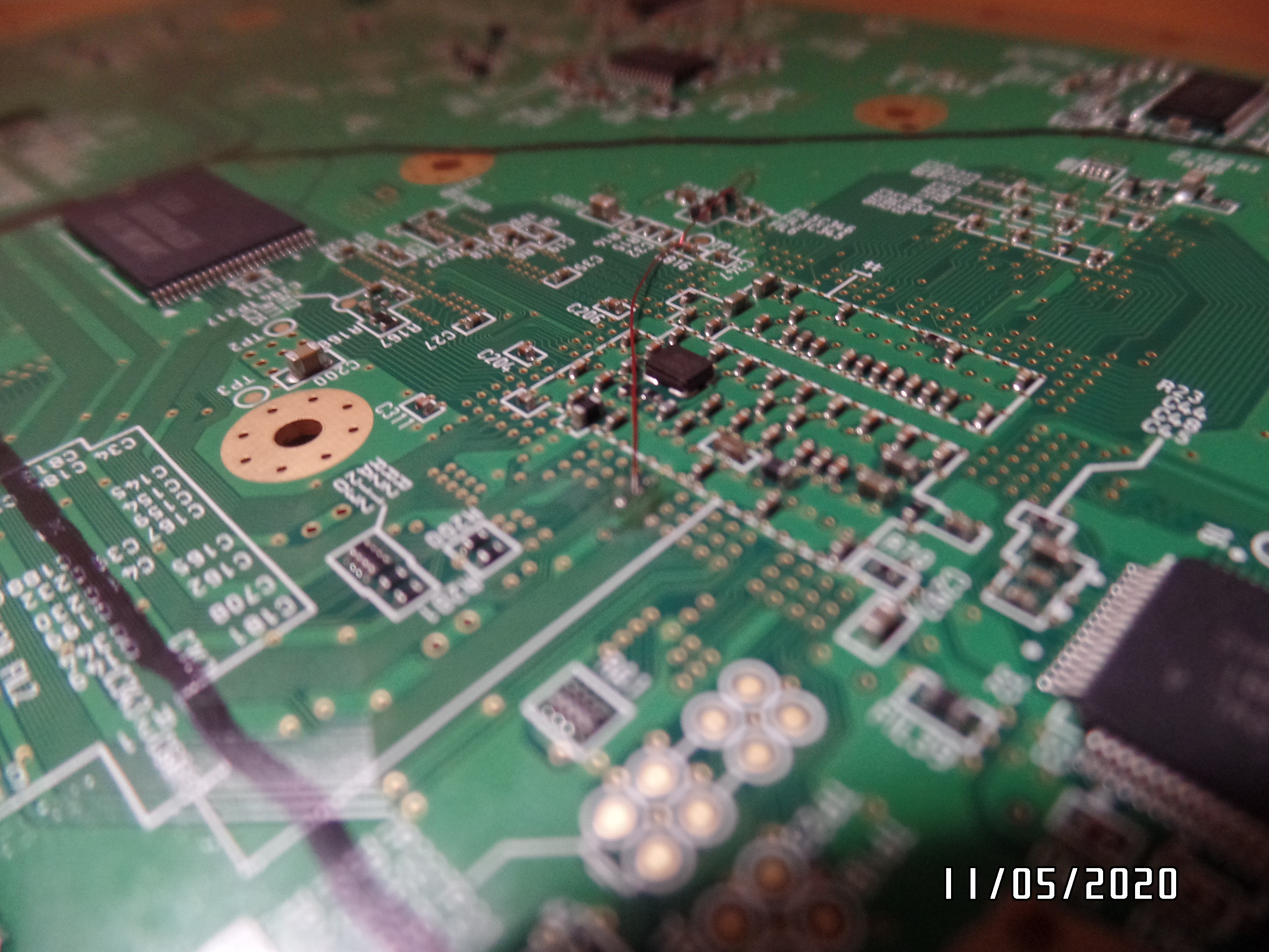

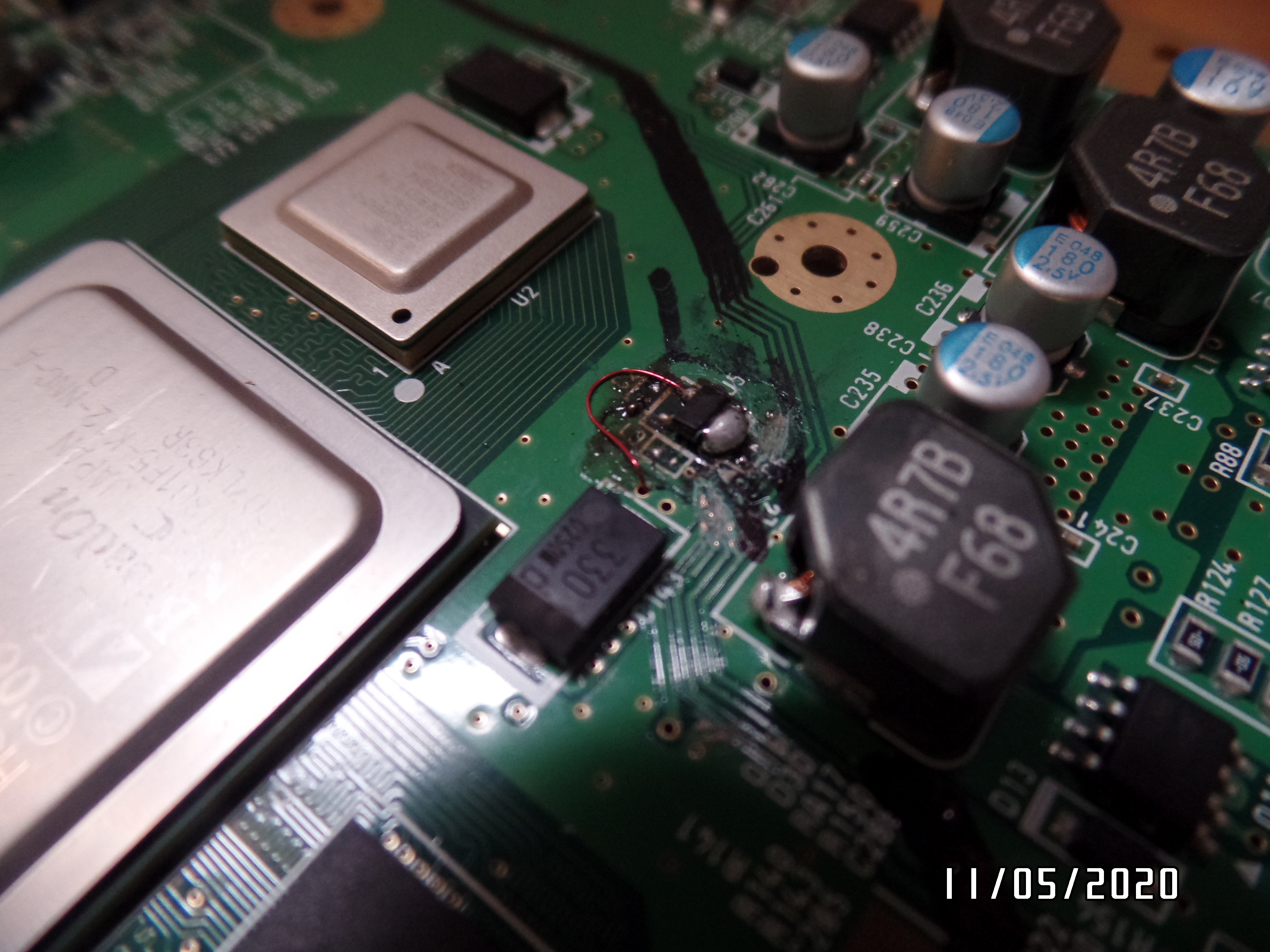

Here you go.
Here is the U10 Relocation. You can see where I scratched at the traces, as I forgot to do that befor attaching the U10
This is where I soldered the GPU wire. I hope this is the right spot.
This is where I destroyed the U10/U9 area. I hope this is'nt a critical area, or at least that I can stil use the MX chip.
Chean that shit up pls, then bridge the two pads where U9 used to be or it won't boot.
I know. But I accidentally desoldered some resistors close to the U9 solder pads 4 and 5, and I am wondering whether those are preventing the wii from booting. I have tried shorting the pads together, by the way, and it still doesn't work. :facepalm:
I dunno those pads look ripped
They pretty much are, yeah.

Yeah you'd have to disassemble it, best to hold off. Also don't short the cap pads together, that'll ground the voltage lines which will stop everything working. Clean the board and unshort the cap pads, if it still doesn't turn on, I'm out of ideas we'll need a smarter person.
What exactly do you mean "unshort the cap pads"?
-EDIT-
I did some soldering and it WORKS PERFECTLY!!!!
Thanks for the help Stitches and jeffery!
