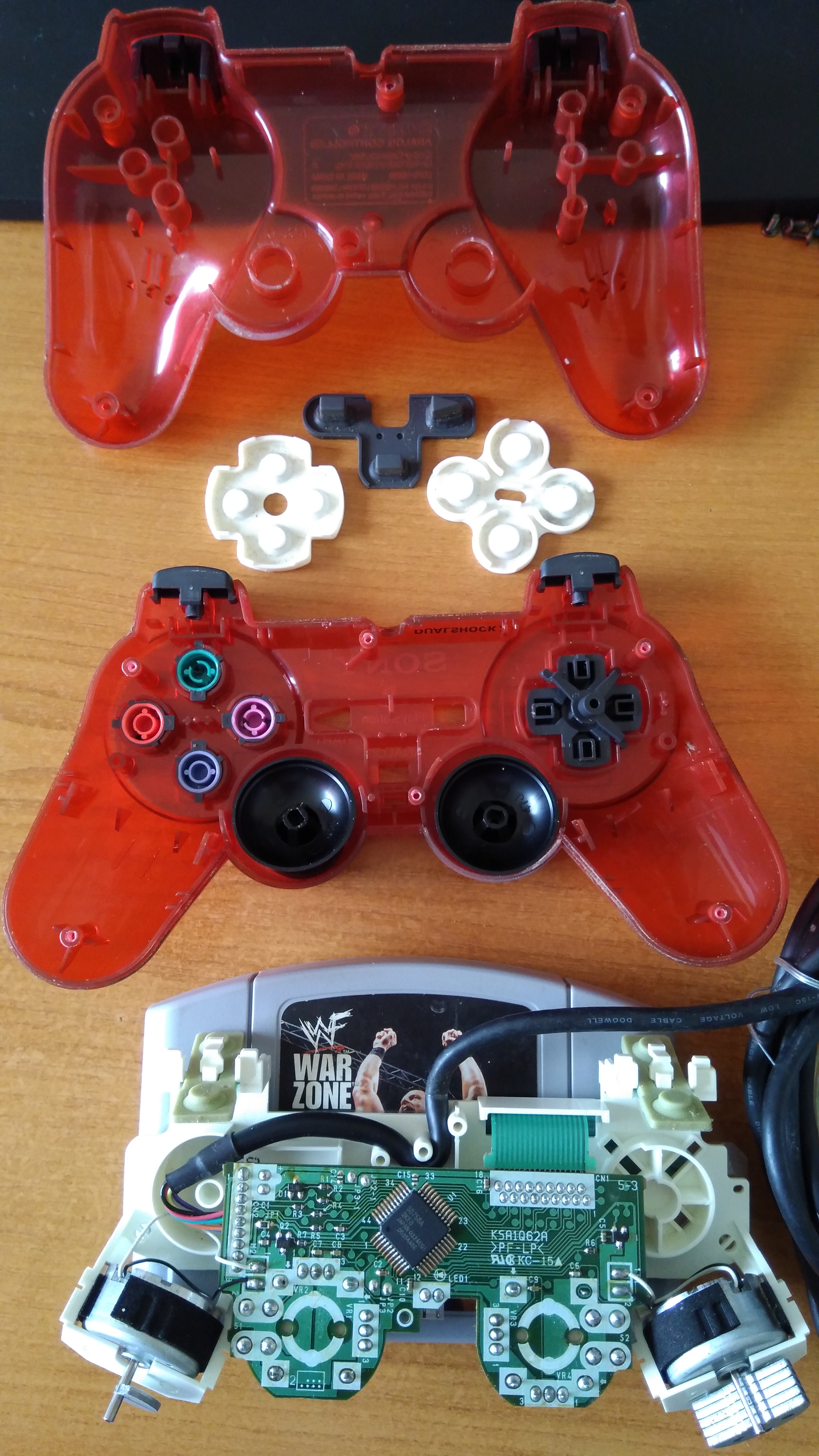

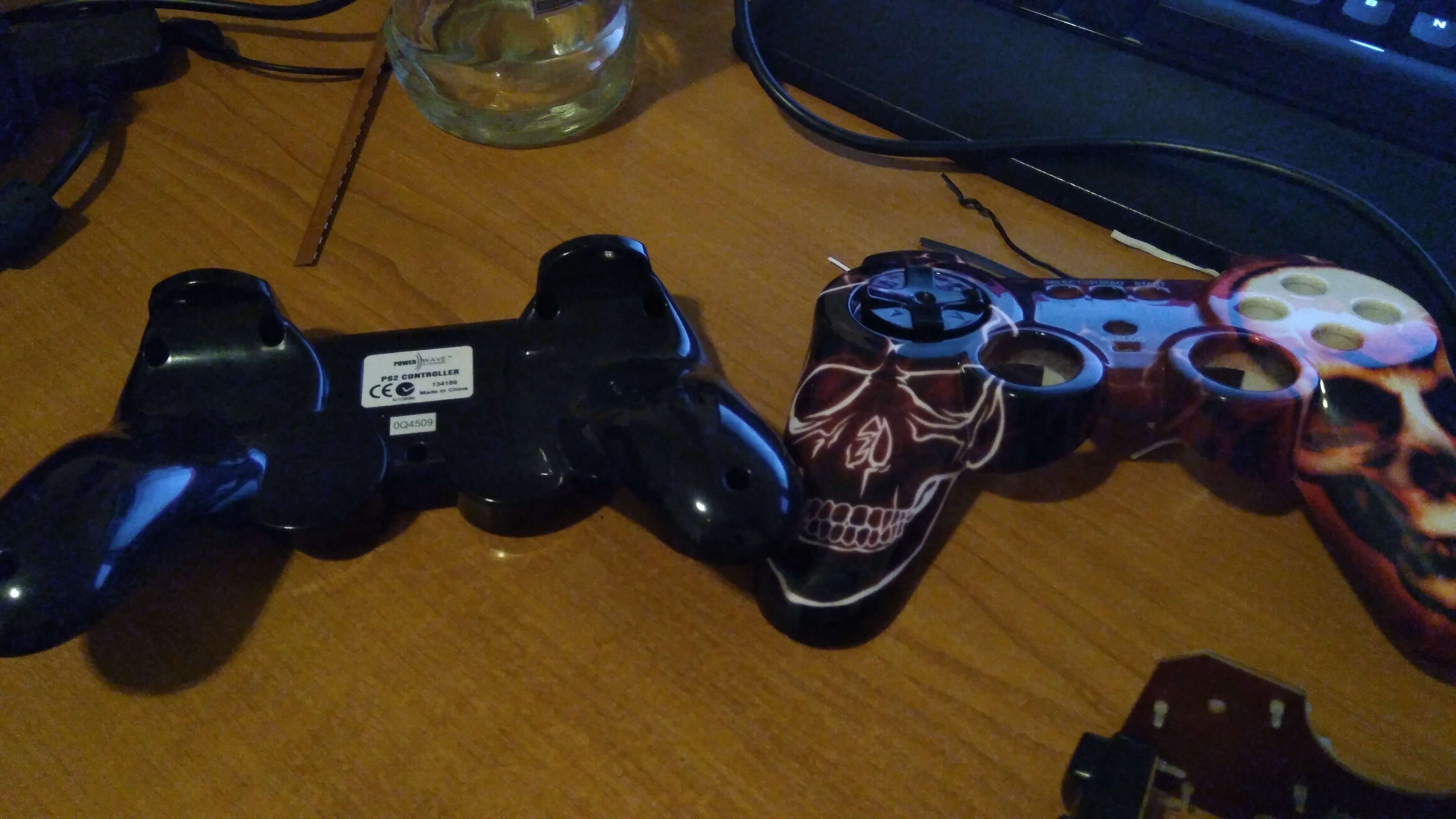

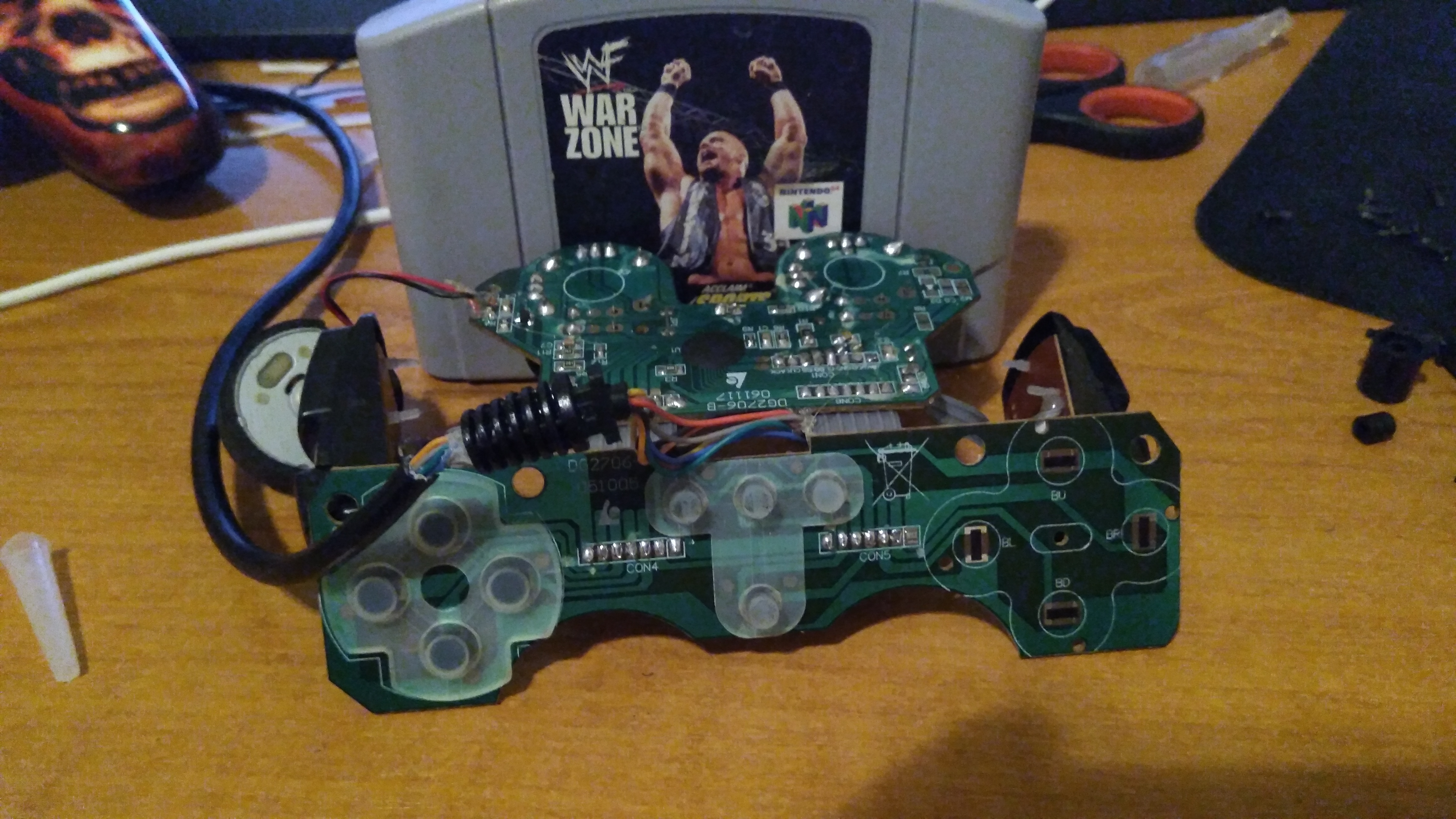

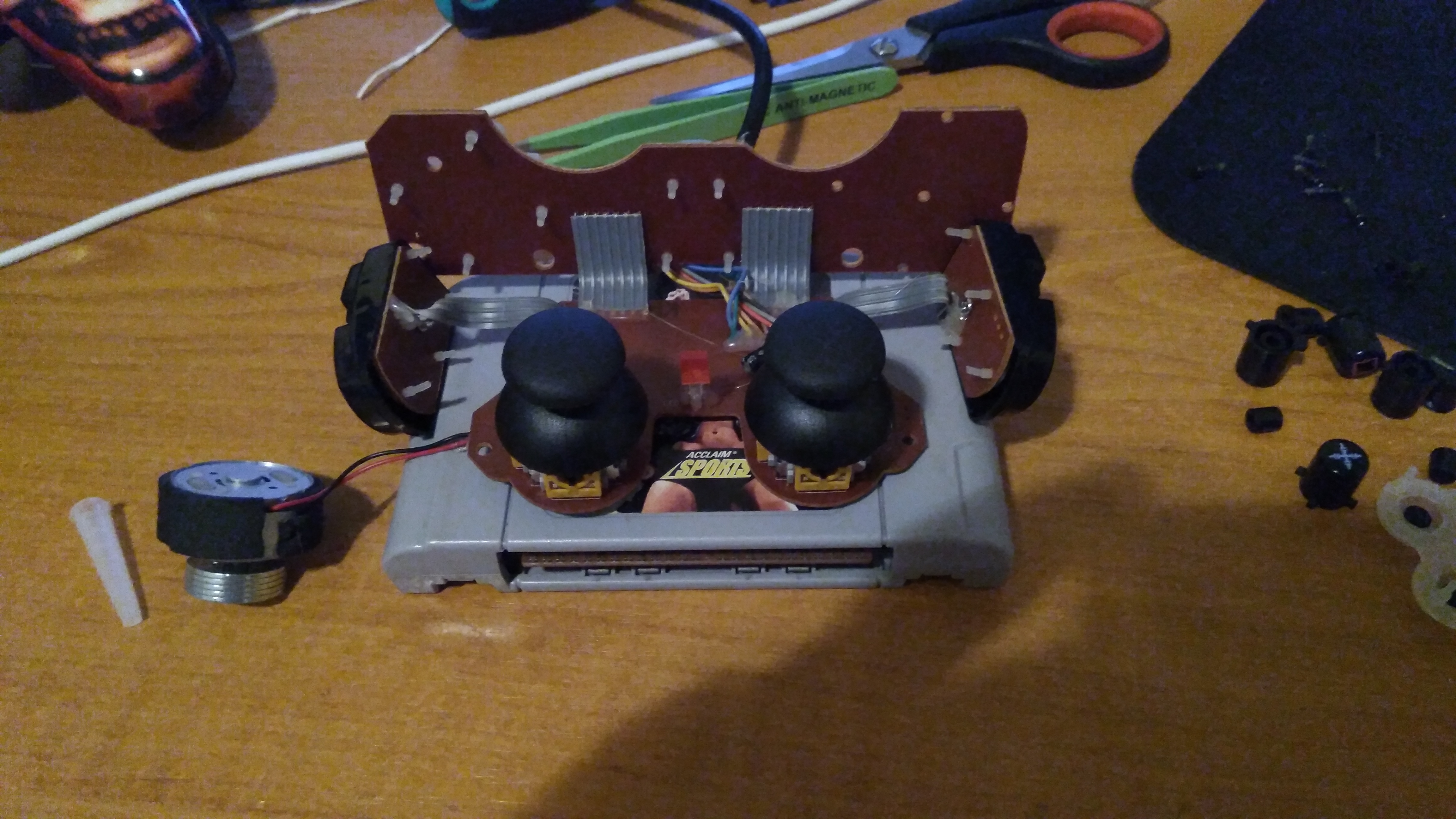

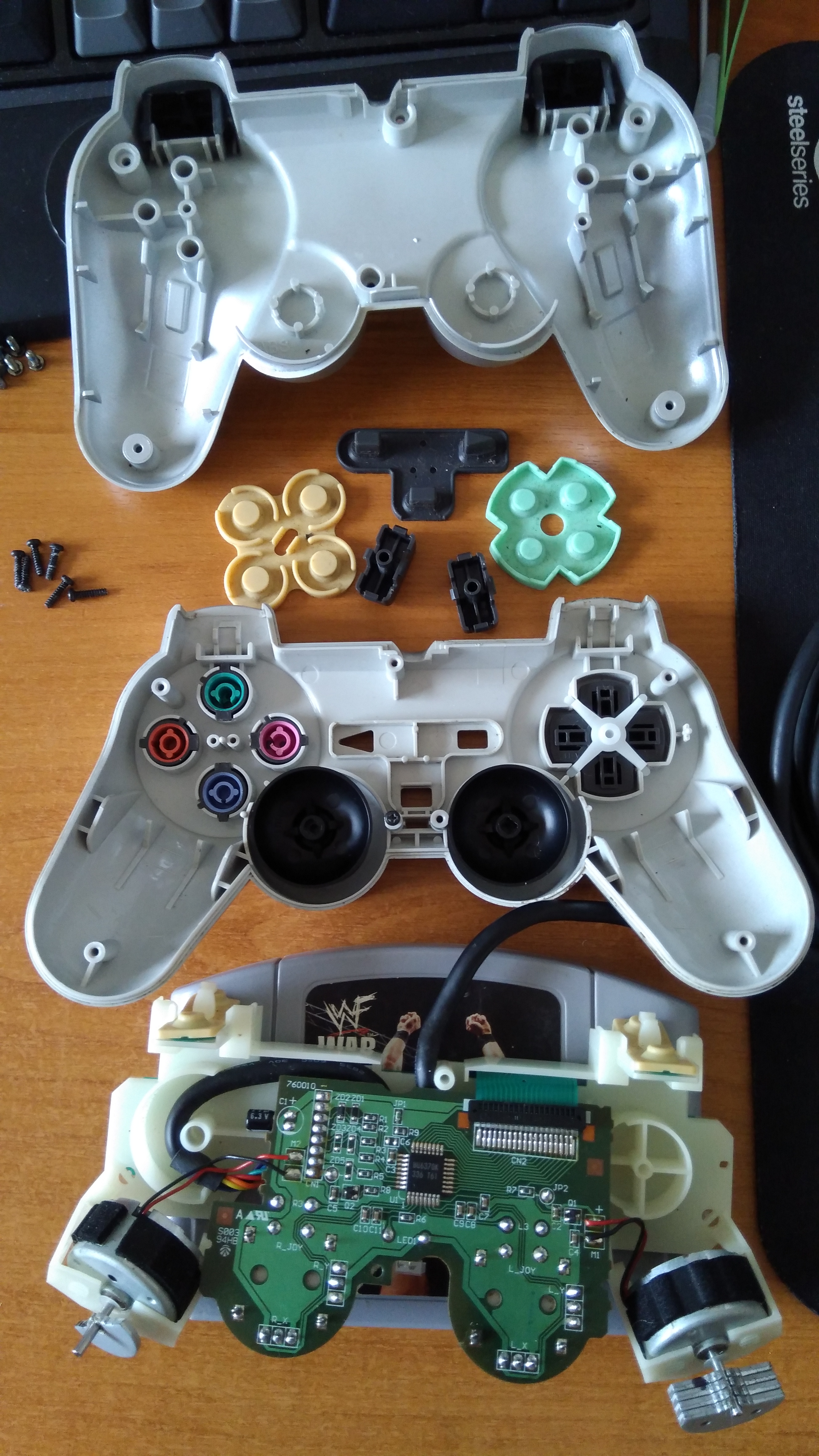

Here's a controller that was sold in Australia that I bought in around 2010. Its a Power Wave controller and the board is probably the smallest Ive seen for a PS2 controller. n64 cart for size comparison

Holy crap that's small! I've actually finished my little project, but oddly enough since starting this thread have had people asking me about controllers lol - if anything I'm loving seeing posts like this roll in as they're not all made equal!
From memory the silver controller is newer so you can see the changes that were made over time(check start/select/analog area, screw post holding in the controller board on the silver, i could also take the button thing off the red controllers board but not the silver one)
