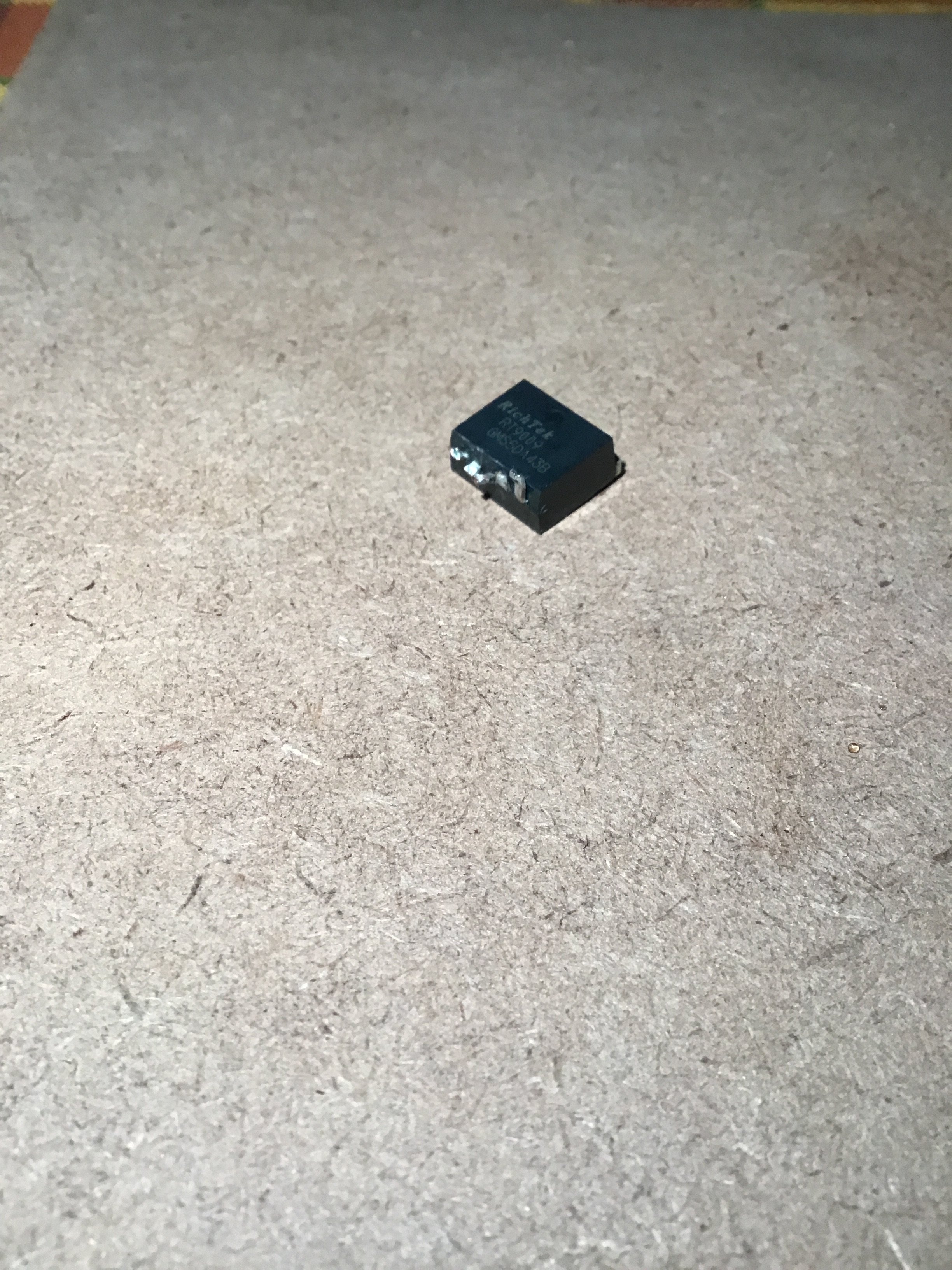

Hi everyone, I’ve recently fried my PMSv1, so I ordered a PMS-lite, but I noticed the LDO is now required.
I was very lucky to find my LDO with other trash components, it’s not in perfect condition so I would like to test it somehow.
Do you know how to test it with a multimeter?

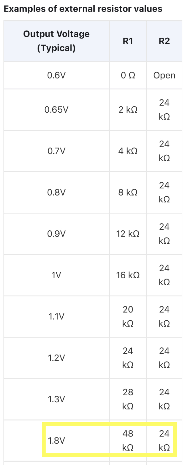

Thank you for the answer, what voltage should I put in Vin?
3.3v, but you'll first need the two RSET resistors to configure the output to 1.8v. Without the correct resistors, it'll output the wrong voltage and will probably fry your 1.8v line

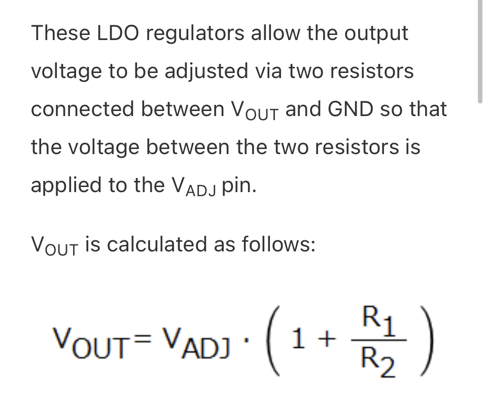

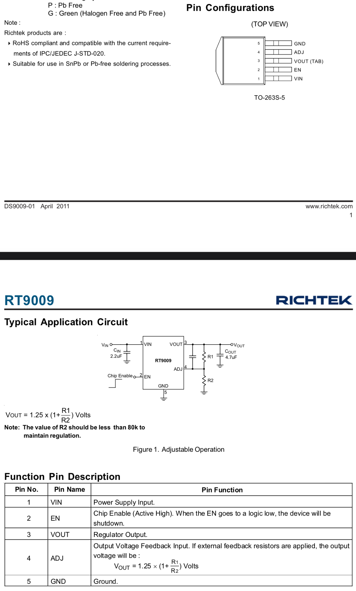

I found the right datasheet of LDO the Wii uses:

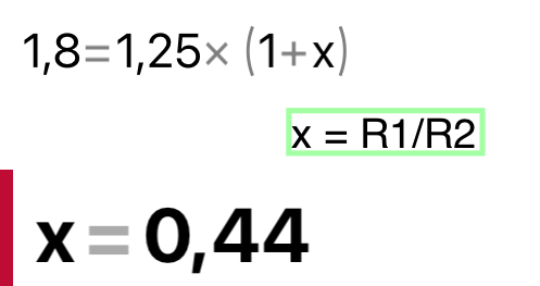

Solving a simple equation:
I need to test the R1 between pins 3 and 4, R2 between pins 4 and GRN on the Wii motherboard.
So R1/R2 should be around 0.44
