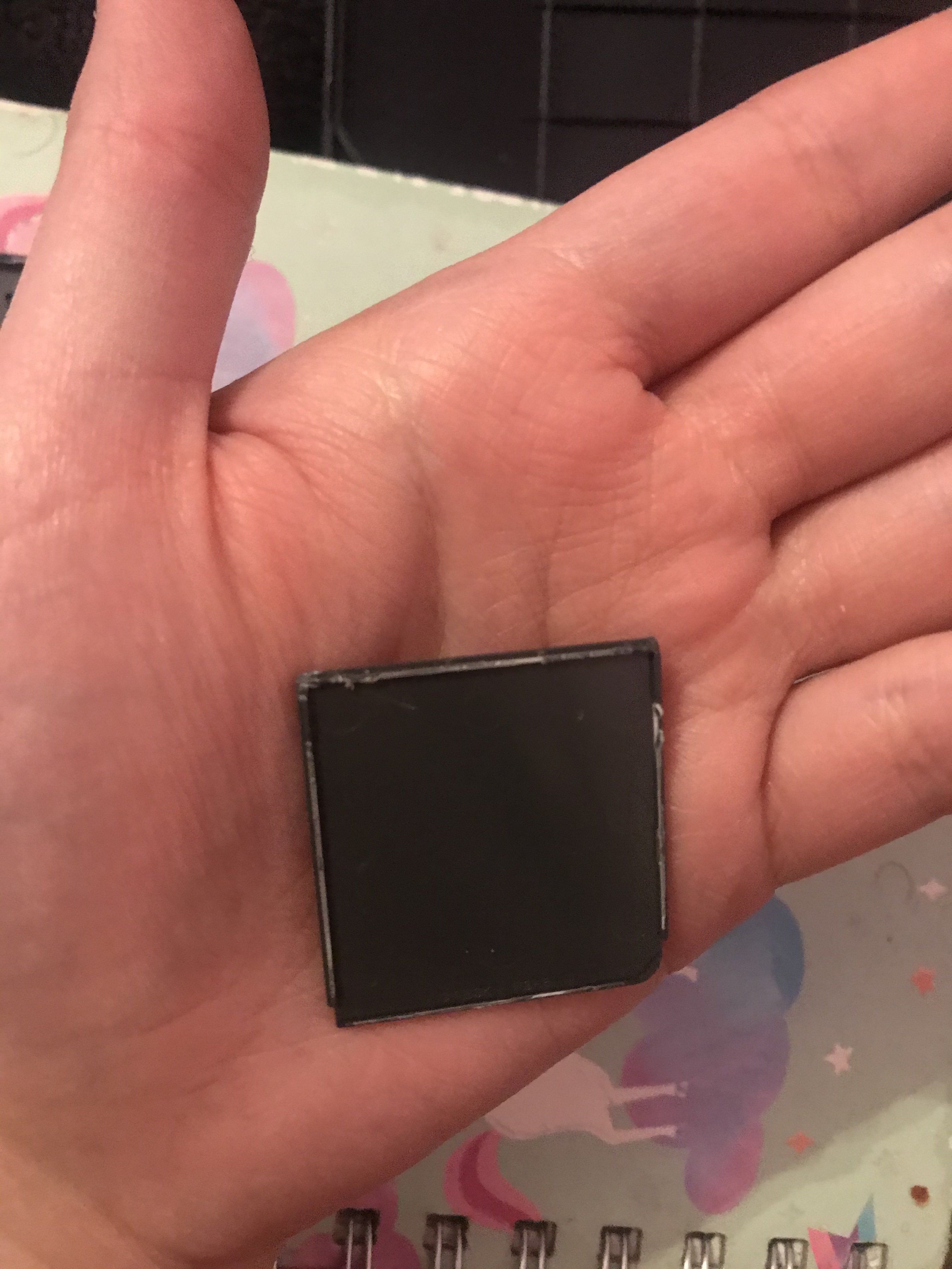

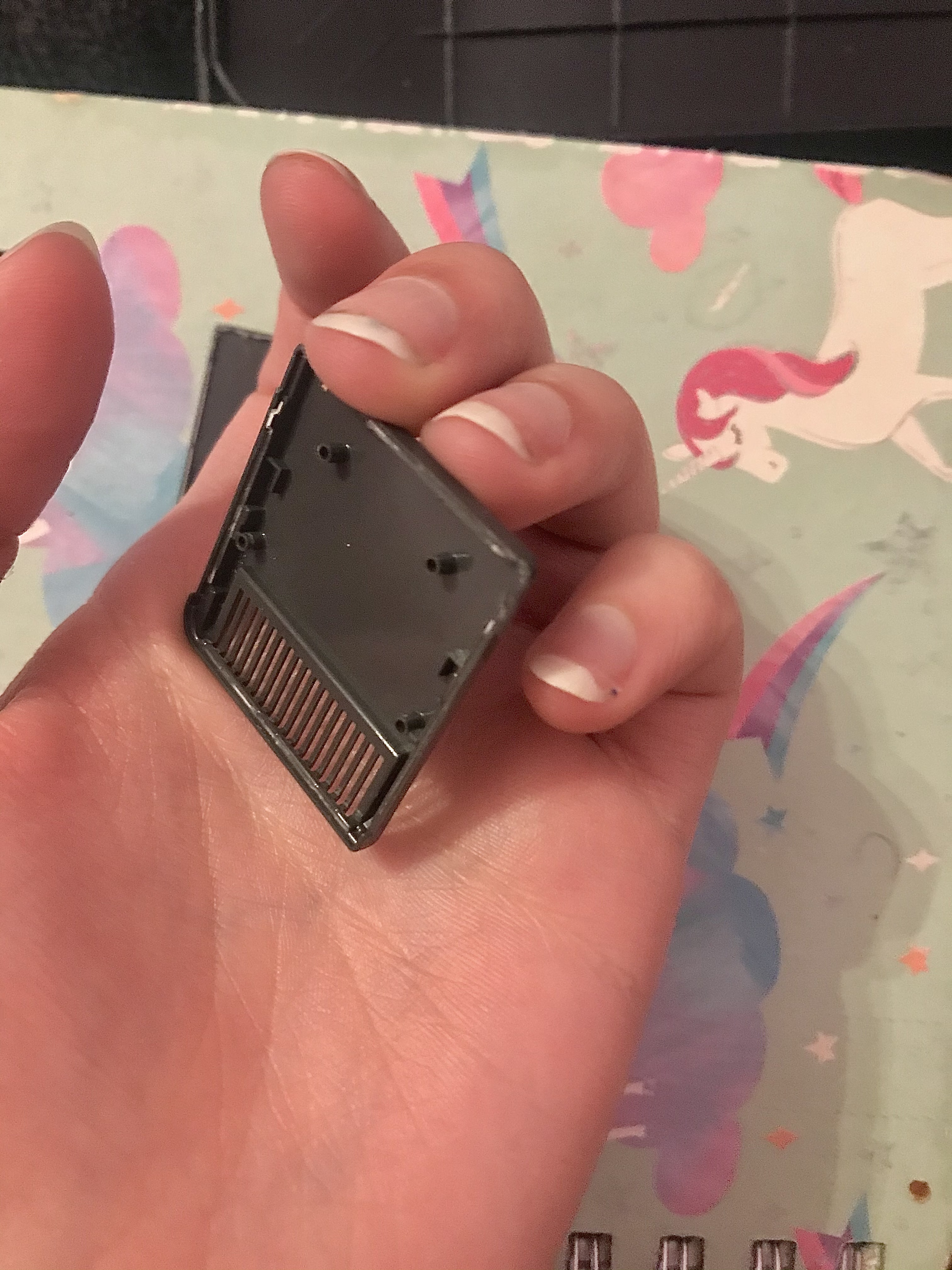

Currently my first obstacle is with taking apart the cart in a neat way. All the tutorials I found online boiled down to sticking a tool in the groove and prying the DS cartridge apart, and well....I got it apart
But I also damaged the shell pretty badly
Any cracks, scuffs and scratches that happen to the shell will end up transferring over to the mold and then the final piece. Obviously I don't want that. Since I ended up with a crack that split the front half down the middle, that sacrificial cart is pretty much useless to me now and I'll have to try again with another one. Any tips on how to get the next one apart as cleanly and neatly as possible?

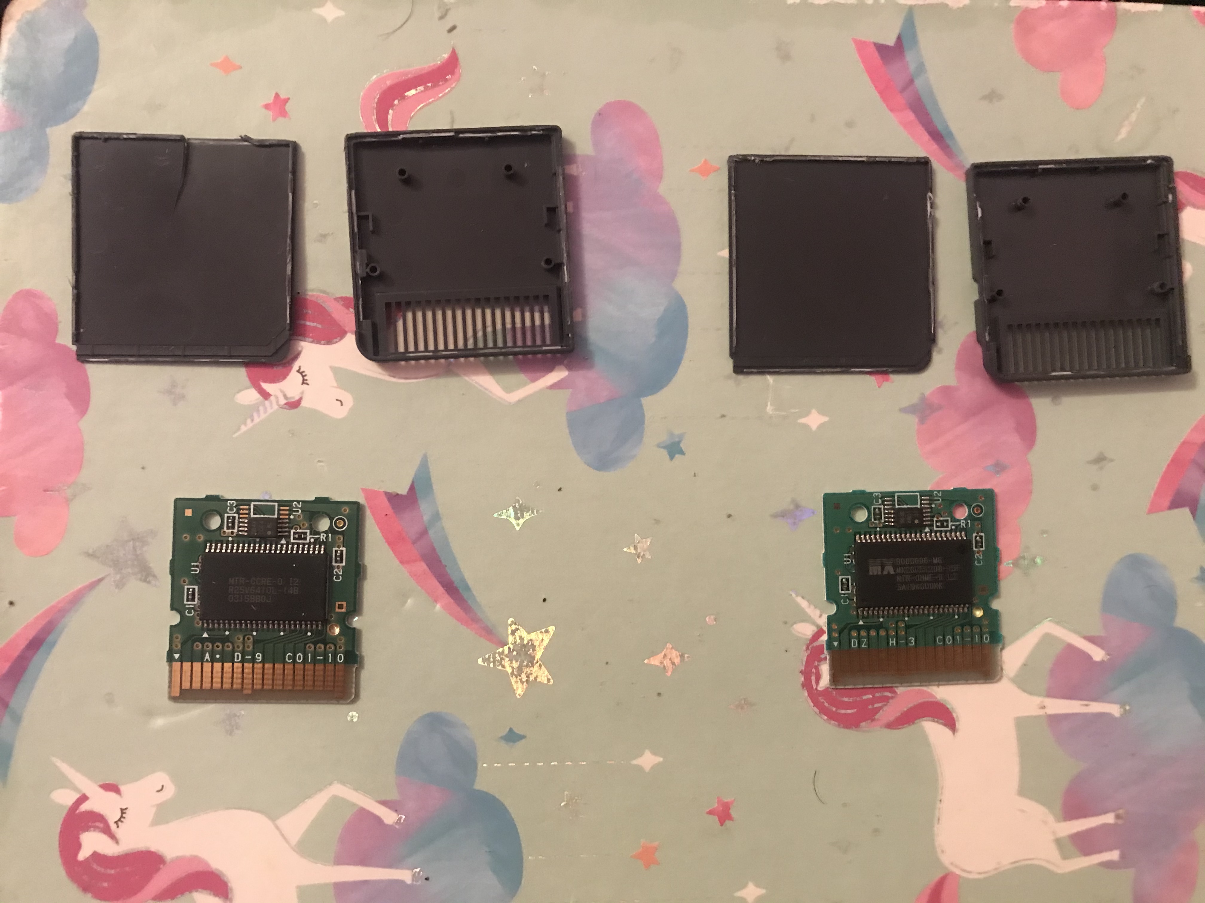

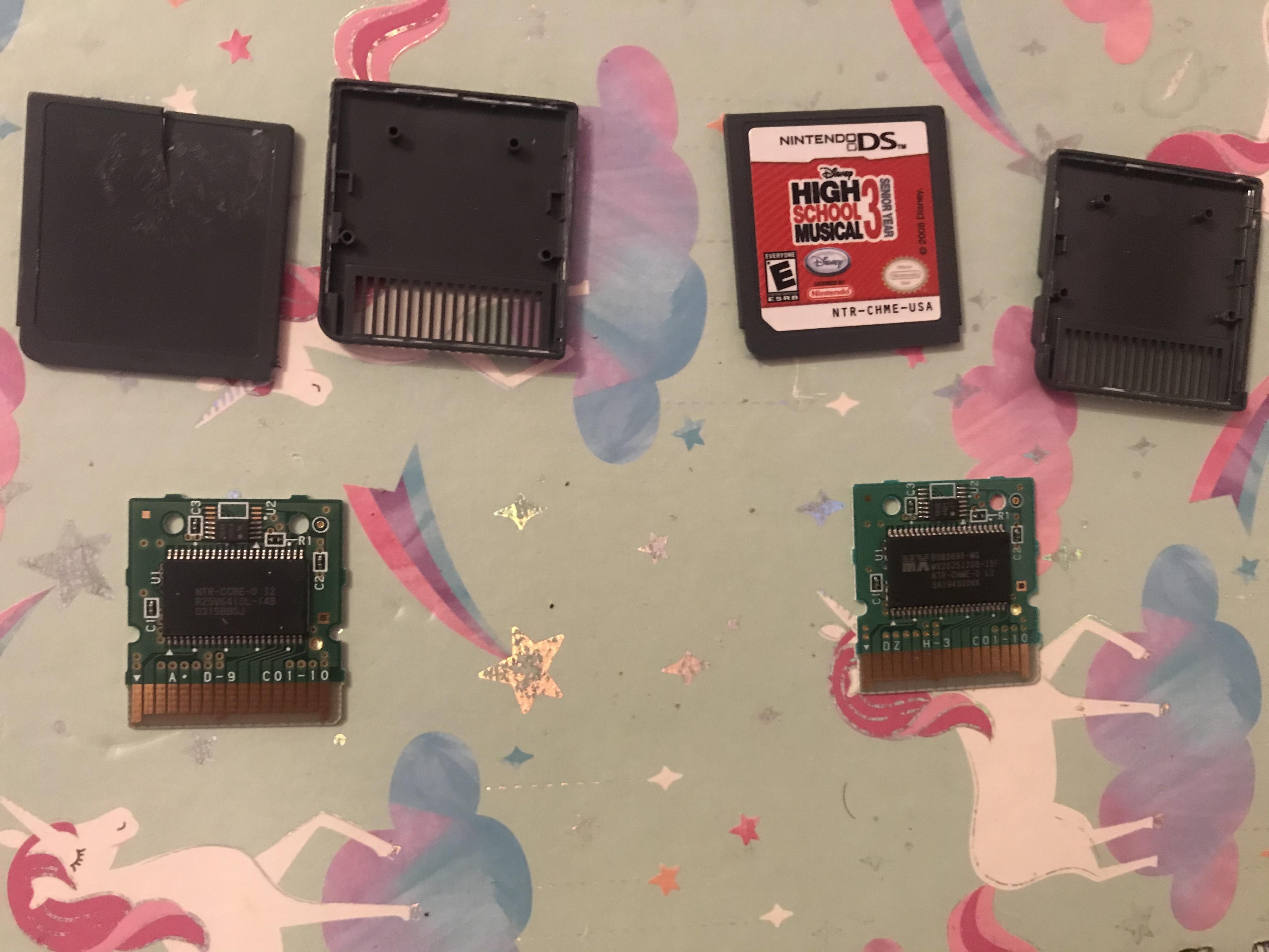

attempt #1 on the left, attempt #2 with steaming on the right

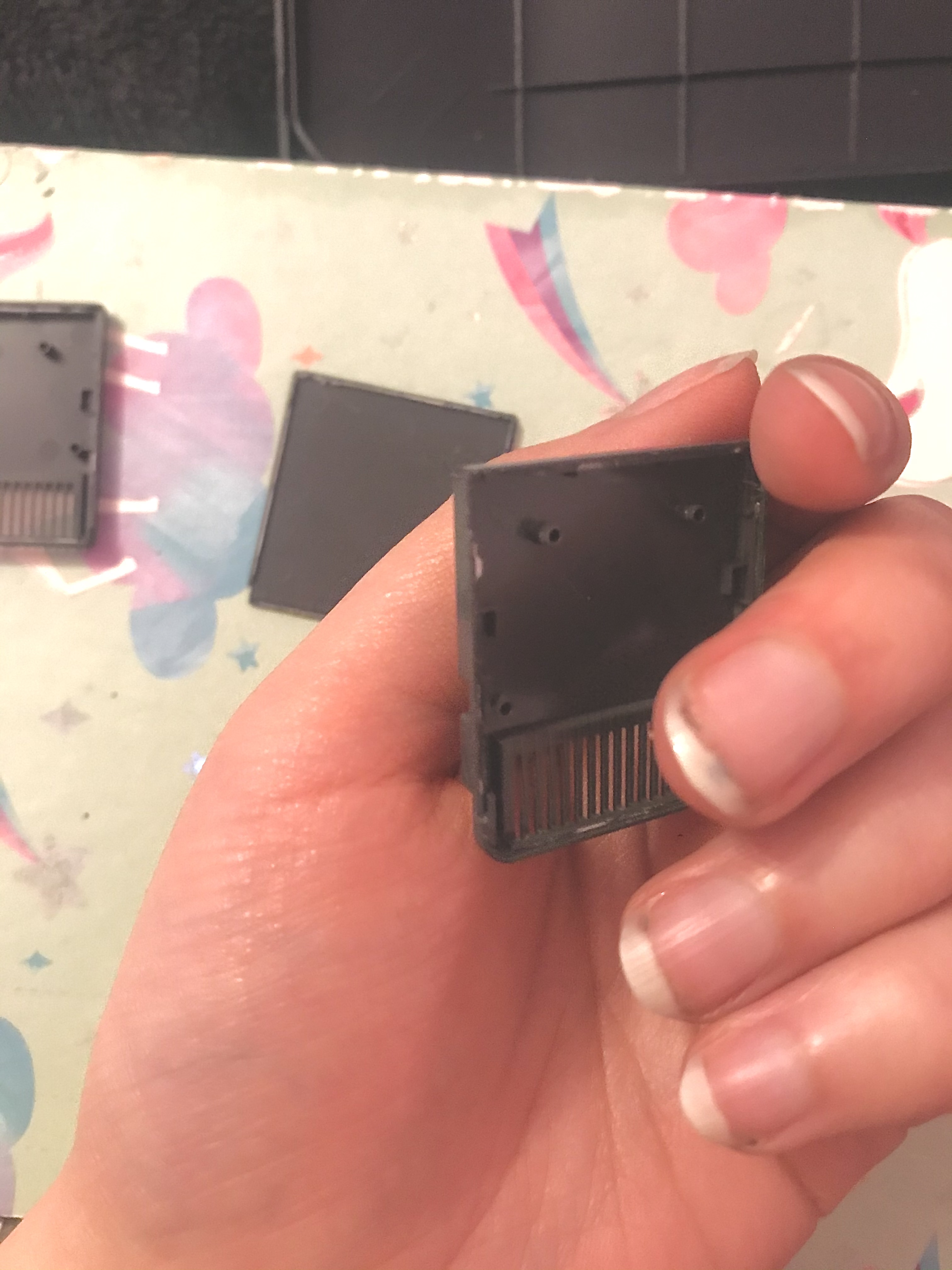

its definitely a cleaner dissasembly. Not perfect, but much much cleaner. I essentially just threw a glass measuring cup in the microwave for about 4 minutes to get it boiling and held the cartridge over the steam. It took several steamings and prying inbetween, but eventually it came apart

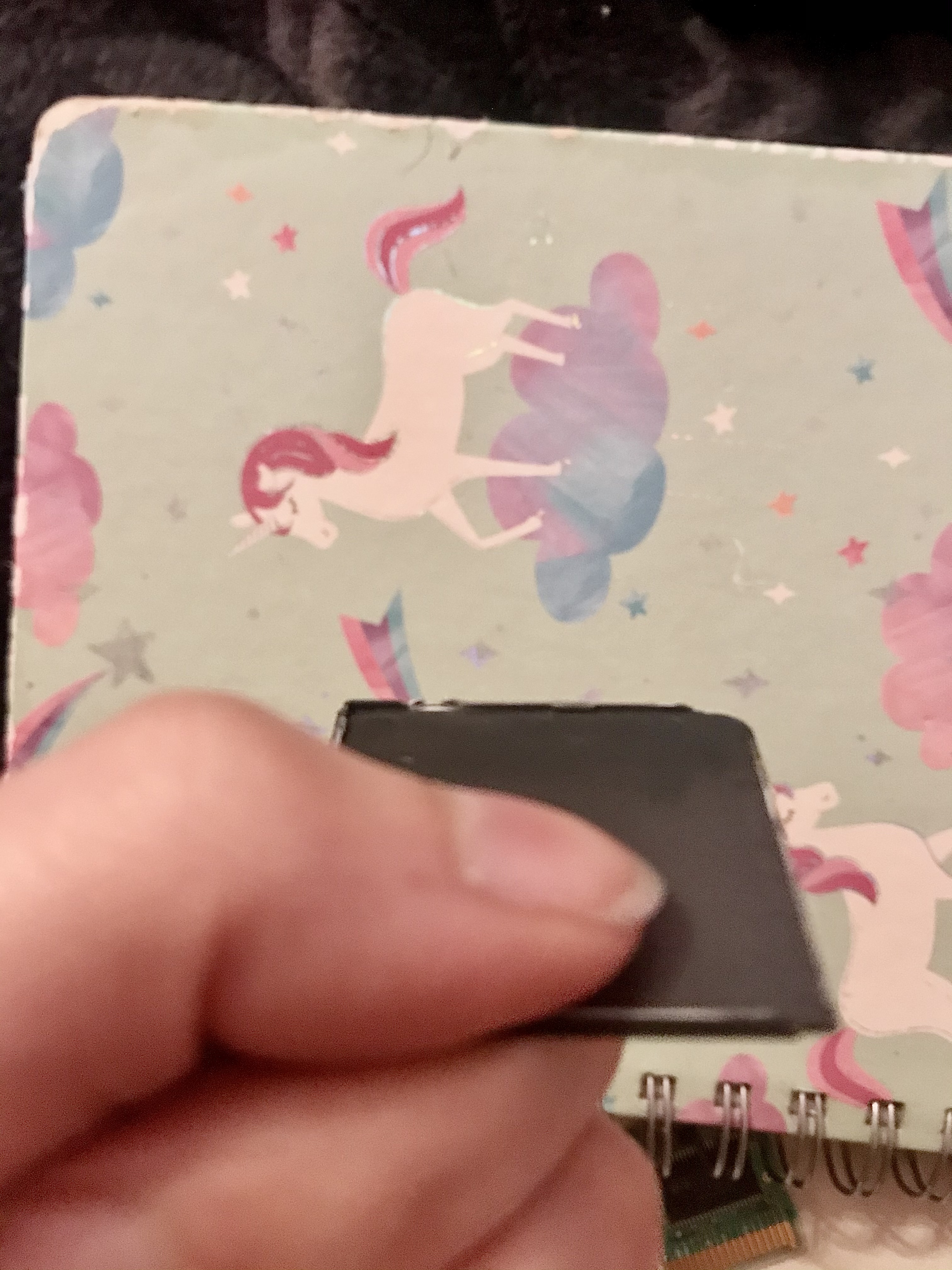

but not quite perfect. Still some scuffs and scratches, particularly in the corners where I was sticking my metal prying tool. I also tried sticking it into the grooves on the sides to seperate the two halves, and I think that’s where that lil nik in the side came from. The metal tool scratches and marks the plastic pretty easily. The corners kinda look mishapen as well. I *could* work with this shell, but a part of me wonders if it’d be worth my time to try again with a third cartridge and use a plastic tool instead
