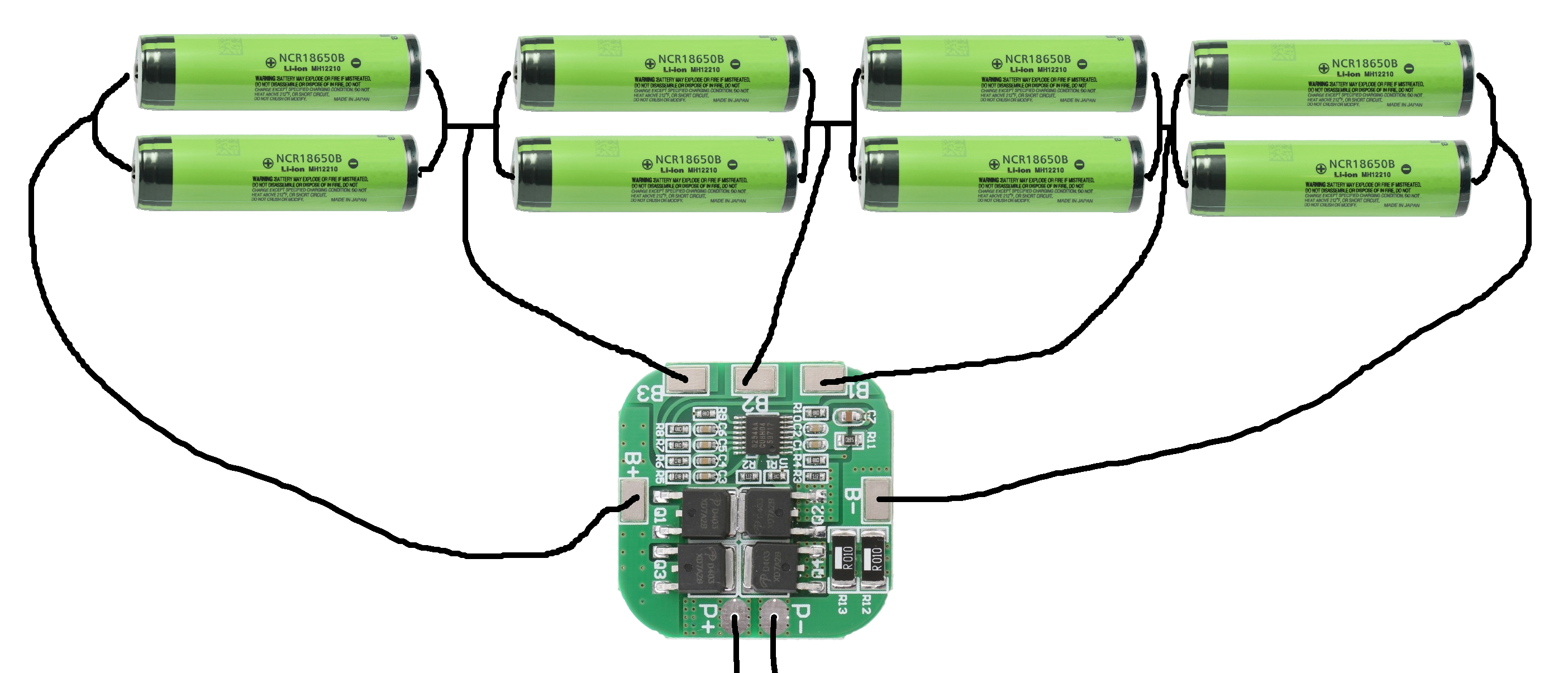

rrrrmrmr . Joined Dec 15, 2021 Messages 20 Likes 5 Mar 20, 2022 #23 What would be the best way to charge the 4s battery?
Stitches 2 and a Half Dollarydoos Staff member . . . Joined Feb 5, 2017 Messages 4,631 Likes 3,580 Location Banana Bender Land, Australia Portables 6 Mar 20, 2022 #24 rrrrmrmr said: What would be the best way to charge the 4s battery? Click to expand... Define "best way to charge"?
rrrrmrmr . Joined Dec 15, 2021 Messages 20 Likes 5 Mar 20, 2022 #25 Small, cheap and unlikely to break quickly

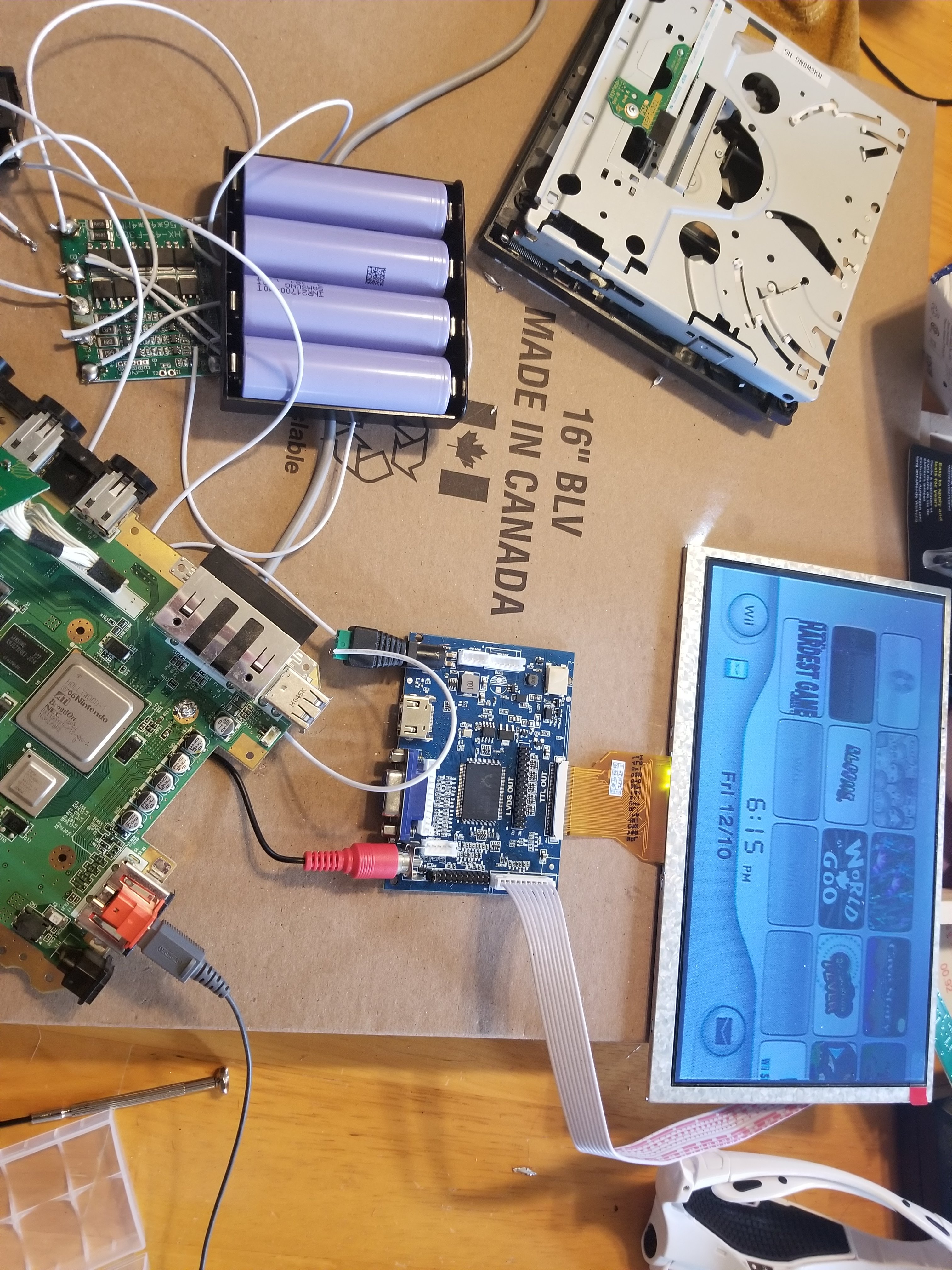

Viilmo . Joined Jun 23, 2021 Messages 223 Likes 114 Location Germany Portables 2 May 16, 2022 #27 rrrrmrmr said: Almost done View attachment 22496 Click to expand... You should install RVLoader even if you won't trim the board.You have easier accesses to starting the games since you wont need the sensorbar. Also you can use vga with it what makes the image way cleaner and sharper.

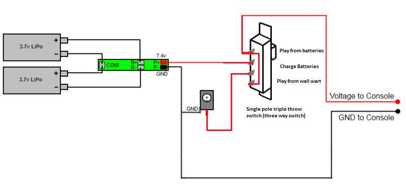

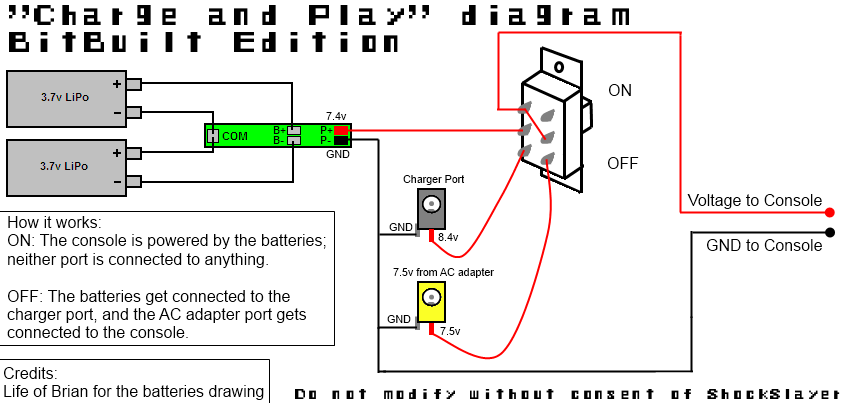

DiamondBuildsWii202 . Joined Dec 21, 2021 Messages 35 Likes 1 May 20, 2023 #28 Can we make that charge or play diagram work with a 2p3t switch instead of a 1p3t switch? Last edited: May 21, 2023
