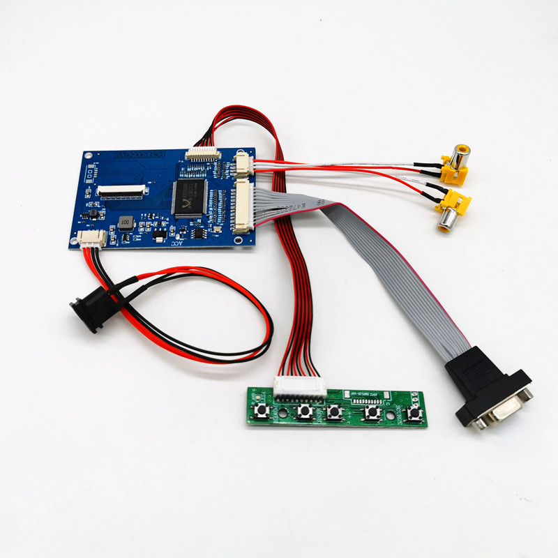

I found this photo on Ali Express, just don’t know what buttons do what

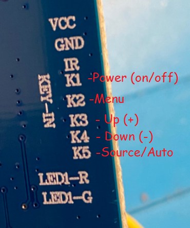

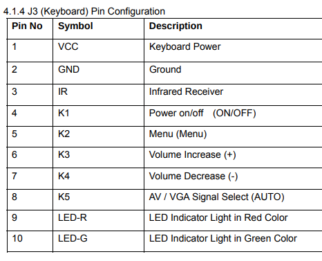

K1-K5 are the input pads for the screen controls. You can find out what pads do what by soldering a wire to a ground location and poking the K pads with the other end of the wire. Once you know which pad corresponds to which button, you can look at either wiring buttons for them or using CrazyGadget's OSD control board
I ended up getting my hands on that break out board in the photo above, and verifying the following controls:
I just tried this without luck. Shorting K5 to K4 didn't work for me. I had to short K5 (Source/Auto) to Ground to change the input. Hopefully, this helps someone else in the future. :)
