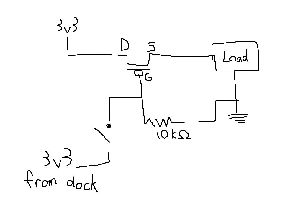

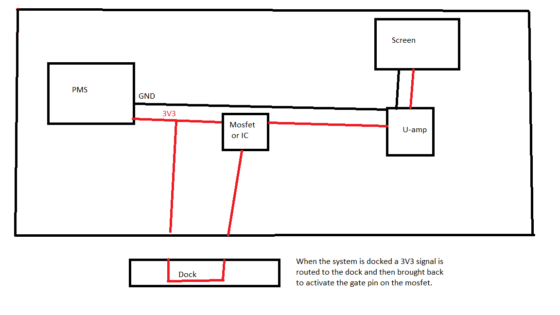

Hello, I'm currently working on my second portable and I wanted to challenge myself to make my own PCB's for this build. Basically I'm making a Wii portable and I want it to have a dock that has an HDMI out port on it. When the system is docked I want to turn the screen off and cut off all audio from the handheld itself. My idea I have to accomplish this is to just cut off the 3V3 power source to both the screen and the U-amp board that I am using but I'm having a little trouble designing a circuit that is normally closed and then becomes open when the system is docked.
Could I simply just use an N-channel depletion type mosfet for this purpose? I would have the 3V3 line going through the mosfet from source to drain and then when the system is docked a power line would come from the dock to activate the gate on the mosfet thus breaking the circuit to the U-amp. If I did do this, would I need any other passive components or would just a mosfet suffice?
And if the Mosfet thing wouldn't work, would an IC like the TPS2024 or BD82042FVJ work in it's stead?
Any help would really mean a lot as I don't have any experience in designing circuits and I've had a bit of a hard time figuring out this specific issue.

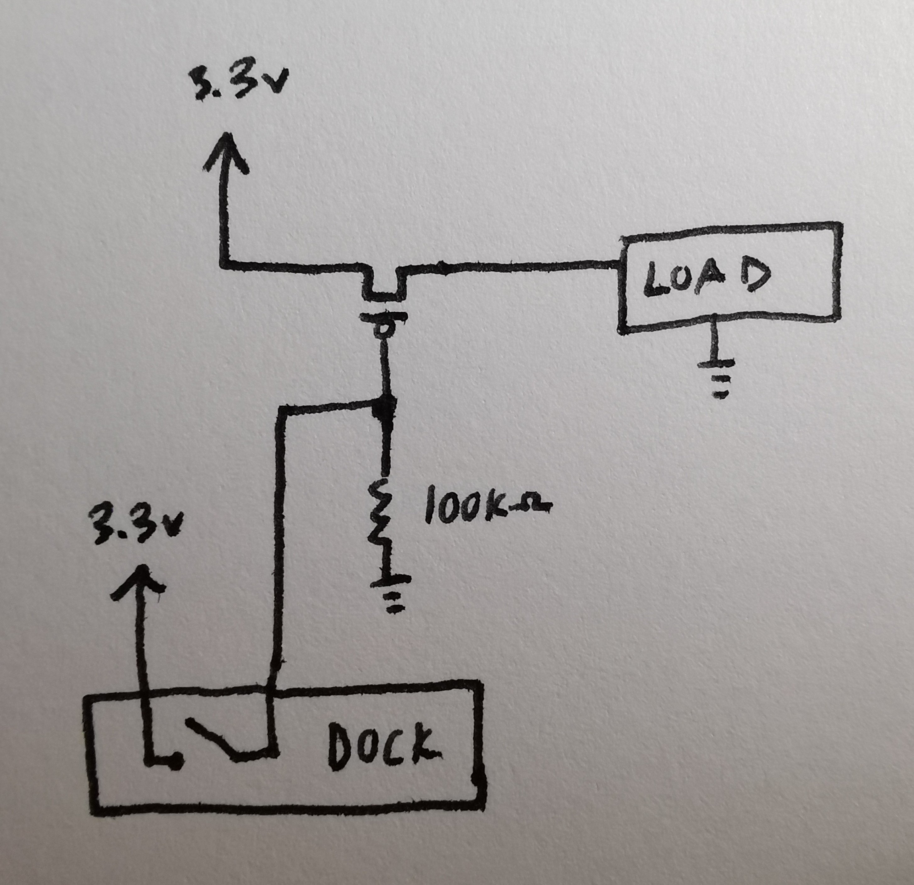

For high-side switching like this, you should probably stick with an enhancement-mode P-channel FET. Add a pulldown resistor in the range of 1k - 100kohms to the gate to make it "on" by default, and then have your dock connect the gate directly to 3.3v to turn it off.
Just make sure you select a FET that has a low enough Vgsth to turn on fully at Vgs = 3.3V, and has plenty of continuous drain current headroom for the full load you'll be passing through it. A quick search on Mouser shows tons of 3A+ p-channels in easy-to-solder packages like SOT23 and TSOP that would work well.

Thank you so much for the reply! I'll probably go forward with this approach then but I just wanted to make sure I understand it correctly. The MOSFET in your example would normally be off but because of the resistor connecting it to ground it's supplied a sufficient negative voltage to turn on, right?
I also had one more follow-up question to this. On the dock I will have gamecube controller ports and I want to switch the Player one data line from the internal GC+ to the external controller port when docked. I could use some kind of mux to switch between the two easily enough but since I will already be cutting 3v3 to some of the other components when docked, could I just have the data line split to connect both to the GC+ and the dock at the same time and then just cut power to the GC+ so it would be ignored? Or would using some kind of switch between the two be better?
Yep, P-channels turn on when the voltage on the gate is negative with respect to the source voltage.
I would use a mux for the controller data line, since you don't want the external controller to 'phantom power' the GC+ through its GPIO.

So I finally got my PCB's in using this circuit design and I'm not sure if I just got a mosfet that isn't suitable or if I messed something else up. The mosfet I purchased is this one (I also got this one as a backup). And my circuit looks something like this -
So it looks like I'm able open (close?) the gate just fine. With no input voltage from the dock and using the pull-down resistor I am able to get 3v3 to the load. But when I supply the dock voltage to the gate I still get a voltage reading of around 3v at the source pin where I would expect to get no voltage. I have also tried supplying 5v instead of 3v3 from the dock but I still get a voltage reading of around 2.8v at the source pin.
My guesses for what the issue would be are either
- that I need a mosfet with some different specs as this one isn't suitable with the wanted voltages
- or that the drain and source pins need to be reversed in my schematic
Any help is always appreciated. Thanks in advance!
