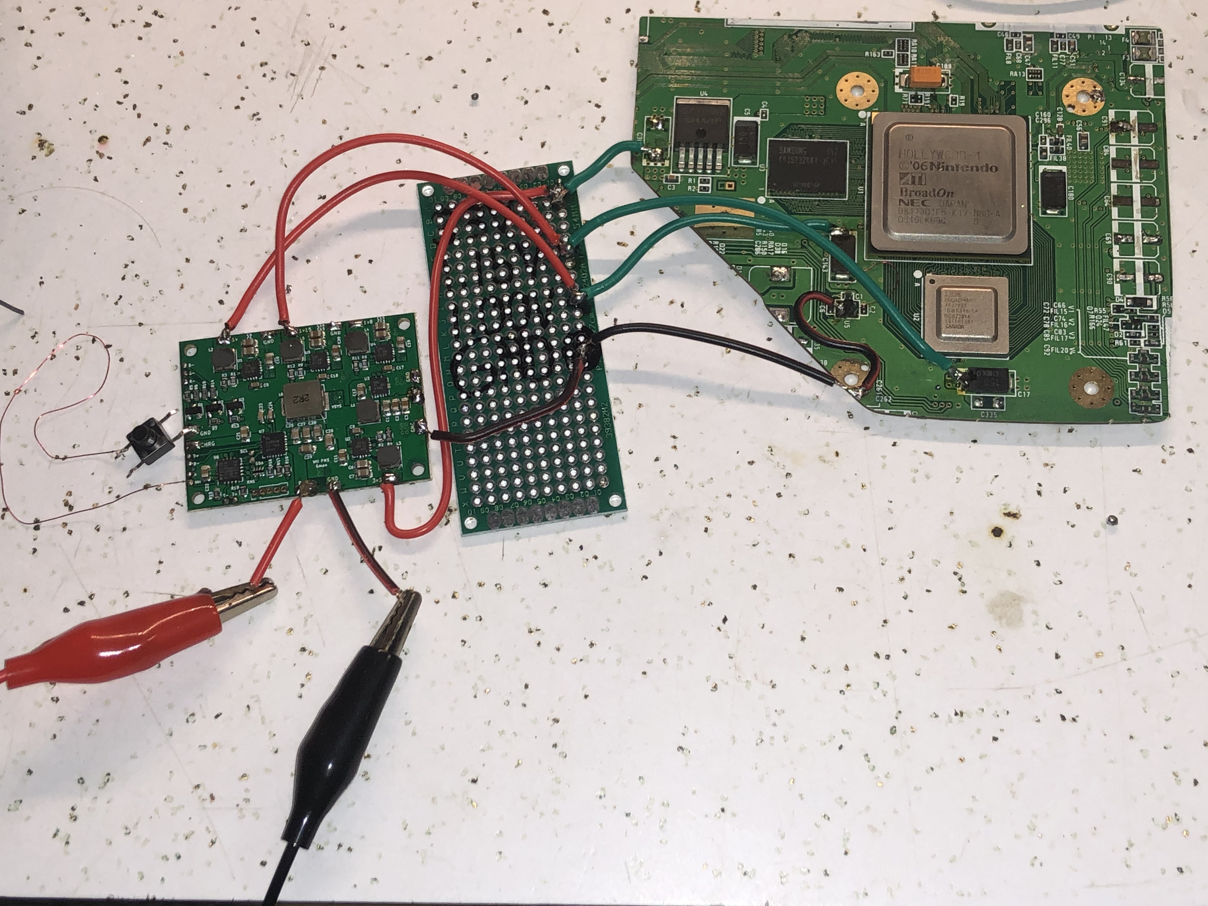

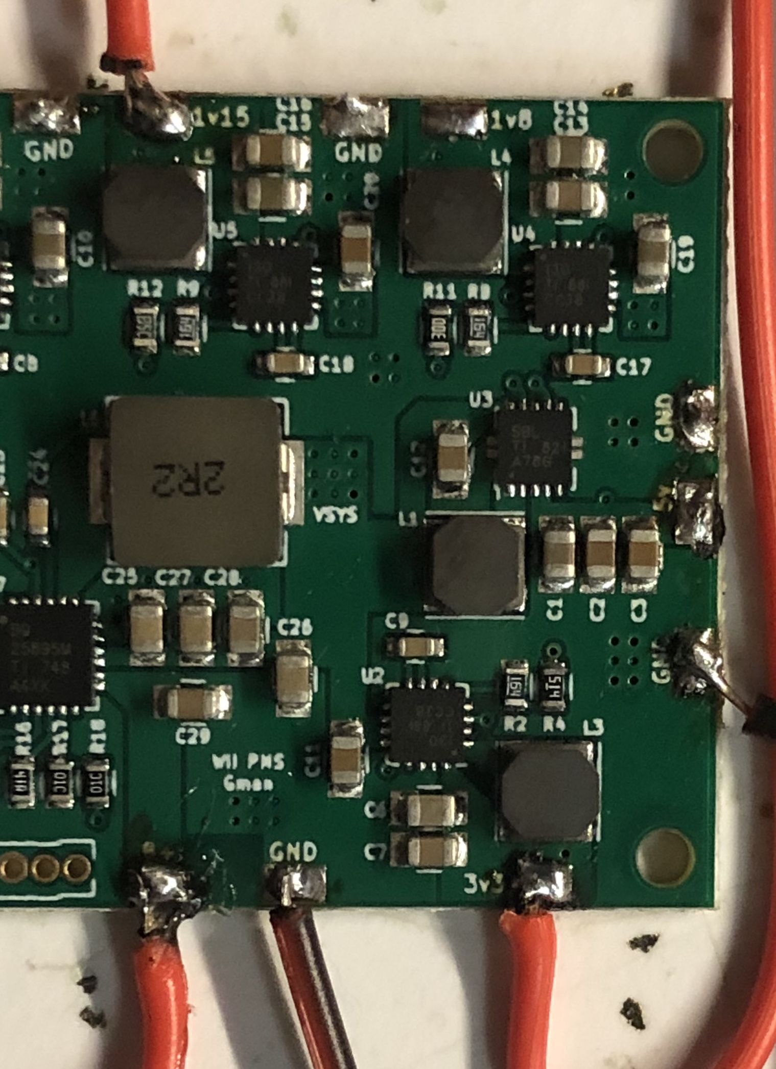

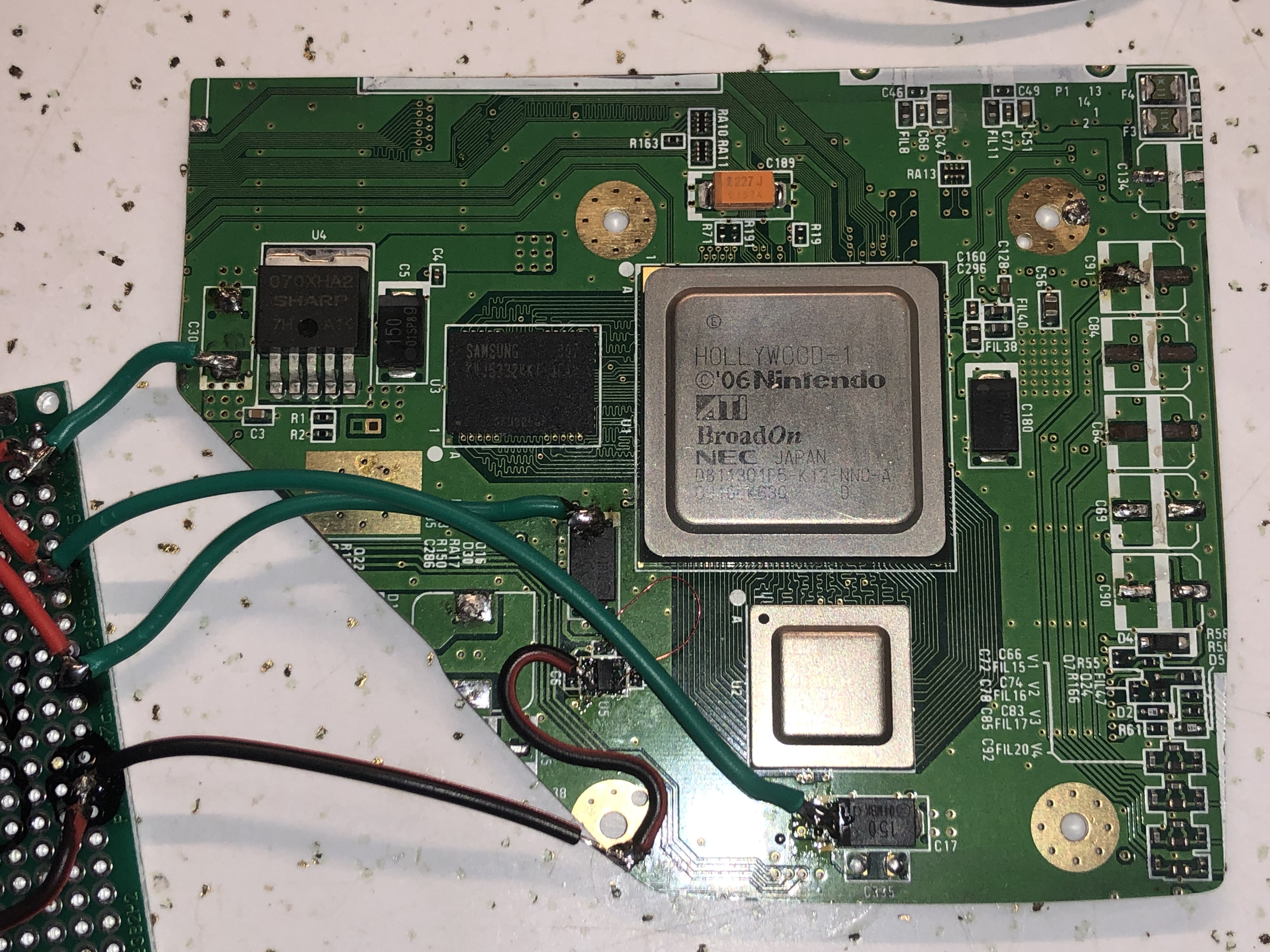

Ok just setup each voltage to a power switch to narrow down the problem and it seems that 1v and 1.15v can operate individually and together but once i introduce 3.3v, the wiipms shuts off. How can I track down the 3.3v voltage to find where the short is?
How about setting up your multimeter to measure the battery current, then you can see if the current is usually high or whatever is going on

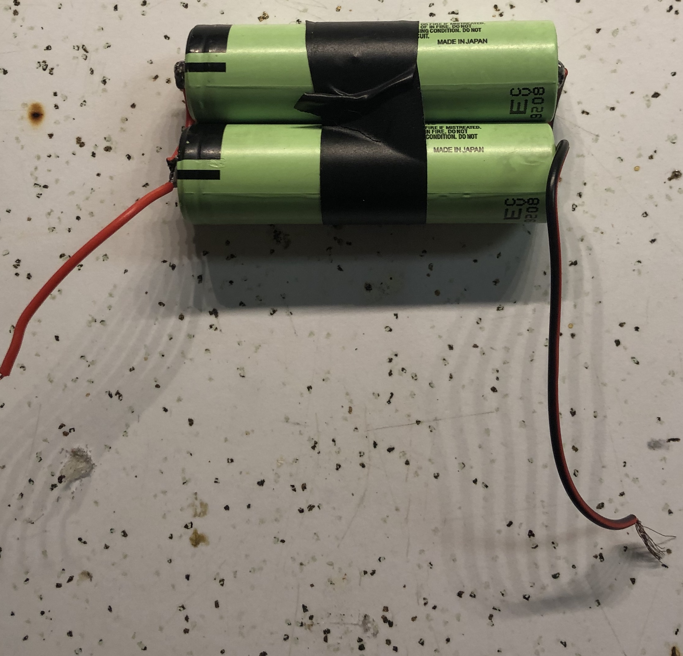

I FIGURED IT OUT GUYS!! I feel really dam stupid for only thinking that something was wrong with the WiiPMS or the Wii motherboard, it was the wiring to the batteries! I had been using alligator clips for battery positive and negative (I think they couldn’t handle the current) but once I hard wired them to the WiiPMS, all the outputs work together!
