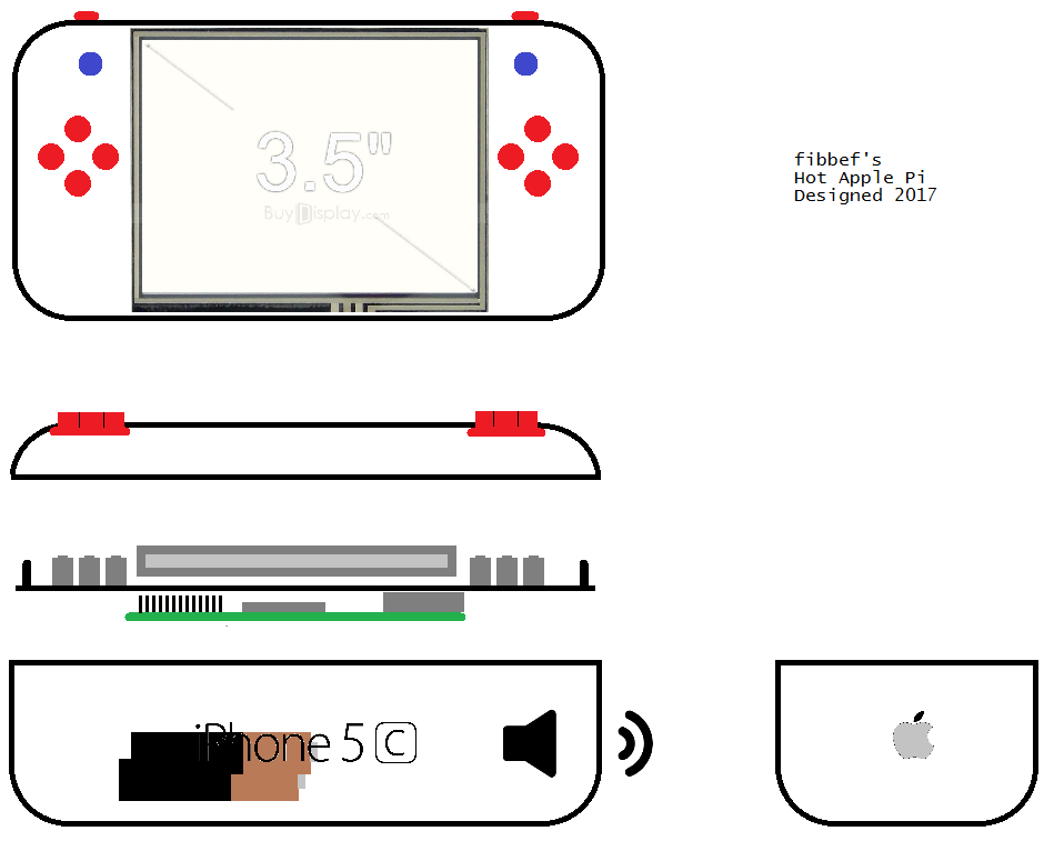

Couldn't get off my butt to find some paper at home, so an MS Paint drawing will have to suffice.
This is my plan for the Hot Apple Pi, a Raspi inside the plastic box that an iPhone 5C came in. I want to keep the box as minimally modified as possible, so I'm not cutting a screen opening since the lid is already clear. Controls are computer mice tacts wired directly to the Pi's GPIO pins. The buttons themselves will be plastic (not necessarily the colors shown) and I plan to attach them to the inside of the lid.
The case comes with a plastic insert that originally held the phone. My goal is to have everything attached to that insert, allowing the lid and base to detach completely for dead simple repair and battery replacement.
A cheap mp3 amp and a speaker pulled from a Samsung Galaxy 4 will provide sound. The Apple logos will be filed out to create holes for audio and volume control. The amp I plan to use has a 3-way switch for volume control: off, on, and loud. (I said it was cheap.) So the switch should be accessible through one of the hollowed out apples.
The Pi and screen will be powered by 4xAA batteries or a single 9volt (battery life be damned). I should be able to pull 5V from a regulator on the screen to power the Pi, but if not I can add a 7805 to the circuit (that's what makes it the Hot Apple Pi). I have an AA battery holder with a 9volt-style connector, so when it's all done I'll be able to switch between battery types at will.
I already have all parts on hand and should be able to start building once I get a couple of other obligations out of the way.

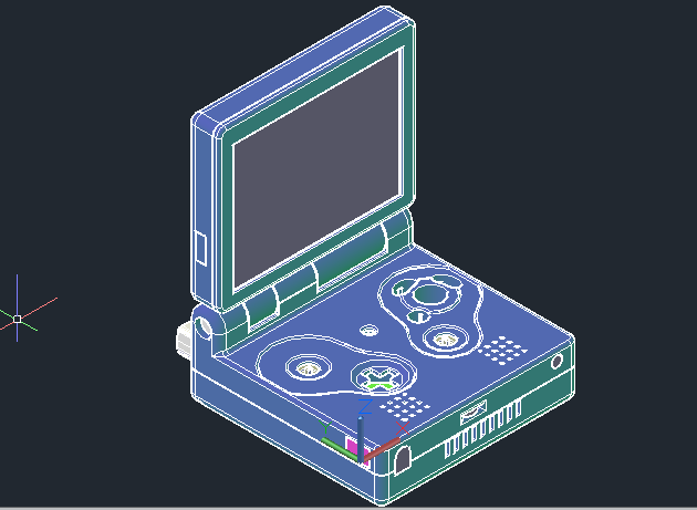

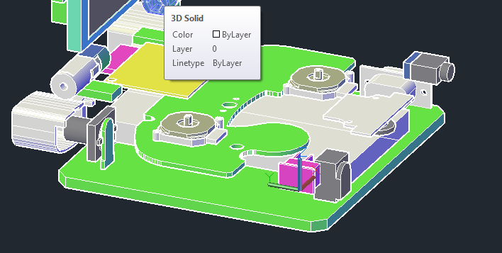

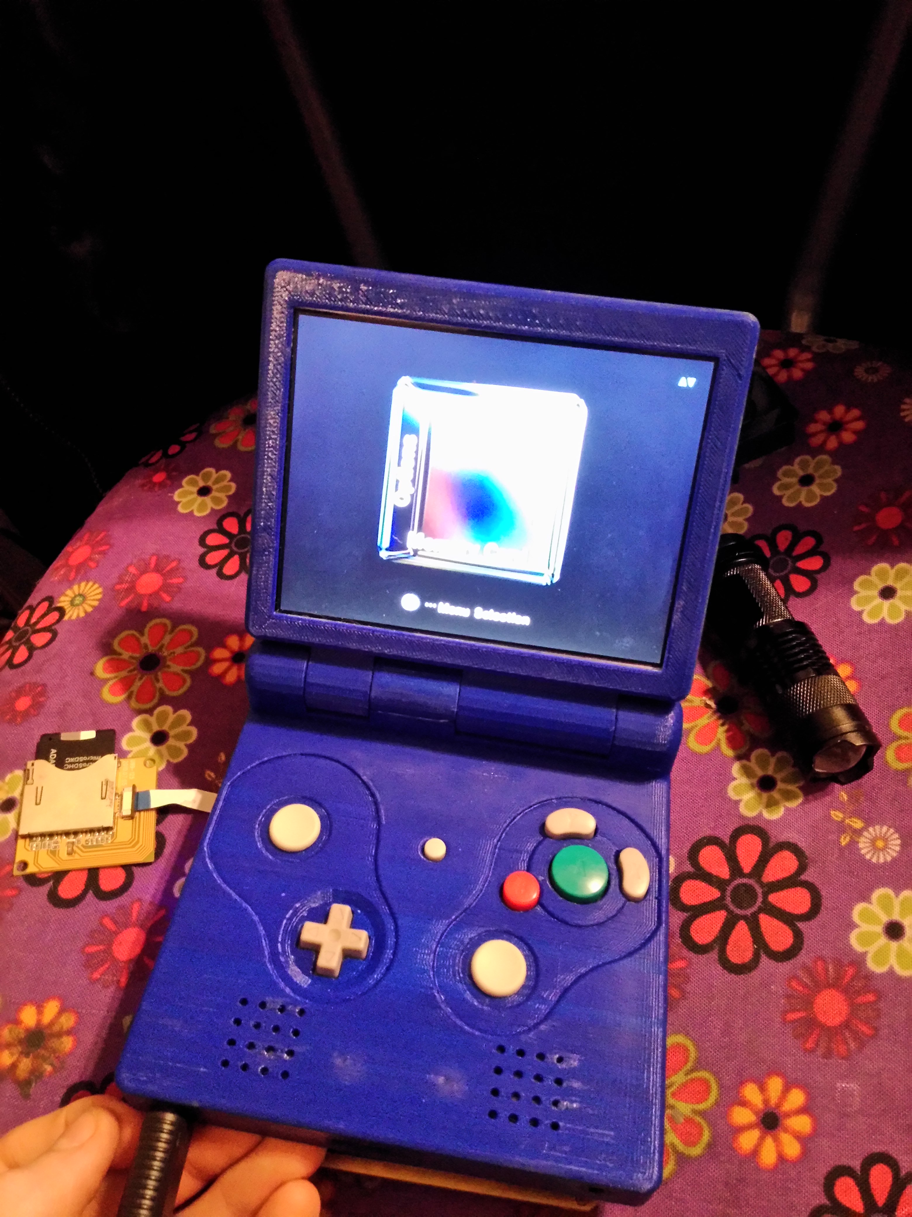

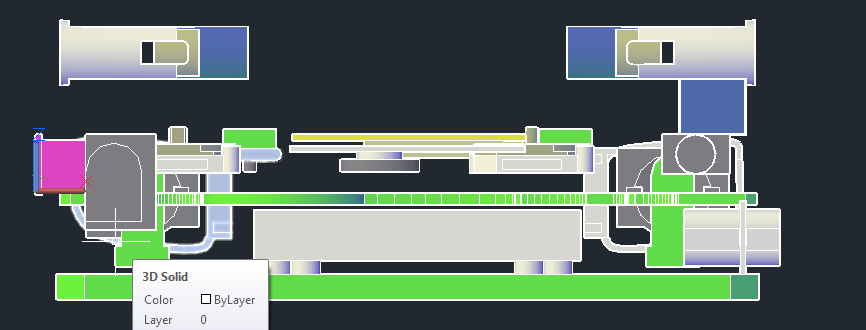

Here is my entry into this contest, the Gamecube Advance SP (GCA-SP) Unfortunately I may never finish it, as it is a Gamecube, and I cannot seem to get the Wasp working again. And by the time I have the extra cash to buy a new one from Aliexpress, they may be gone forever. Never the less, here it is!
Nice design! No batteries, though?
Anyway send me a PM after mid-February, I might have a WASP, but I'm not home right now.
Yeah? That's awesome! Will do. And no, no batteries. If I trim the board I'd definitely have room for them. But at the time of designing this, I wasn't up to the challenge. I have a couple of friends that want me to make them one so I wanted to keep it easy to do so I didn't have to charge them more than $300.

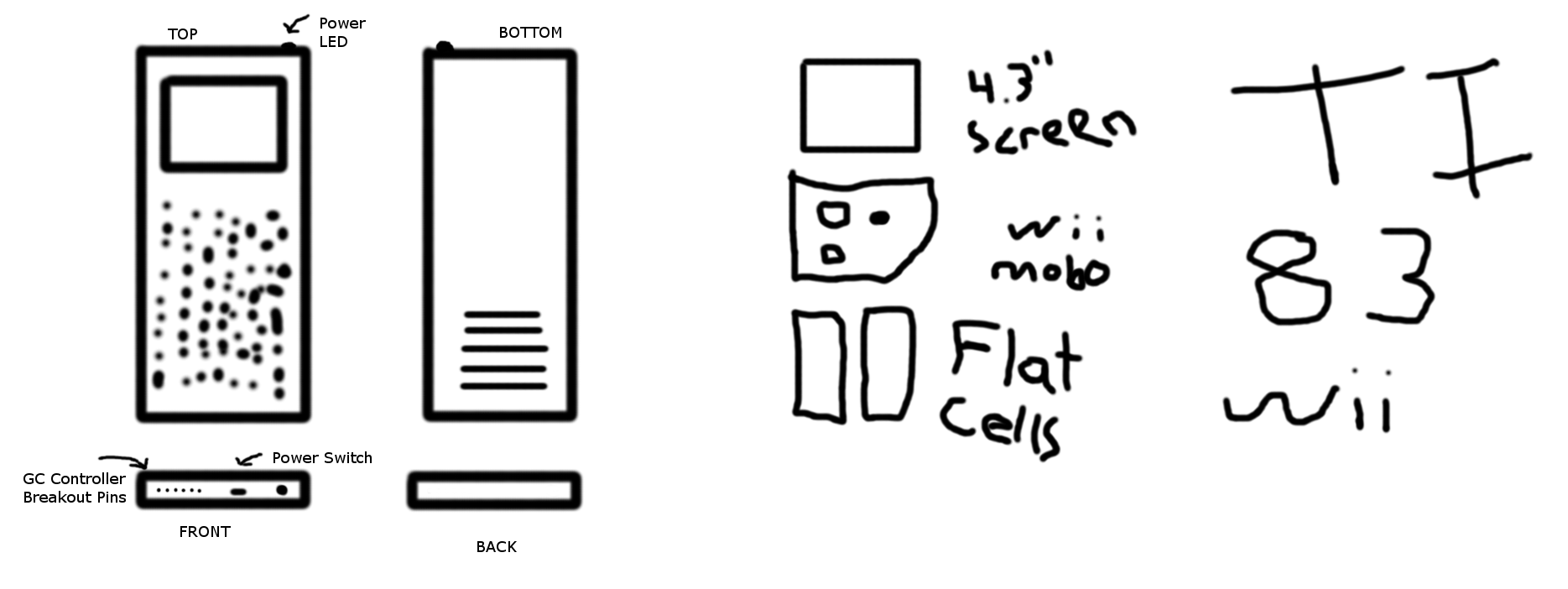

Actually not a joke, you legit could do this (though my great drawing probably says otherwise).
Base TI83 calculator, glue all the buttons in place (except for one to act as a sync button), put a LCD in place of their screen, a wii in the middle, and two (or more, depending on how much space is left) flat cell batteries. Have external controller ports to avoid needing internal controls. Then you could play smash or something in math class :P

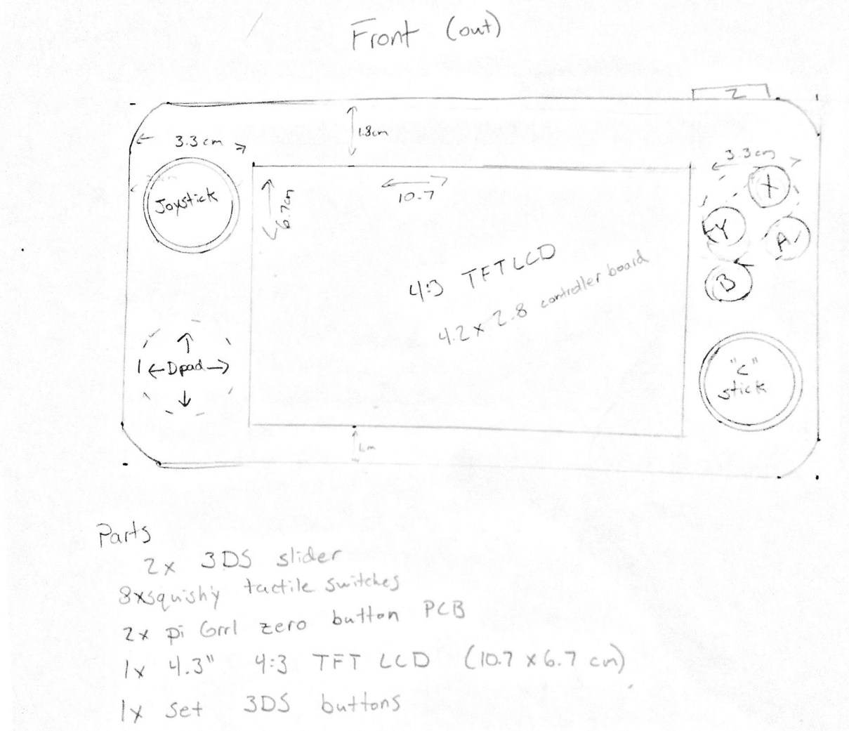

Damn. So many good ideas in this thread. (This is my first built and I am waiting on regulators and what not to get here). I could put up some sketches though. I would like peoples opinions/feedback.
I'm new to this stuff/artistically handicapped, so I drew the front/size to scale, and it all looks doable, but I included the measurements on here for ya'll.
Front
Back/Side
The write up:
Case is a modded circle pad pro. This combined with a Lower ds faceplate and some pieces of plastic frankencased off the circle pad and that is basically it. The circle pad pro came with the triggers and Z buttons intact, so that works well for me.
For buttons, I did not really know what to do, so I ended up picking up 2 of the PiGrrl zero 4 button PCB with common ground.
Adding a second slider and retaining the slider pad triggers/Z and that is basically all the control / outside aspect.
Internally, I am having some difficulties. I am waiting on my regulators/parts so I am working on refining my technique by soldering/desoldering old useless electronics.
If I lack the balls to cut up this wii, I will use a rPI. In that case, I would wire up these PCB to a teensy rather than the IO pins on the PI (easier upgradability in the future).
If I do cut up this wii, I will try wiring the buttons to a classic controller PCB (there are testpoints on the board), so you can basically cut it down to ~3cm by 3cm. Bought a cheap knock off wiimote online in the hope that the traces are more visible and not obscured like the stock one. Optimally the best bet would be to setup a small board like the GC+ that includes a small bluetooth chip and emulates the classic controller connected to a wiimote.

Looks pretty dope. Regarding the triggers on the back, I think you actually need to raise the buttons on the front or lower the triggers on the back a bit. I think it would be best to raise the front buttons because you primarily use your thumbs for the front, with the index fingers supporting the case and the pinkies resting a little lower.
So assuming the ring/middle fingers are for triggers, having your thumb and middle finger on the same level is a bad idea because it doesnt allow the hand to achieve an ergonomic feel. Holding it for a long time would result in pain/stiffness in your thenar eminence (palm near the thumb).
Damnit. Adding this response to your design made me question the feeling of my own...
