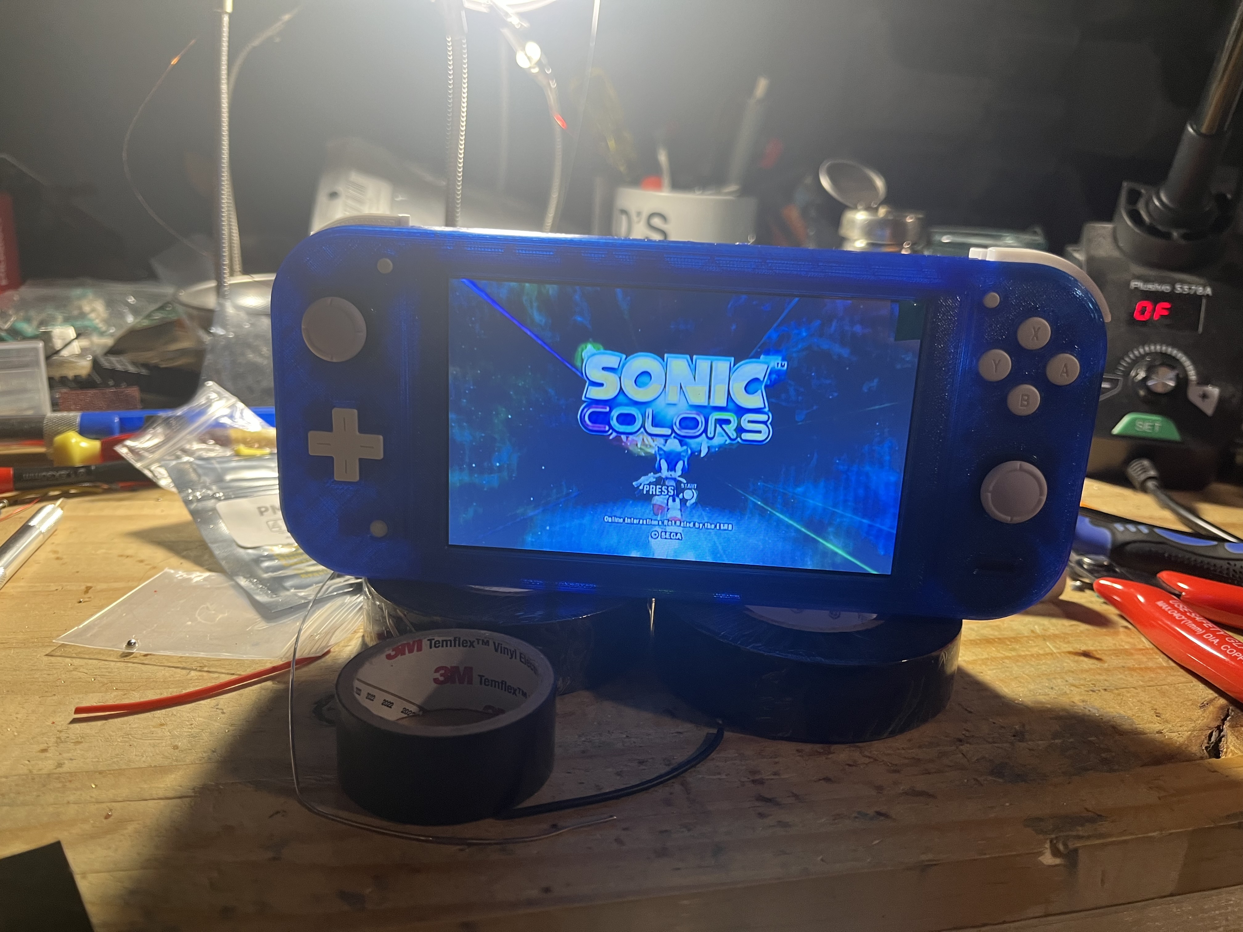

I’m having issues with my GC+2.0 particularly with wii games. It seems like the Wii games can’t choose between using the gamecube controller or the emulated wii controller and seems to rapid-fire between the two several times in a fraction of a second, especially in Sonic Colors. The first portable I made doesn’t have this issue but it’s the only one using the RVL-PMS-lite. The others portables that have this issue use the RVL-PMS-2. None of them have the bluetooth chip and all of them have an MX chip and use the same revision of RVLoader. If anyone has any idea of what’s going on, I would be very grateful. Happy Easter!
Edit: Also, they all use composite video for my soldering abilities and tools

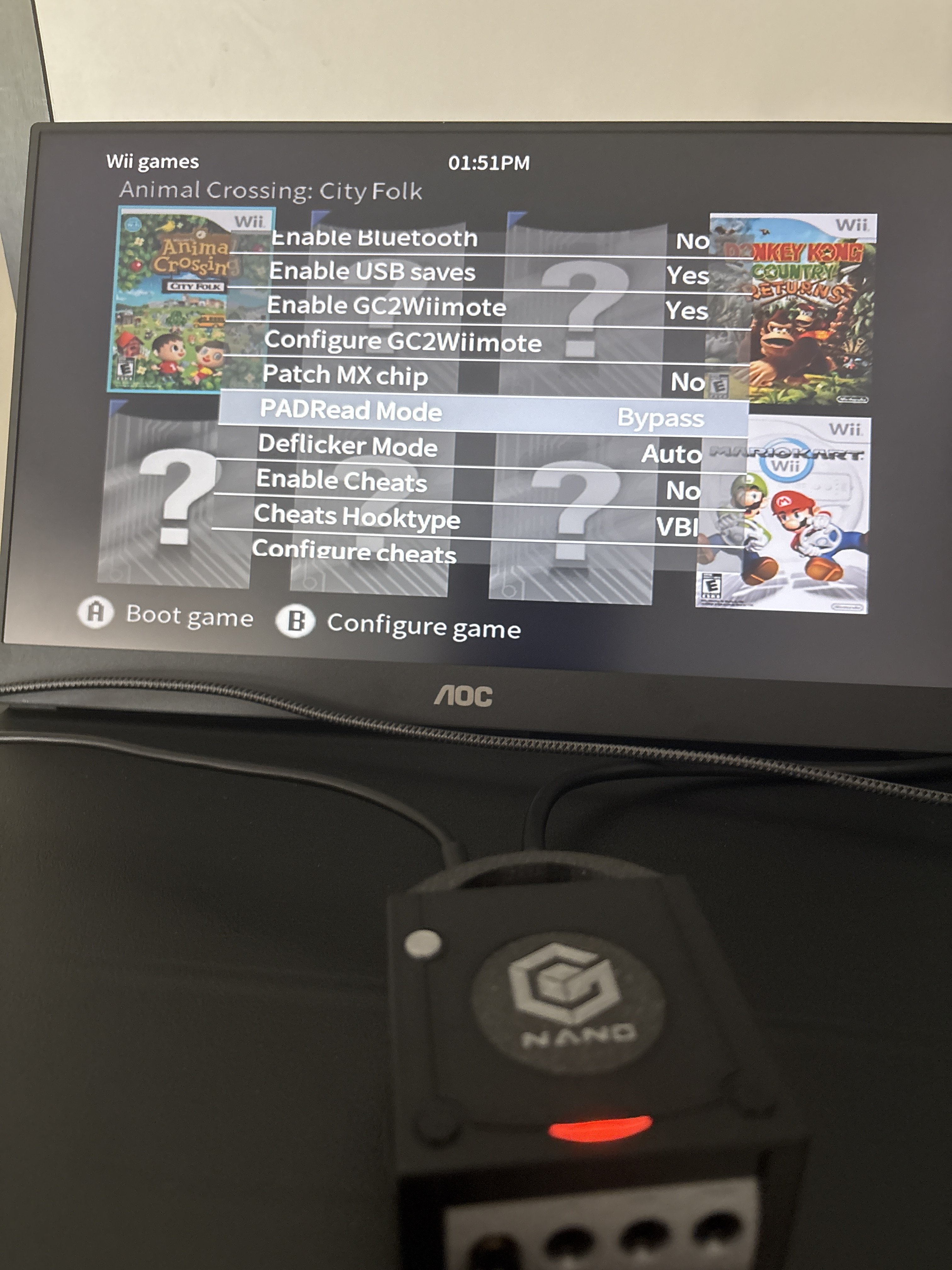

You need to change PADReadMode configuration in game settings from RVLoader
Sorry, that I’m getting to this late, but what did you mean by this?
In RVLoader, select a game, press B to access game's settings and change PADReadMode to something other than Auto and try again.
here it is. On Mario Strikers Charged, all 3 modes on PADReadMode do not work by the way, just tried to test it now.

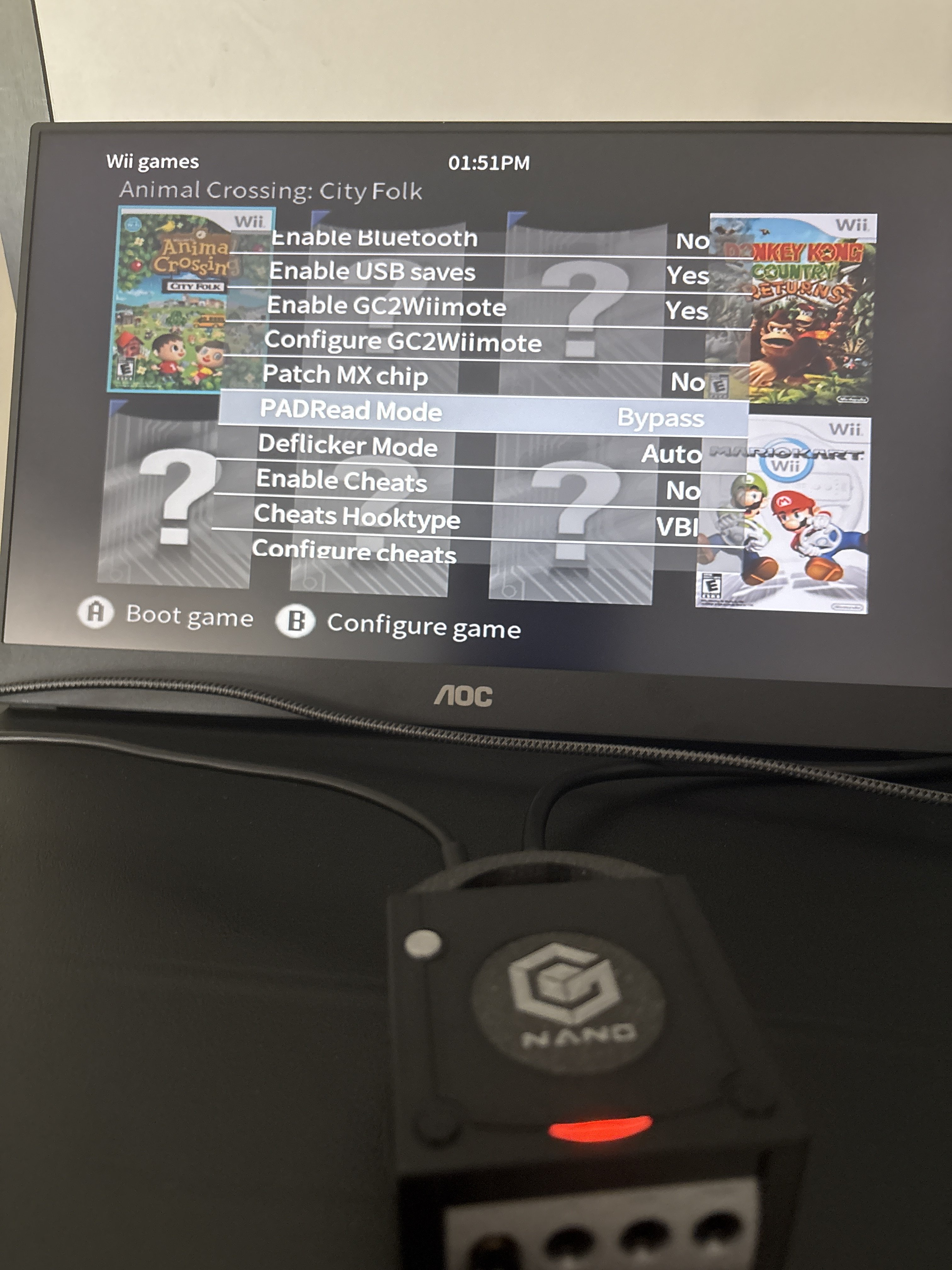

Can you also show GC2Wiimote configuration?
Apologies for the very late reply, but here’s my GC2WiiMote configuration for Mario Strikers Charged. PADReadMode is set to Auto.

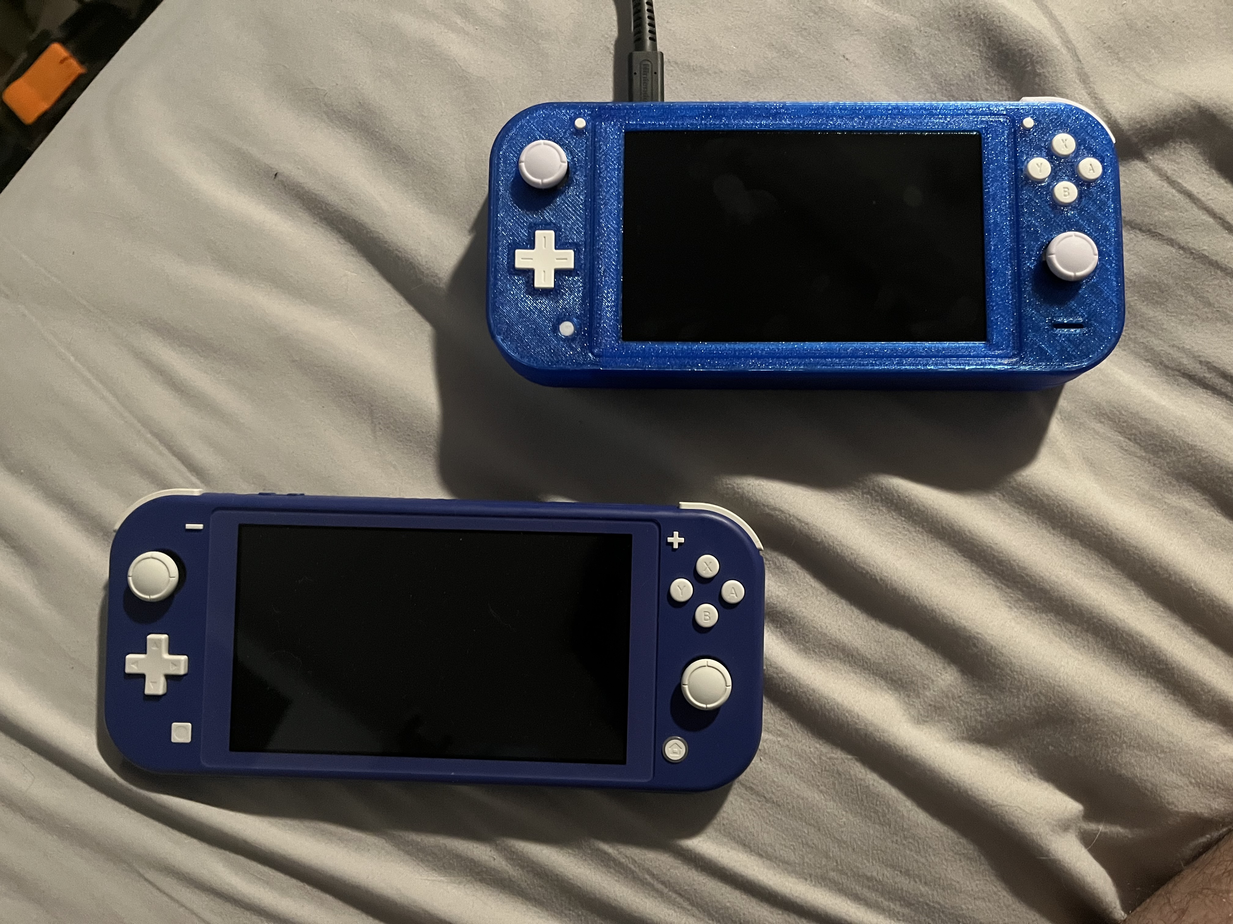

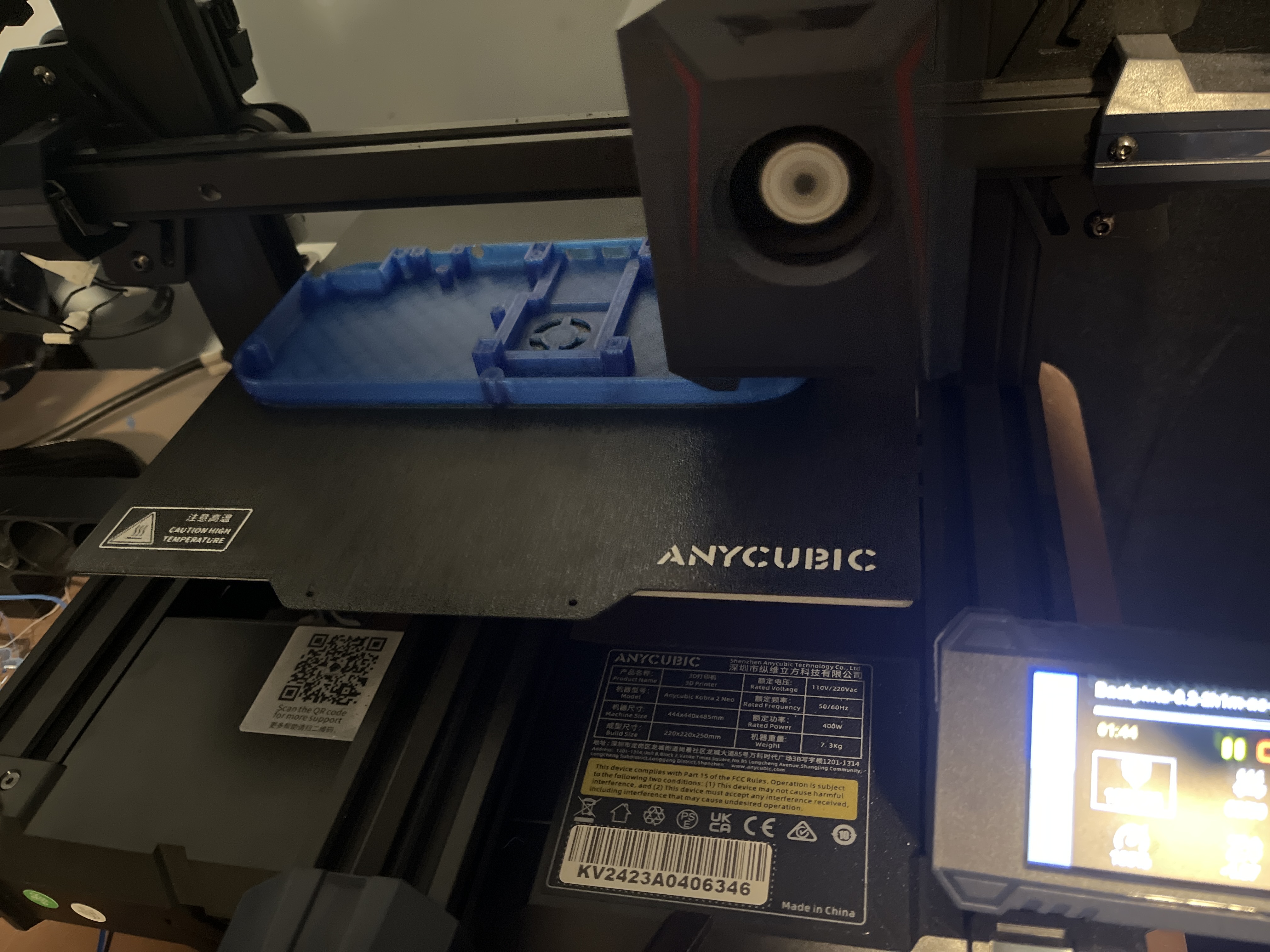

eh screw it. i’m making a new one just for wii games. the final prints are being made now. started designing exactly a week ago
