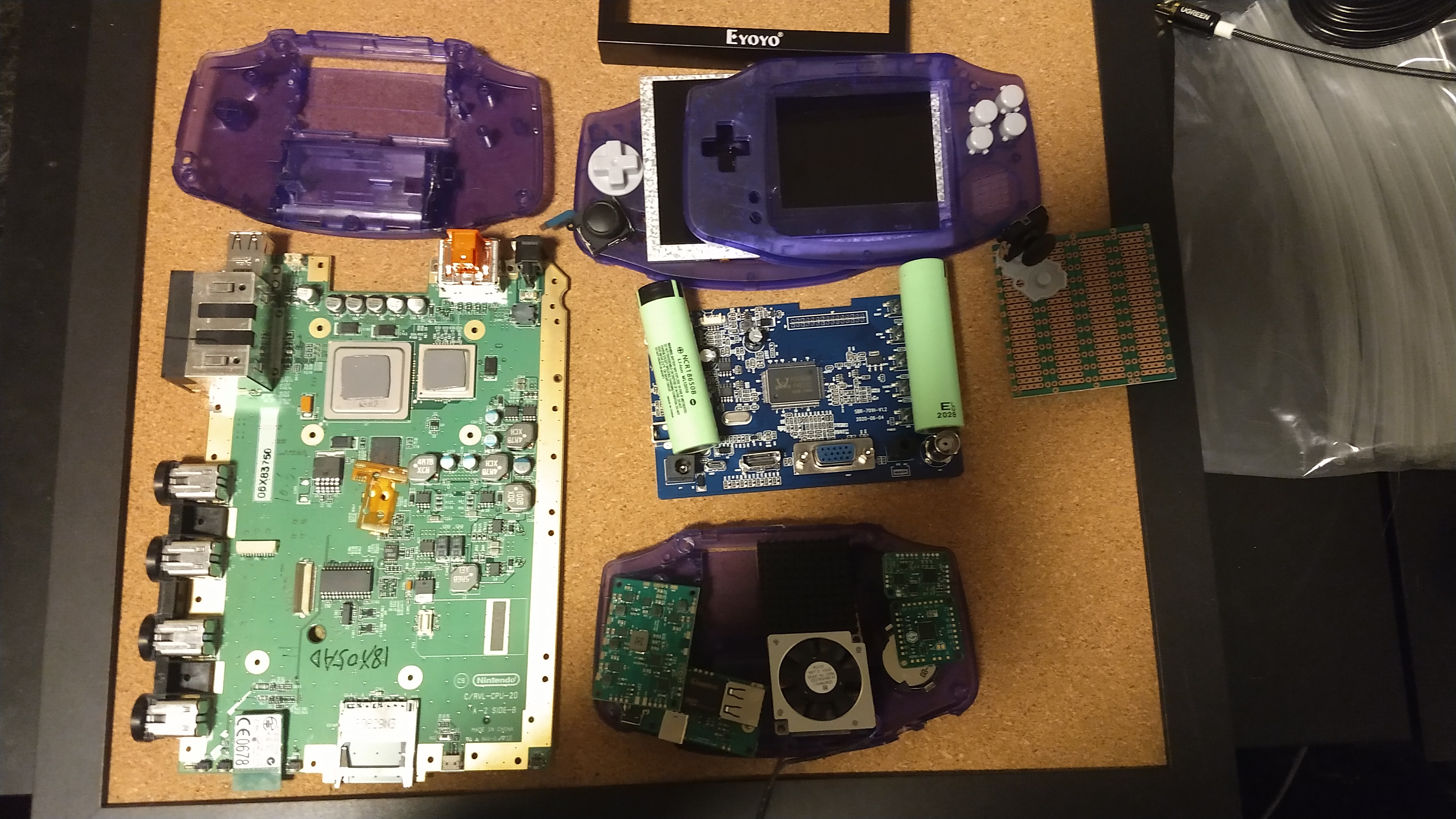

All my parts finally arrived, so it is time to make a worklog and start this project properly.
I plan to frankencase two GameBoy advance shells together to fit the 5" component Eyoyo display. And then have all the other components within the GBA shell.
My biggest worry is the thickness, especially the middle part where I'm squeezing in the LCD, driver board, cut Wii, and cooling on top of each other. And that the batteries won't fit on either side of the motherboard, on top of the driver board, though I'm not super attached to the batteries and will drop them if they don't fit.

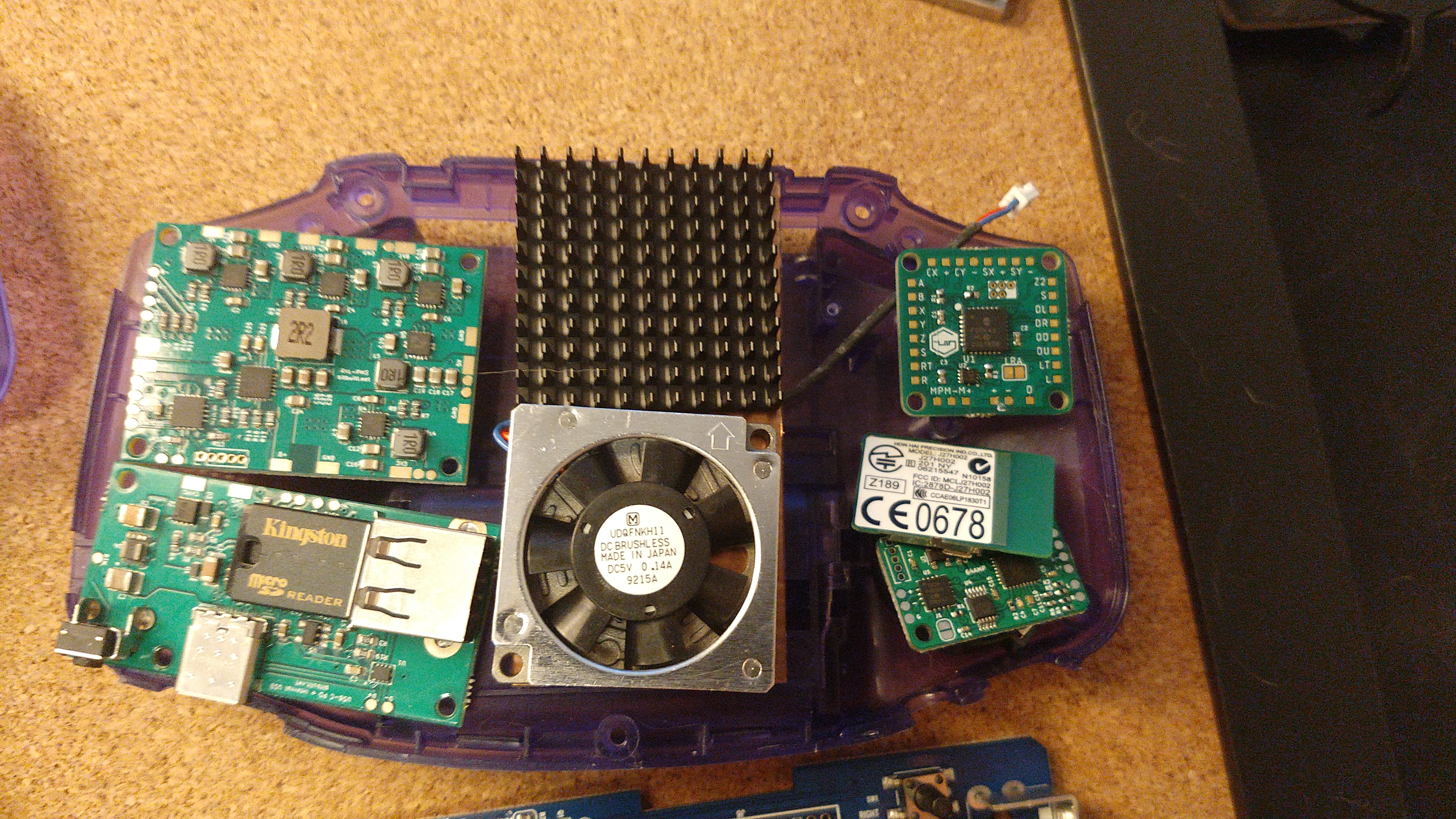

Here is my initial plan for the layout. Though, I'll have to remove all the unnecessary plastic and expand the shell properly before I can be sure of the actual layout. (The cooling will, of course be laying down and not up in the actual build.)

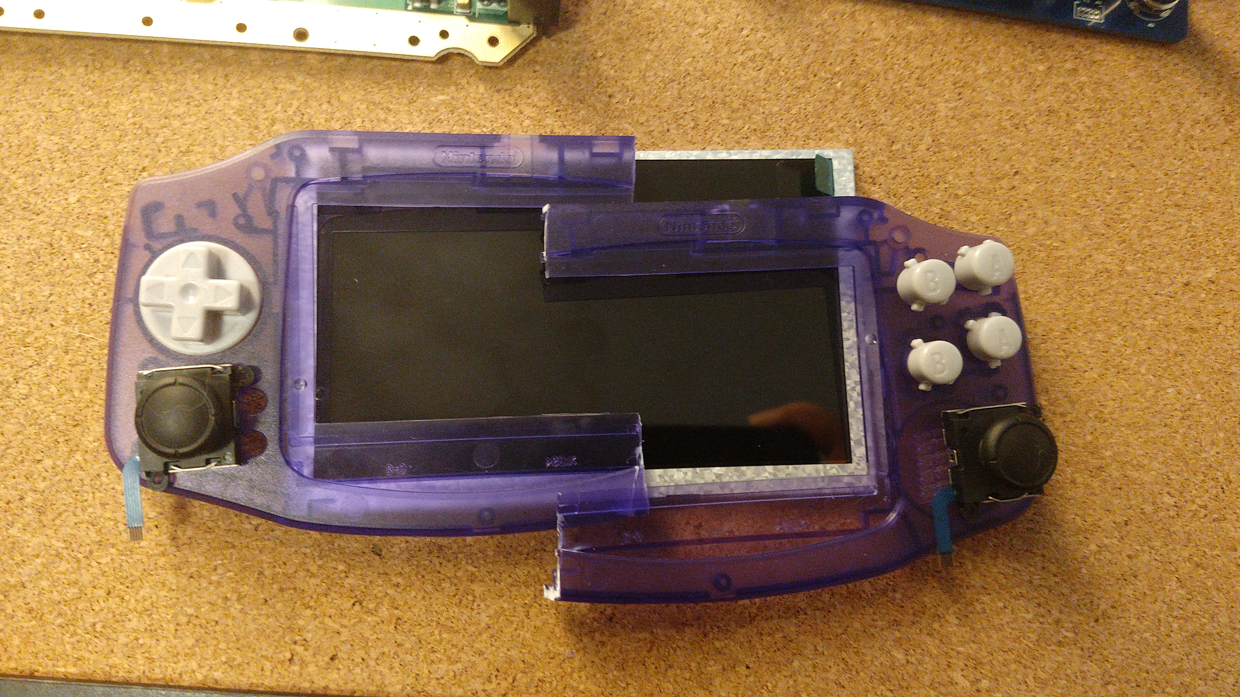

I made a rough cut to better visualize how the two parts of the shell will mesh up. The height of the display in the corners is just barely within what the shell can handle. I had measured it out beforehand based on the description specs, but seeing how close it was is something else. (Also, I know the cuts were not all that great, I'm experimenting with what tools gives the best/cleanest results)

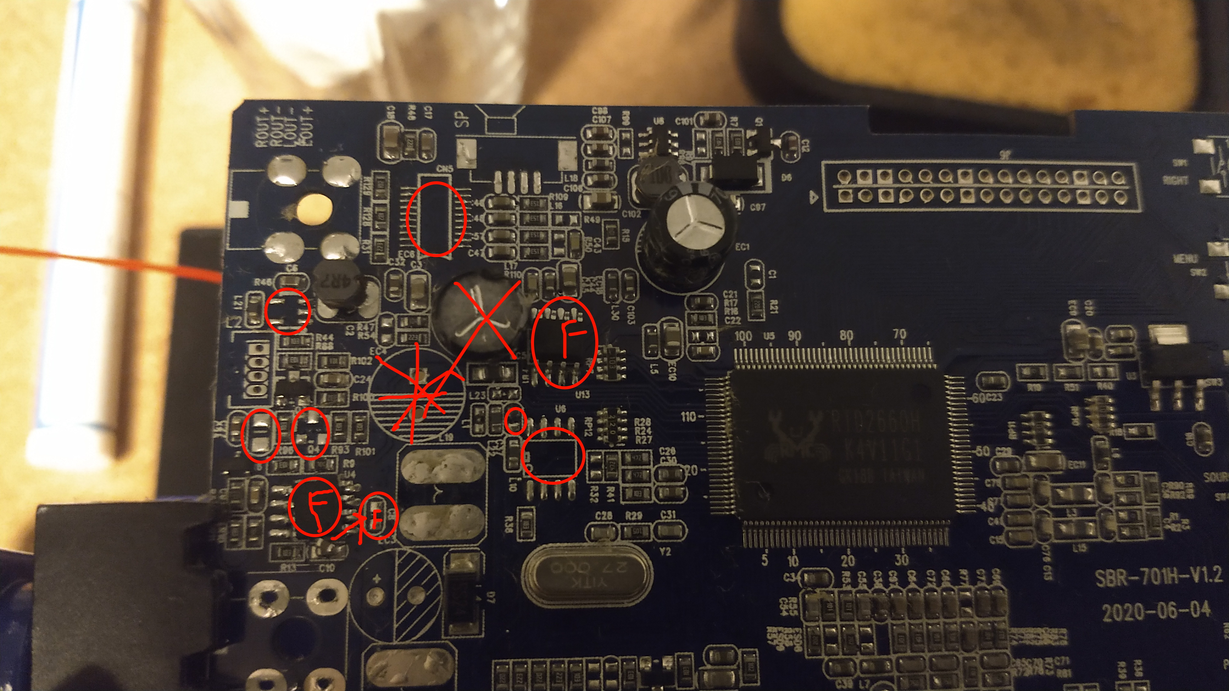

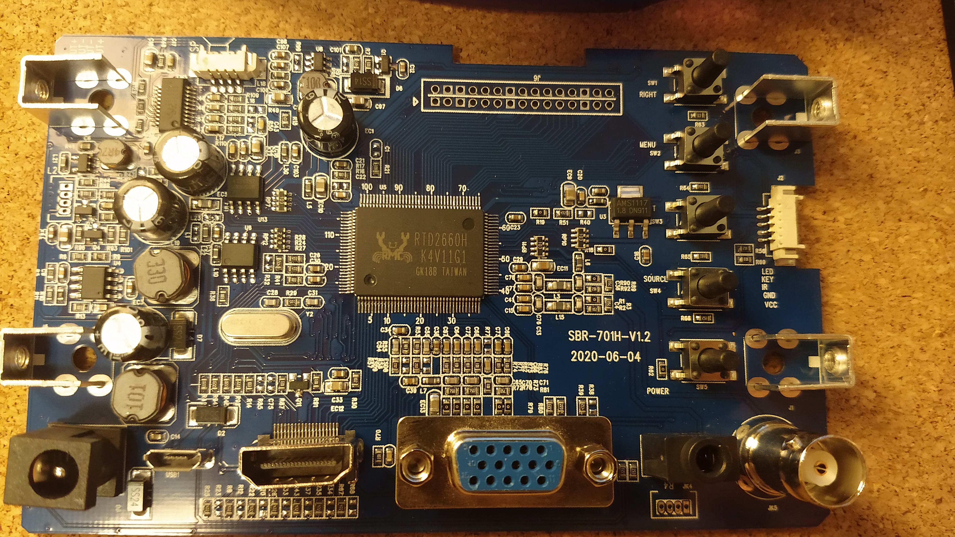

I also noticed that Eyoyo made a new revision to their driver board in 2020. I'll try to grab the firmware in case anyone is going to want it. I feel I have seen both this exact board and the LCD on eBay when I was looking for displays before I found the tread on Eyoyo. So maybe other displays can be converted to accept component video?
Edit: Well I killed this board by rushing a bit too much when removing some of the capacitors, one of them blew, and other important parts flew everywhere. Waiting on a replacement.
