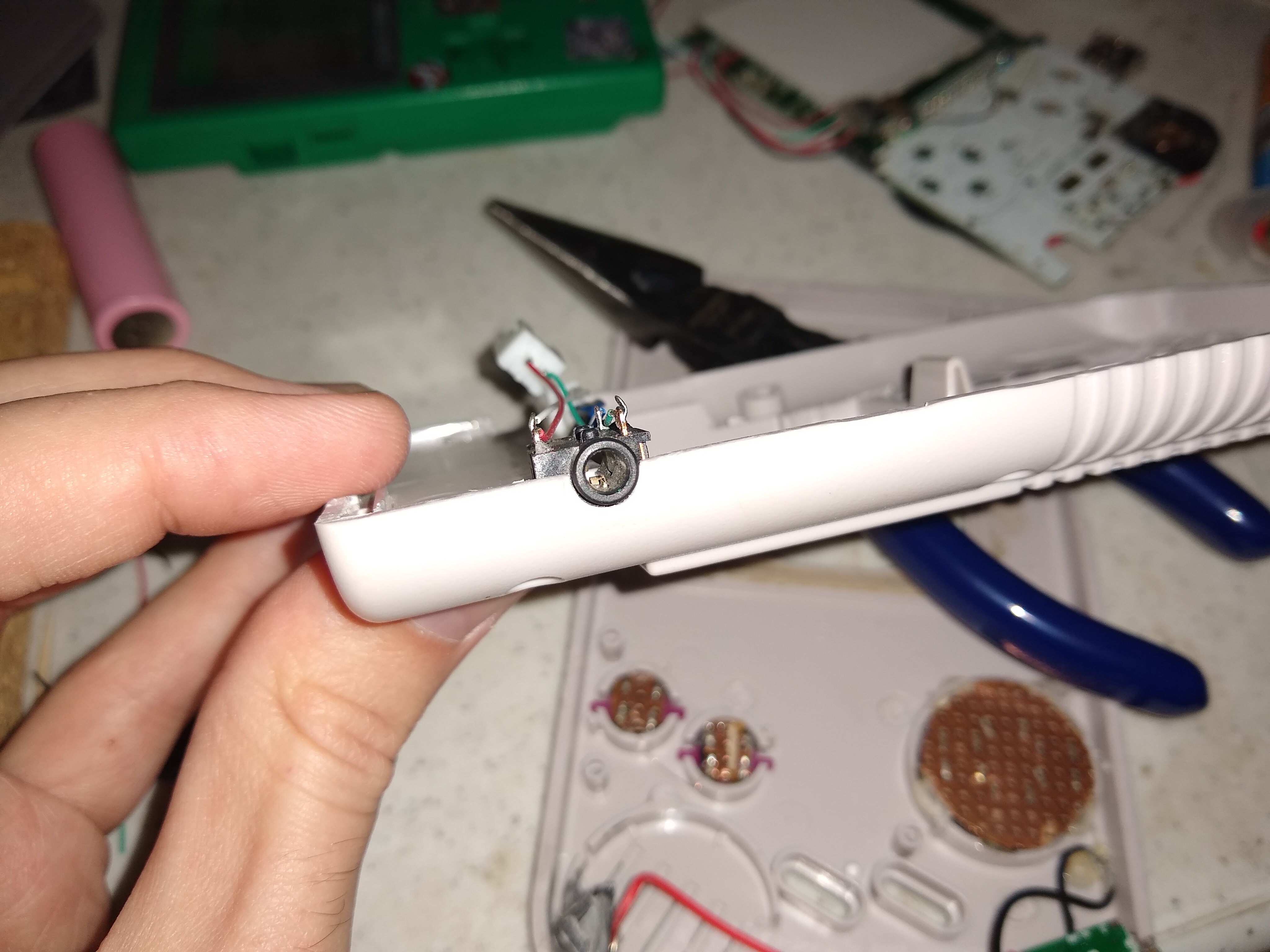

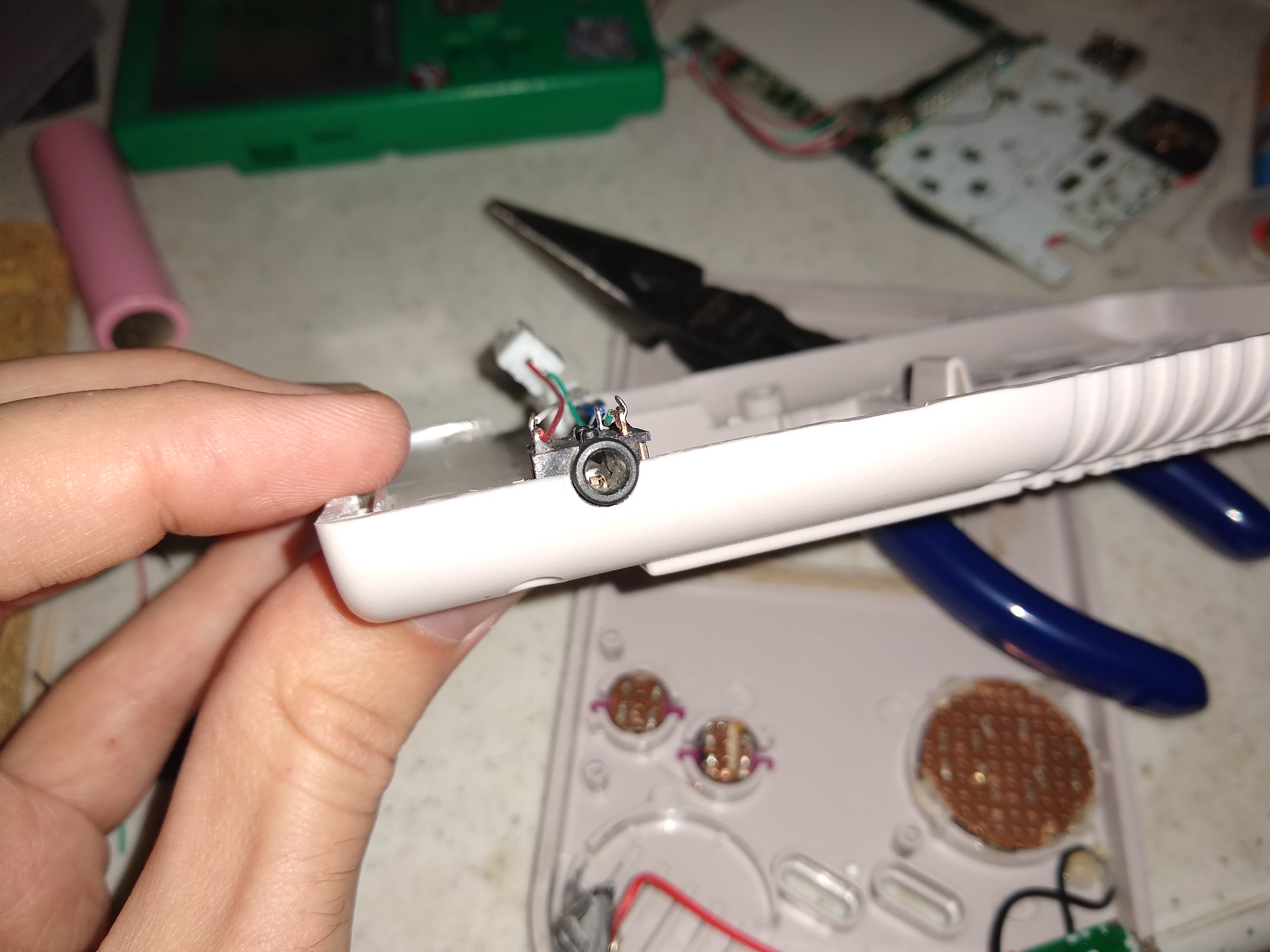

The dials. I decided to glue them to the all-the-way-down position and solder other dials to the same contacts. I don't trust myself to de-solder them without ruining them. The headphone port and link port came off ok.

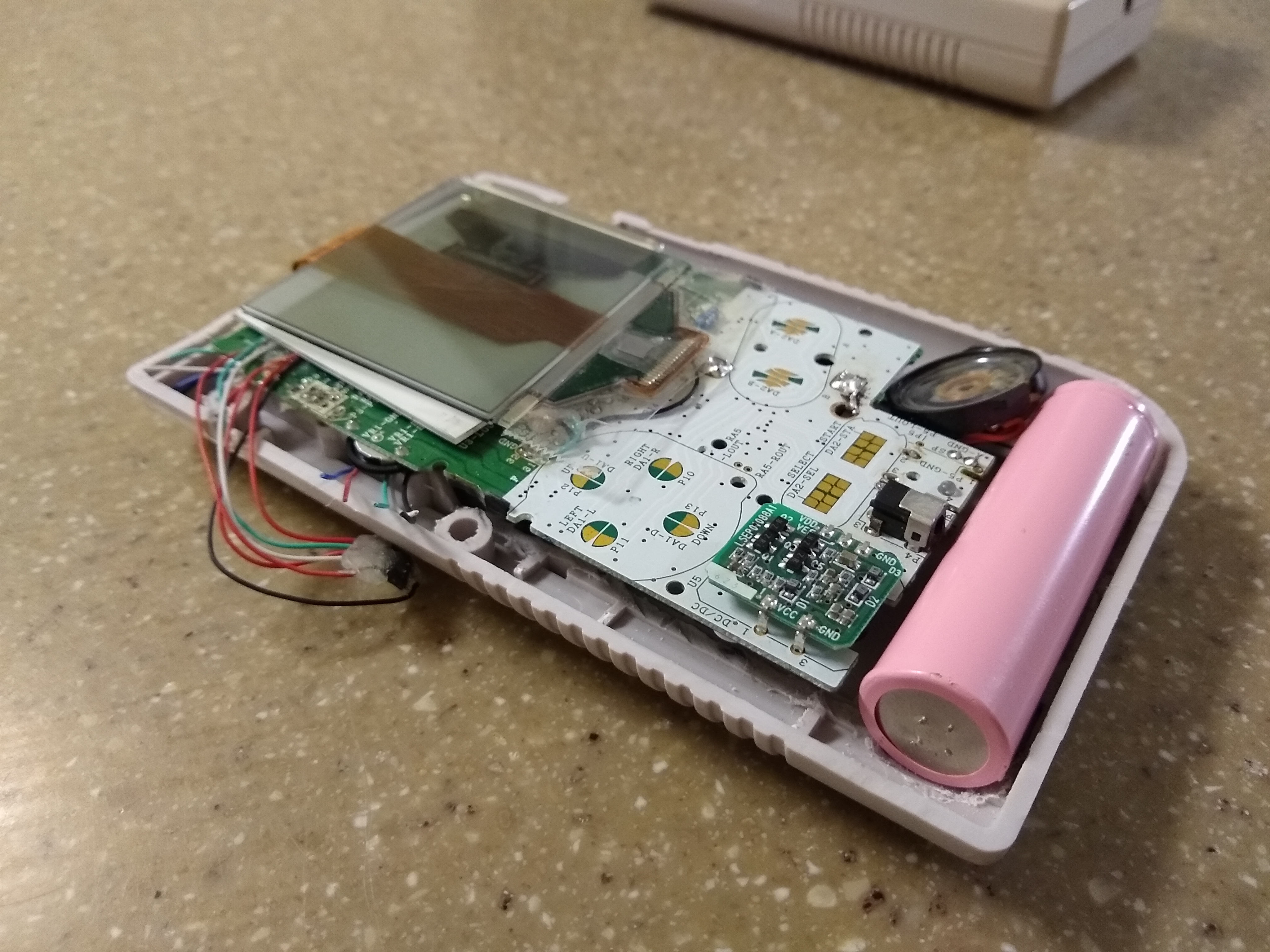

The battery fits after removing the headphone port and grinding down the AC port. That's the bivert chip hanging out the side:
Already soldered connectors for the headphone port and battery. Unfortunately I don't have a 5-wire connector so I'm using a 2 and a 3. Ready to glue in the battery terminals.

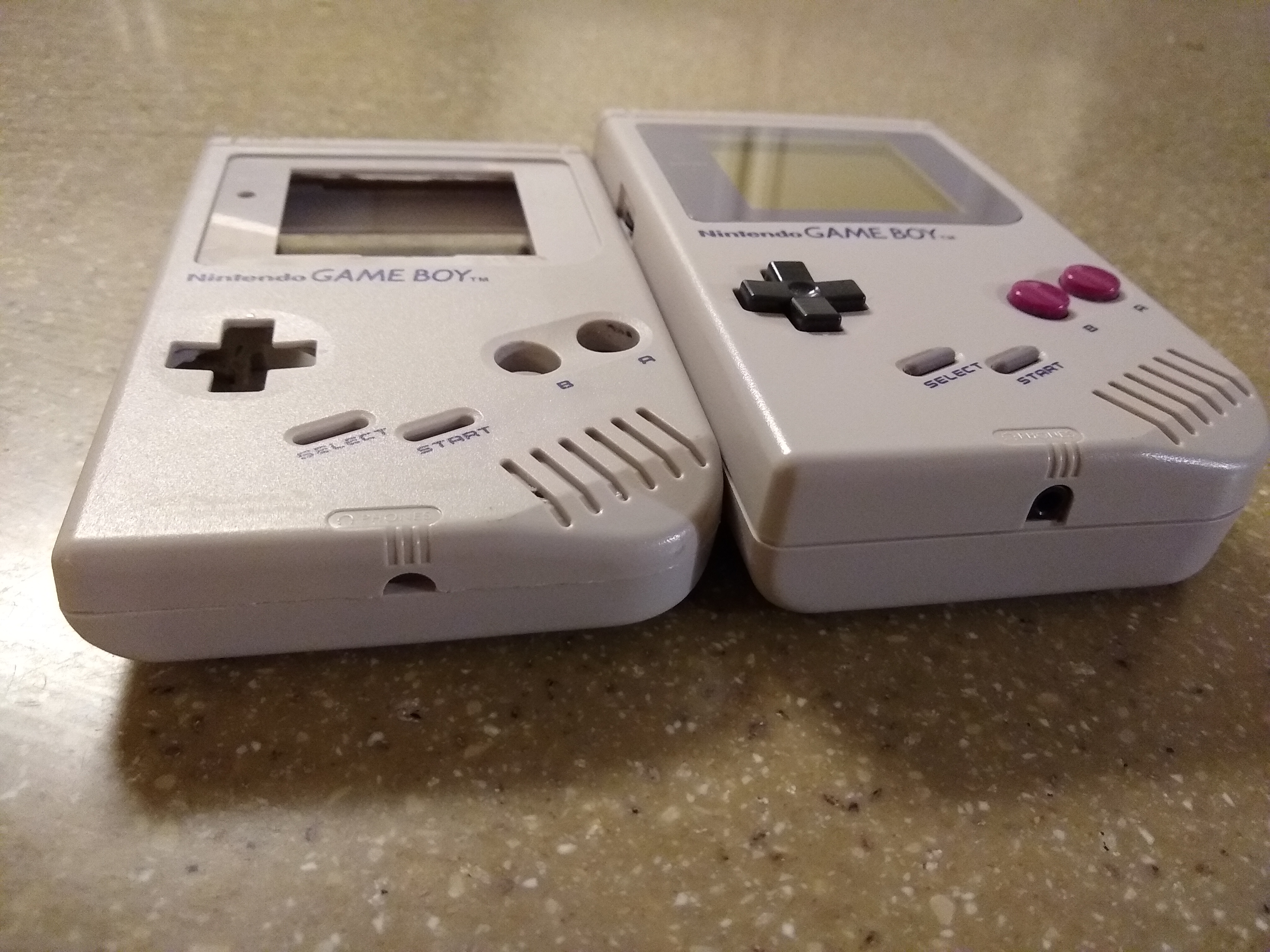

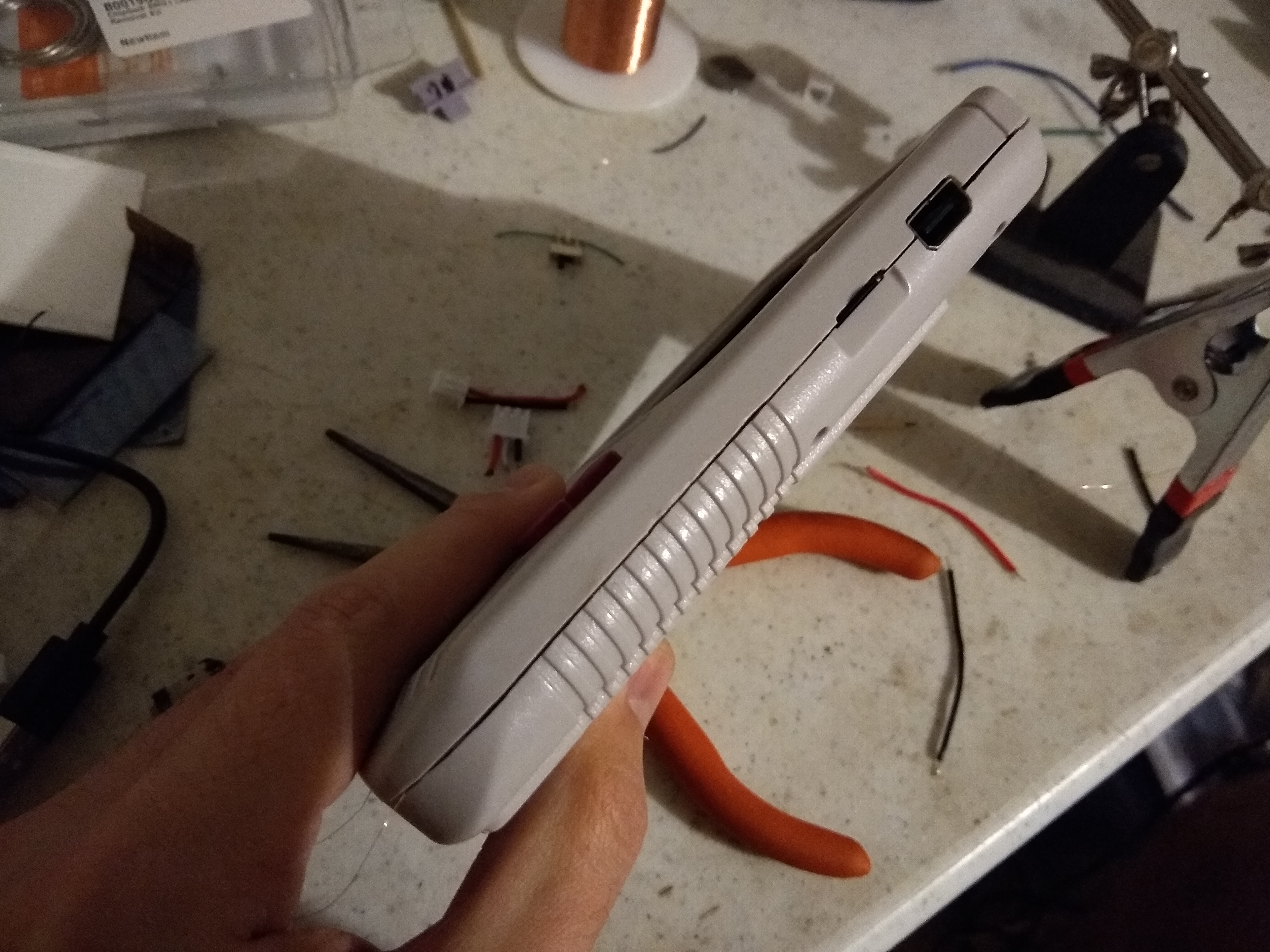

It will be just over half as thick. Whenever I think this project is stupid, I just pick up a full-size DMG and marvel at how gigantic it is. You can see in the speaker grill where I carved too deep to fit the battery.

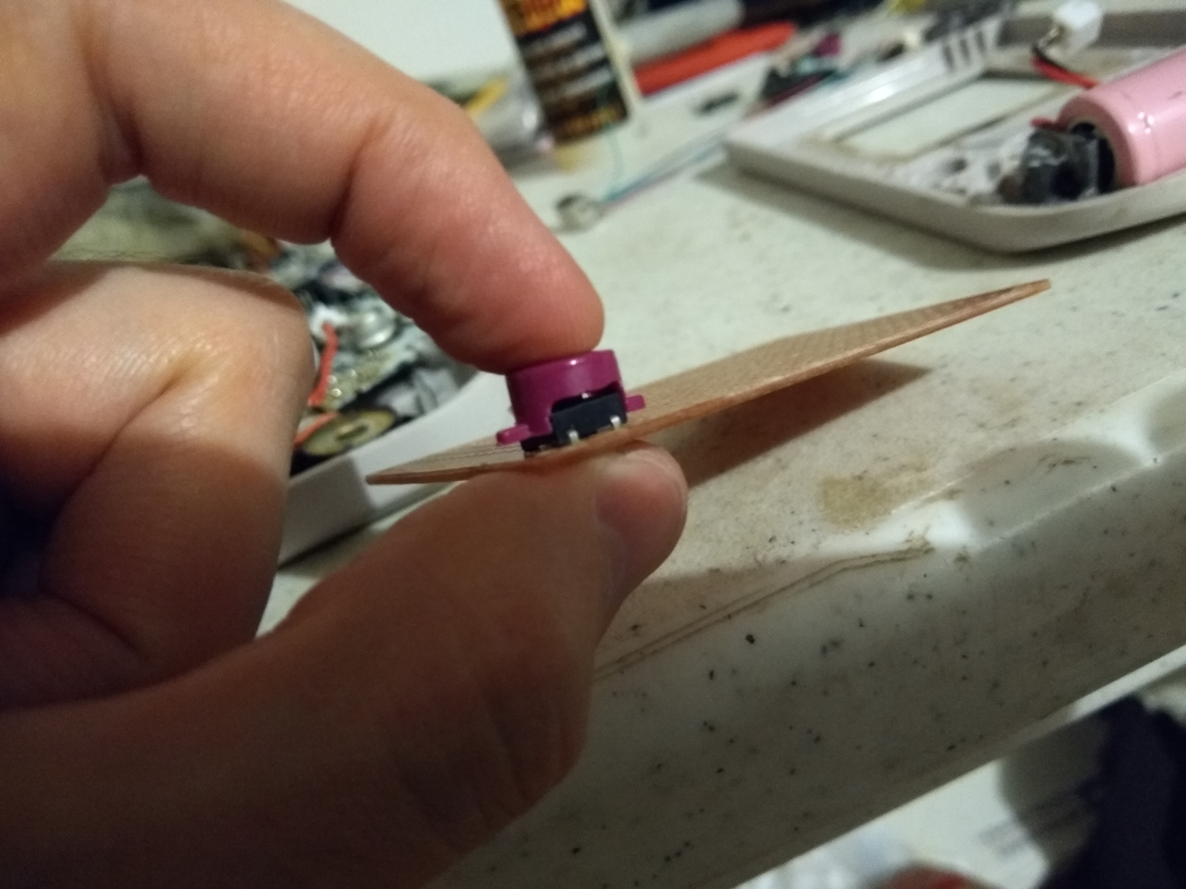

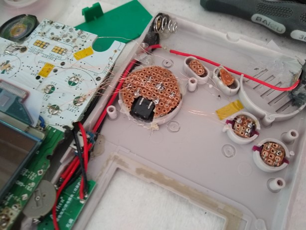

There's almost no room for buttons beyond the rings built into the DMG shell. So I'm carving away at the buttons to try and fit a squishy tact in that small space. A and B buttons sit satisfyingly well with perfboard to epoxy to. D-pad will be harder, and I'll have to come up with something crazy for Start+Select. But I think I have some tiny clicky tacts that will fit.

if the button doesn't work, and you need more space, you could use button domes, they are only like 2mm-3mm tall, they are sorta clicky, if you put a piece of silicone on it, it feels like a squishy tact(it's what Nintendo did for the 3dsxl and joycons)
Yeah I might have to do something like that. A and B are fine, but the D-pad + squishy tacts are too tall. I can carve into the Dpad a little, but not like A+B. Maybe I could move the tacts more toward the center, that would let me move them up into the plastic a little better, but it might feel weird to actually use the Dpad if the tacts aren't as close to the edges.

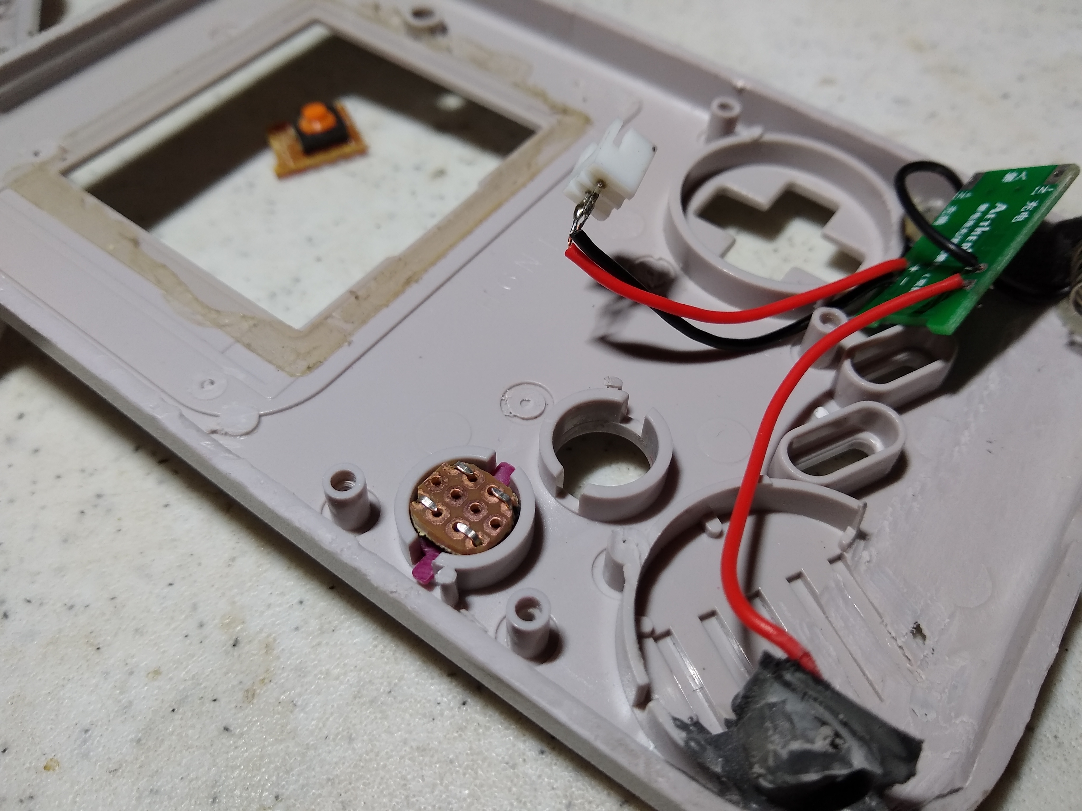

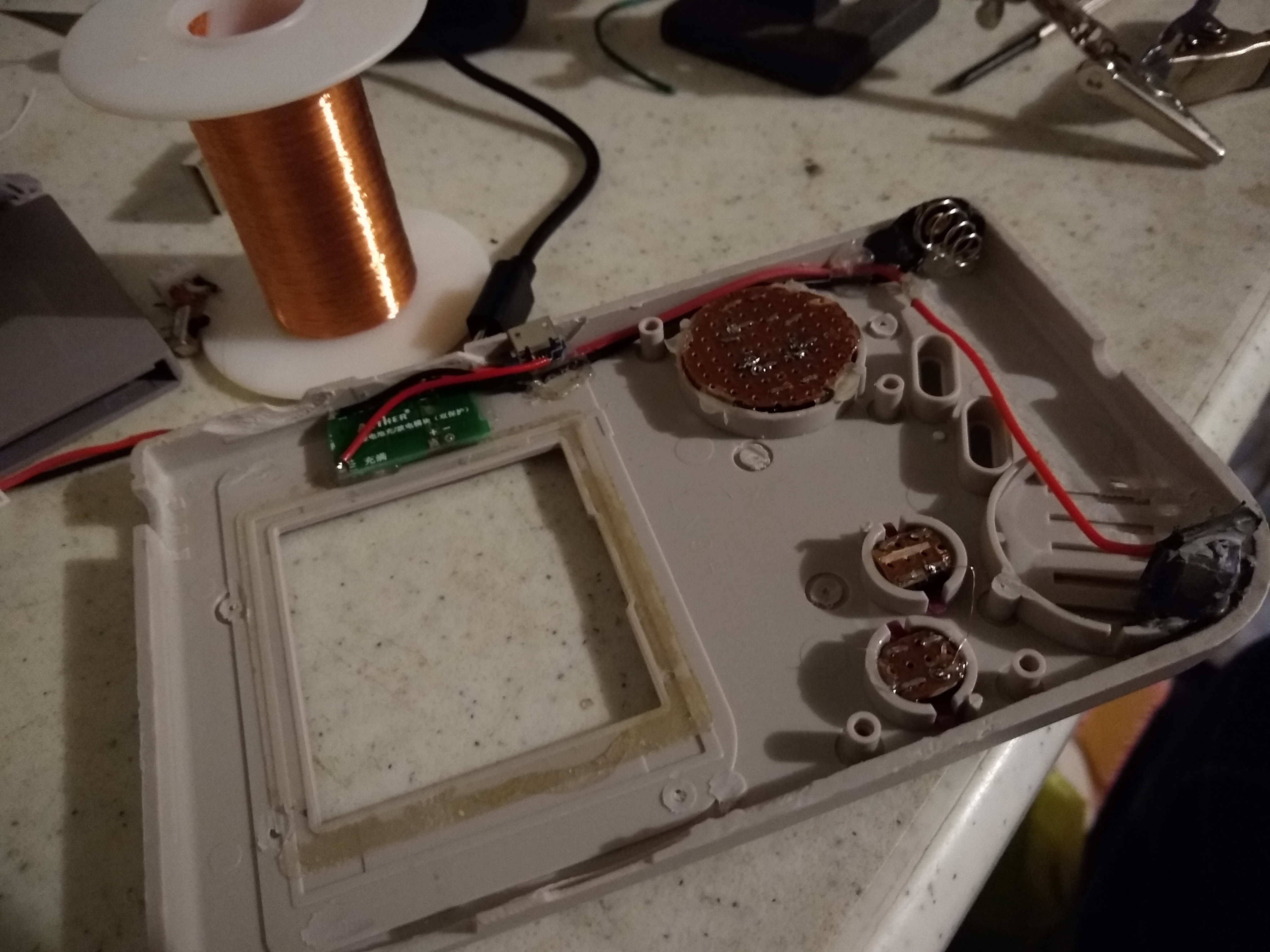

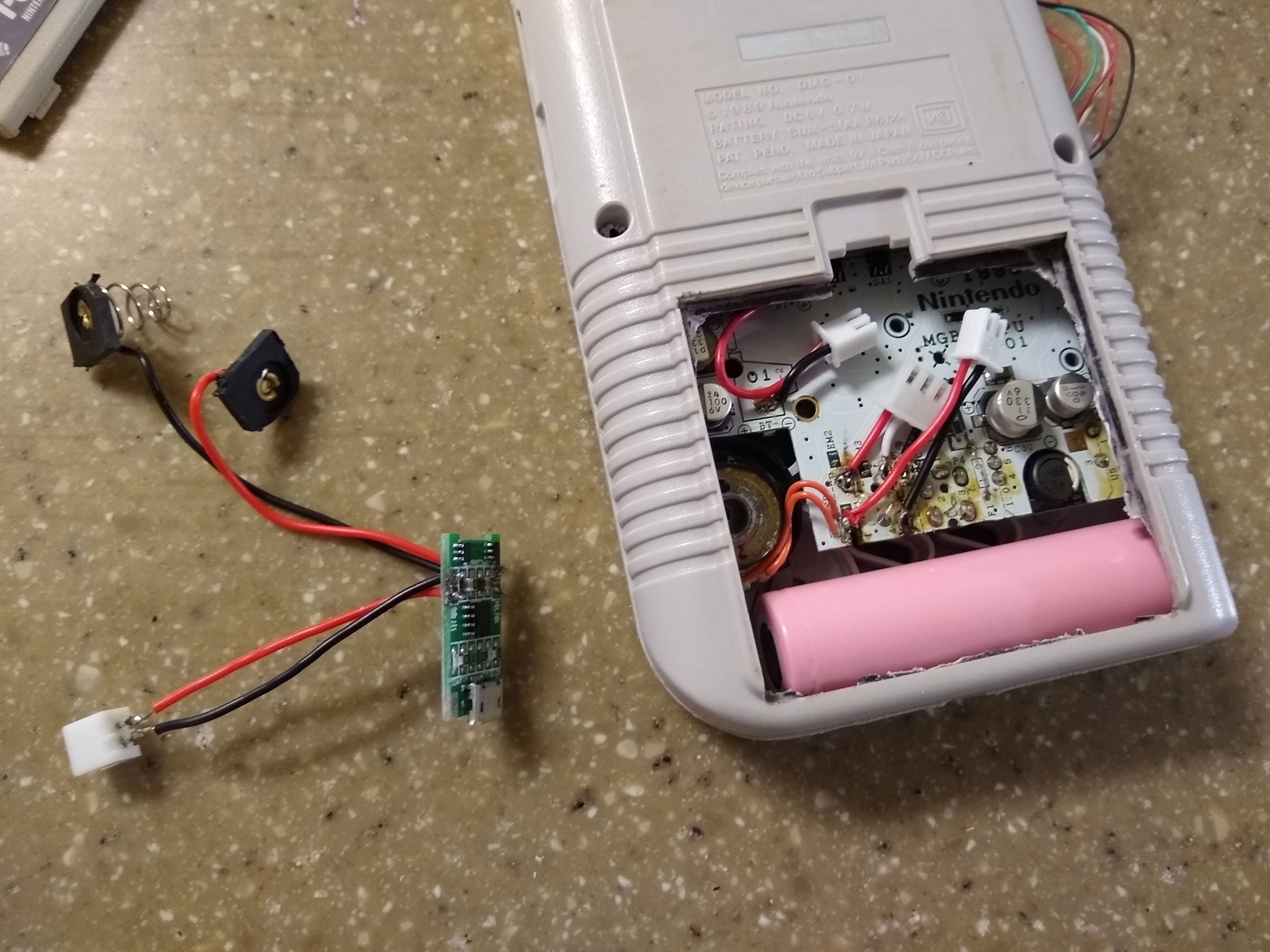

I'd better finish this! It's almost done, just need to glue some stuff and wire up the face buttons. I mounted the charge board up by the screen so that the charge light would shine through the old power light hole. The dials and ports are wired up. Turns out the DMG link port has the exact same pinout as the Pocket link port. I should be able to use the stock on-off switch (the grey plastic piece, not the switch itself) without cutting it, so it will still have the bit that slides over to lock the game in place. I plan to install the magnets and have everything else working and ready to go before I wire up the face buttons and close it up.
When I was installing the micro USB port, I thought it would be a good idea to put a USB cable into it to help hold it in place. Well, turns out there are holes in the sides of the port, and I ended up epoxying the cable to the port. I tried to pull the cable out, and the male side got ripped out of the cable, still permanently glued to the port on the Game Boy. Good thing I had a spare microUSB breakout board I could use.

Looking good! I bet it feels so good, and maybe a bit weird, to hold a DMG game boy so thin
The battery board is a TP4056, this one is supposed to have undervolt protection. I don't know that there's a lot of danger of undervolting the Li-Ion since the DMG usually runs on 4 AA's, but I don't know exactly how the DMG circuitry works.

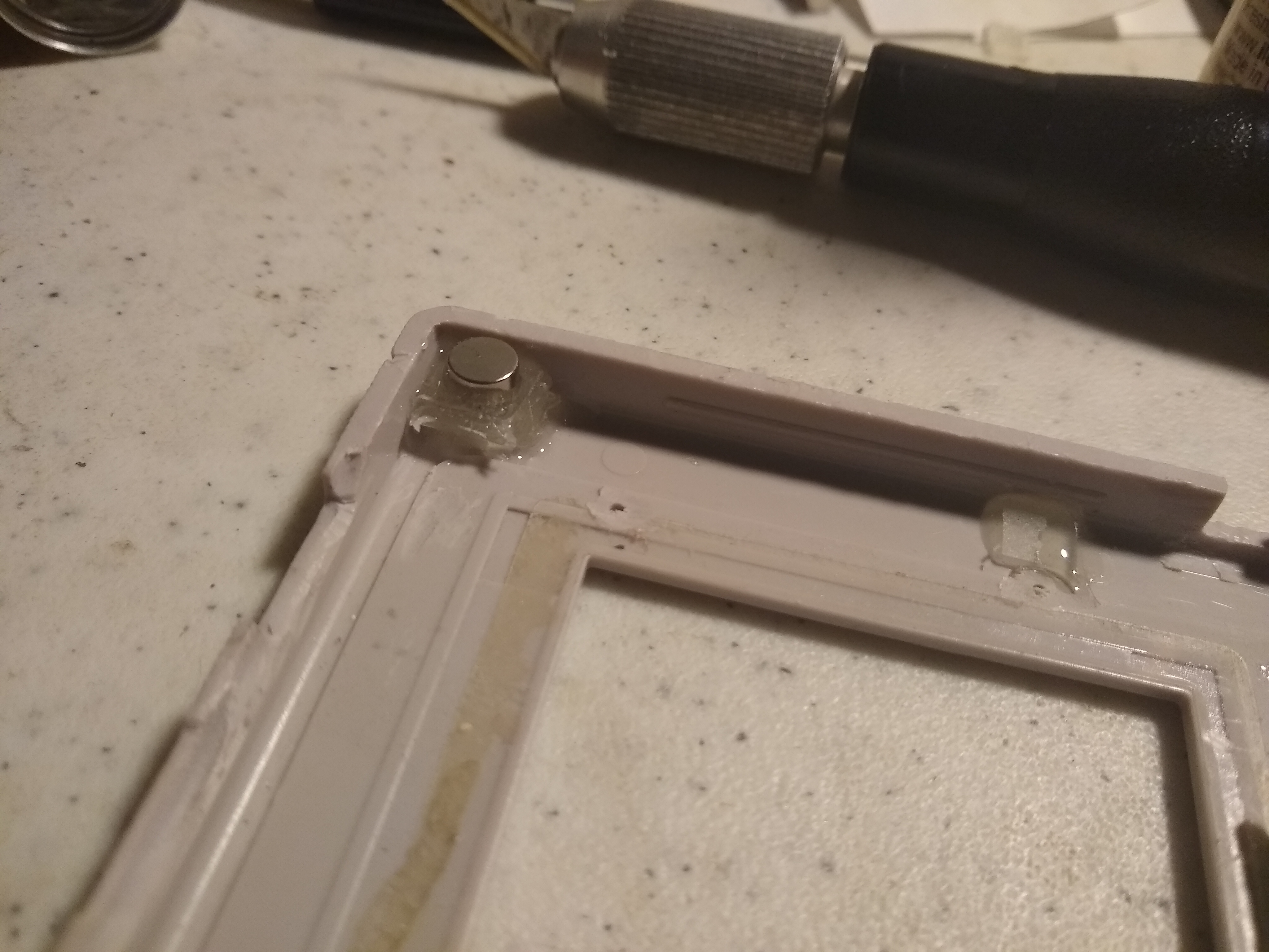

Clearwelding in the magnets now. It takes a lot of gluing, drying, and testing to get them positioned just right, but I should be able to fit a pair in each corner of the Boy. Using scrap plastic to elevate the magnets.

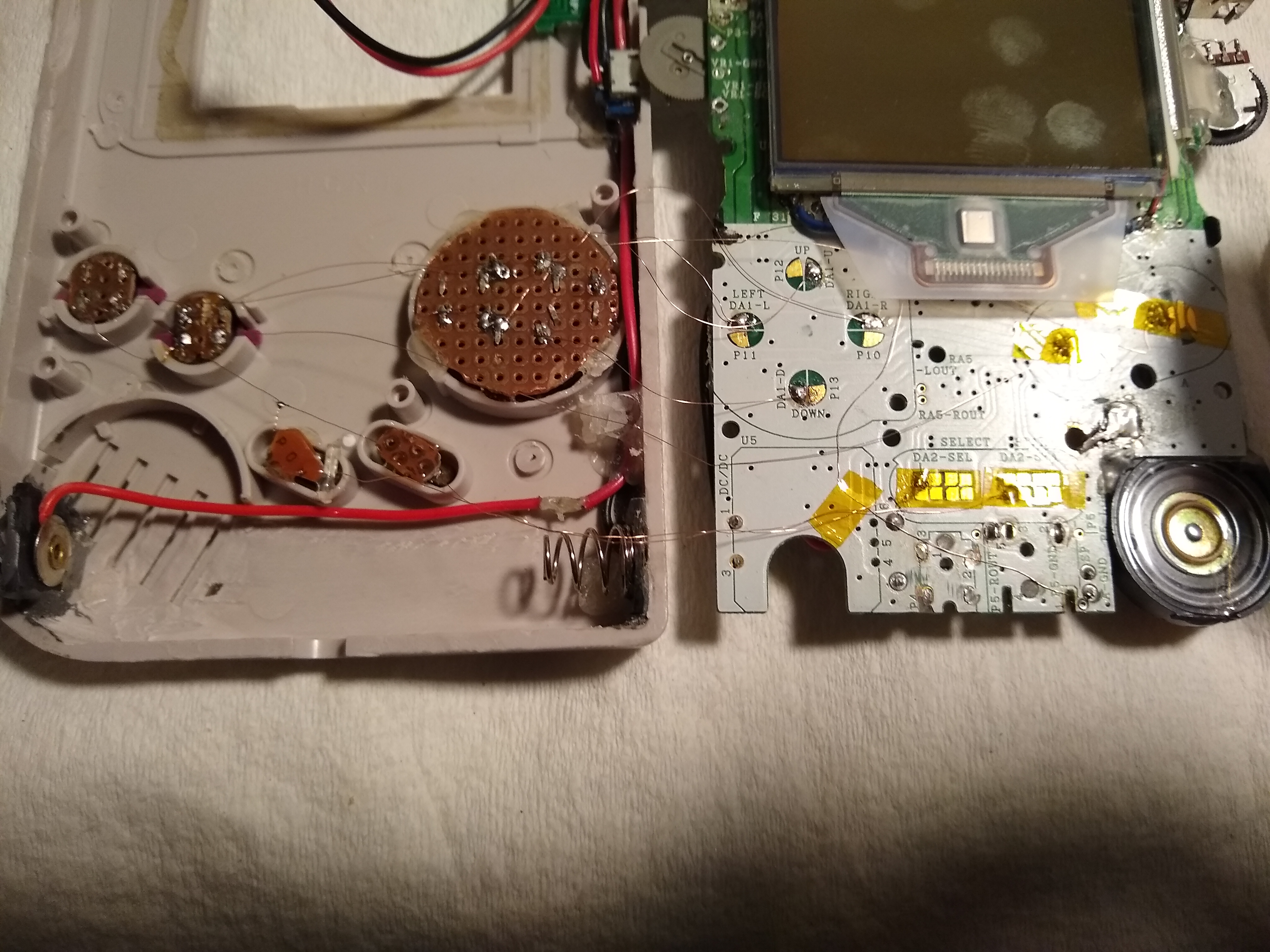

Turns out two magnets on opposite corners is plenty to hold everything together. I wired up the buttons and tested them, to find that every button except Left activates the Start button. Left activates Down. I thought I could use the common-ground of the Pocket button structure to make the wiring easier, but I'll probably just put 2 wires to every button. I should also come up with a better way to secure the wires so that I'm not just stuffing them in and shutting the door.

I got all the buttons working except UP, which did nothing at all, no matter what I did. That's the kind of thing that makes me want to throw the whole thing in the trash. I didn't want to have to carve open the D-pad enclosure, but I didn't really have a choice. So I put a new tact switch in there, which had a habit of slipping out of position, but now it's been working great for a few days. Some other stuff came unglued because I didn't rough up the surfaces, the volume dial stopped working, and the link port needed a new wire, but I stuck with it and everything looks to be good now! So I'll make a Cutting Edge thread and finally start work on my portable Wii.
