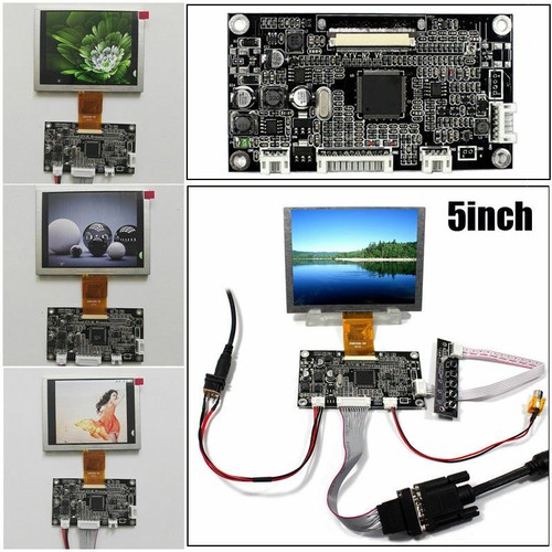

You will be able to use the G-Boy Manual as a guide for most parts of the G-Wii. Differences that are going to show up are as follows:
- Screen wiring will be slightly different as the 5' screen has a completely different driver board. (the schematic is posted somewhere on here, or I'll repost it)
- You will need to buy: 5' display, more batteries, a standard GC+, soft and hard tacts of various sizes, and a U-Amp

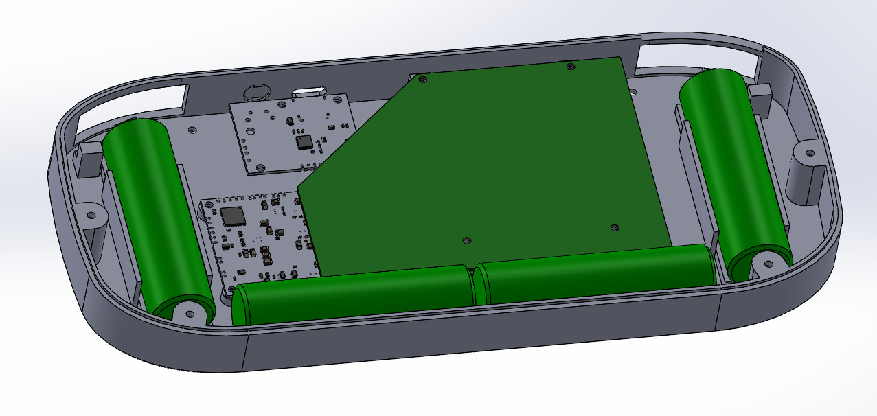

I've updated the GWii back to fit the new PMS-PD and RVL-PMS-2
Just checked out that new 4layertech store. Really glad to easily be able to acquire those parts again. was wondering if this case fits the new U-amp 2 as well.
The Uamp is just glued or sticky taped into place so yes it does fit
Yes it is the same LCD panel, just a different driver board.
