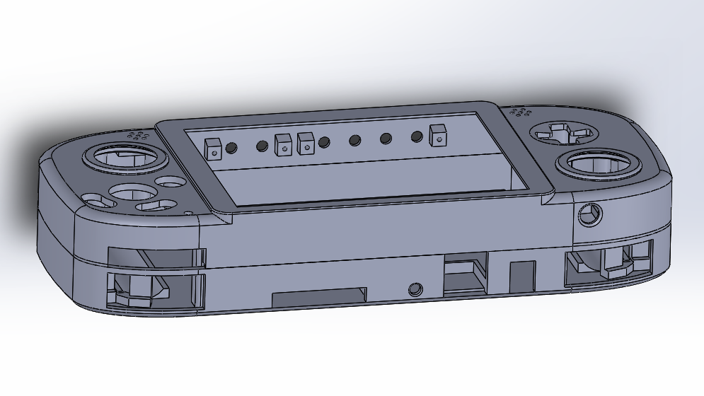

I edited the GWiirev2 to use original Wii USB port cut from the motherboard, on/off switch is a normal tactile, and uses same charging jack as GWii1. This does not use the USBC board. Only the GWii bottom is changed, uses the same files for the rest.
Thanks I keep having a problem when importing into fusion 360 it looks like a mesh?
This could be one of the best or the best portable, beside the GameCube memory card slots.
You’ll have to import the SolidWorks assembly. Gman provided both the assemblies for rev 1 and rev 2 of the G-Wii. You’ll be able to edit them the same as any old Fusion model once you do.

Check the very first post.
The boards needed are WiiPMS, USBC board, GC+, and UAMP
