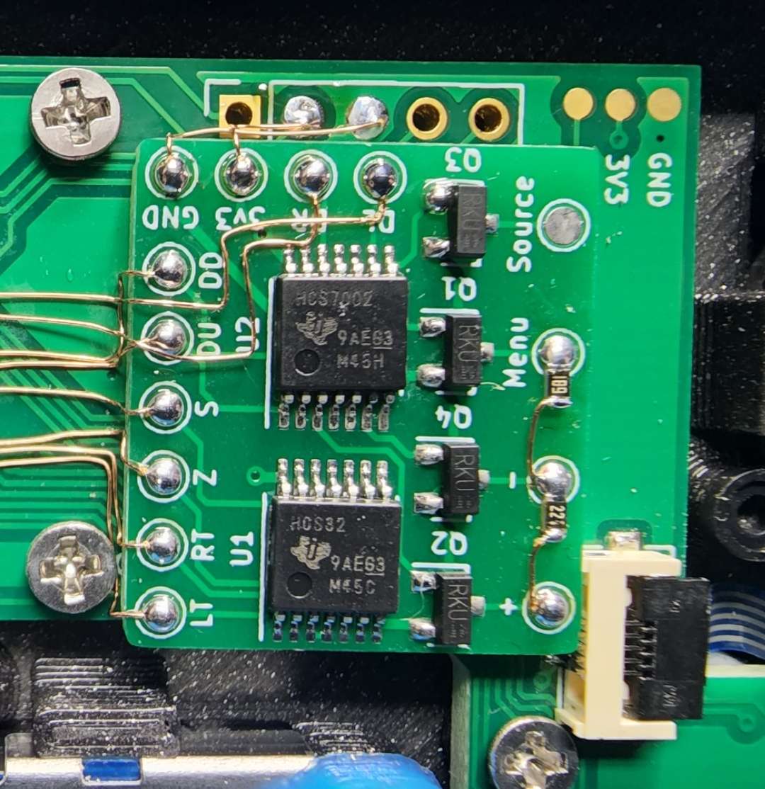

Here's the GitHub report for my OSD control board:
Note that, if you want to use it with the old G-Boy screen, you have to incorporate the resistor ladder on the button board that came with the screen like this:
I also have a bunch of assembled ones, feel free to DM me here or on Discord if you're interested.

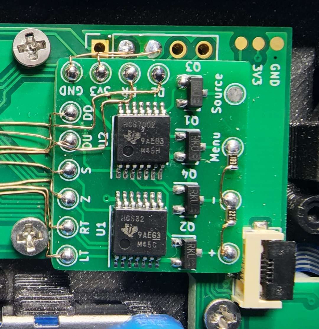

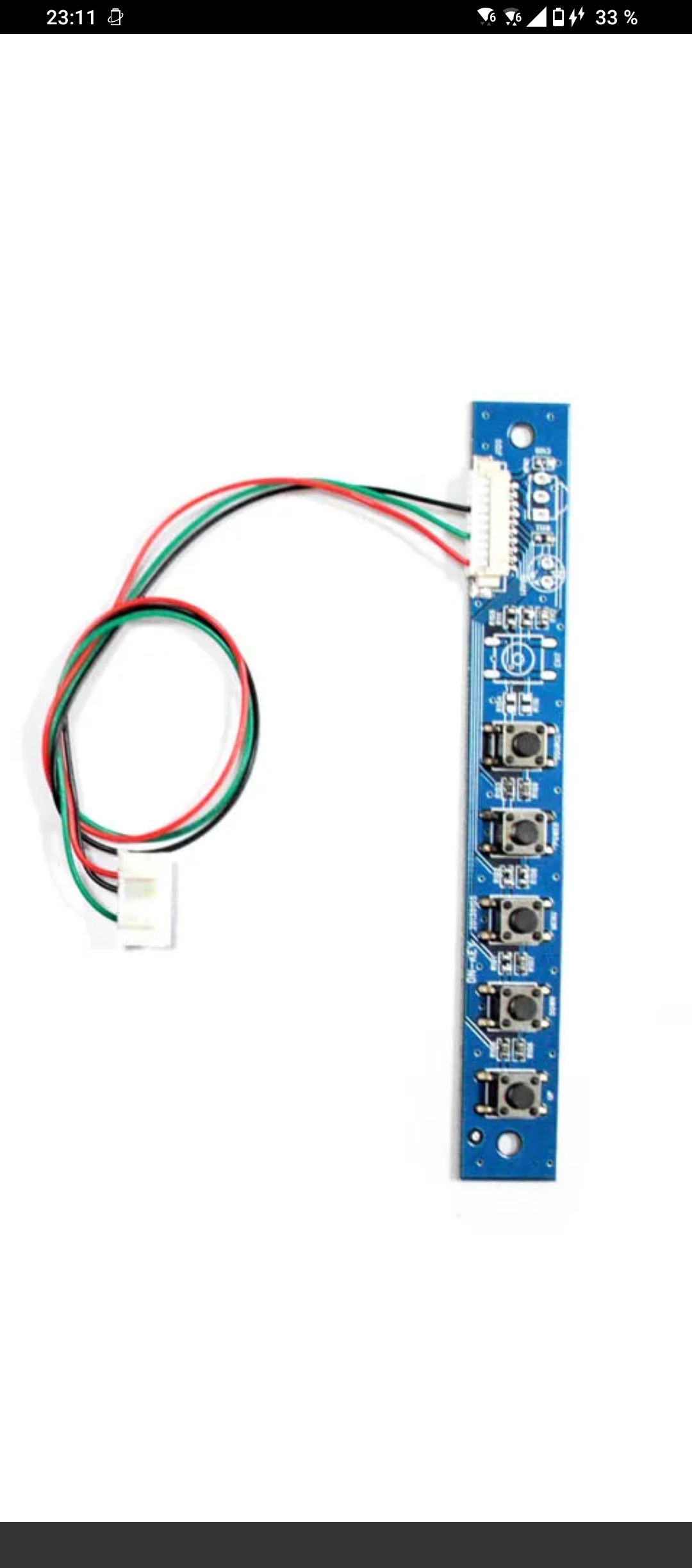

thank you, saw your post. I saw on AliExpress that the company that sells those 240p screens with the driver board, also sell the Display controller board for those. I ordered that one that come into the connector in the middle from the driver board for testing. I give you guys feedback after i receive it in a couple weeks. :-) So that I don't need to solder because I'm still new in those gboy things
here a picture of it
