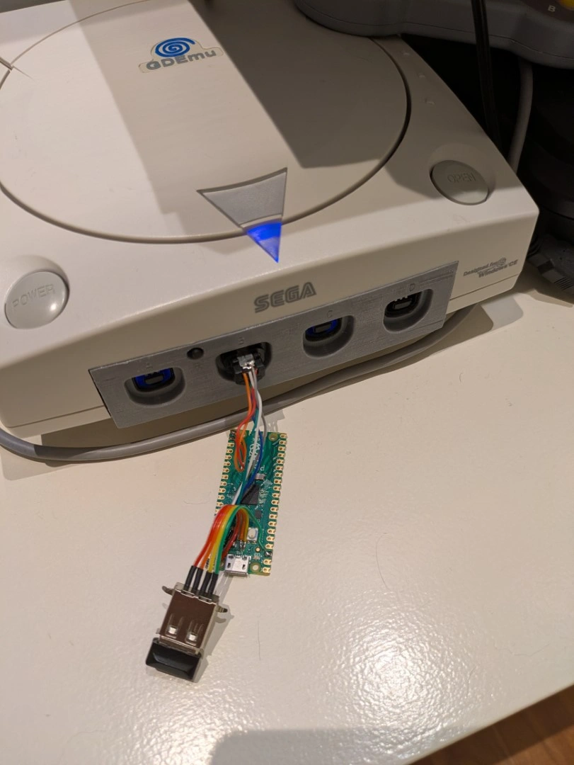

I guess this is what I'm looking for: https://github.com/cluoma/Pico2Maple-fw

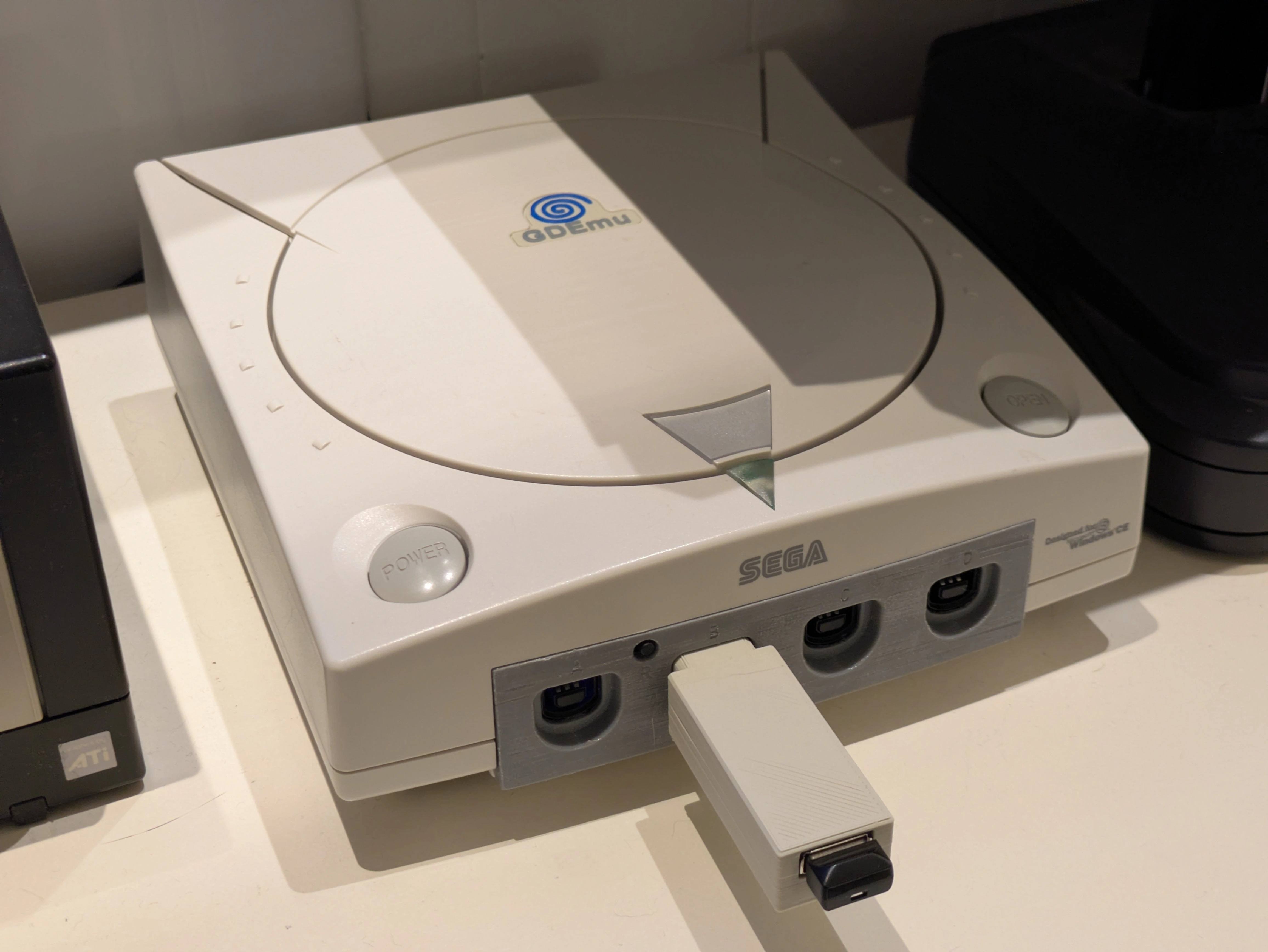

It works with a USB stick even though USB drives aren't mentioned on Github. This is with the rpi connected to controller port 2 and using a XBOX controller to navigate the Dreamcast wirelessly. I designed a case for it. I haver ordered some smaller Rpi units and wil also try USB4MAPLE. I should be able to make it tiny with those boards. I only have a large original Rpi RP2350 board right now so can only test Pico2Maple.

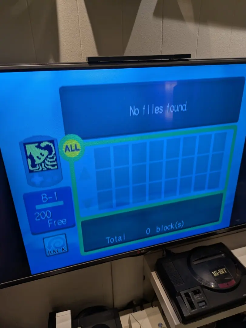

Turns out it doesn't use the USB stick but stores VMU saves in the RPI's own storage. Too bad I can't swap banks unless I plug a controller into the PI. Pressing Bootsel does nothing. I wanted to add a button but the source code isn't available. I can try USB4MAPLE instead when I get RP2350 PIs. Pico2Maple works well otherwise and nohing but a Pico and a Dreamcast connector is needed to use it as a single VMU.
EDIT:
I soldered a wire to ground and tried touching the GPIOs and GPIO8 triggered a bank change so that solves that problem.
