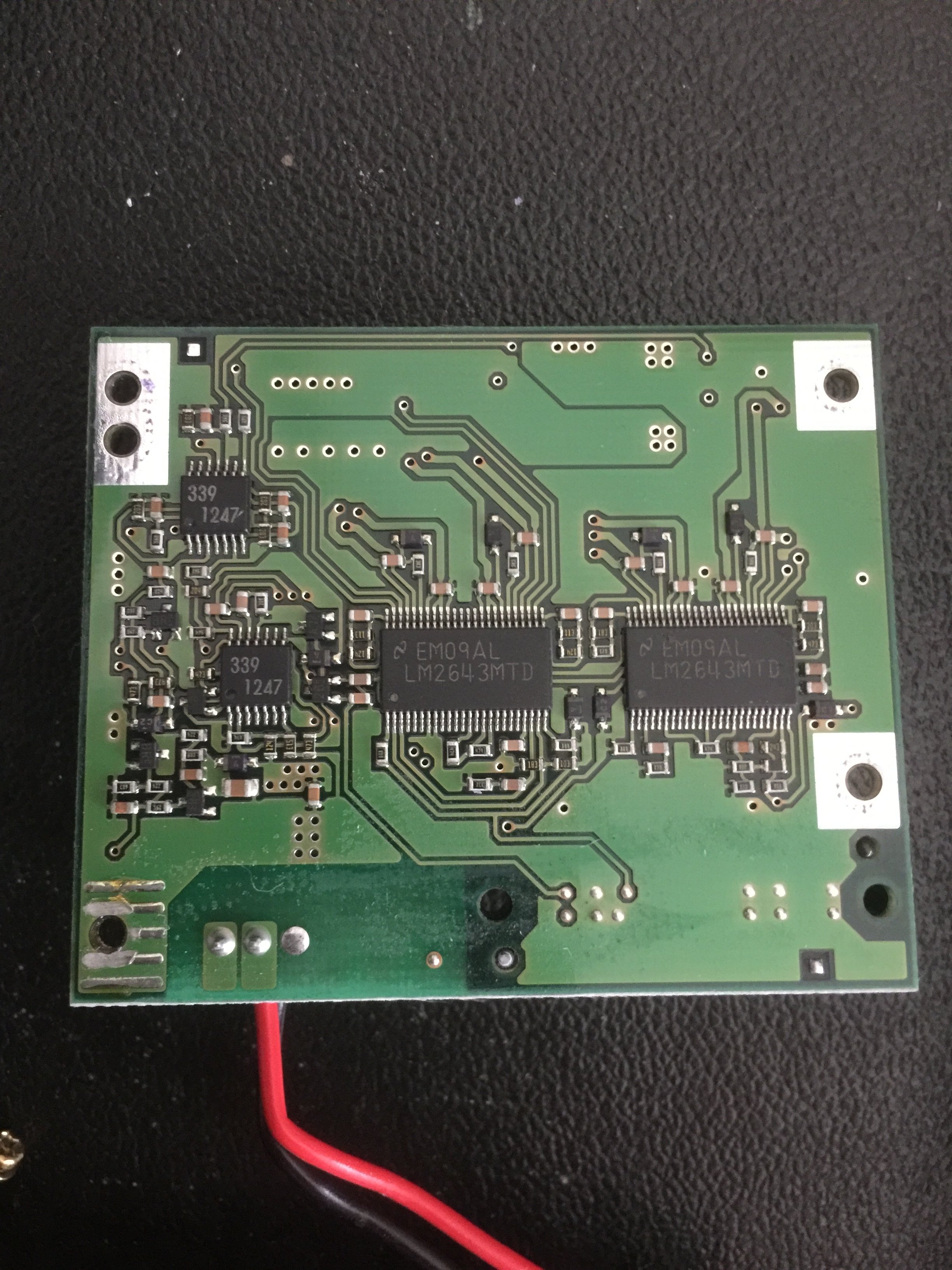

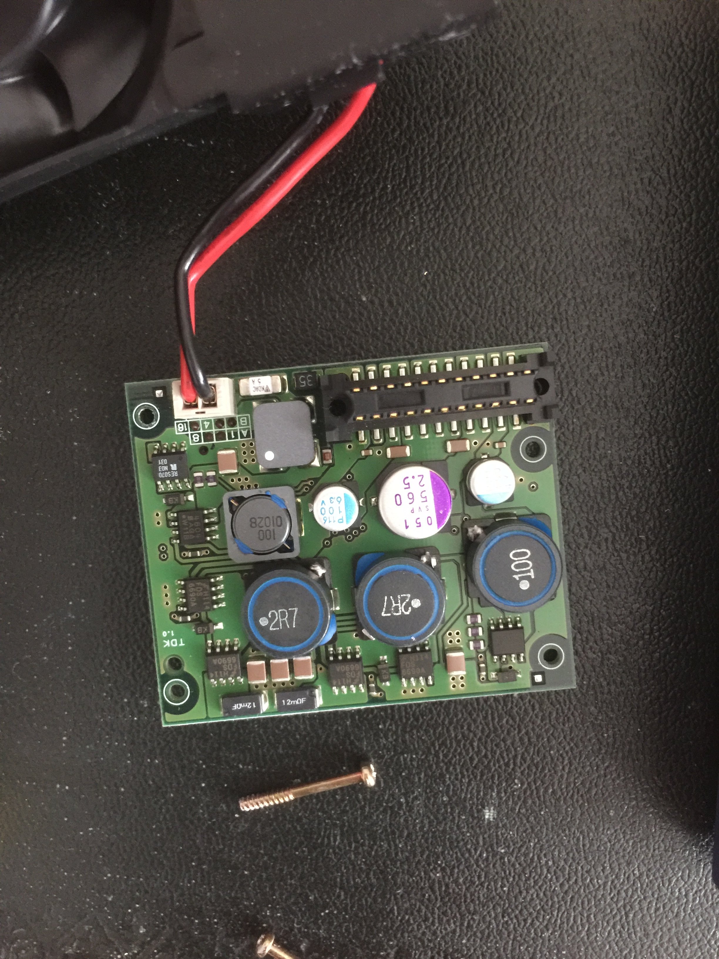

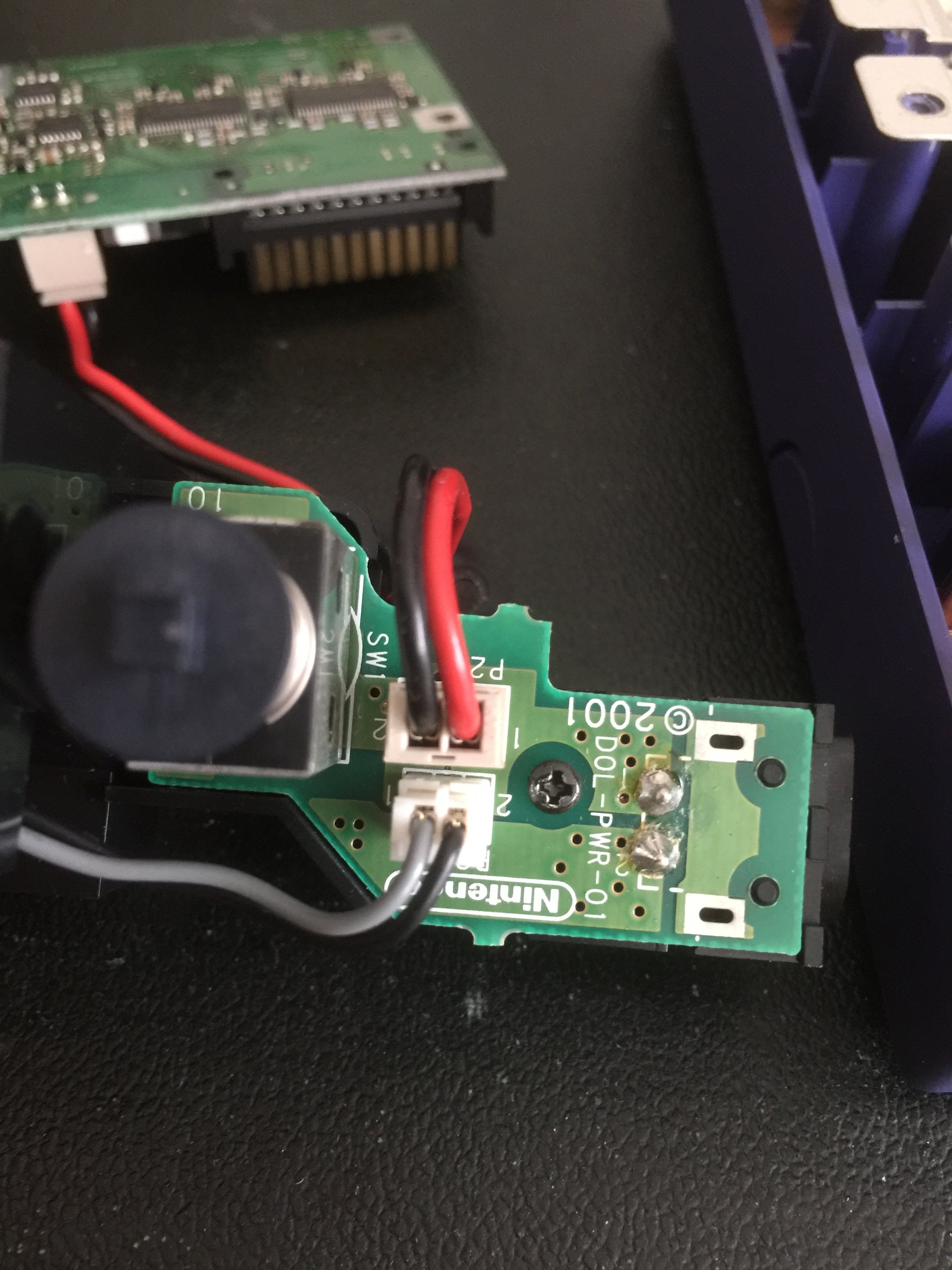

I decided to buy myself a GameBit for my screwdriver and I opened it up. To my surprise all of the components, especially the pcbs, seemed unharmed. I'm not sure about the regulator daughter-board though (the caps look like they're leaking).

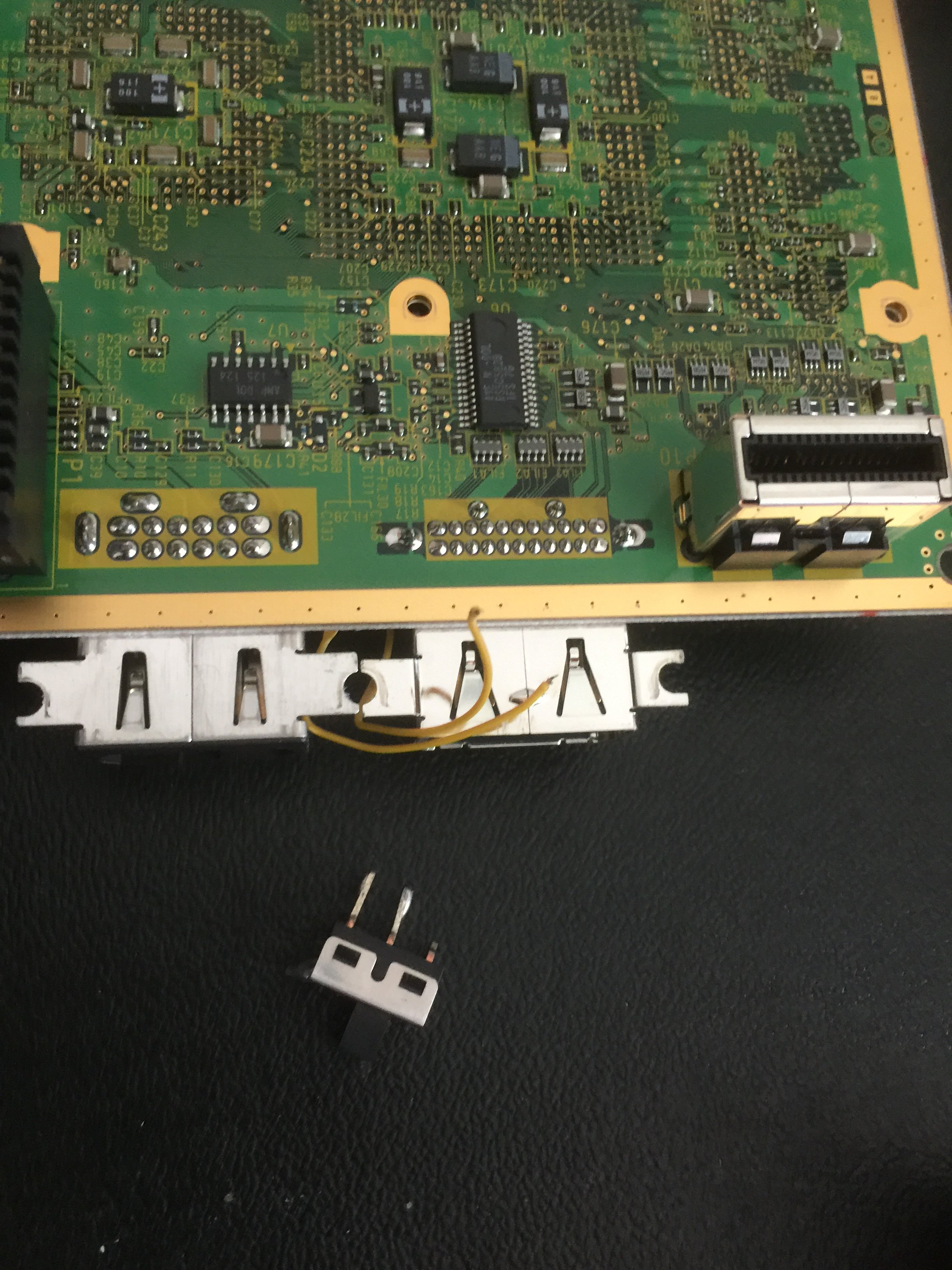

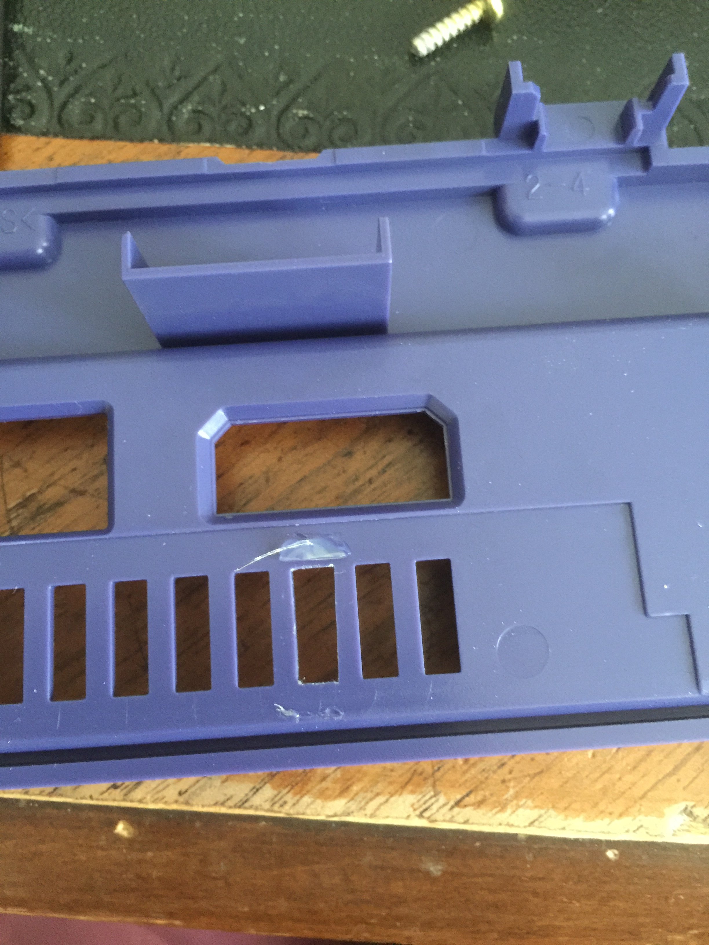

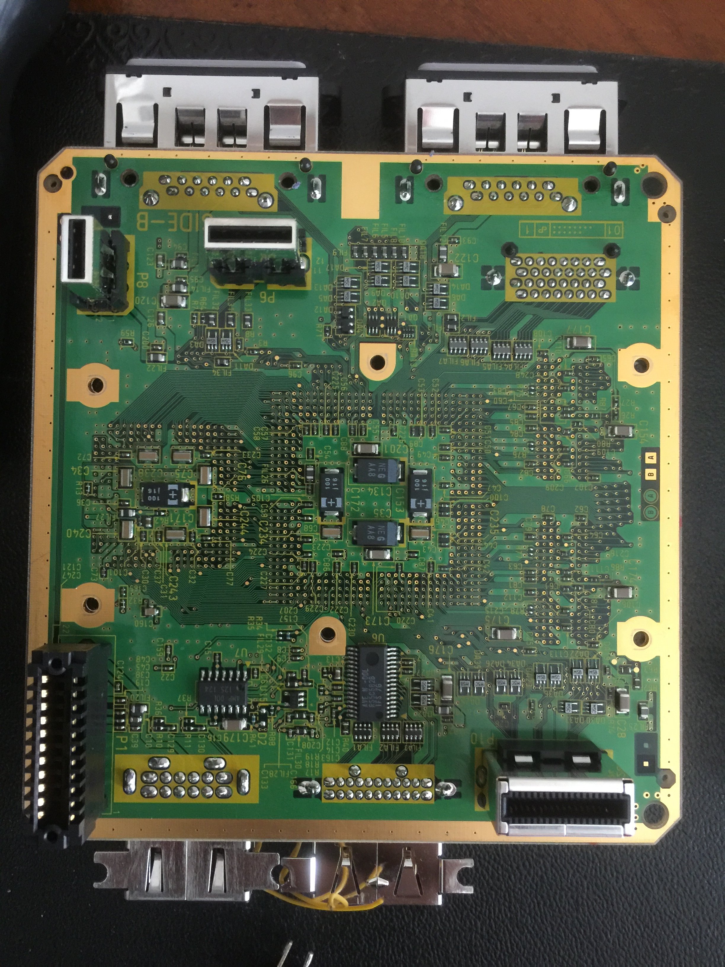

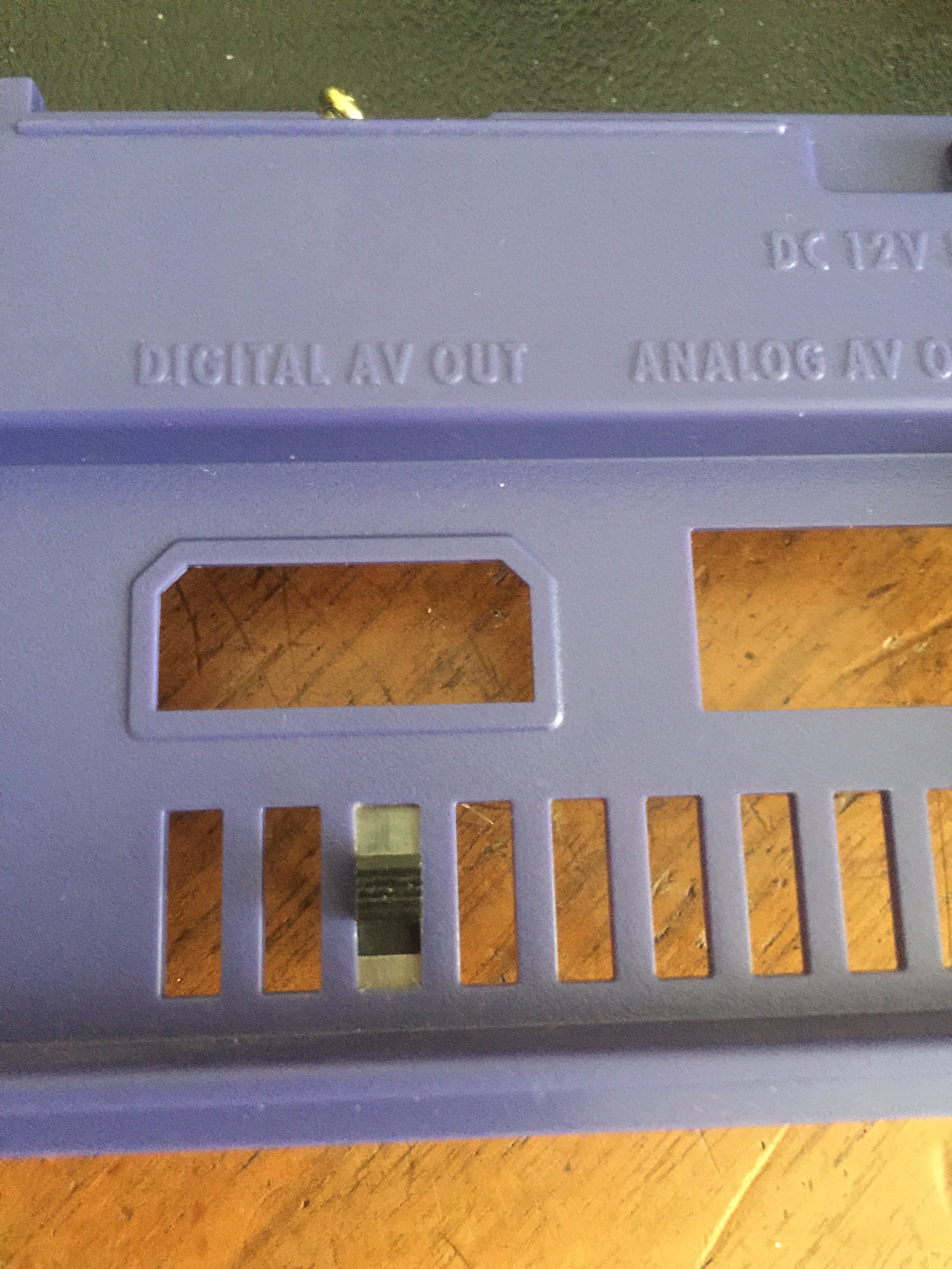

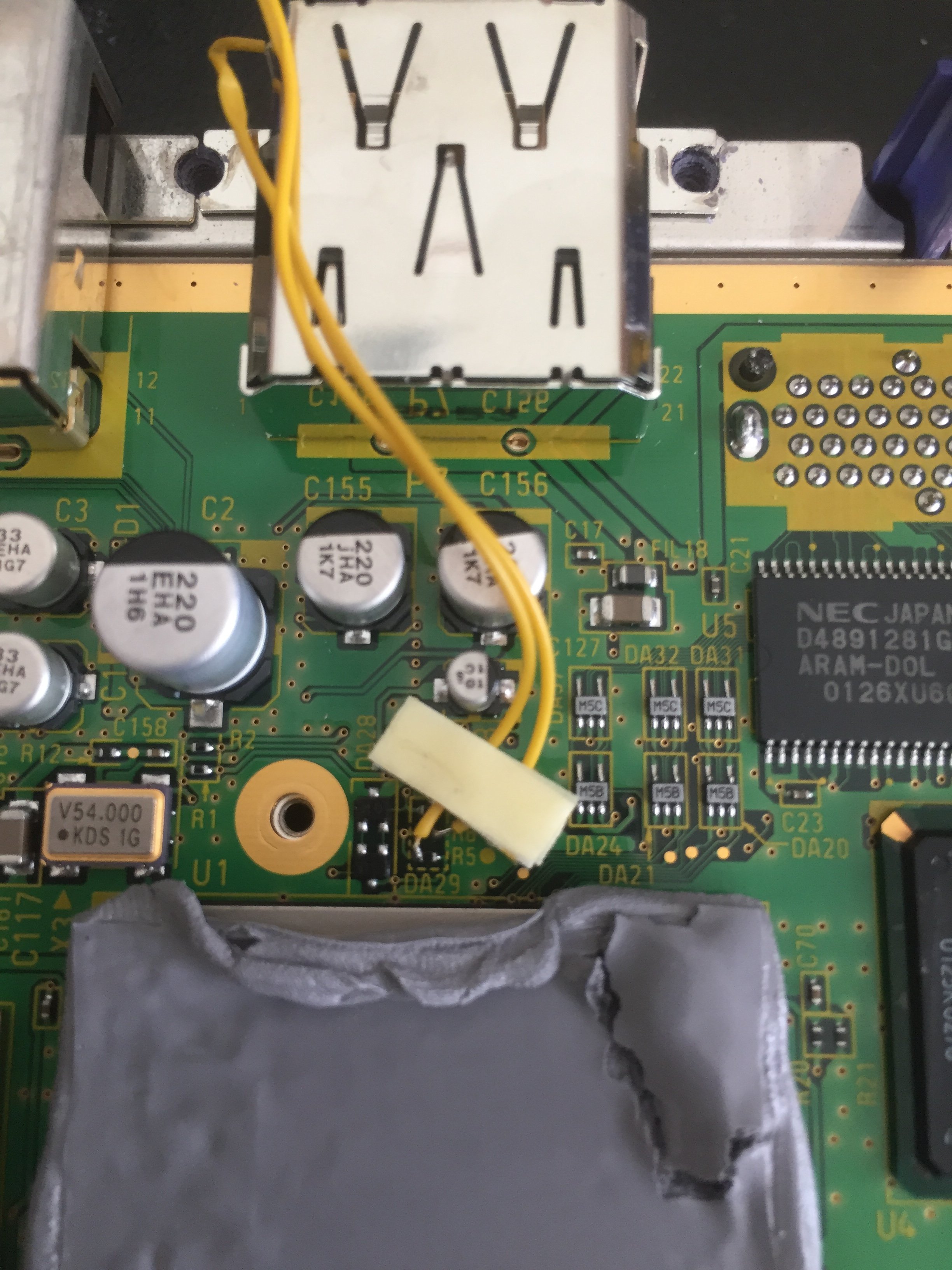

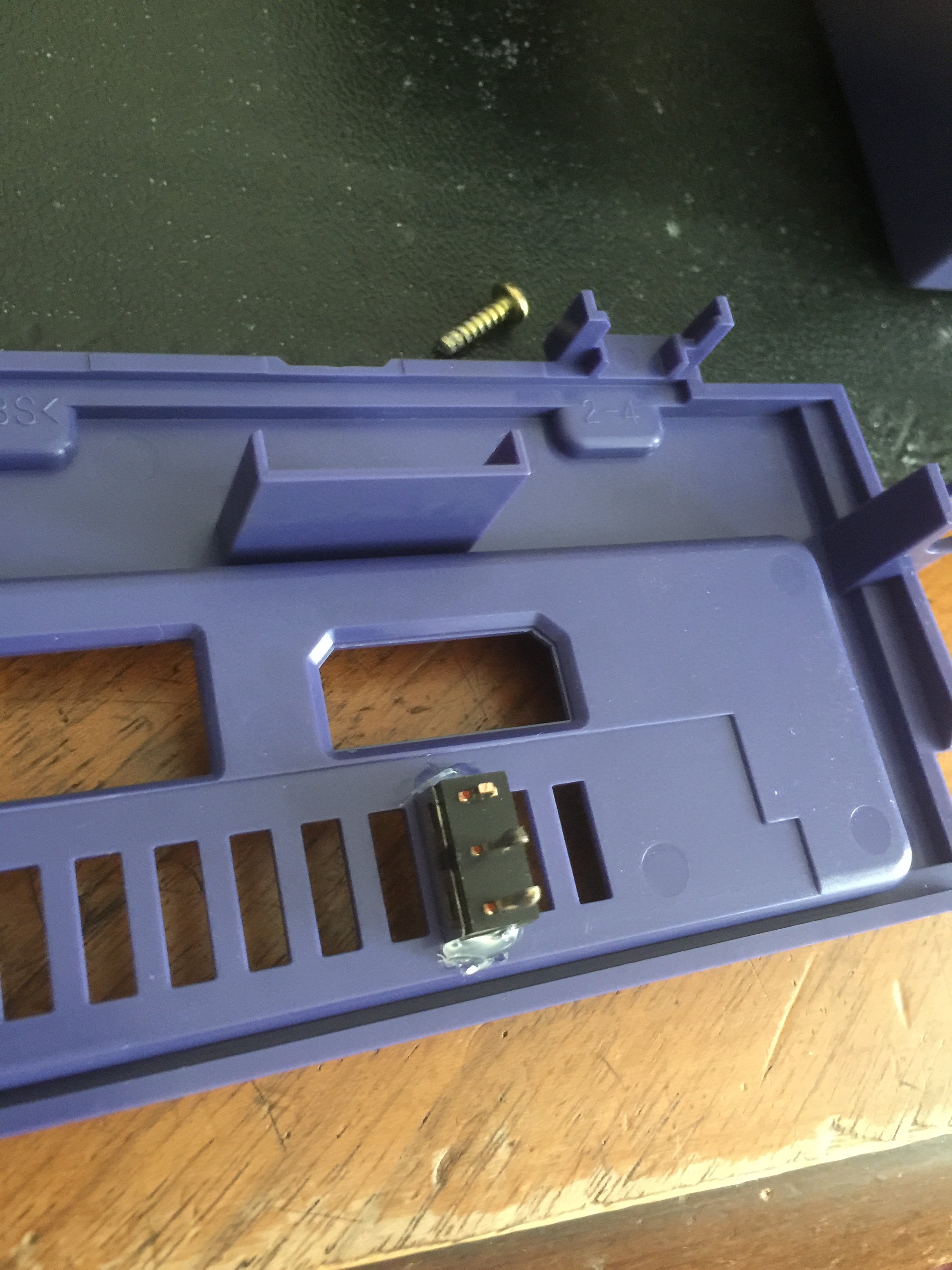

I also found what I think "popped". There is a power switch on the back of the cube, between the slits under the video ports. The solder on this switch + the hot glue keeping it in place melted and it came off. Now I see two yellow wires coming from under the heatsink on the MOBO and I don't know if I can just reconnect them and try it out. Please could you guys give me some advice. Here are the pics from my teardown:
- Main question: Do I just resolder the switch or is the regulator damaged?

I'm not sure what the switch is for? I doubt it's a power switch, more likely a region switch mod? Anyway it's hard to assess damage but if I were you I would test the outputs on the regulator board separately and see if it still works, if it does then there's no harm in just trying to boot the GC again.
Thanks for the quick reply Jeff. Yeah I honestly think the previous owner installed a region mod, can't find anything about there being a switch there in the stock version.
I'll check the outputs of the regulator board once my multimeter arrives (such a noob didn't have one yet). I'll be back
Pls photo
of top of mobo
where the yellow wires go
I fix for you my friend.
No but seriously, it looks to me like a region mod switch. Not surprising seen as I live in Europe and this was a Japanese GC.
That switches between NTSC-J and NTSC-U, pal is a whole different board, whereas us and jp are just a resistor in a different place. I'd check the fuse on the reg board, that most likely is your culprit. I'd just take the yellow wires off and leave it as whichever region you want
