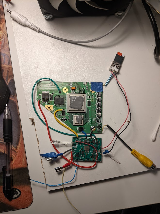

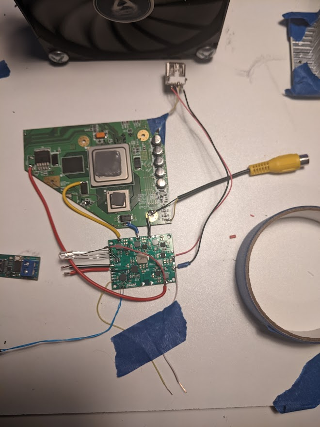

Just got an OMGWTF trim working this weekend WOOOOP:)
Photos
Cut with a multitool sanded with 120 grit sandpaper, then a high grit chisel sharpening block, edges of the Wii came out really smooth
Found 1.8v and 3.3v were directly shorted to ground so removed smd caps near the edges
But it was still shorting so I removed the LDO pins (This went horribly but I have some solder mask if I want to hide it)
This stopped the 1.8v short I think
Realised I sanded the edge of a cap near the PCB edge next to the nand chip after I removed this no shorts :) resistances attached for fun (I think the 1v to GND is wrong it was in the hundreds when I measured again when measuring with a multimeter all resistances seemed to change while measuring quickly at first then settled like the voltage while charging a capacitor)
Also while checking my wiring found I wired the U10 to wrong via

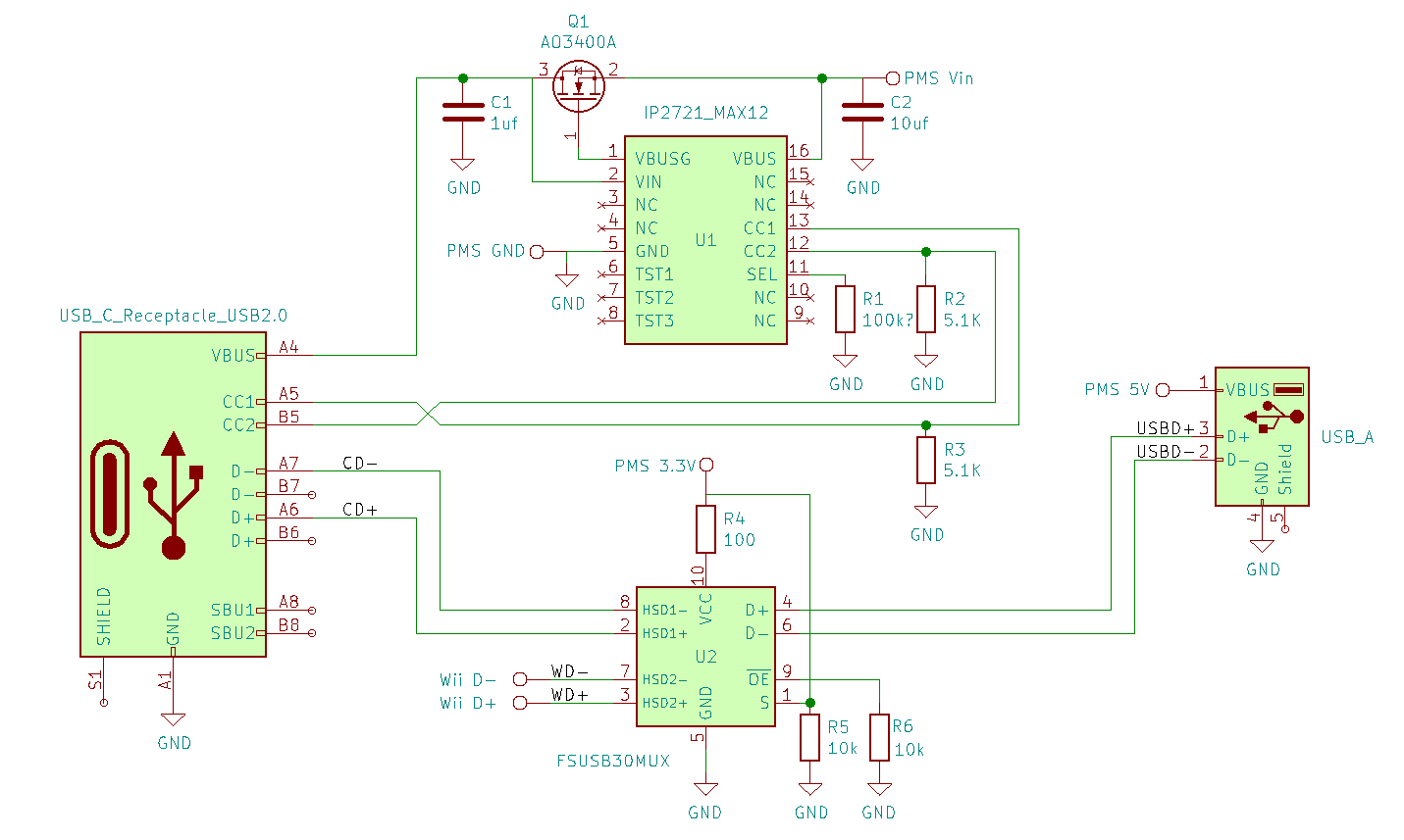

USBC PD (have some initial PCB plans that I made a while ago) although 4 layer tech's one is pretty cheap
Possible
MX chip
WIFI
USB-C PD
The PD bit is handled by an IP2721 or maybe a CH224K seems to be cheaper and more available to do the same thing (also doesn't require a transistor I think but I need to research)
Data multiplexing this is simple just connect USB to Wii when it sees 3.3v from PMS, but when it receives no voltage (off) the default connects USBC to the USB
Although as I designed this a year ago the specific chip has probably gone from digikey

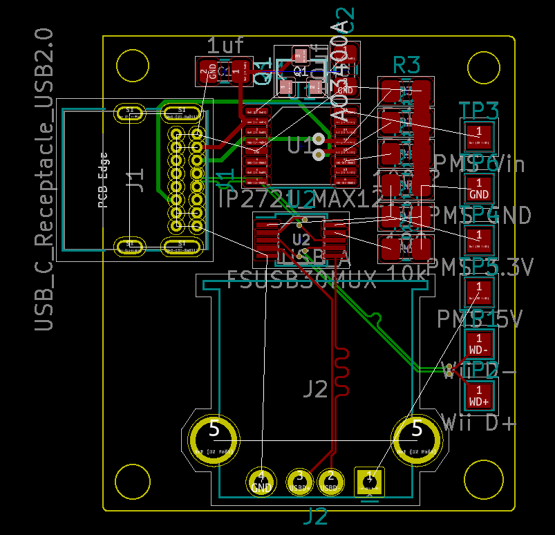

The issue is powering the USB either have a 5v reg and a multiplexer (on this PCB I am designing) to switch power to the USB from the PMS or the reg.
or
Change the PMS code to have the PMS 5V regulator on when it is charging (this is the solution I want to do to minimise components needed but A code change will require a lot of research although do remember somebody's worklog doing this and B having the 5V reg on while charging my waste power but if I only use 5V for the USB it wouldn't be much.
Also designing differential traces seems to be quite specific although according the internet at USB full speed the traces don't need to be exactly the same length and vias are not too bad for data transfer rate

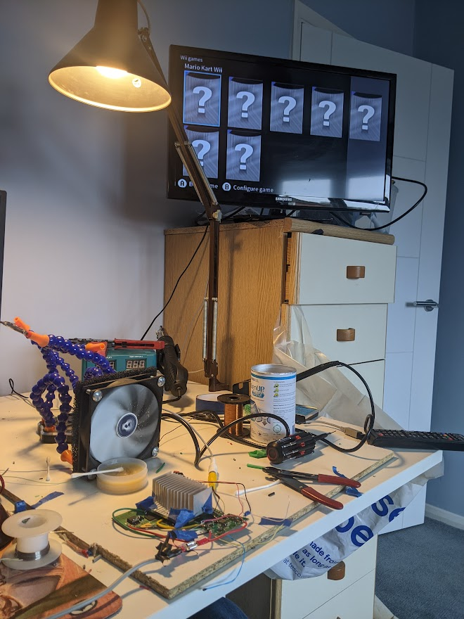

Update from August last year

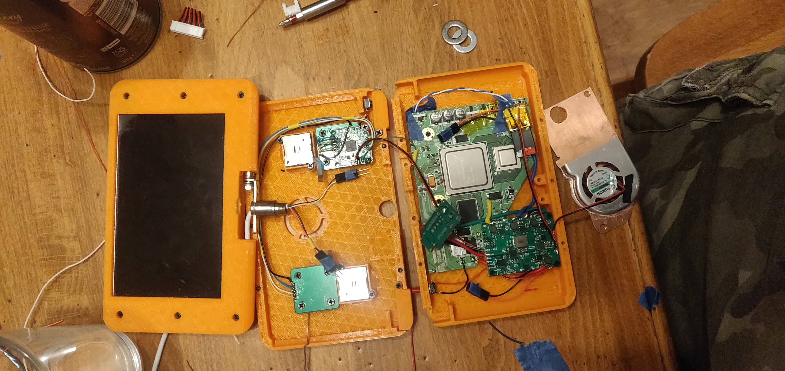

Got it assembled but dislodged the usb wire so it didn't boot after assembly and also of the controls were still not wired

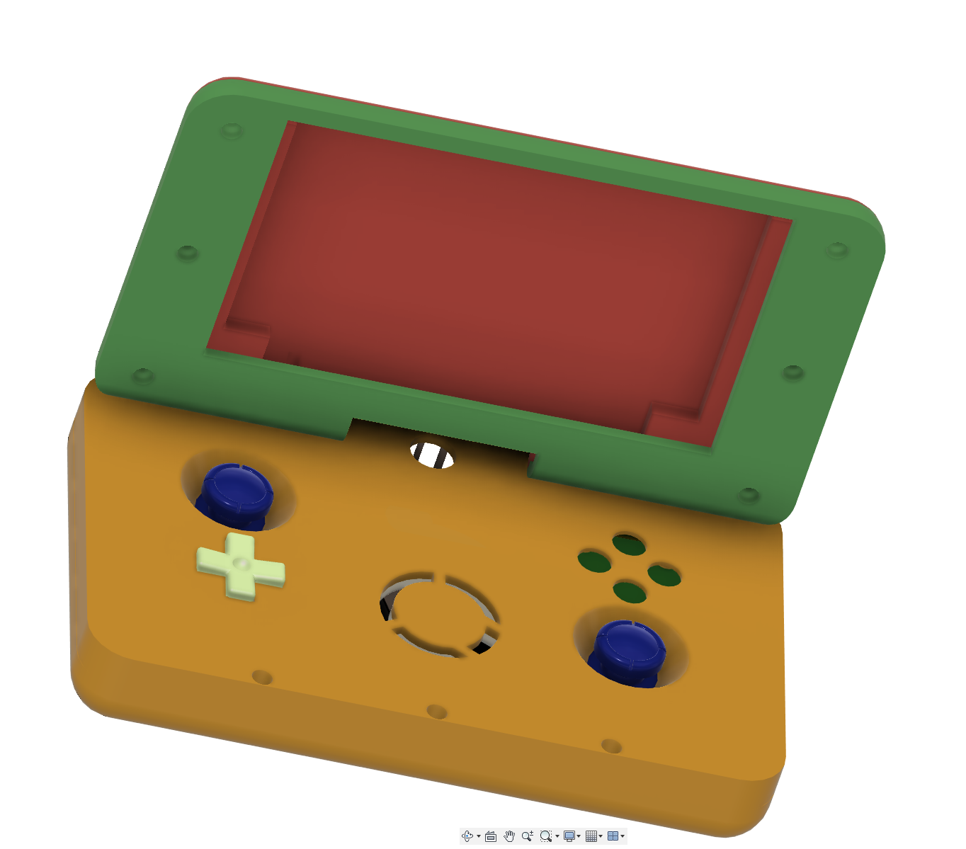

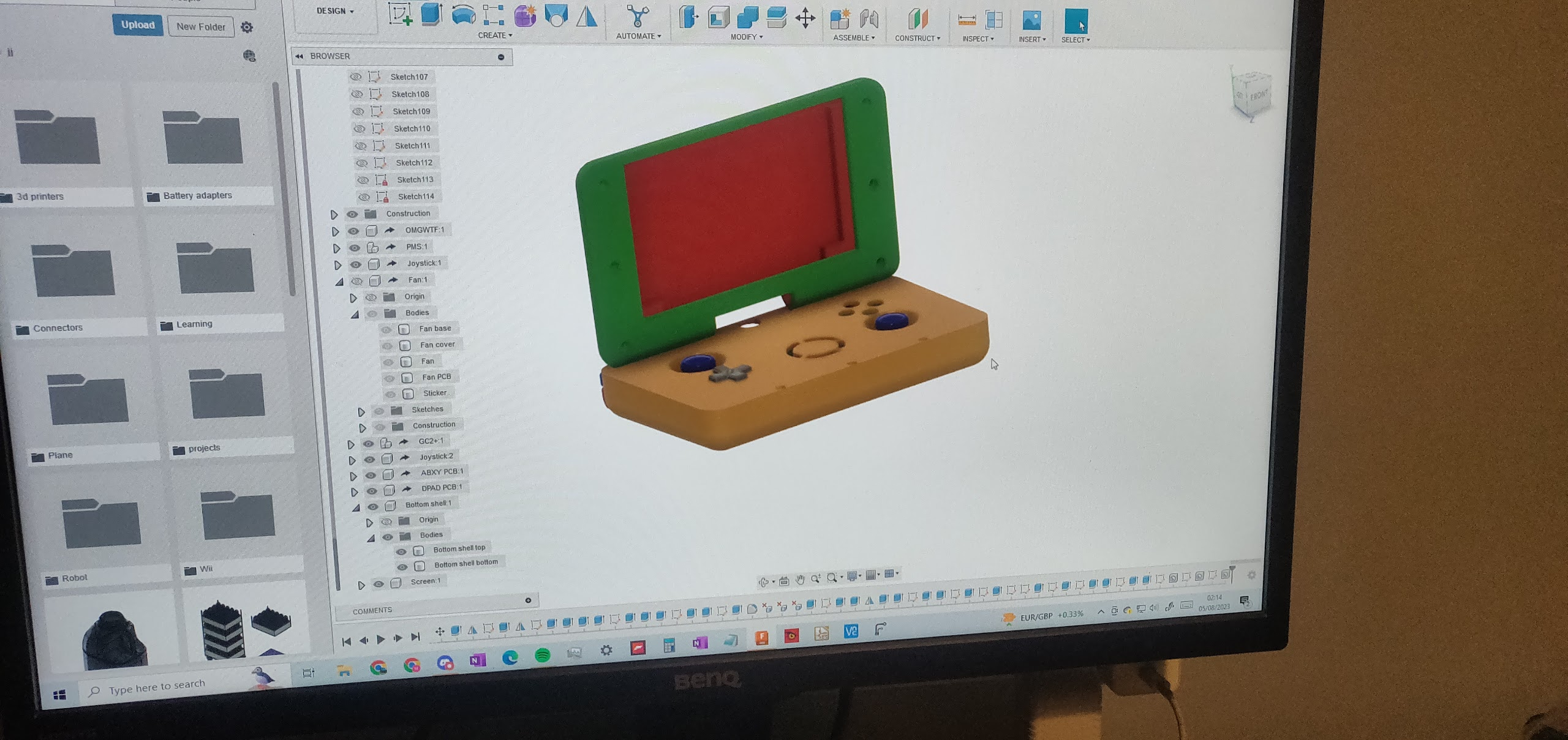

Good bit of 2am CAD
AP1GczPZsRSaZs8_lv9UWB2VOT6Q9DwB0AkprQcaIYk_sW4NmdI6uOSFVvXMAbB60G7-soNT717T2yCp1V9XhujlzkmJAxTfEB7eZ4Z9ANXHPFshrn19vbUZiF4ayAdSgI231cs-zC-BWXnBIdiCM3I3t9uB8ooyiTbYQOvJ5hguRqO2ZNZfmbXfyw83KMrj36fRGTo8Aa5iOWXwdiTaITt1Ms6qWkopglpFEQ6hiJ-BTUSxt9UfM2YAUh3h9xjvr_1vydh2OtocgxWu5T6-nNr3PqwKYmC5cSmghccNnERGCg_cHl5c3QLkkup7lA0KIUg9sjJympuP65T9qo2EygzdYno7ntaGit-OvI34YiMmwiZvI4cjRpVdfMrfItFh49wfw_BMNXkrojNqLap9XfrelJ0KNGDXNihLy0fmTlILV19zctF7oW4Dc98bpqSA78yInLhttfko8y1oPoYW7rWOeMs1w9iSGX_GbUXA1PLrWHC2UceSmGKuKuqS8GcHiRMEXH5-tk62QZQ7eb6eKPZL5q9BHgYH4Vg1wUYaLbIny2hwl_Y0hhwfGtGVSBvYU8cQUdymXIYrxWG7Q-da2GvxVdXYmtknll_hUNeaWD5jDzJF84y_k-VaQIkoRtfkCzB8X8LirYMELhK2GF_ZENrV1Xf7rPTWIIpgYjx36QrGvRtTmeobvz1JXXudh4ol87PjL75cTKtDvINO2-KwY-ccJqnRH3Bq-VOpPTib3BW28av0lsF1FaNlwNBY7tAw_8mIgU-nsX24HWqeOl57raWQwVWR7eaBV-4T5Uvf88Ye-gO8qJAArYMf_XAVME4JRhMqd6OE7IpmJpHIf74hVXJOFKgDgu1-v56SpXgIAZ9yd39J4IYBbmqCKMAwhVXNgwQaCI8EDiTdIw92YxLWHIeQPf9U=w2560-h1209-s-no-gm

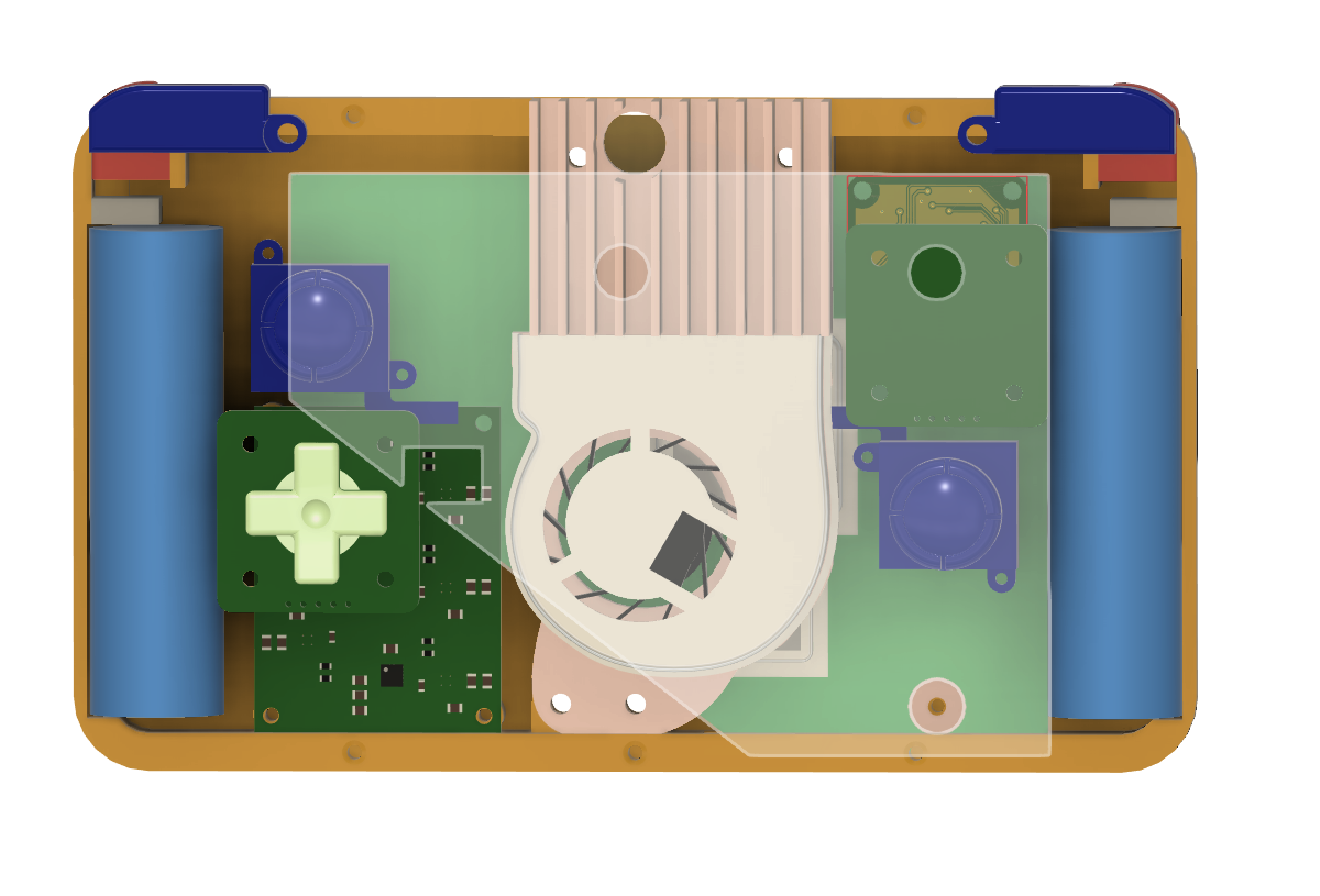

This design was a nightmare to assemble mostly due to the fact the hinge had to go through the top of the bottom shell (the middle piece in the picture above) and then be mounted to the heatsink but the heatsink had to be screwed in from above so i had to rotate the top shell piece 90 degrees in both directions to be able to put it together and obviously this meant i pulled some wires of the pcb.
Today's Update (only a year since i started :))
Lots of cad has been done mostly sporadically i'm on v78 with 141 sketches so my fusion file is a horrifying mess but the design is coming along
Specific bits I want to mention because I think they're cool
Hinge will still be mounted to the heat sink but the heatsink will have tapped holes in it and be screwed in from underneath.
The buttons for the L and R triggers will be mounted to the top of the bottoms shell as this will make wiring simpler. so the top piece will extend into the bottom bottom shell. ( the grey piece in the above picture will be part of the top shell)
It's a Clamshell
Good bit of incredible luck
So I needed to trim the Wii more for the new heat sink mounts (see picture below). I consulted the compendium and went for it not realising the nand connections are not in there so ended up trimming so close that I can see the copper of that nand trace from the side. SOMEHOW this still boots though so all is good
