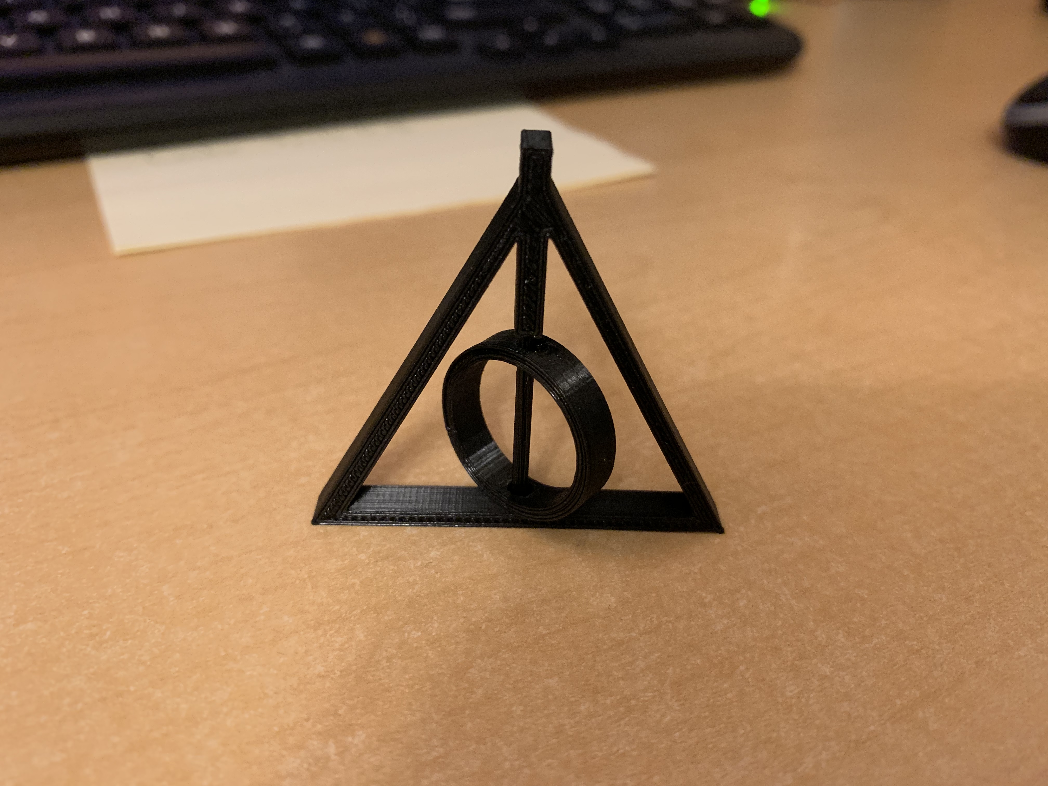

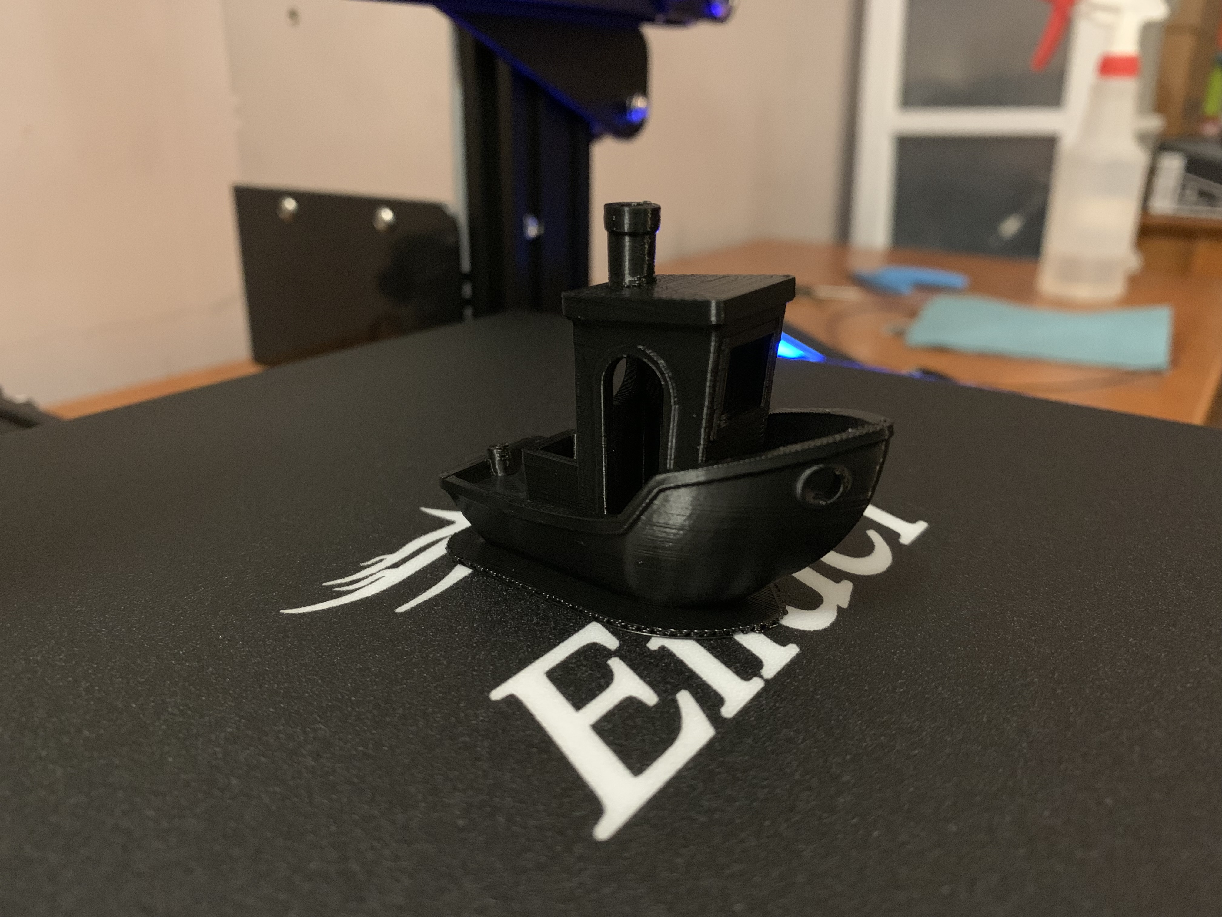

Check that 3D Benchy... I think it turned out pretty damn nice... I've still got to measure it with my calipers to see how accurate the print is. But no stringing whatsoever. :)

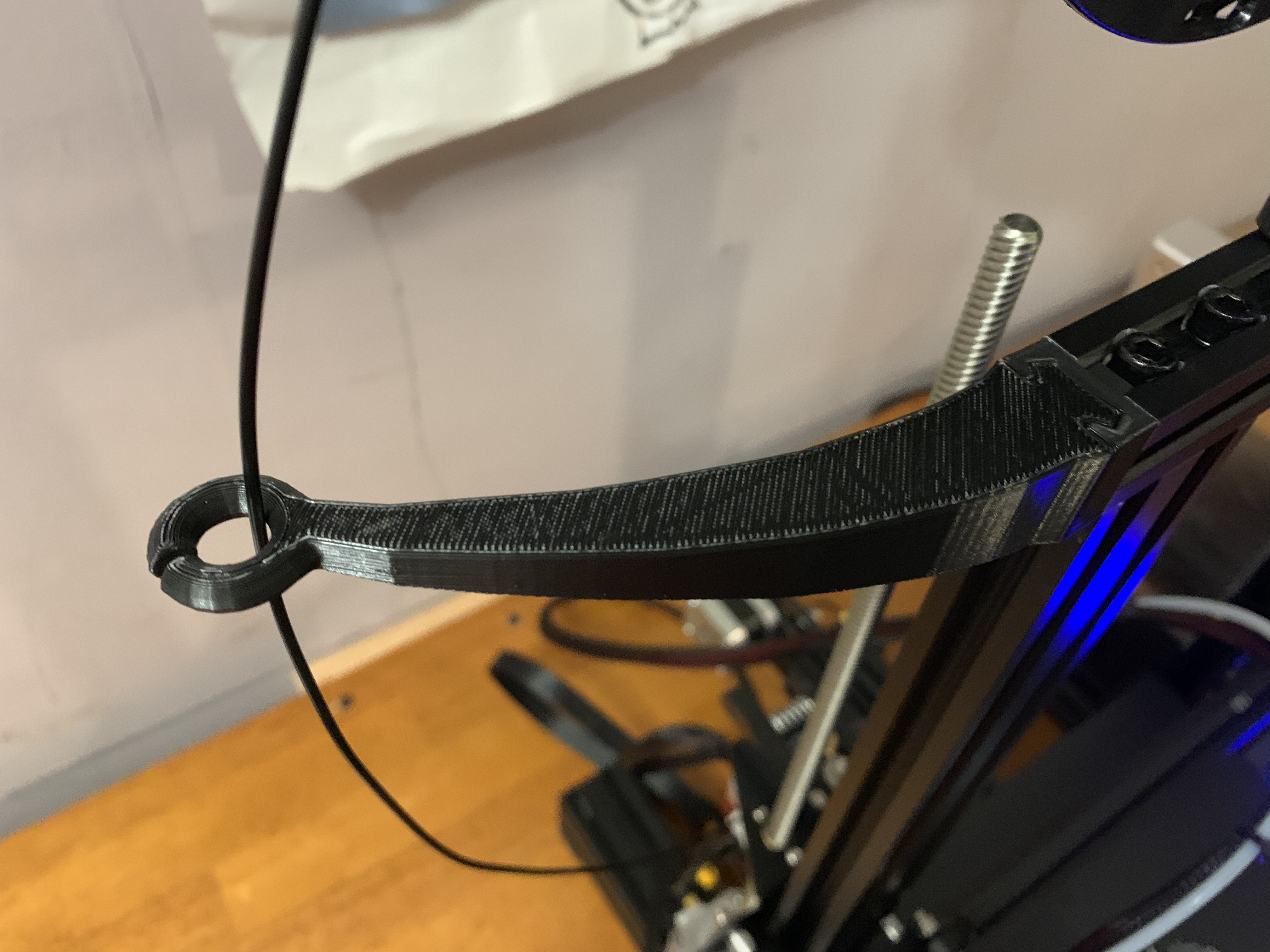

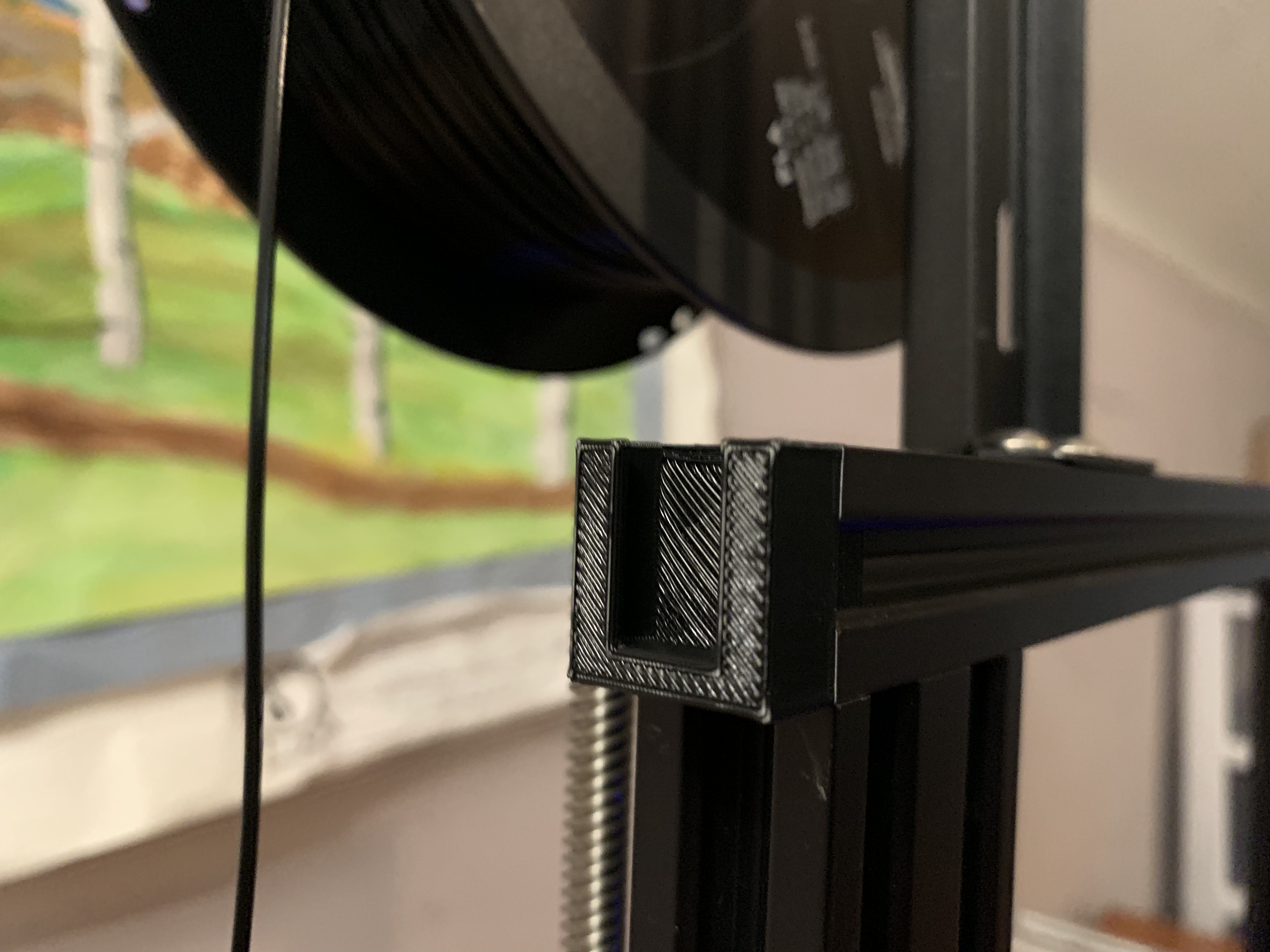

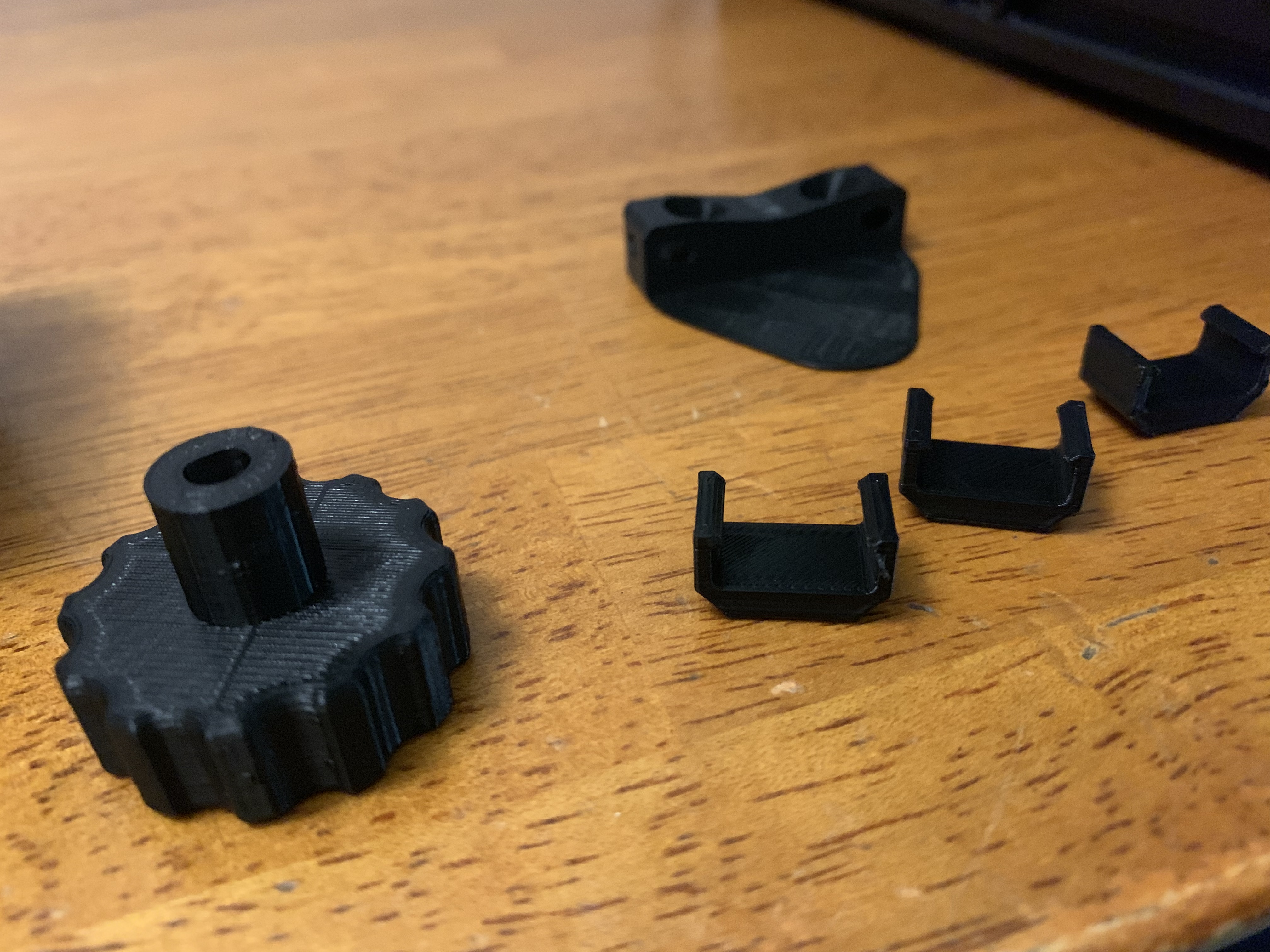

I printed that very same filament guide arm. For some reason the part that presses into the frame started coming loose, so I used some duct tape to hold it in place. A bit tacky, but I don't care how the printer looks, just the prints. But still it's a good print because I made a spool rack out of pvc pipes and I have some spools feeding from the far right side of my printer.

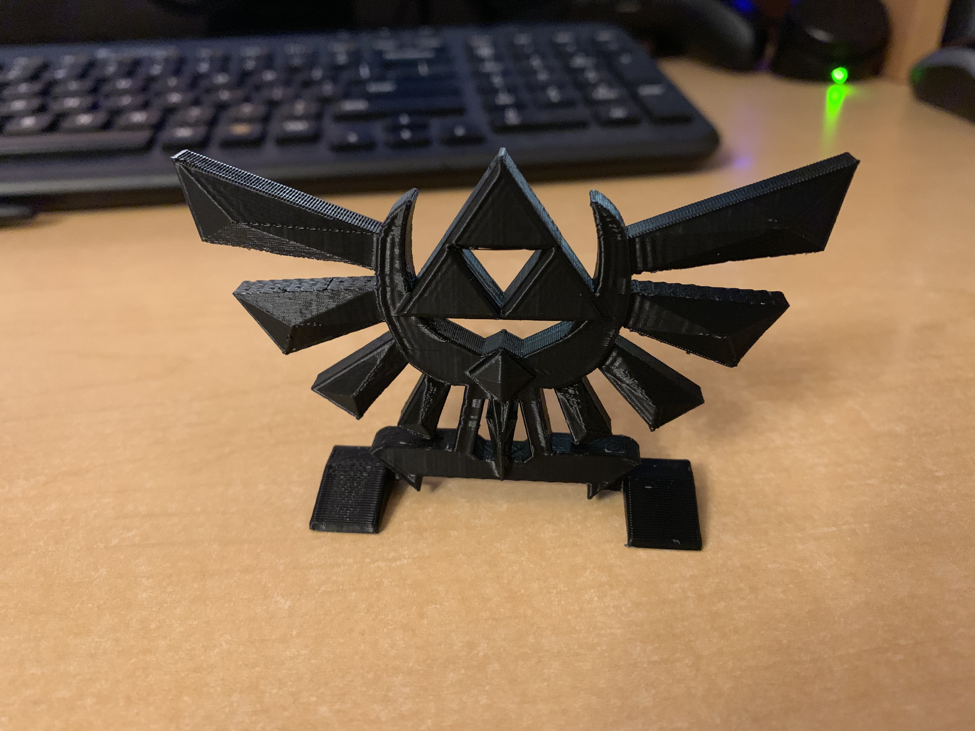

just seeing these prints I wanted to mention, you really don't need rafts. Don't worry and save yourself some time. If your model doesn't stick just apply 1 layer of regular glue stick and it'll do the job.
I only use rafts for prints with little to no first layer surface
Heh, I kinda figured out the raft thing on my own after a bit. I read all this junk about bed adhesion going into all of this that had me scared to print without one at first. Turns out the E3Pro has really good adhesion with the supplied magnetic mat. Puts a nice texture on the first layer of prints and everything.

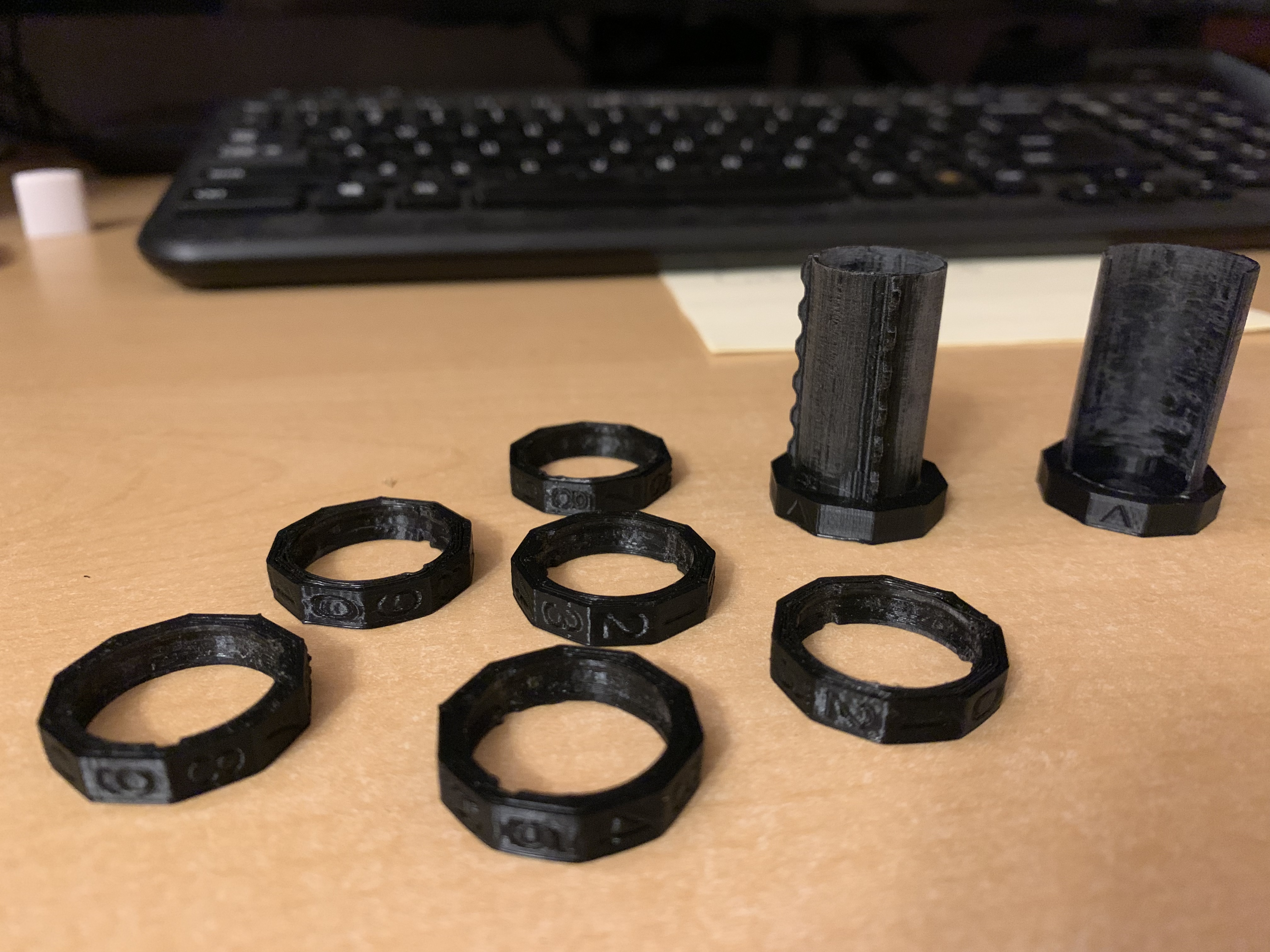

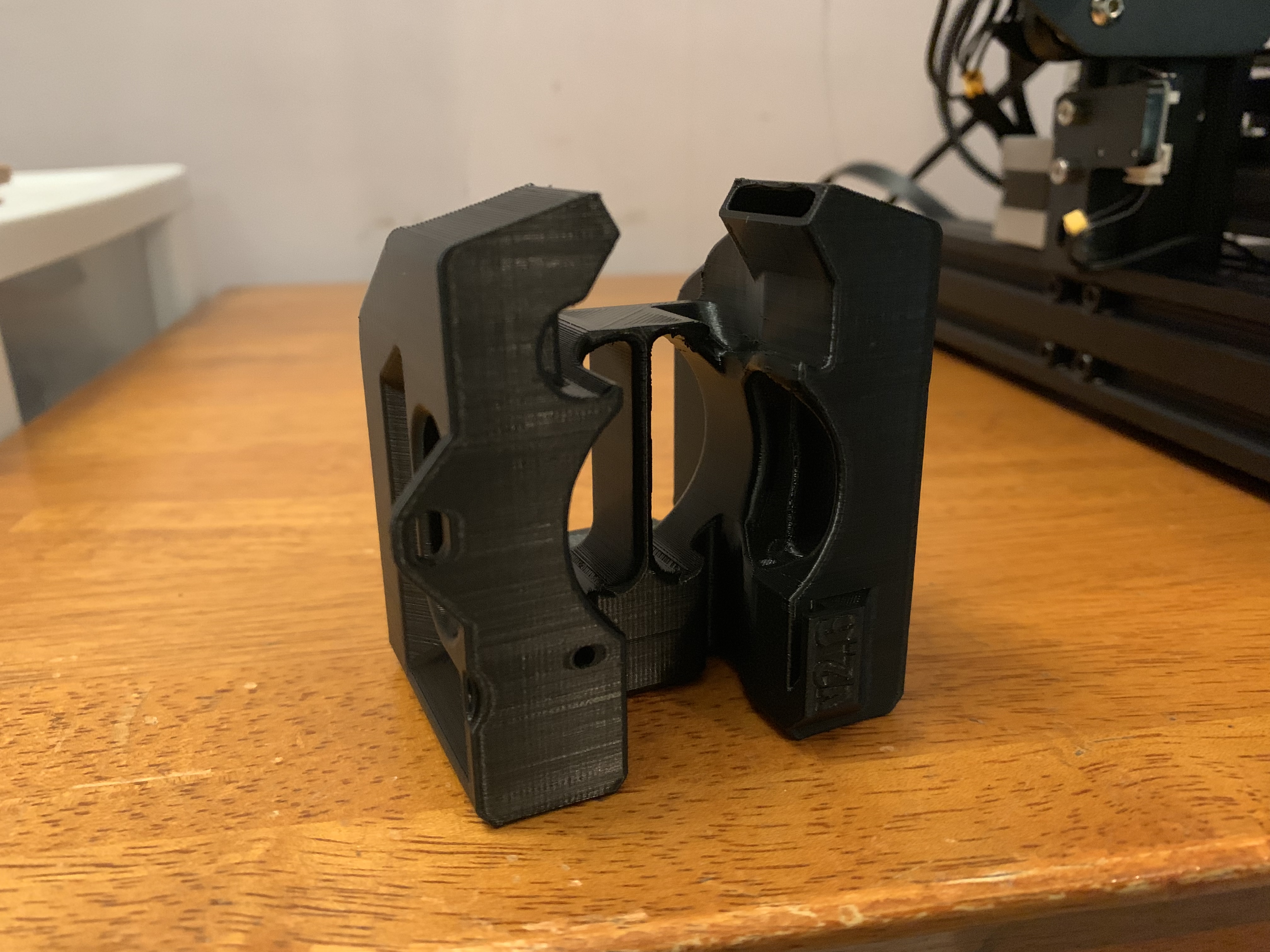

Anyway, here's some more messing about I did early on testing out what I could do and how to do it. :)
