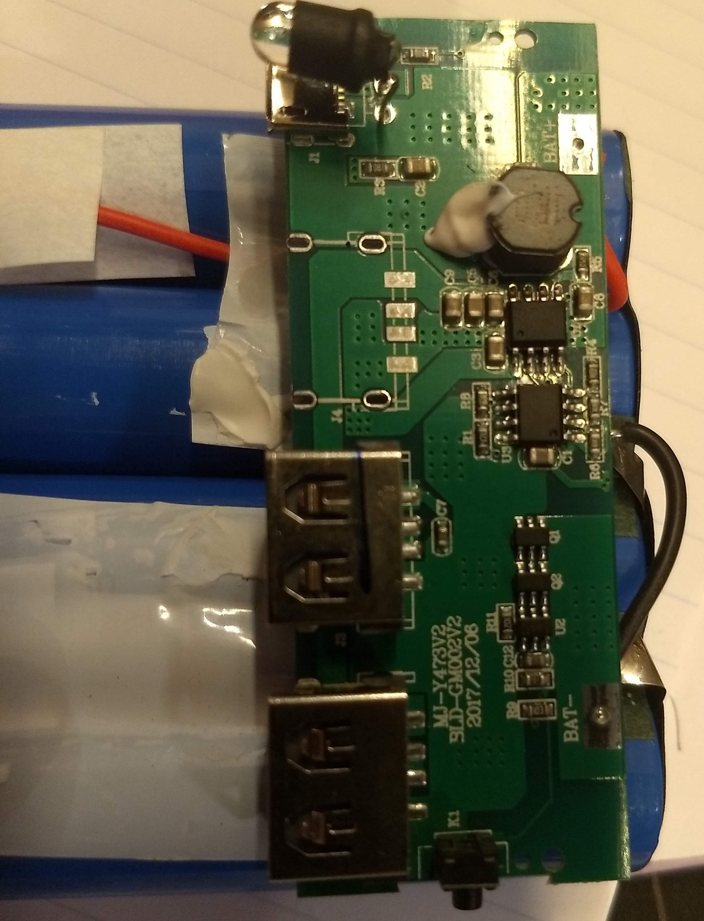

I've attached a picture of the board. This one is dead (I suspect from overcurrent, explained in my other post), but the three working packs are identical to this one. Each pack has 8 18650s in series being boosted to 5V. The total rating at 5 V is 20,000 mAh (I know its excessive, but for long drives I thought it would be nice).
Should I just take the output of the cells directly and only use the circuit for charge? If so I would need to put two packs into series for the output, as my boost converter is unstable around 3-4V (even though its rated for 3-30V) and will spike to high voltage (~30V) at the low 3 V range.

So, a quick test with the output of a good battery pack (before it goes to the board) led to the Wii not powering on. I don't know why, as the 8 batteries in parallel should have provided more than enough current even after the boost converter. I tested the Wii to draw around 20W peak (with disk drive) and at a voltage of ~12.46 on the boost converter and more than enough current, the Wii only made small clicking noises.
